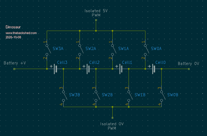

Below a schematic of a Sodium Ion Cell Balancing circuit.
Showing it simplified to get some opinions on a problem.
The switches are all OptoMos Relay modules capable of 20 Chinese Amps.
OptoMos
Maximum I will put through is 5 A PWM at 5v.
The 5v is from an isolated PS, but has not been connected yet, until I am 100% confident.
So perfected the software to measure the Cell voltages and switching the Relays to select the Cell to be balanced.
By switching say SW0A & SW0B together (they are hardwired together) the path of the current from the +5v iso rail connects through to the 0v iso rail.
That is 100% guaranteed correct and problem free.
Been testing with NO iso 5v connected, no load current at all.
When I connected my ESP32-S3 to my laptop, predictably I got some erratic readings from the cells due to powering my ESP32 and ADS1115 from the laptop only.
However, there was never a problem during this period.
Then I decided to use a 240 to 5vdc PS to get a more stable reading and that also worked perfectly. (for about 10 minutes)
I had both Laptop USB and the extra PS connected. There is a schottky diode in between as specified on the ESP32-S3 doc's.
Then for some reason the SW2A started smoking.
The only way to stop it was to disconnect the PS.
I can guarantee that the only Relays being driven were SW0A & SW0B.
There are led's on the 3.3v o/p's.
It took out the ADS1115 as well.
My areas of doubt are;
The ADS1115 is connected to the NON-Isolated 5v supply
When balancing Cell 0 the 0V isolated & 0V NON-Isolated are connected.
Would love to hear some opinions on this.

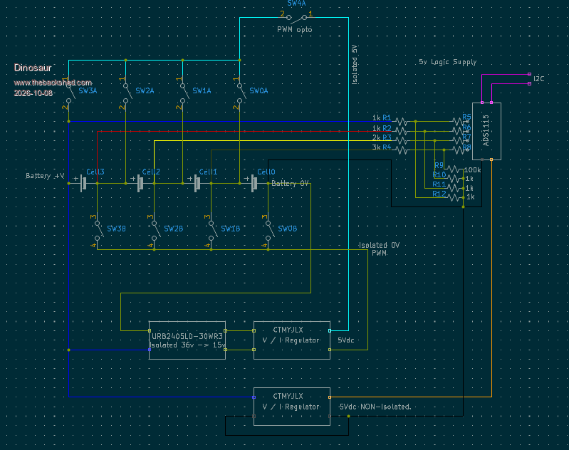

A total picture of the system.
Hervey Bay Qld.
