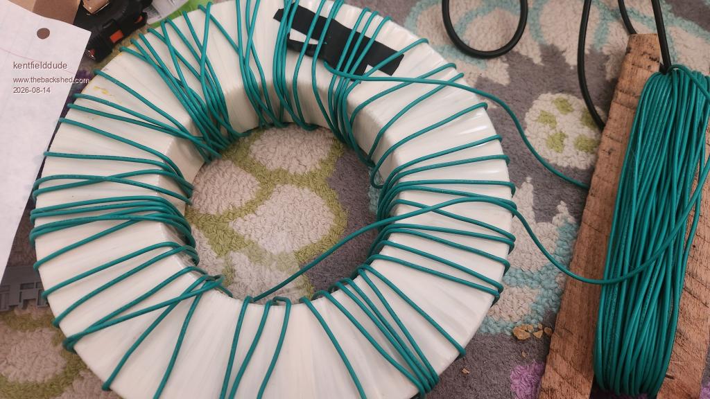

I purchased a toroidal core today. I don't know what it came from but its 46 pounds (21 kg) and I measured it to have a cross sectional area of about 40cm^2.
It seems to have a rather large hole relative to its size.

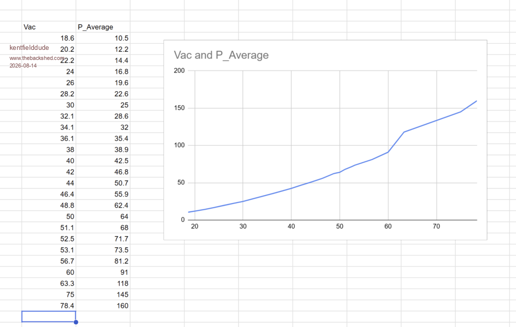

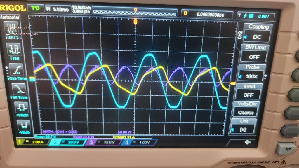

I put 60 turns on the core, and applied different voltages.
I used CP2100B current probe and a differential probe on my oscilloscope.
I set a math channel to do A * B, then I took the average of the math channel to get power consumption.
At 60V AC its drawing 91 watts.

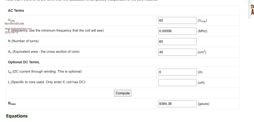

I plugged 60V ac into the flux calc and i get 0.94 Tesla. Seems like a high idle power. Could it be bad core material or am I doing something wrong here?

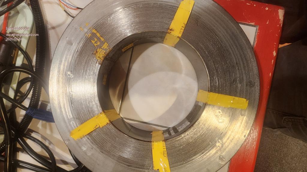

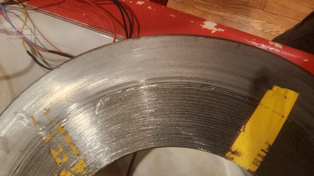

So many damn layers of thick mylar on this core. How do I tell if this is good core material. It looks like tofu steel to me but I'm no expert.

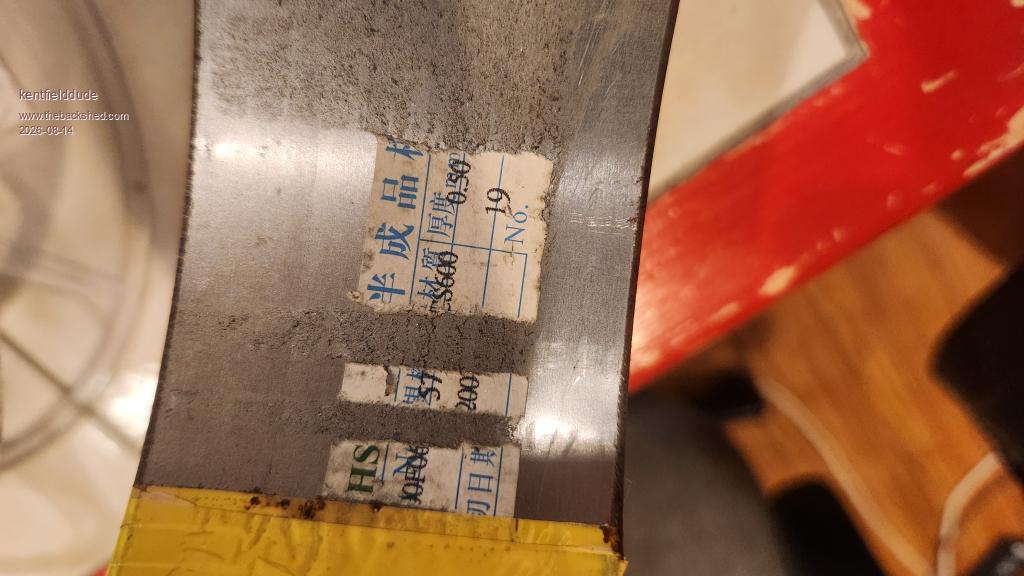

I have a #1 and #2 with decent idle power. I don't know what this core was from that I was just testing. I picked it up for $16 so it's not a big deal if it's bad. Looks like it's 0.5mm steel. Also it looks like they ran out of steel have way through and then just added some more and there's a gap. No varnish or anything on the core just bare steel.

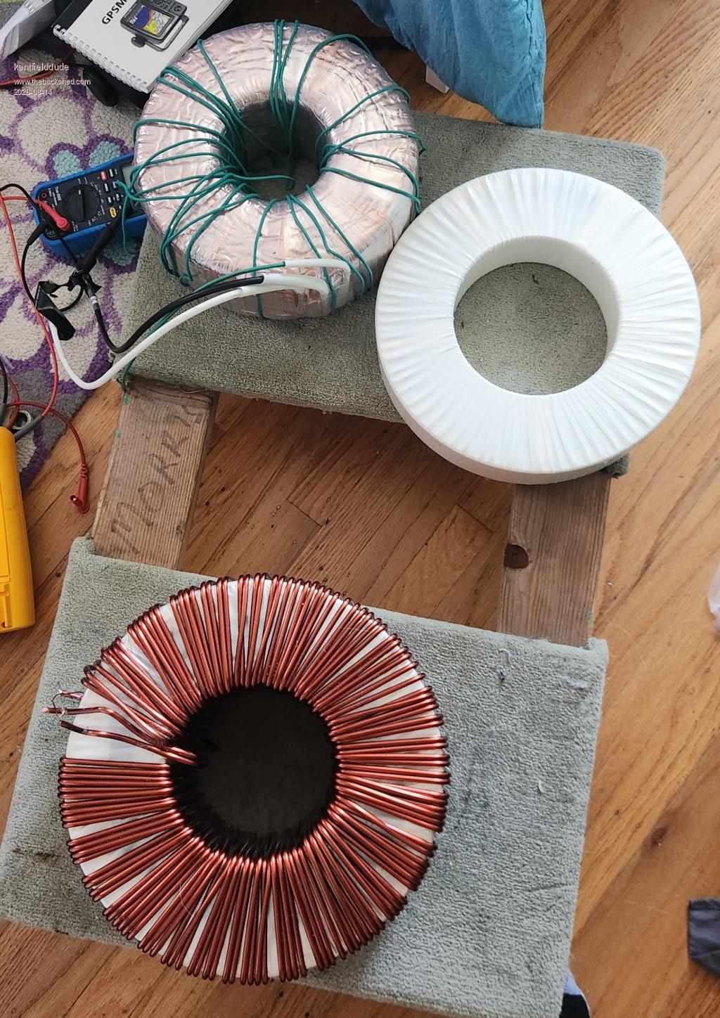

Godoh. My largest core, which you can see in the photo, is 84 cm². I've kept the original primary winding on it. The primary had two 4.6 mm diameter copper wires wound in parallel, with approximately 66 turns on the core. For a 225 V primary, I need around 108 turns, so I put the two windings in series to get 132 turns.
With a 4.6 mm diameter wire, the cross-sectional area is about 16 mm². At 4 A/mm², that gives me around 15 kW.
Is it okay if the windings that were originally in parallel are now connected in series and wound on top of each other? If there were a short between them, would it cause a sudden drop in the output voltage? I used a megohmmeter to test between the two parallel windings while they were isolated, and I got an open circuit on the 1000 V setting, which is the maximum voltage my meter can test.

I'm pretty sure it's just a bad core. My other core has 15w power consumption at 1T flux density. This has 91W consumption at 1T flux density. I also had a kill-a-watt meter hooked up to my variac that was feeding into the core. It was pretty close to what I was getting with the current probe setup. It was a bit higher but it's also including the losses coming from the variac transformer
Looks like it is the outer half that has no varnish. Maybe you can ohm out the OD surface and the ID surface to find out.

The amount of distortion of the I waveform is more than I would expect from GOSS (Grain Orientated Silicon Steel). The wrong steel could increase hysteresis losses.
The scope image shows only a small phase shift between V and I, it should be almost 90°. The purple trace (power) is nearly all above the 0 line showing a lot of power is going into the core but little being returned on the next ¼ cycle. An almost equal amount should be returned.
Probably not practical to unwind it, varnish the surface then rewind it.

My crappy core has continuity between all the layers
Posts: 3421
Posted: 12:20am 18 Aug 2026
There will always be continuity when measured with a multimeter as it is one long strip of steel. Even if multiple strips have been used the cut edges of adjacent layers often touch in places but this adds little to the loss as the resistance is fairly high, tenths of ohms to several ohms.
The problem is when the broad surfaces are in direct contact, the resistance gets down into micro ohms resulting in a large circulating current.

The outside layer to the inside layer measure about 0.6 ohms.

  kentfielddude said  The outside layer to the inside layer measure about 0.6 ohms.
The meter probe tip penetrates a thin insulating surface coating or there is no insulation at all.
