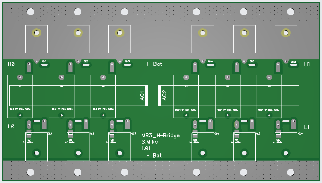

Looking at various options, have decided to build a LF inverter, I have an old toroidal core stripped out of a variac, the core needs demagnetization, so will have a go doing that. Also have a mishmash of various Lifepo4 cells here, just wasting away in my shed, so could use them to make a 32 cell battery for nominal 105V output. Sounds like a lot of work... the fun things we do as a hobby.
100v DC input makes things easier to build an inverter as the currents are smaller than your normal 50v, so pcb's augmented by busbars are easier to DIY. To that end have decided to go with 3 parallel mosfets per bridge quadrant, mounting them under the main pcb bolted face down to the bottom of the case - 2mm thick alloy.
As high voltages and large currents switching in 100's nSec time frames, construction is akin to RF design techniques to minimize voltage spikes and wave form ringing; the main 2 layer power pcb is built as a sandwich construction with 0v on the bottom, 100v on the top layer and the AC switch nodes as an isolated floating busbar glued to the top layer. Thinking around the 150A max and 100v, should be plenty to run the pump, the high start current is seconds only, normal running approx 20A for about 10 minutes, couple of times a day.

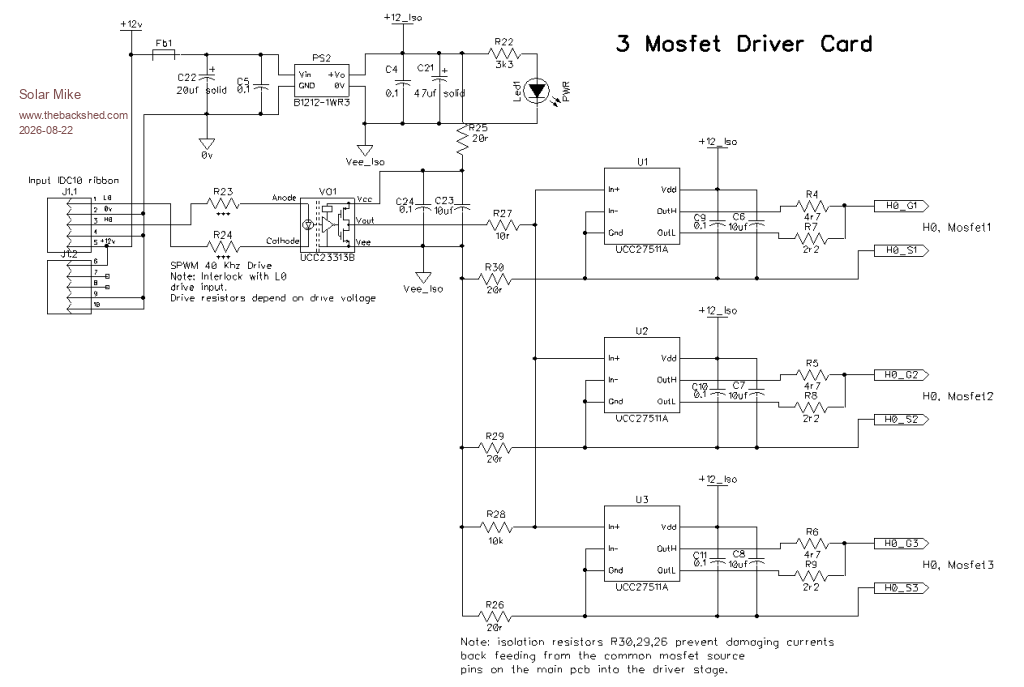

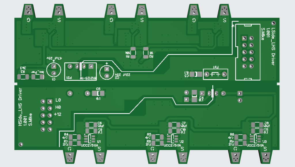

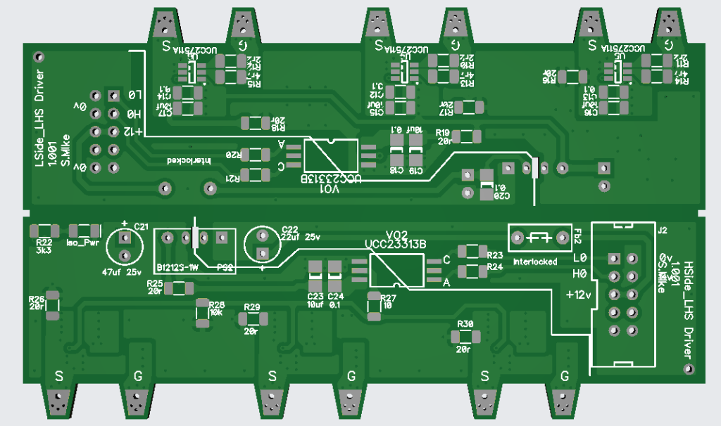

Each group of 3 mosfets have their pins protruding from the main pcb, and a driver daughter pcb sits vertically off this. Have used an "E-Diode" UCC23313B isolated mosfet driver as the main pwm input to each card, the output of this driver drives 3 x UCC27511A drivers, one for every mosfet. CPU derived inputs to the card have both High side and Low side inputs, this allows H0,L0 driver cards be cross-coupled in an interlock arrangement, ensuring no possibility of shoot-thru occurring, should the cpu go haywire. SPWM + dead-time generated from the PICO2-RP2350 cpu PIO, is 40 Khz, so the drivers have to be robust.
This time I have a schematic, here is my provisional for the driver cards, 4 cards each 28mm high and 96mm long, 2 per pcb 1.2mm thick, makes it easy to cut in half. Unfortunately due to their mounting positions, components have to be on the correct side, thus 2 different layouts.
Driver PCB:
Will draw up the schematic for the main Bridge board next.

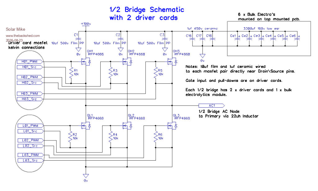

Here's the schematic for 1/2 of the bridge, the two H0,L0 driver cards sit directly on the pcb mosfet pins to give a direct kelvin drive connection. For a 100v nominal battery rail I'm using IRFP4668 mosfets with a 200v rating, It maybe possible to use lower voltage rated devices after observing them with a scope, the amplitude of any inductive spikes is unknown, so better safe than sorry.
For the very fast transients I have a 1uf ceramic across each mosfet H\L pair and a 10uf 500v pp film capacitor for main commutation current surge. This combination should ensure the bulk electrolytics sitting on another sandwich constructed pcb above the main board have minimal very high frequency current, which large electro's are not very good at handling anyway. Mosfets sit under the pcb, face down, the AC node connection is a folded copper foil soldered to the AC busbar and thru the pcb slot to the mosfet pin.
Top and bottom of the main pcb has 0.5mm thick copper foil folded over the edge and soldered to the pcb. Same for each bulk cap board, 7mm dia brass spacers link these boards together. The two AC nodes comprise a copper bar 15 x 2mm thick glued to the main pcb on a piece of FR4 with no copper as insulation, this sits under the 10uf film caps. The two bulk cap boards have 0.25mm copper foil added top and bottom to increase current capacity.
Main AC outputs each have a 40uH inductor to the transformer primary, this acts as the 40 Khz filter and isolates the primary and its winding capacitance from 40 Khz HF spikes; this allows a second identical bridge to also be connected in parallel to the transformer input for greater output; as they will all share identical SPWM from the cpu.
Haven't even looked at the cpu drive board yet, PICO2 RP2350 module, using the PIO to produce accurately timed 40 Khz SPWM + dead-time, will be using feed forward voltage sensing as the primary output AC stabilization and a secondary feedback measuring the output voltage.
Maybe awhile before I get around to working on this, too many other projects on the go at the moment, along with a bathroom renovation...

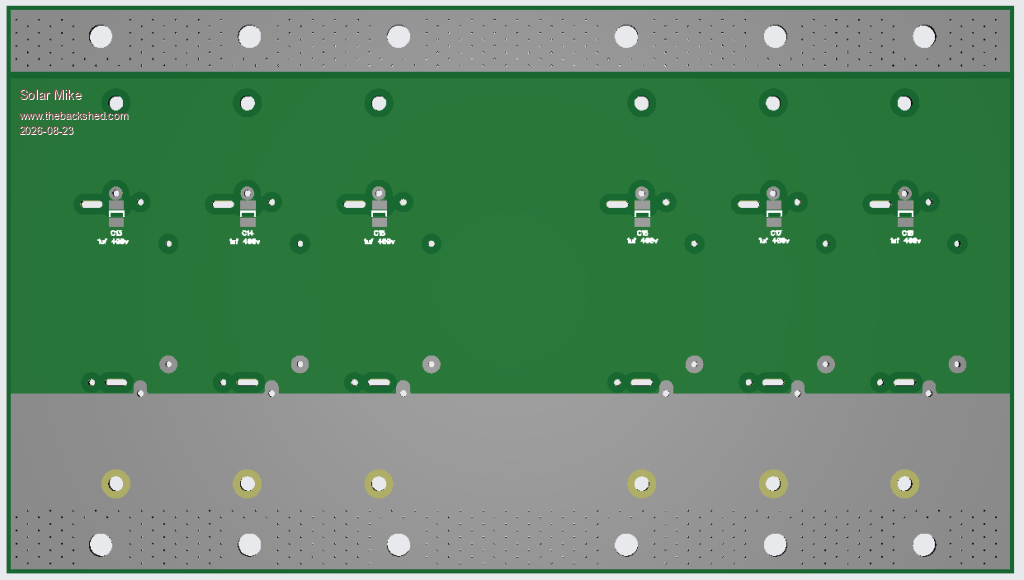

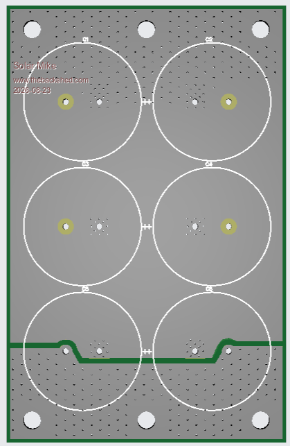

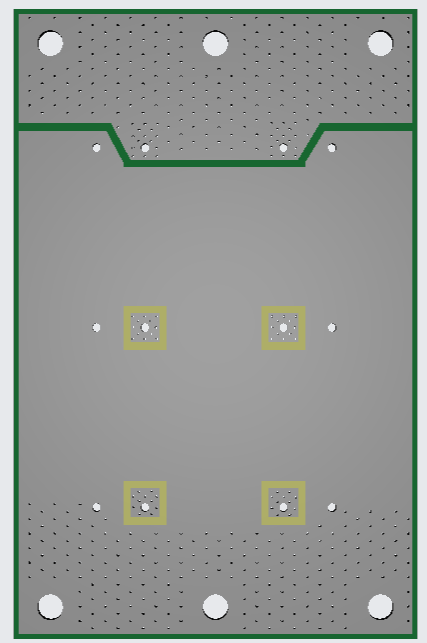

Bridge PCB, 230 x 130mm:
1 of 2 Cap pcbs: 83 x 130mm:
I'm not going to get any of these boards made yet, until the cpu pcb is done, as there maybe changes; looked at the cost of 2oz pcb, its horrendous, the most cost efficient way to get them made is to do all as a single pcb with snap off cut lines.
Looking forward to seeing the build.  It's a bit surprising to see a 40uH inductor given the 40kHz switching frequency.  Based on the ~47uH inductor sizing for the 20kHz switching frequency used in the more recent nanoverter builds, it seems a significantly smaller inductor could be used for 40kHz.  Increasing the switching frequency is one thing I've wondered about for the nanoverter as a way to reduce the quite large inductor size used in the recent builds.
