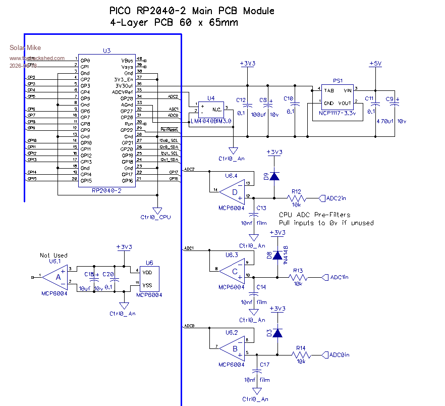

First project is a 3 phase PV charge controller; the Pico-2 PIO can easily be setup to output 3 PWM phases each running at 125 KHz and driving a buck inverter stage. To that end I want a generic plugin PCB module containing the main CPU and some ancillary components, running off a linear 3.3v psu and ADC reference of 3.0v. Included on the pcb is a voltage rail fail reset chip an MAX809L, this resets low at 4.63v, connected to the incoming 5v power it can cause a interrupt on an input pin and allow the cpu to turn off PIO output pwm signals, shutting down cleanly.
Have built this on a small 65x60mm 4-layer pcb with a 44 pin edge connector, so can be plugged in to the main PV host controller. The 4 layers give excellent internal ground and power planes which will help in a noisy inverter environment

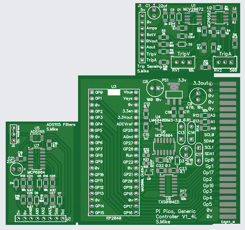

Have also made a couple of small ancillary helper modules with pin headers. These are on the same 100x100mm pcb and cut off.

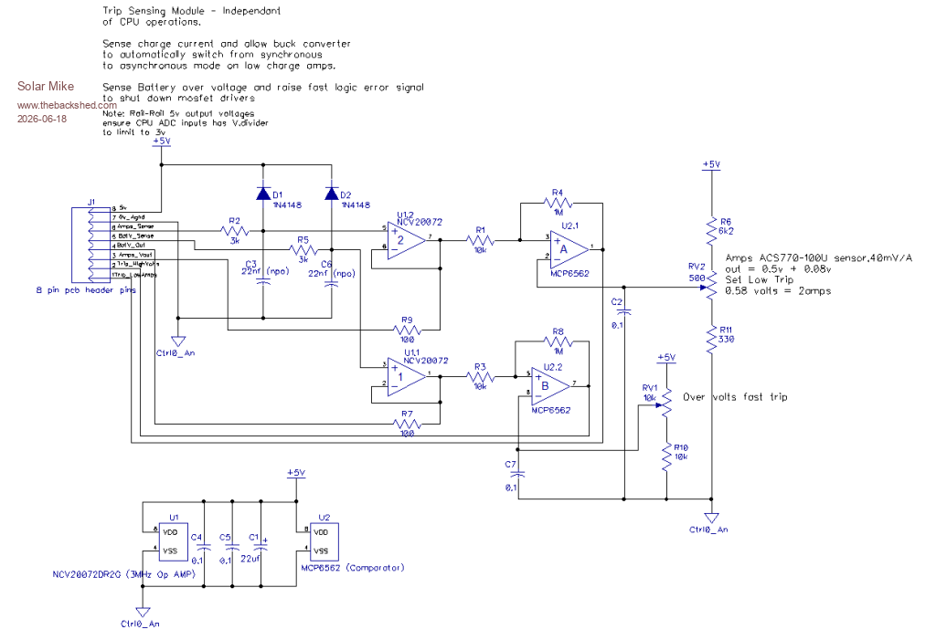

1: Trip sensing, this pcb has an over voltage detection comparator to allow shut down of the buck inverters independent of the cpu; as if the output fuse blows or battery gets suddenly disconnected the cpu sensing battery voltage cannot react fast enough to prevent the buck output voltage rising to alarming levels and perhaps destroy components.
2: Low buck current sense, at very low duty cycles its possible for the buck stages act as voltage boosters, feeding battery power backwards causing high voltages on the main capacitors, again blowing things up. To prevent this I switch off the low side synchronous rectifier mosfets at low current levels, thus turning into asynchronous rectification using the mosfets source-drain diode. CPU has no involvement here, buck stage seamlessly switches between the two modes.

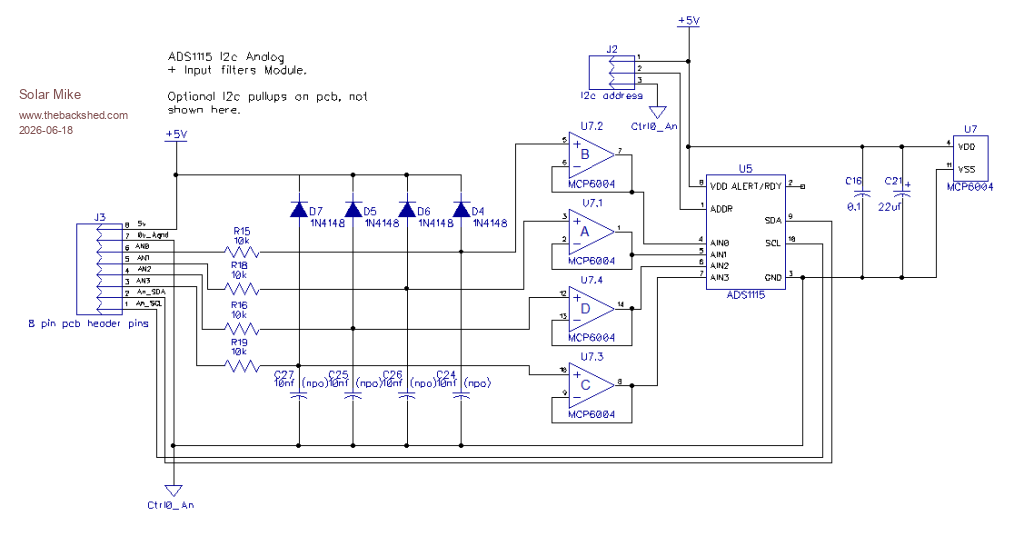

The other helper pcb has a I2c ADS1115 mux analog ADC chip and some high input impedance noise filters, again with 8 pin header, main CPU can use this to get accurate voltage measurements, as the PICO-2 still has a slightly compromised ADC input system.
100 x 100 pcb: to cut up at marked edges:
I quite like Micro Python as an object programming language, so will use that for future work using these boards, its also quite fast and allows access to the 2nd CPU, noted with strict limits.

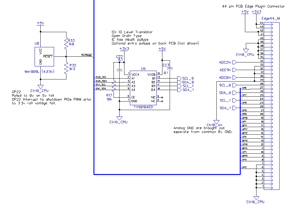

Edit: just noticed an error on the Max809, will fix it.
This is how its meant to be wired, OK on the pcb...

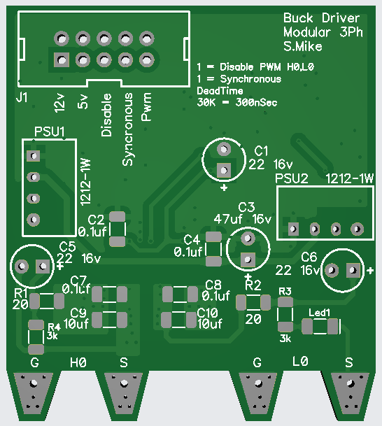

Making a start on this project with the buck inverter modules; each buck output phase will be a 100 x 100mm pcb with bus bar connections to the other 2 phases for PV volts, 0v common and battery output.
Will use two TO-247 mosfets on each module mounted under the pcb, so they are pressed against a heat sink - 3mm thick alloy plate - bottom of case or box. To get best gate driver connections its easier to mount the driver components on a separate pcb that solders direct on top of the mosfet pins. Then link these to the PICO controller via 10 pin IDC cables.

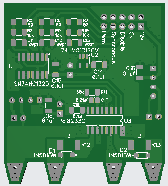

Here is a test build of the driver module, they are quite small, 4 will fit on a 100x100 pcb.
Top:
Bottom:
Concept is quite straight forward, all inputs are high freq filtered then into schmitt trigger NAND gates, the Synchronous signal allows turning off the L0 input during low duty cycles to prevent the buck stage turning into a voltage power booster - Not good, the Disable input via schmitt buffer, turns off the mosfet driver PAI8233c, these are 4 amp fully isolated drivers with resistor set dead time. Small 1w 12-12v psu's provide isolated mosfet bias, note they require min load current (3k Resistor) on output. The main PICO board will turn off the input 12v supply to the 2 PSU's under no charge conditions.
I haven't created a schematic for these yet, back of a napkin scribble is all there is currently; and it may not be the final version.

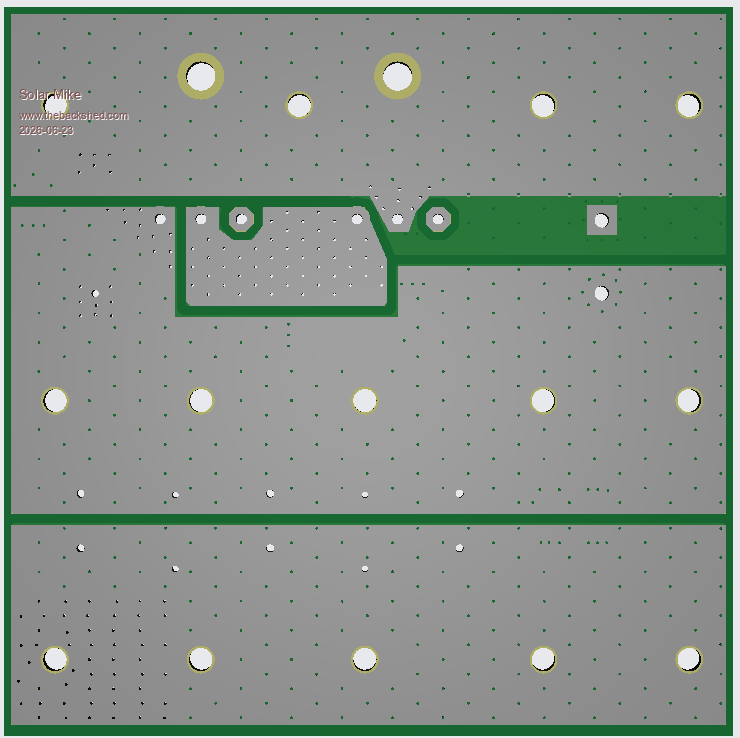

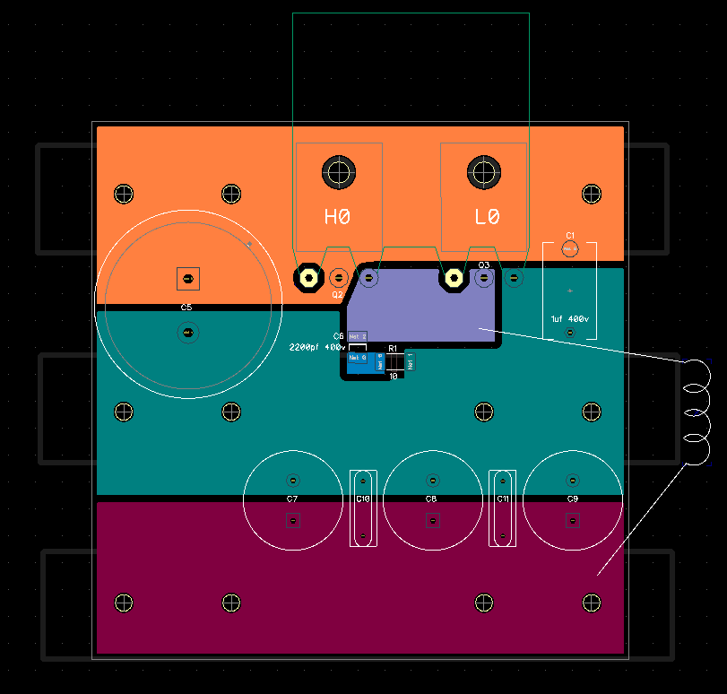

This is the sort layout of a Buck Module for each output phase, I'm thinking of doing.
20 x 3mm soft alloy bars run under the pcb where the copper pours are tinned, they are bolted to the board by counter-sunk 3mm bolts, this provides great current carrying capacity at little cost; bars are sufficiently long to mount 3 modules.
The two power mosfets in each module are placed under the bar area + insulation pad against the heat sink. The driver module sits vertical on the mosfet pins, with their drive ribbon IDC cable running back to the Pico Mother pcb, The bars bolt to one end of the mother board, which has the current sensor and extra bulk electros.
Cad Layout PCB 100x100mm:
If say each module handles 30 amps + some ripple current, 3 phases will do 90 amps, this maybe required if running 12 or 24v battery voltages. Three 30 amp buck inductors are much easier to make than 90 amp ones, if 90 amps isn't required then one could just have two phases operating, or leave three and have lots of head room.
I don't think I need to worry about having individual current sensing on each module, if the same components are used, currents should be similar, could always have a pwm duty offset on each PICO PIO output to compensate??
Mike

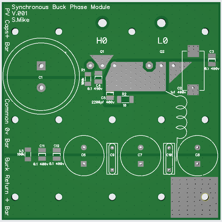

Solar Mike
Joined: 08/02/2015
Posts: 1255
Posted: 02:37am 23 Jun 2026
Buck Phase Module 100x100:
Time all three modules + PICO mother board are laid out in a thin alloy box, the physical base size will quite large, if the bottom panel is 2mm thick aluminum, that should be ok for the heat sink, wont require any fins.
Work on the Pico mother board next..

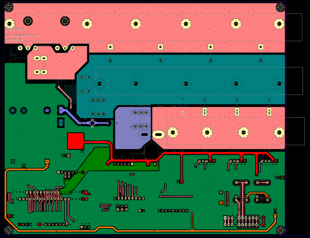

Main host board done, taken awhile, 2 layer 206w x 170mm pcb. Heavy alloy or copper bars bolt under the pcb against tinned copper pour areas with 5mm spaced via's over the surface.
PICO2 cpu module pushes into a 44pin socket, other helper modules solder via header pins, have kept most of the IO logic at 5v using totem pole V translators or HTC logic interfaces, note the I2C uses open drain converters. The PIO generated 3 phase pwm signals are buffered by 74ACT541 so they have enough drive for the ribbon cable outputs to each buck power module. Have allowed for some Bulk input electro's and a few final output ones, testing will tell if I need them all; if not then could have a V2 made smaller.
Will do some additional checks and send all the gerbers off in the next day or so.
Cad Layout:
Mike

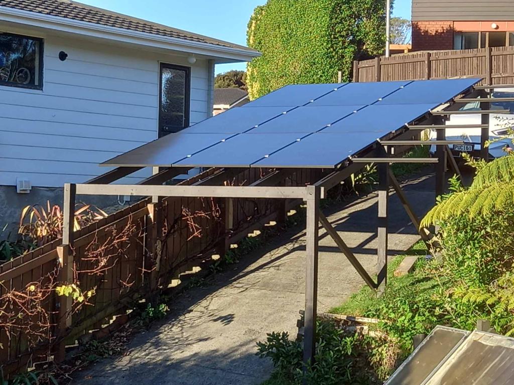

I have built a solar carport above the drive down into the garage under the house, mounted 12 by 450 watt bi-facial panels, will arrange in 4 groups of 3 panels as the ones nearest the fence get partial shading in the morning from the house next door. Mppt is 31v so 93v loaded, 106v unloaded, this means I can use 160v capacitors.
Pic shows partial construction with 9 up, have since put up the remaining posts and mounted all 12 PV, just have to build a shed next to it for batteries etc. The 3.5m beams across the drive are made from 3 pieces of timber laminated with a steel strip between them, glued with polyurethane, we are in a valley and the winds howls past at times creating a high loading from the panels surface area.
Mike
Godoh
Joined: 26/09/2020
Posts: 716
Posted: 12:03am 07 Jul 2026
Looks great Mike, Looking at the photo from this angle the carport looks really low, I was wondering how a car would fit under it. I am guessing that you have no plans to buy a van or a truck and try and get it down the drive.
I am thinking the angle of the photo makes it look a lot lower than it is.
I understand windy places, we often get 100 kilometre per hour winds in winter where we live, so everything here is over built.

The MG EV fits under with plenty of room, a larger SUV + roof rack may have problems, however at some future date, the whole deal can be dismantled; its all held together with bolts and joist hangers with hundreds of stainless screws. The grape vine on the fence didn't produce as many grapes this year, possibly lack of sun, see what its like next year.

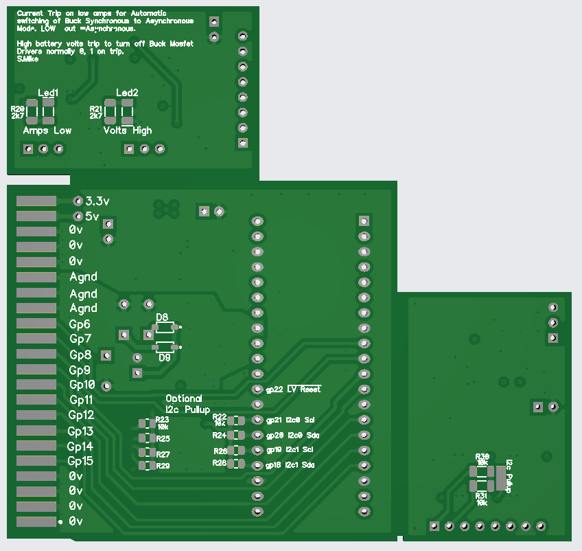

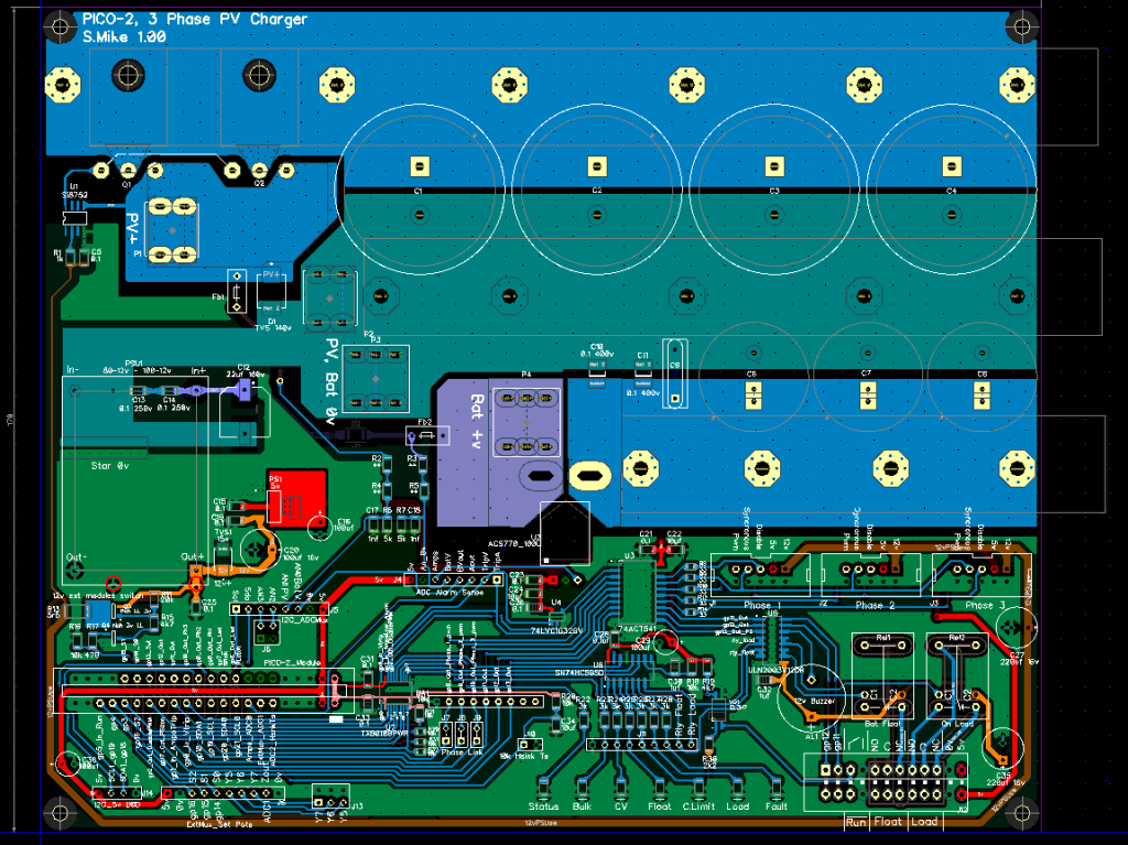

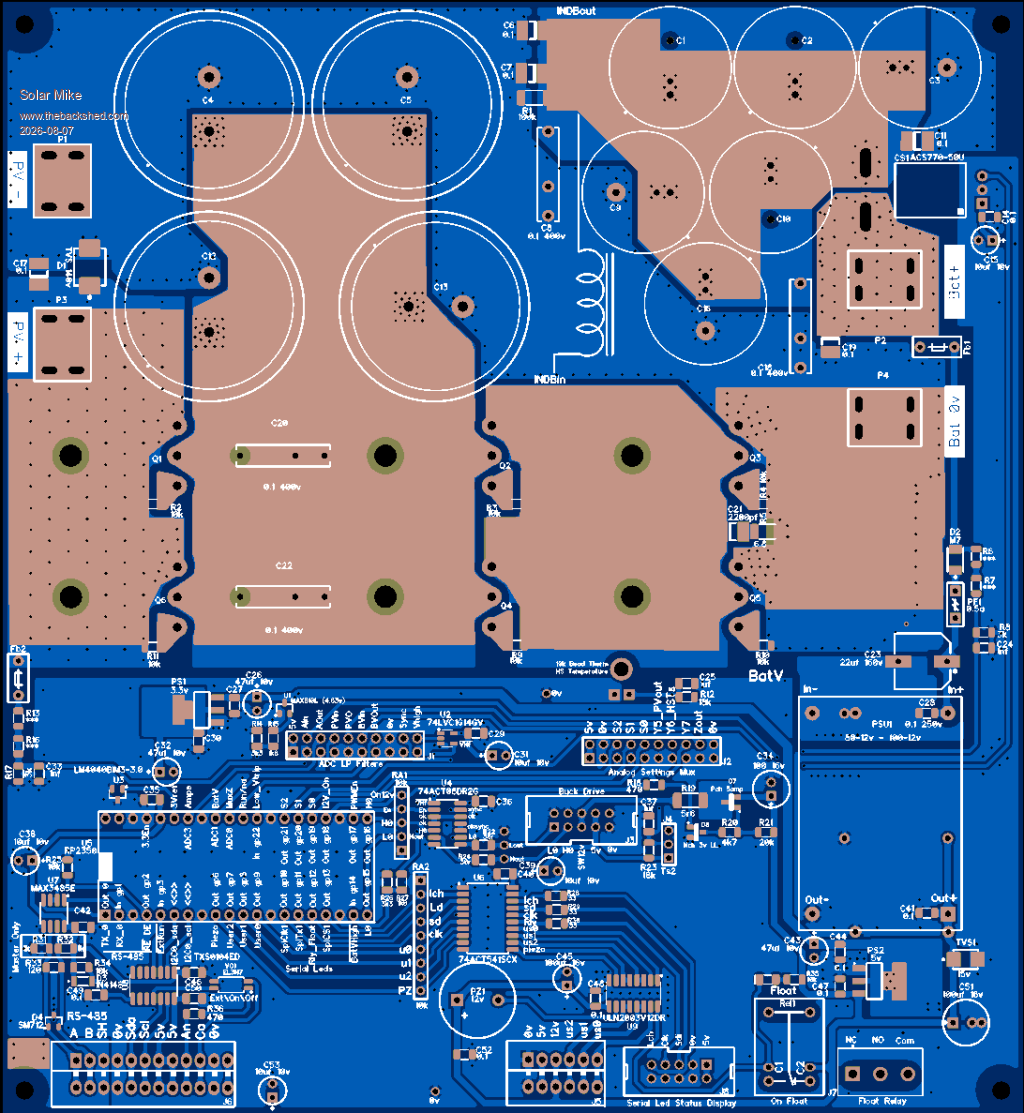

The pcb's came back a couple of weeks ago, their immediate use is at another location charging batteries in a container, with an array of 24 PV panels split into 4 groups of 6, each 6 grouping producing about 1800w around 36 amps @50v. I dont really want a huge multi-phase PV controller for this; better to use one with dual parallel mosfets for the buck and synchronous rectification, this makes the layout simpler and quite efficient having current sharing in each mosfet.
So, another quick re-design, have placed the PICO-2 RP2350 on the main pcb, along with a couple of helper pcbs containing the low pass active filtering and the H0,L0 mosfet drivers.  I also want proper balanced RS-485 communications between all 4 PV controllers, where one is a master and the others slaved to it. There will also be another stand alone module that with the RS-485 communications aggregates the data from all 4 PV controllers along with a DIY smart shunt.
Bit of a pain making yet another controller...
Here is the main PCB 188x 204mm
Should get the other small pcbs completed tomorrow.
Edit: haven't shown the bottom, its nothing but tinned ground planes.
Mike

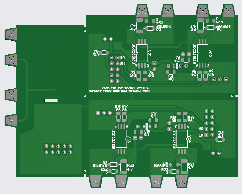

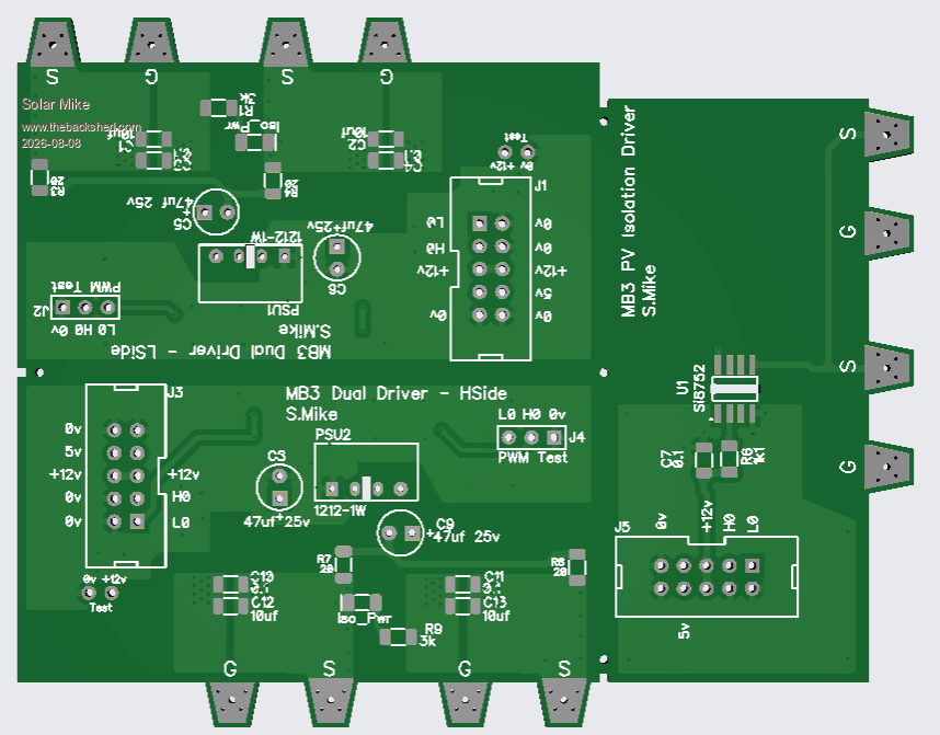

These are the 3 driver daughter boards that mount directly to the mosfet pcb pins
they fit on a 100x100 1.2mm thick pcb, 1.2mm allows easy cutting with stanley type blade or large tin-snips.
The "E-Diode" input Ucc23313B drivers 1 per mosfet are cross coupled interlocked, so they only work with complementary H0,L0 signals. The main pcb is using the RP2350 PIO to generate the 100 Khz PWM + 250 nSec dead-time with 11bit duty precision, thus the interlock.
PV-Battery isolation mosfets just have a 12v input to activate the SI8752 isolated voltage driver. 12v power to all drivers is switched off/on by the CPU, so during times of no activity the small 1212-1W isolation PSU's are turned off.
Mike

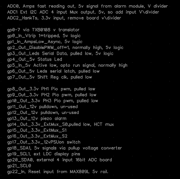

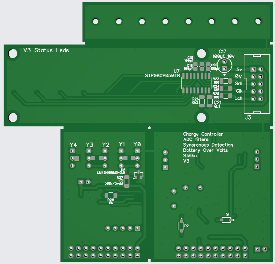

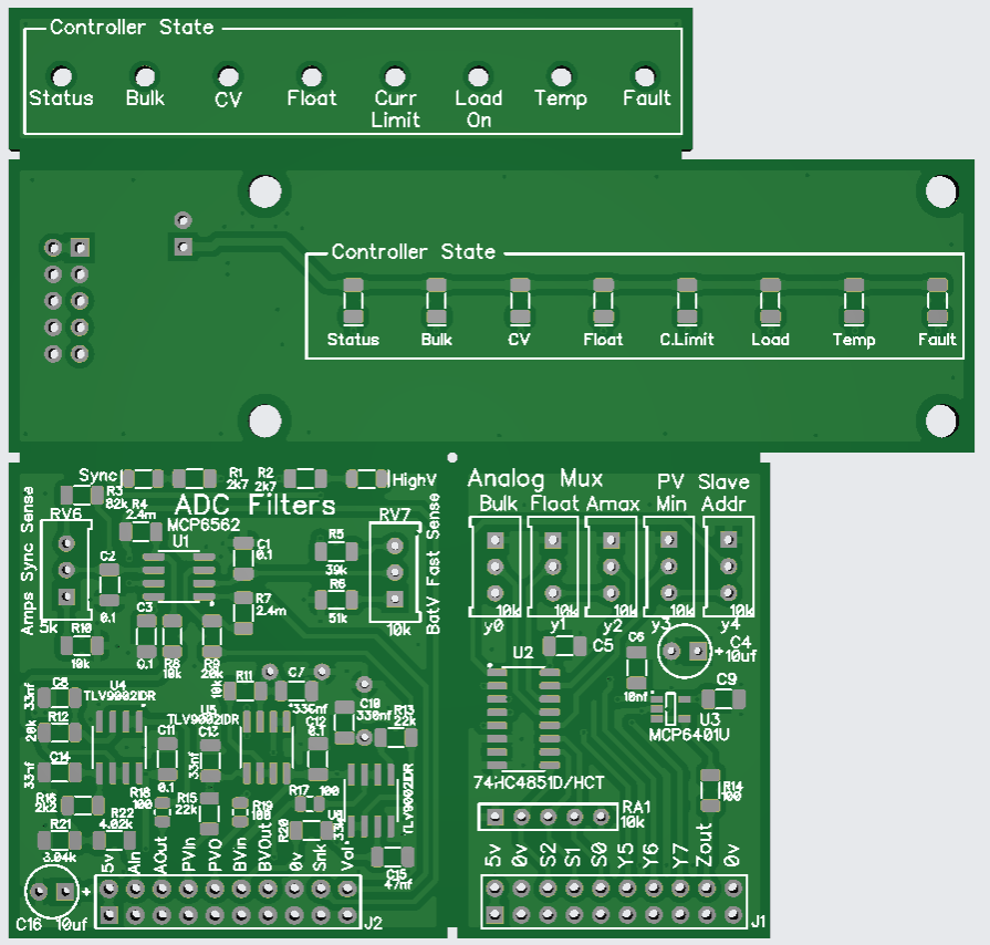

The main PCB has two 10pin double header sockets, one hosts the 3 tailored low pass filters that link to the PV, Current, Battery volts, an over voltage battery sense comparator and a low charge comparator. PCB is 1.2mm thick, so quite easy to cut as marked.
The battery sense is used in a fast pwm lockout to disable pwm output prior to any response from the cpu; typically this would fire if say the output fuse or breaker opened during a high charge current event, where the controllers output voltage would rise extremely quickly, potentially blowing stuff up.
The low current sense activates whenever the output current drops below a set value, approx 2 amps, the sync output signal turns off the low side synchronous rectifier mosfets, thus seamlessly reverting to asynchronous rectification at low current or low pwm duty, there is hysteresis, so switches back at some higher level to full synchronous rectification in the buck stage.
The other analog mux module, allows use of some multi-turn pots to set main voltage settings on the fly, the slave address pot allows multiple voltage levels to be set to distinguish Master and slave addresses. a precision 3.0v reference on the rear of the pcb sets the max voltage level to match the same device on the Pico ADC-Ref pin.
Third board with IDC connector, has a serial led driver to quickly display controller status, if this board is mounted under the front panel, the very top pcb can be glued to give a better finish. These are made black with white text.
