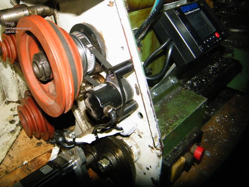

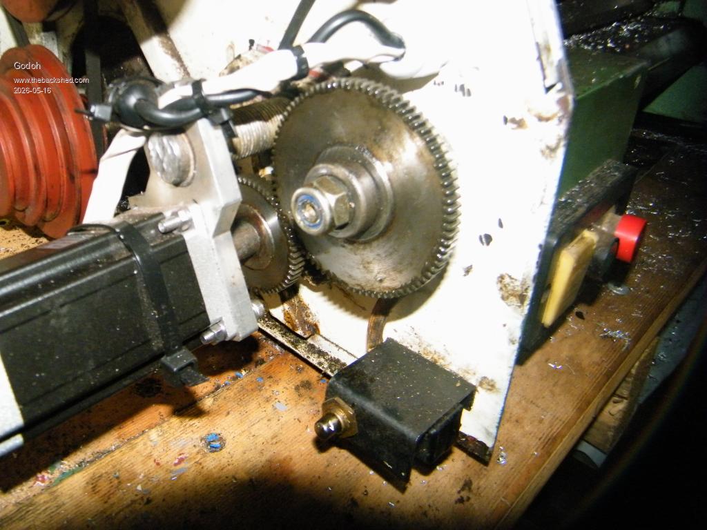

Here are some photos of the unit.
I am wondering if the stepper motor can't run fast enough to drive the lead screw at the speed required for the coarse threads.

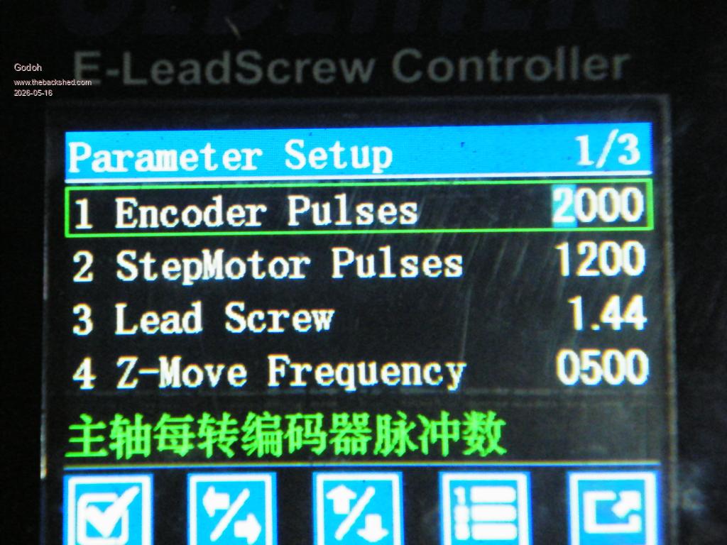

Ok this is the first lathe I've seen that uses an encoder for rotation position so I have to ask is that
1 Encoder pulse 2000 ' is that exactly a 360 degree rotation
2 Stepper pulse 1200 ' what is the leadscrew pitch and is it metric or imperial
3 Lead Screw 1.44    ' Please explain what figure this is
4 Z-Move Frequency 0500 ' would this be set for a screw cutting pitch

So the encoder pulse was set that way when I got the gear. The kit came with toothed belts and pulleys and the setup was already programmed in.
I did check the rotation and yes as best as I can see the chuck is reading right for a 360 degree rotation on the degree setting.
Now I am totally new to all this stuff, so how do I measure the lead screw pitch ?
The stepper pulse on the controller was already set at the 1200 setting so I have just left it that way
I am fairly sure the lathe is metric, but there are adjustments on the controller to cut metric, imperial or custom threads. I have cut some 28 tpi threads with it and they appear to be pretty good.
The lead screw setting is the one I have changed to get the tool carriage to move the correct distance when I run the machine. I tried heaps of settings up and down until I got the one that moved the tool carriage the right distance. So the 1.44 setting for the lead screw is the one that lets me cut threads and machine automatically accurately.

The ratio of the gearing I have driving the lead screw is 1 to 1.2
so 70 teeth on the stepper motor and 84 teeth on the lead screw

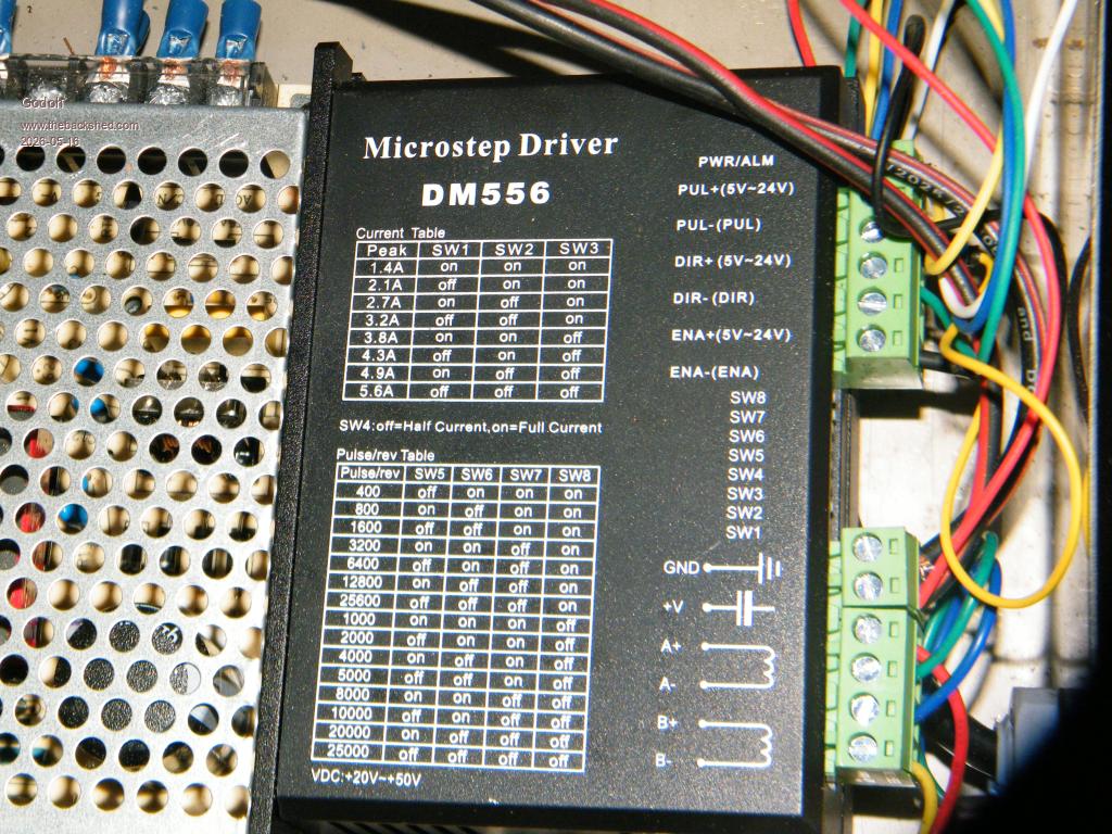

Hi Bryan the DM 556 setting is for 2000 pulses at the moment.

Ok mate Now all you may need to is move the first 3 switch's to set the current and leave switch 4 off to reduce the holding current.

Hi Bryan, thanks for the tips, I upped the current from the stepper controller and at first it worked, then it went into freakout mode again.
I worked out that I was trying to run the spindle too fast and it was causing a mis match.
I put the machine onto the slowest spindle speed and then it worked fine.

I have not read all of the above but can you tell me what current setting
you have with the stepper drive?
depending on the position of SW1, SW2 and SW3 you set the current.
if the current is too low, it won't run fast or pull high loads,
it will just whine and think it's going somewhere (sounds like some
people I have shared a car trip with)
See what is said on the motor, as far as max current is specified.
then set the switches to that or maybe 1/3 more.
I have built about 5 machines that use steppers in the past.
They feel no pain if you give them a bit more current.
The drive says it's good from 20 to 50V DC. Obviously running near
50V will give you the best chance to drive a difficult load.
what voltage is supplied to the stepper drive?
(I have a few of these here at work and they have been reliable in my
use cases)

Hi Poida the stepper controller was set for 4.3 amps when it arrived, it is a kit from aliexpress that has all the parts to automate the lead screw.
The gearing was wrong from the stepper motor to the lead screw for my lathe so I removed the pulleys and belt and have used gears instead.

It turned out that the problem I was having was I was using too fast a spindle speed for coarse threads and the controller didn't like it. The motor was hammering and not running well .
I tried with the spindle speed lower and it works great. So the encoder must be telling the control panel that the speed is wrong for that threading pitch.

thanks for the help. I did up the current setting to 5.6 amps but tomorrow I will put it back down. There is no current rating on the nameplate of the motor. They are basically chinese compies of NEMA stepper motors.
