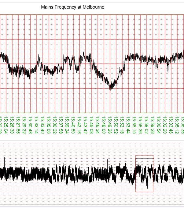

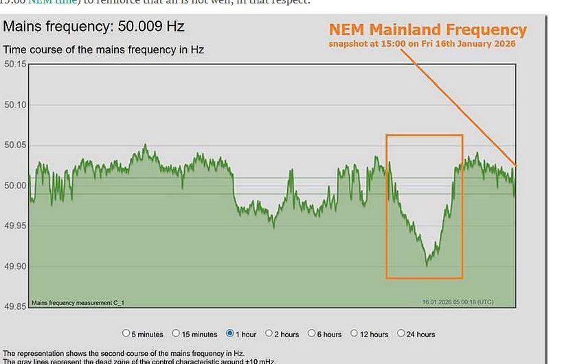

here is some "proper" mains freq data, from https://wattclarity.com.au/articles/2026/01/16jan-frequency/
and my data
I wondered what the average frequency for a day is.
I chose Jan 14 2026..
mysql> select avg(fnfreq) as avfreq from freq where ts > 20260114 and ts < 20260115;
| avfreq            |
| 49.99938892271266 |
1 row in set (5.02 sec)
so my measured mains frequency is quite close the day's expected average of 50 Hz.

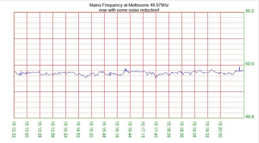

I've been playing with various means to remove noise from this thing.
now it is a lot better.

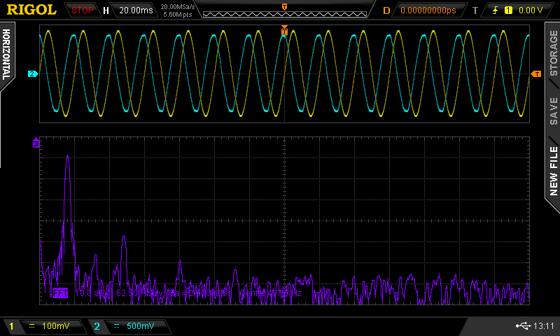

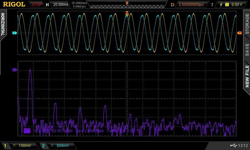

I filter the 20V AC using a Sallen-Key low pass filter with a -3db frequency of 50 Hz
Also I run the 3.3V, GND and opto-coupler output wires 2x through a couple of ferrite
rings before they get to the Arduino Due microcontroller board.
This helps with the noise from various things in my office.
before filter:
after filter:
so the 3rd and 4th harmonics of 50Hz are low less. I wanted the 100Hz harmonic to be
reduced too but it seems not much was done to it.
the resulting frequency graph is a lot cleaner though.
