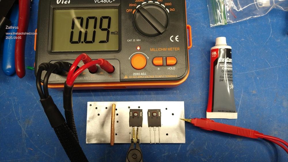

This test measures the resistance between the heatsink and MOSFET drain tab both dry and with GB Ox-Gard applied like heatsink grease.
The compound used between the MOSFETs and the heatsink is GB Ox-Gard anti-oxidant compound. From GB marketing:
"The Ox-Gard Anti-Oxidant Compound is the perfect safeguard for aluminum-to-aluminum, aluminum-to-copper, wire connections, and aluminum conduit joints. This product is formulated with metallic zinc to create a compound that enhances electrical and thermal conductivity which is used on high power crimp connections and stud bolt mountings. When the connection is tightened, the grease is displaced, leaving a layer of zinc filling in the surface imperfections of the interface. This has a twofold effect; it improves electrical conductivity and it improves thermal conductivity. This reduces the connection temperature under high power conditions by a reduced voltage drop and by providing a heat conductivity path to the connection's substrate. Manufactured with a unique grease compound ensures brush-ability over a wide temperature range, tenacious adherence to all surfaces, resistance to water wash out and the prevention of rust and corrosion. "
Normal white heatsink compound is silicone oil loaded with zinc oxide.
The GB Ox-Gard  is a lithium grease loaded with zinc powder, talc, and graphite.

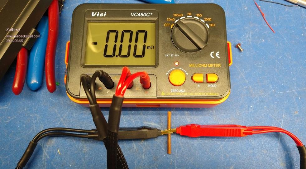

I had reciently purchased a Vici VC480C+ milliohm meter from Amazon and decided to see what could be measured.
For the money, the VC480C+ is a quite capable meter.

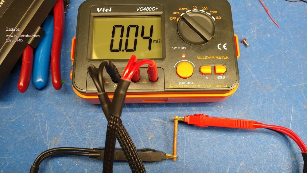

For zeroing the meter, I've been using a 2" long chunk of 6ga (16mm2) wire.
The meter is sensitive enough that if you zero the meter with the clips close together, then move the clips to the ends of the wire the meter measures .04 miliohms. The measurement is quite repeatable.

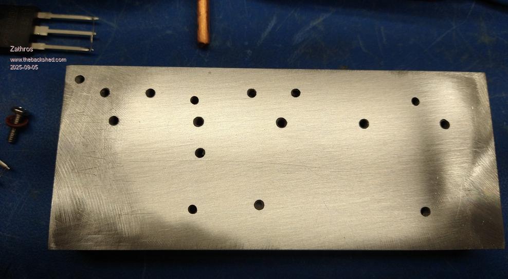

The test heatsink was prepared using a benchtop disk sander to remove the aluminum oxide layer and flatten the back. Final prep was hand sanding using 5" diameter 150 grit followed by 220 grit self adhesive sandpaper stuck to the top of the cast iron deck of the table saw.
The meter uses 4 wire clips so back side of the heatsink also needs to be preped in 2 spots where the meter will be connected.

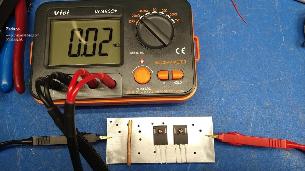

For checking the meter connection to the heatsink the clips are connected to opposite ends of the heatsink.

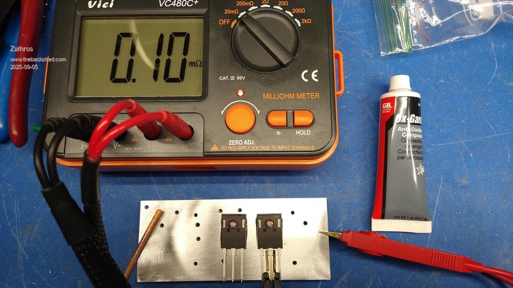

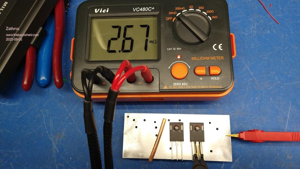

The drain to heatsink resistance was measured with 1 lead cliped to the heatsink and the other lead clipped to the drain lead at the MOSFET body.
MOSFET #1
MOSFET #2

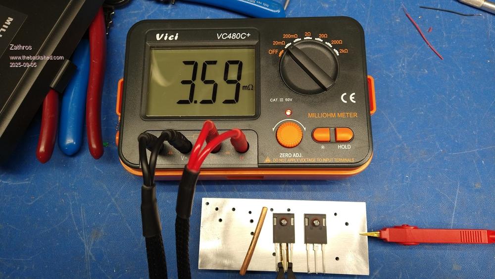

Compound was applied between the MOSFETs and heatsink the same way heatsink compound is used.
MOSFET #1 with compound
MOSFET #2 with compound

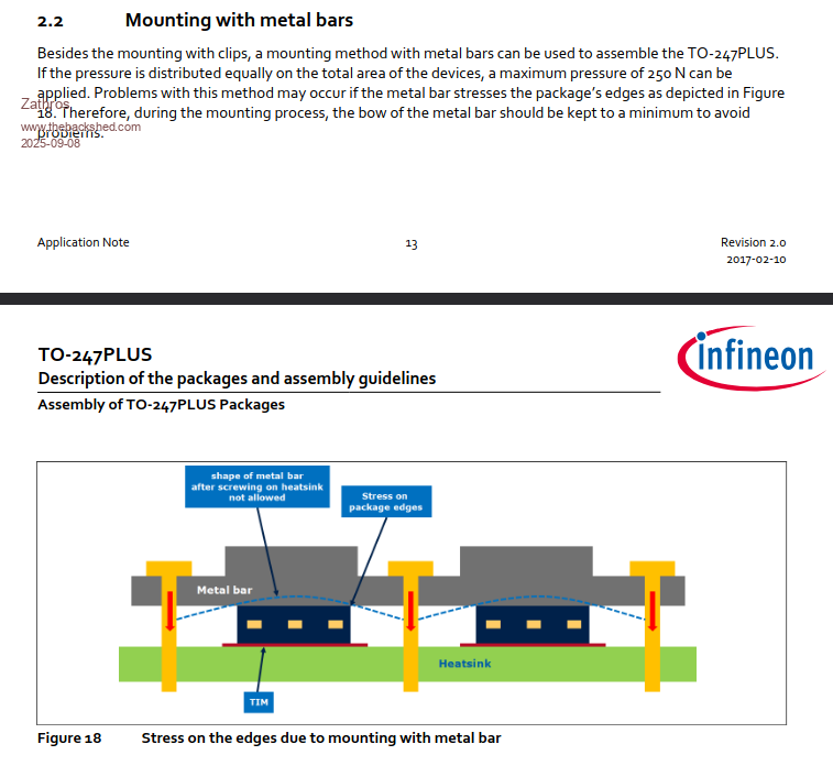

  analog8484 said
That should help but I think bar clamps that are wide enough to cover most of the MOSFET package and centered across the package would provide even more balanced pressure.
Yes, bar clamps work great. Good choice while designing, but can be difficule to retrofit.
Great information in the
Infineon Application Note AN2017-01
Excerpt from AN2017-01:
