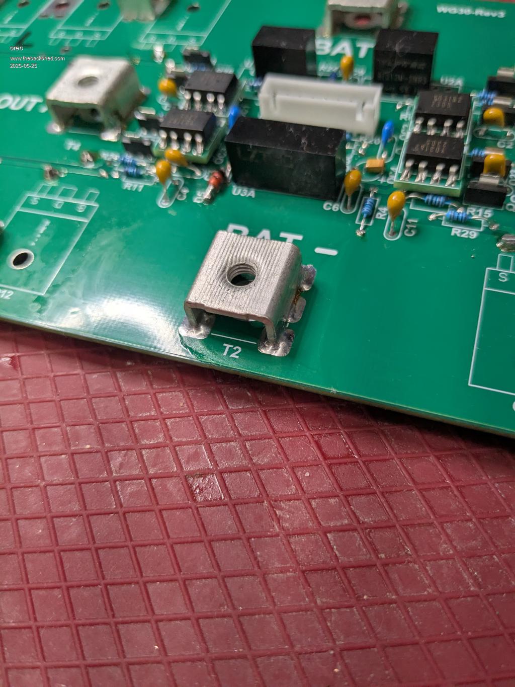

I am currently using a Hakko FX-888D which I upgraded to a couple of years ago.  It does not heat up nearly as quickly as the T12 system does, but I like that the larger tips (5.2mm) will solder heavy parts pretty well.  When soldering the 130A terminals on the Wizeguy power board, the FX-888D (65w) performed far better than my wife's Weller W100P (100w) iron that has a giant tip and is used for stained glass.
If I ever need to upgrade again, I will need to consider some of these other options.
