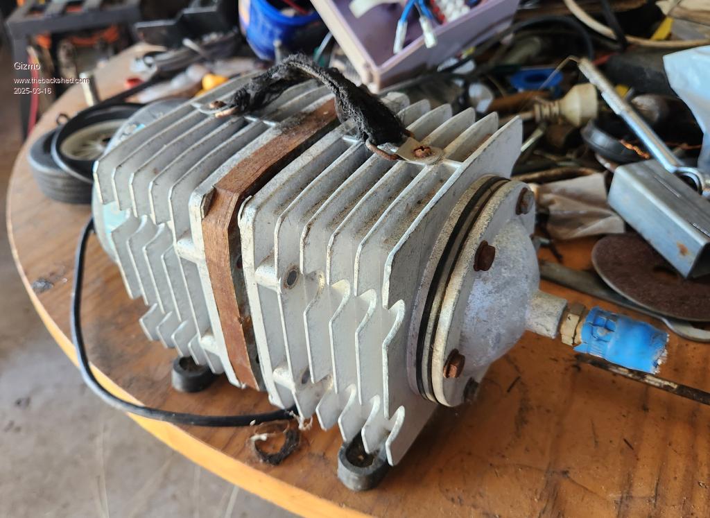

I picked up a little air pump the other day. I didn't really need it, but it was cheap. Yes, I horde.
Powered it up, and it went for about 5 seconds, then my inverter shut down with a fault. I'm off grid, everything runs of a Latronics 5kw inverter.

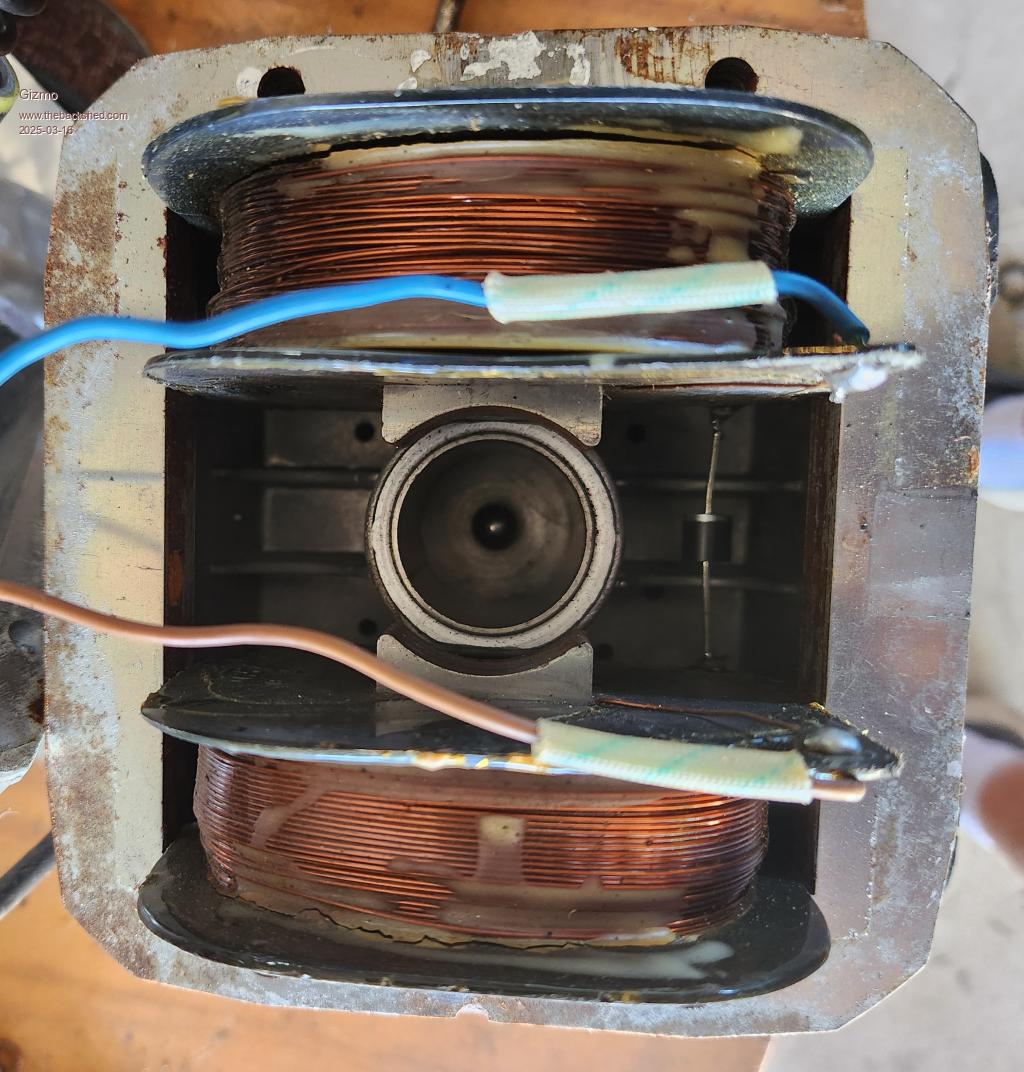

Back to the air pump. I pulled it apart, and bingo, there's a diode in there. But why? I'm tempted to short it out and see how the pump runs. I guess it will be twice as fast, maybe overheat, not sure, so thought I would ask if anyone knew any more about these air pumps.

My guess it is really a 110V model modified for 240V.
If you have a variac or suitable transformer you could try it without the diode.

I have 1 of those, they don't run at all without the diode, had to repair it and it had aluminium wire that got damp and rotted.
I think it is half speed with diode and one direction? cant confirm as its in bits somewhere
Pretty sure there was a spring at the other end, The HF inverter ran one of these pumps for years no problems, but the inverter didn't run the heat gun on low.

Try shorting the diods, but I suspect as you said Revlac it wont run properly. I might also try a full wave bridge rectifier, so it will get 100 pulses a second instead of 50. That may be to fast, the armature is to heavy and it wont pump properly, but at least the inverter will be happy.

Perhaps tape a temp. sensor on a field coil (assuming there is a way to get the wire out) before trying a full wave bridge rectifier. If it gets too hot some voltage reduction may be needed.
