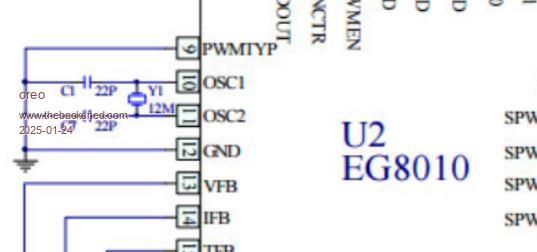

So I have been running an EG8010 based inverter for awhile now, and recently connected a circuit which has a clock on it.  The clock was running quite fast, so I compared the frequency of the inverter to the mains and found:
Mains:  59.98Hz
Inverter: 60.18Hz
This would suggest a crystal accuracy of 3000 PPM. Looking at the board, I can see the 2 capacitors connected to the crystal are present.

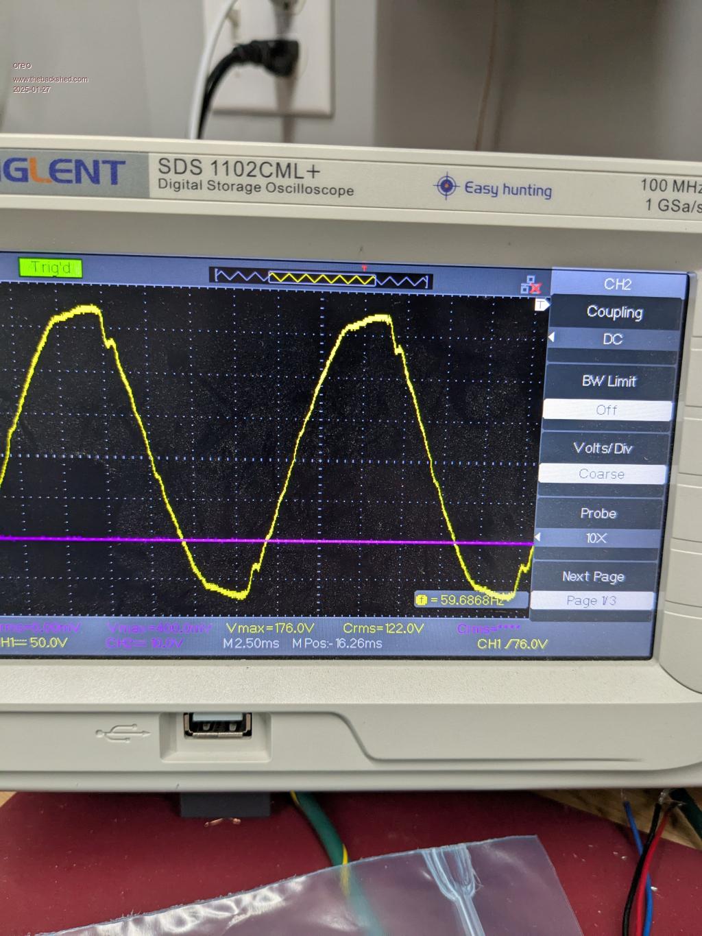

My inverter output waveform can look really good depending on the load.  Here is it with the microwave and furnace on.  This is about as bad as I have seen it get.
Note that the frequency measured by the scope jumps between 59.686 and 60.686 hz (2 values).
I think I will monitor the clock error for a longer period.

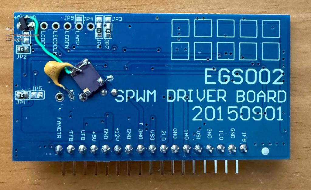

Resurrecting this thread as my inverter now powers my entire house loads with appliances that use power line frequency for Clock Displays and they all run too fast to be useful.
Using the SI5131A based oscillator board is too complicated for me, so hopefully there is a simpler solution.
I am still puzzled since the EGS002 uses 12.000 MHz crystal which is an integer multiple of 60Hz or 50Hz.
For base line, I want to know actual grid power line frequency. Since I don't have a frequency counter, I used an arduino/code and and a 6vac step down transformer feeding it through a 10K series resistor, maybe this is good enough. In the serial output, first column is the timer/counter1 value at the rising portion of the sine wave. second column is the resulting calculated ~60Hz. Jitter in values is probably due to time jitter between rising portions of the clamped sinewave. Still readings are close to 60Hz.
I thought that the chinese made crystal on the EGS002 is not precise enough. But I replaced it with crystals from different manufacturers ordered from mouser and still the 60Hz is too high. Below is the result when the arduino/code was fed by 1LO of the EGS002 through a 10K series resistor.
Edited 2026-02-15 09:51 by tinyt

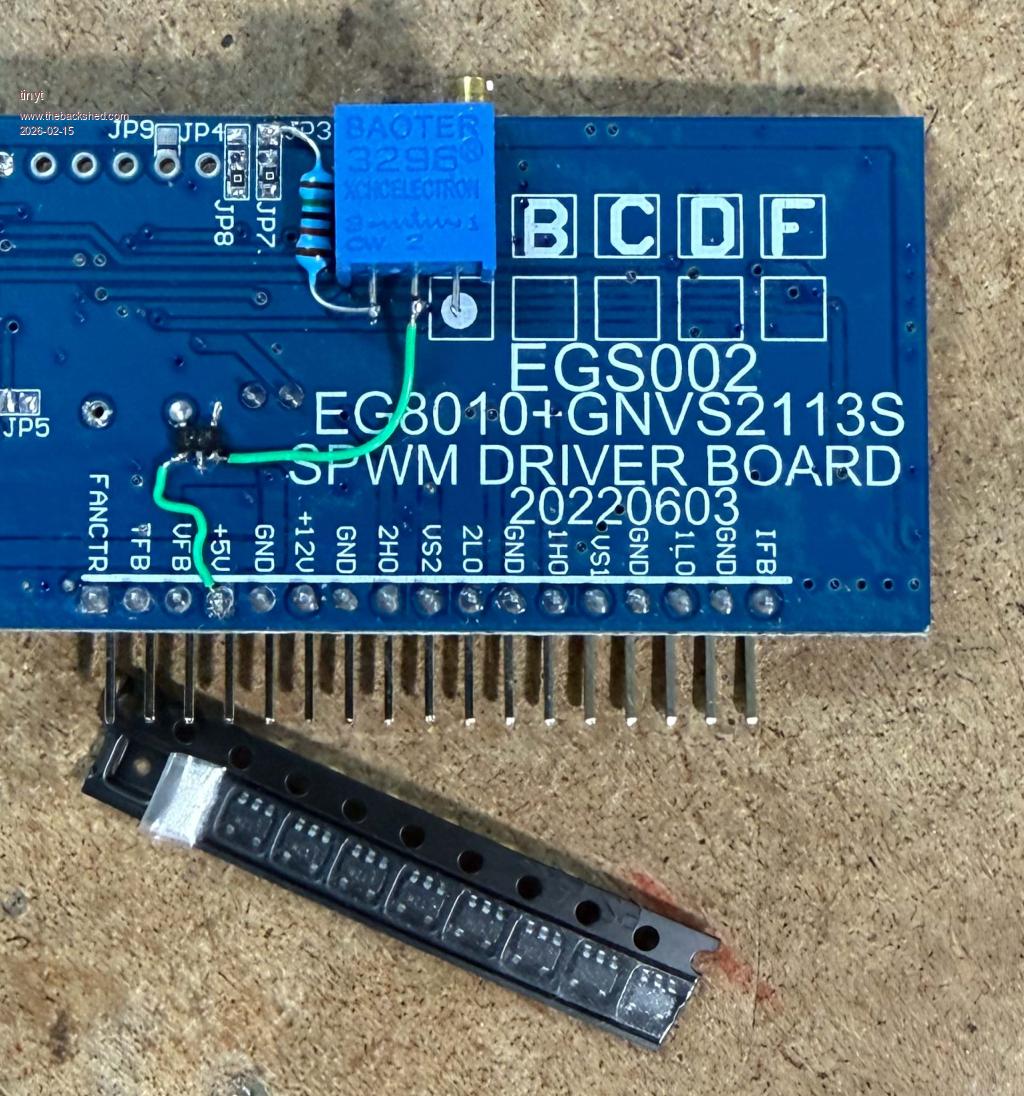

Still too complicated. This one needs only three or two components.

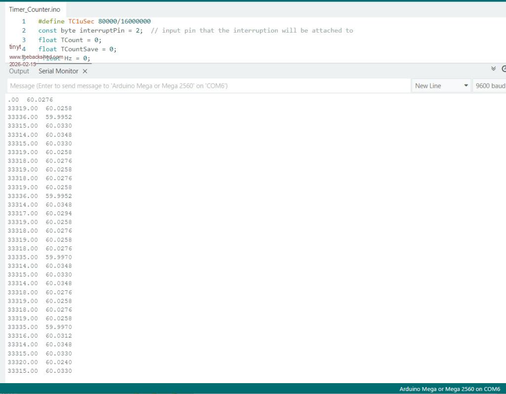

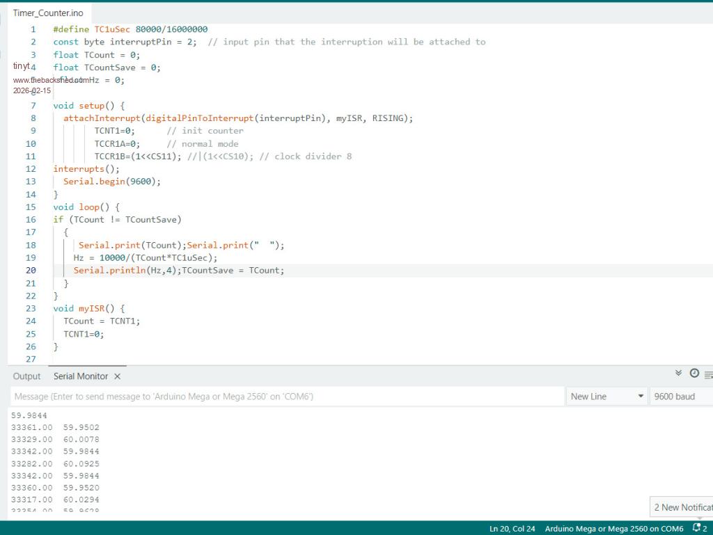

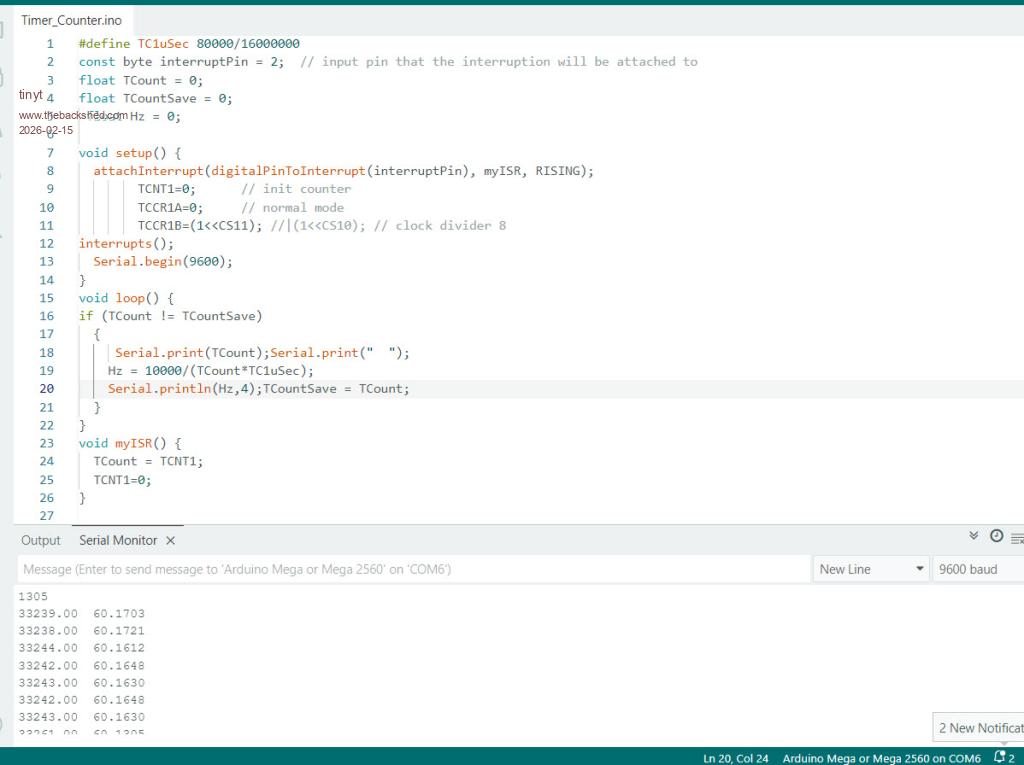

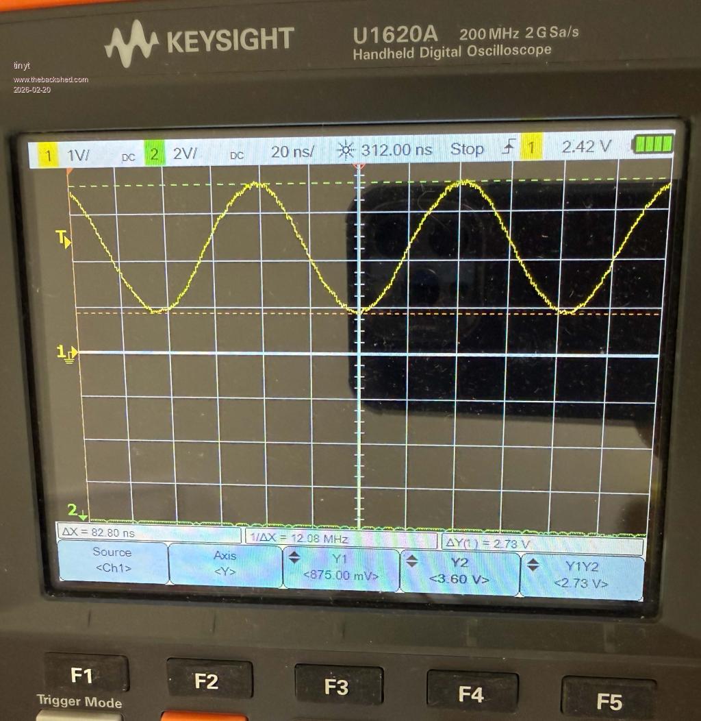

I removed the existing crystal, connected the LTC6900 output to the OSC1 input of the EG8010. (I lost 1 LTC6900 because I sneezed when I was trying to solder it).
According to the LTC6900 data sheet, the resistor value for 12 MHz is 12.5k ohms if my calculation is correct. So I used a fixed 10k resistor and a 5K trimpot. But the resulting 1LO frequency is 71Hz to ~90 Hz with trimpot adjustment.
So, I changed the fixed 10k to 15k.

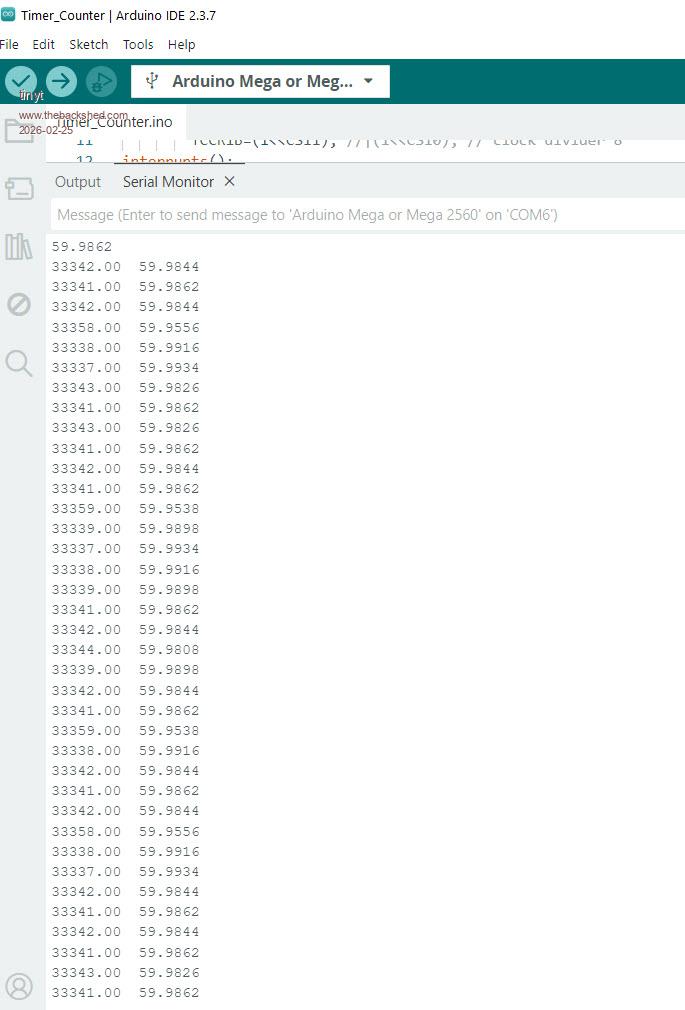

Here is the arduino/code report. Will continue testing how much it drifts. But looks promising.

Posted: 04:59am 15 Feb 2026
Update:
Frequency(60.0x) did not change much at room temperature for about 2 hours.
So, I used a hair dryer and blew hot air to it and frequency increased to 60.27x.
Frequency went back to 60.0x when it cooled back to room temperature.
The 5K trimpot has its wiper set for 1.46k to get 60Hz. I think I can change it to 2K for finer adjustment with the same number of maximum turns.
The LTC6900 has a TCR of +/-40ppm/C. I don't know the TCRs of the fixed resistor and trimpot. The LTC6900 data sheet recommends using precision metal film resistor for stability.
From mouser, I found these 15k fixed metal film resistors.
YR1B15KCC   +/-15ppm/C  $0.58
PTF5615K000BYEB +/-10ppm/C $5.52
PTF5615K000BZEK  +/-5ppm/C  $7.53
And a 2k Bourns trimpot with a TCR of +/-150ppm/C. So if I use this and the PTF5615K000BZEK  +/-5ppm/C fixed resistor, the trimpot's contribution to total resistance TCR is roughly 10%, I think.
I will also add an on board 5vdc regulator instead of relying on the power board 5vdc supply. This way this modified EGS002 can be swapped between the 3 inverters without re-adjusting the trimpot. But it is another TCR to consider.
It is now more complicated, but everything can still fit on board. But I think this is the best I can do using this device.
Edited 2026-02-15 15:05 by tinyt

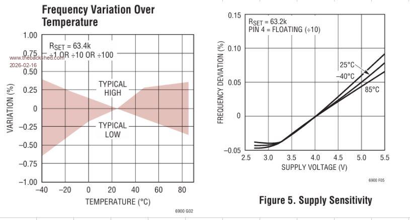

Looking at the LTC6900 datasheet:
I am not understanding the datasheet, since the temp drift spec is typical .004%/C but the graph is showing double that.
Also it seems the device prefers to run on 4v, but that is only introducing .01% deviation over 60C change.
