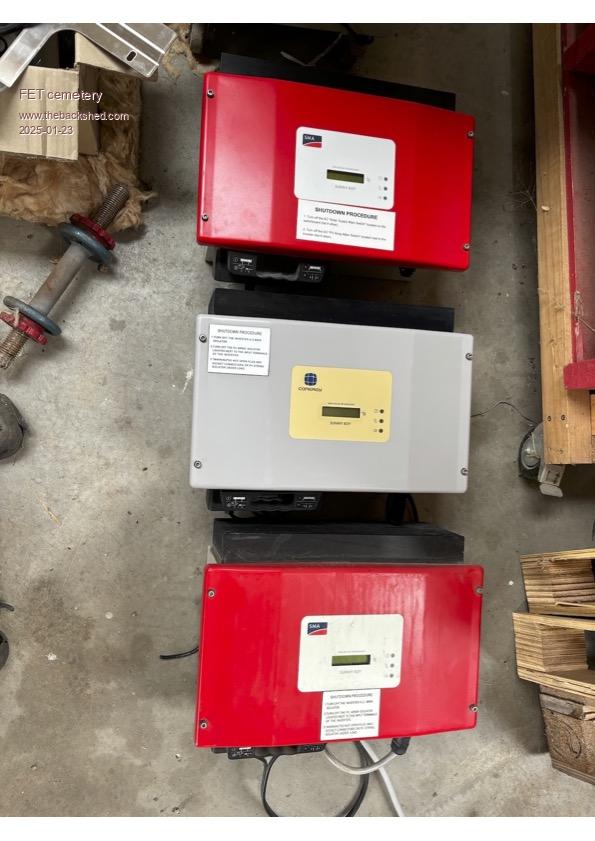

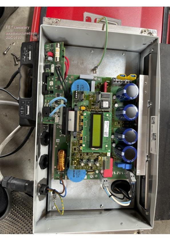

SB1700's.
Lots of goodies inside, not least the heatsinks which will be perfect once I get around to building the Wiseguy boards.

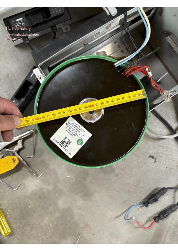

Got to the transformers and oops.... They're all completely potted in some sort of epoxy with a plastic case. I may have said some bad words.
The transformers have 93V secondaries like KeepIS had, but I don't think they're exactly the same.

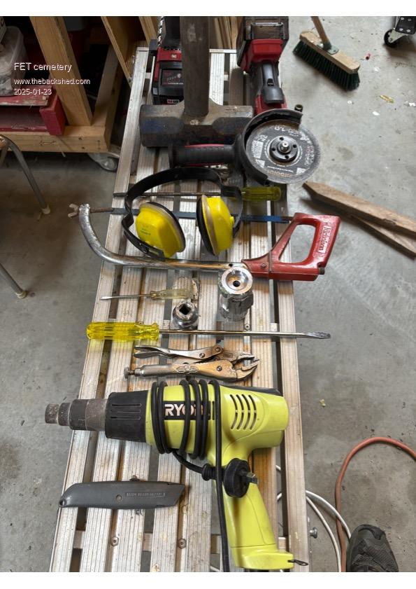

These are some of the weapons I used to liberate the inner toroids. It's not power electronics without power toools after all is it!

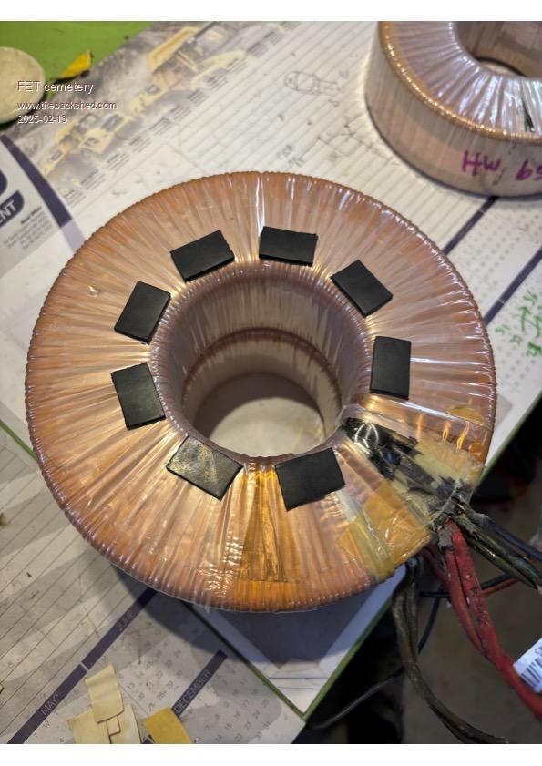

The method used was to cut the green plastic with a butane soldering iron and heat it gently with a heat gun until it just peeled off, in a well ventilated area of course.
Next, I drilled multiple holes next to the aluminium spindle with an old 8mm drill bit, wiggling it around until the spindle was loose enough to tap out with a hammer.
Then it was a simple matter of brute force unwinding the 240V outer winding, dragging it through the epoxy and occasionally using a chisel or some heat when the going got tough. This was hard work, took a couple of hours per transformer and I could only manage an hour or so a day.

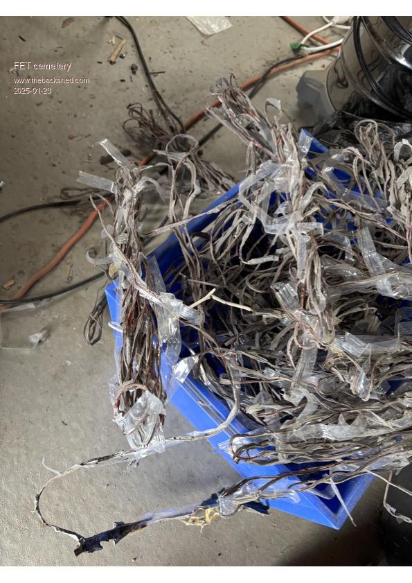

There was a few kilos of unsalvageable copper

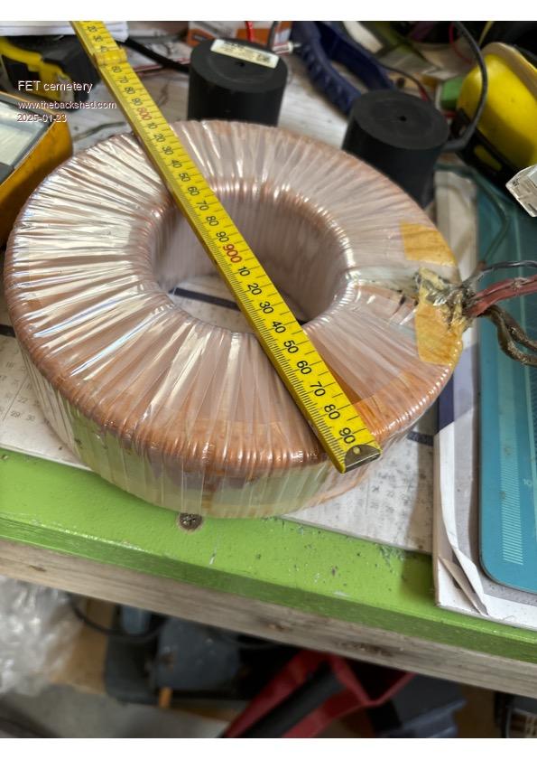

And finally the prize.
The 93V winding is actually two separate windings in parallel.
No stone unturned, no FET unburned.

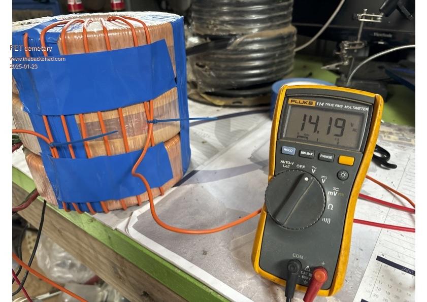

Well I eventually got the three out, wired them together, wound a 7 turn test coil and fed 240V into the assembly - through an old 60W incandescent globe at first just in case.
You can see the reel of 64mm cable in the background which is what the primary is now wound with.
Fed it through an ac power meter, showed it drawing 19W unloaded which I guess is the baseline magnetising power. Impressive for 30+ kilos of core.
To be continued, I'm a bit time poor at the moment.

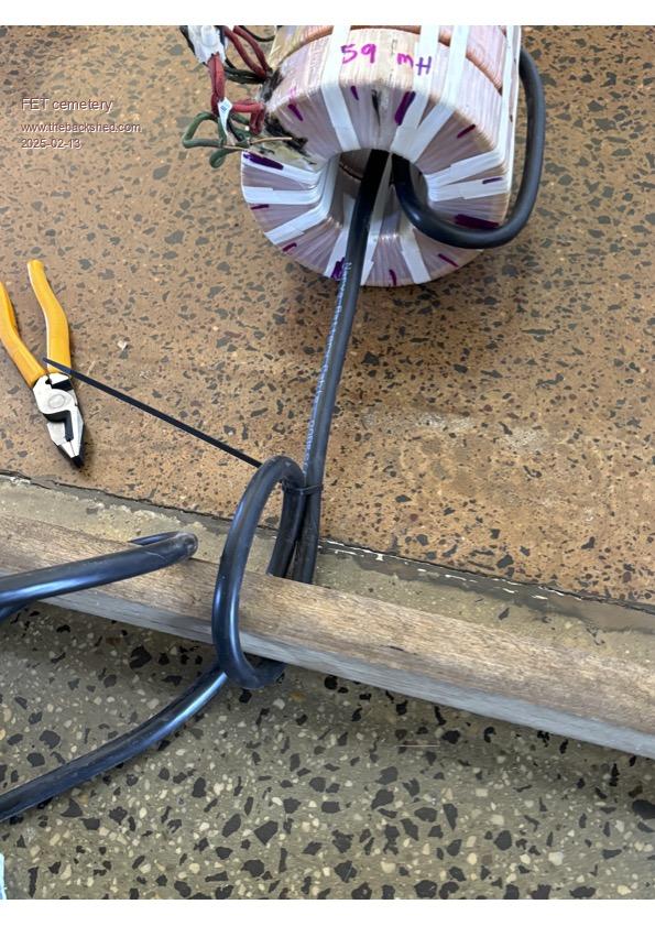

Well this is where it got a bit confusing for me.
So the idea is, after the dismantling you're left with 3 toroids each with a 93V winding. Stack them, join the windings in series and wind a new primary around the whole assembly appropriate for the voltage of the inverter you're building. 93 x 3 = 279, de-rate it a bit and you've got a ready made 240V secondary. The no-dig garden bed of transformers.
Feeding 240V in to this assembly I expected each winding to have 80V across it but no, one had 91V, one was 85V and the one in the middle was at 64V. Wondering if this was the flux in the outer two affecting the middle one I changed their positions in the stack. With the one in the middle now on top it still showed 64V. What was going on?
Out with the trusty digitech induction meter. Two of the toroids showed 59 and 53mH, close enough, but the one with the low voltage was only 28mH. Pretty much half.
As far as I can tell these are identical machine-wound transformers.
Multiple sanity checks of my wiring confirmed that I hadn't done anything stupid.
All I can think of is that the cores are from different batches of metal. I'm open to suggestions here, this has me puzzled.
Jumping ahead a bit here, with a primary wound and the transformer working in an inverter, the same discrepancy is there at no load. As I had suspected (hoped?), increasing the load on the inverter reduces the voltage difference.
At 4kW output there's only a couple of volts in it.
Running at that output for several hours the thing gets warm, but evenly. No hot spots that can't be accounted for by airflow / convection, all three toroids at about the same temperature.
A good outcome, but still a bit puzzling.

  FET cemetery said  I'm kicking myself a bit for not looking in to this a bit more before the transformer was assembled. Pushing the primary wires aside I can get to about 5cm of the inner winding, counting turns gives 23 on each core over this length, identical.
All the transformers had identical labels, primary 93V 50/60Hz secondary 230V 7A.
Wire diameter is about 2.1mm, 2.15mm with the enamel on, giving a bit more than 6mm sq total cross section of the 2 windings if my maths is right. My gut feeling is that this monster is capable of 7 or 8kW continuous with forced ventilation.
It will do 4.3kW all day at 35 degrees C ambient temperature with a fan running half speed drawing air up the middle.
Those are slightly higher power Toriod windings compared to mine, I have thicker single layer windings of 118 turns on each Toroid, when stacked and wired in series, I have 14 turns of 2AWG cable rated at 188A continuous through each 3 stack toroid, there are two of these 3 stack toroids in the inverter.
I can confirm that when running at just under 9kW (4.5kW each toroid stack) the toriods hold around 38°C with silent slightly enhanced convection airflow, the Fans switch to full airflow when either toriod reaches 40°C, they have only come on a few times but don't run for long, they quickly cool to 36°C, the 2 Toroids and 4 chokes have never felt more than "slightly" warm to touch. BTW the fans on full are almost inaudible.
Everything else is always around room temperature. It's a beast

On with the show, time flies!
I found some adhesive backed neoprene from a long-forgotten project, cut it into rectangles and used it to keep a bit of a gap between the windings on the adjacent cores.
The only thing I actually purchased new was some high temperature thermosetting fibreglass electrical tape to hold the assembly together.
The primary is 12 turns of 00gauge 64mm cable rated at 370A. Bought a 30m roll of it at a clearing sale for $80, 15 years ago. Probably nearly that much per metre now.
Winding it was fun, took two of us. Rolled out 8m of cable, tied one end to a piece of timber placed across a door jamb and basically used brute force to get the windings as tight as possible.
