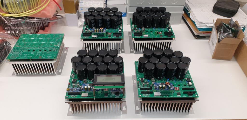

I also use the same supply on my MPPT controllers. I fitted plugs and sockets so they can be swapped out easily.
I managed to blow up a few early on until I learned you shouldn't power down an MPPT without first shutting off the solar input. I bought some of the regulator ICs off ebay and fixed them up. I know they're cheap and I have spares  ...  but I hate loose ends.

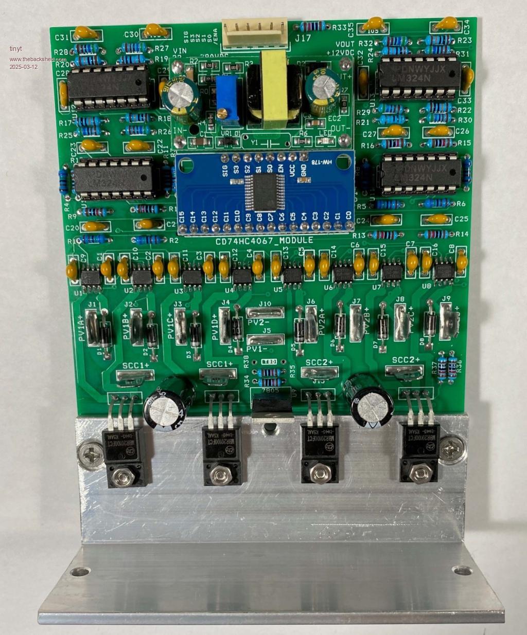

That is what I also use in my PV Combiner Monitor board (Solar array is 21 panels with VOC of 109 volts) for my latest 6KVA solar project. Running for two months now, so far no problem yet.
