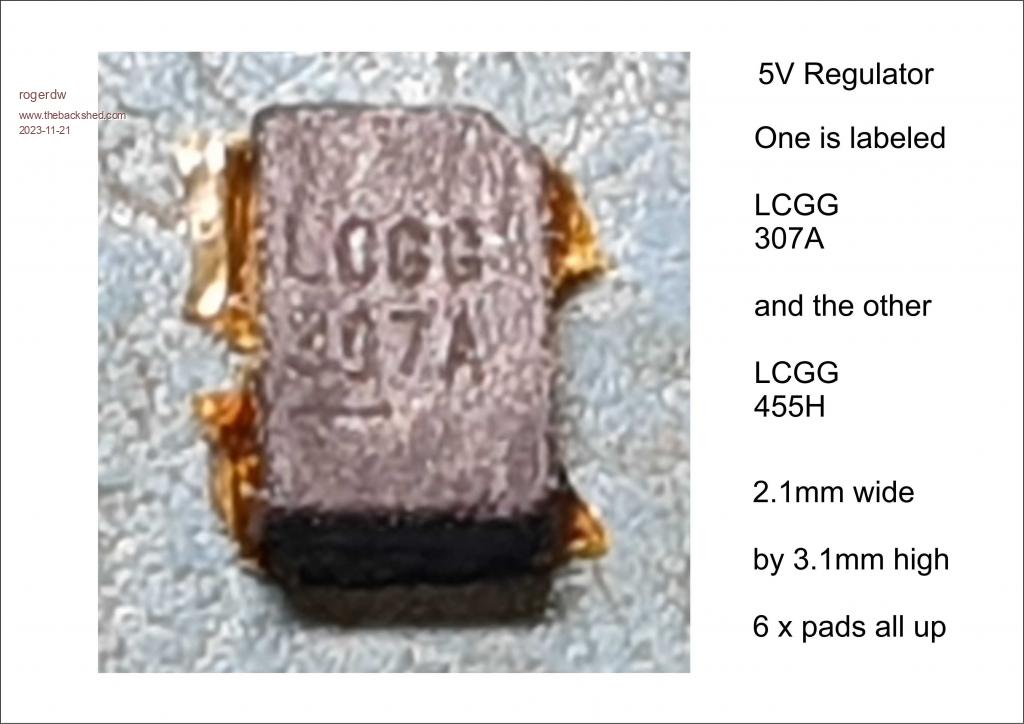

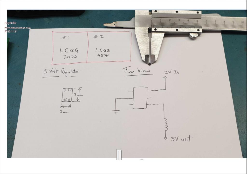

Hi guys, I'm trying to ID a 5V regulator and am not having any success.
It's only 2.1mm x 3.1mm and with 6 pads, no legs.
Thanks for any help
Cheers,  Roger

The codes on small SMD devices aren't always related to the type number. They can be a be anything a large customer wants them to be. The same type may have different codes for each customer.

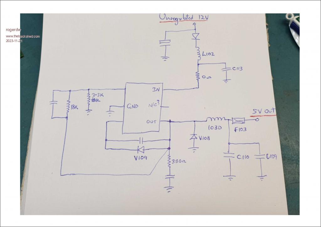

From your circuit it seems to be an adjustable switch-mode regulator.
The top left pin is the V-feedback pin and from the 18k / 3.3k divider its Vref is about 0.8V.
Do a search for any one with the same pin-out and rated for 15V or more.

Thanks Phil, I was a little surprised that I couldn't find any info, I usually can if I persevere.
I only drew out the full circuit after I'd given up looking through datasheets, so hadn't even considered that it might be a variable regulator. I was assuming it would be a 5V one. The board also has 3.3V one (similar but still a different type and size) which is supplied by the 5V line.
I ended up fitting one off another scrapped board, which fixed the problem, but I'd still like to keep some spares for future potential faults.
I'll check out some more datasheets this morning but this time I won't ignore the variable output ones. Thanks again.

I've realised I probably caused myself a heap of grief by assuming it was a set output regulator and ignoring the datasheets of all the variable ones. No wonder I couldn't find one with a pinout that looked similar.

Now you have it working, to be certain you are searching for one with the right Vref measure the feedback pin voltage.
When operating within normal limits it will be the same as Vref.

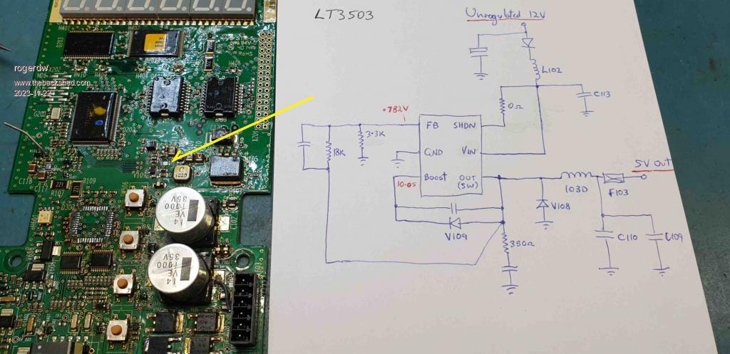

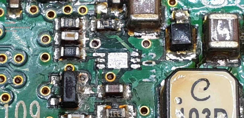

First off, Vref or FB measures .782v
I went through the list you supplied Mike and none showed the layout I thought I had, so I had a closer look and found that while I thought pin 6 was VIN it was actually pin 5  ...  and pin 6 (Shutdown) was tied to VIN via a zero ohm resistor because the function is not used.
So it looks like the LT3503 may be suitable as it also says it regulates its feedback pin to 780mV.
I corrected the circuit diagram and added a few details.
This all brings out the fact that even though I enjoy working on my own, having others around to bounce ideas off is probably the single biggest thing that I miss  ...  but after 35 years and getting close to retirement age  ...  it's probably not going to change any time soon.   Haha, actually I just hit retirement age today!!!

One more adjustment to your circuit diagram.
The 18k divider resistor and anode of V109 go to the load side of the output inductor, not the Out pin.

Thanks again Phil, I think I have it worked out now. It's a bit tricky trying to measure everything while still in circuit  ...  especially when there's a few coils and 0 ohm resistors involved.
Even worse is the rotten conformal coating which is almost impenetrable. I sometimes take to a board with a tiny engraving bit to be able to measure accurately  ...  and I have an old Polar device which measures very low ohms, but you still have to pay attention.
