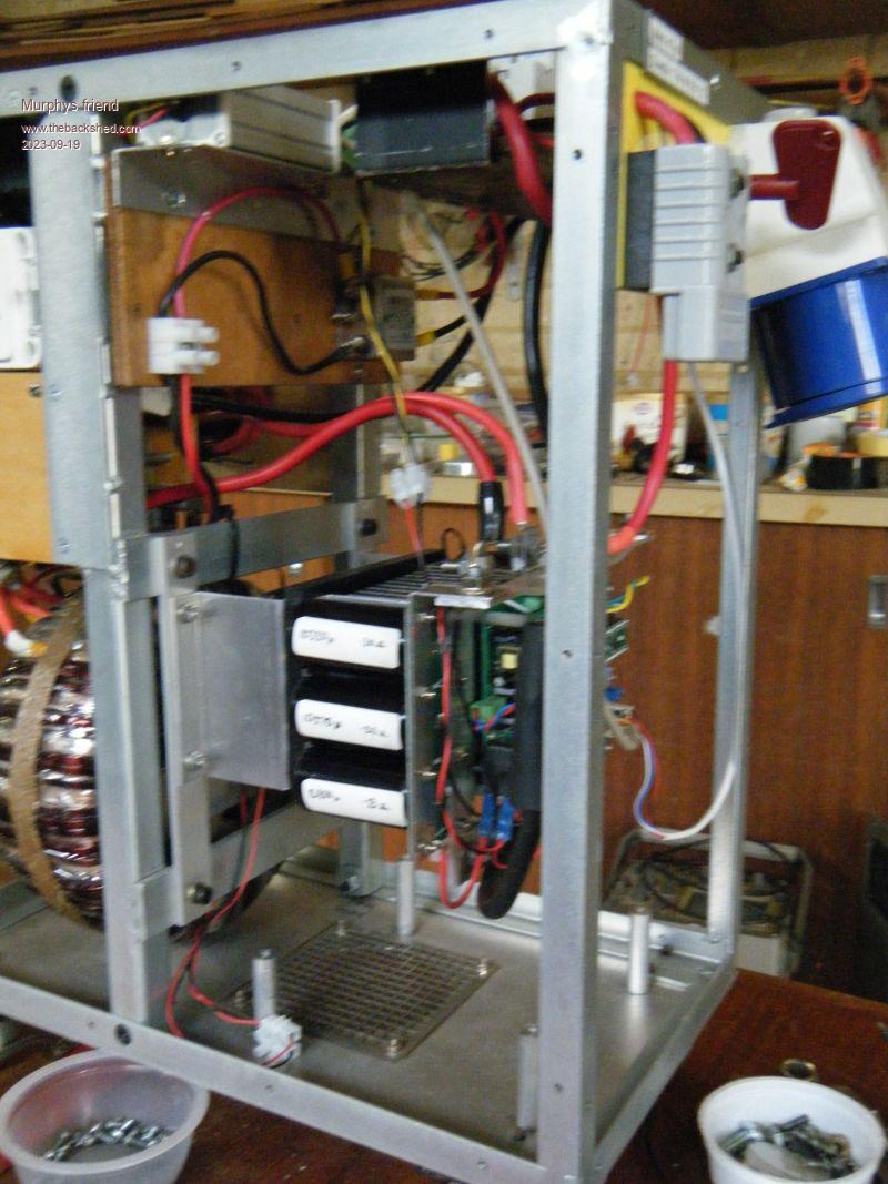

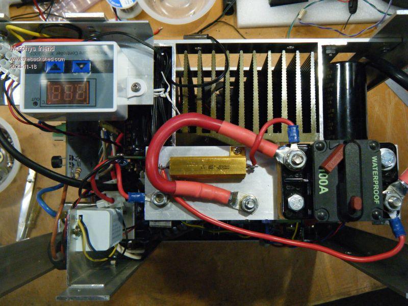

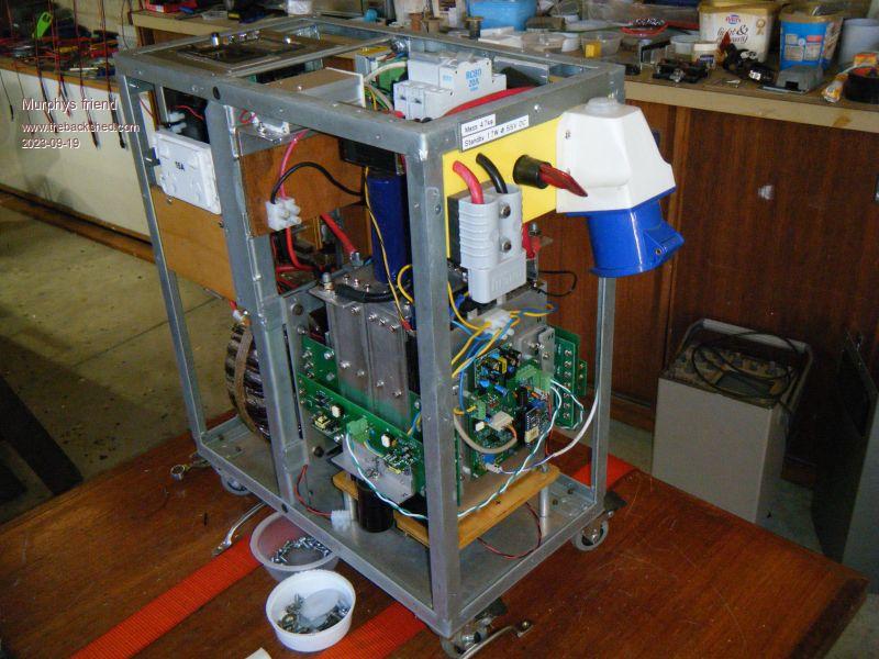

I used my 3KW inverter as a testbed, here is what it looked original:

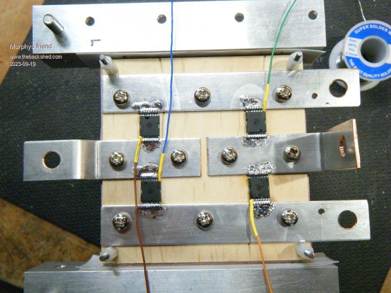

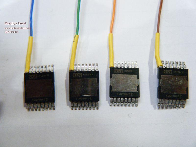

These mosfets have all drain pins on one side and the source plus gate on the other:
They were soldered upside down between 16 gauge copper strips:

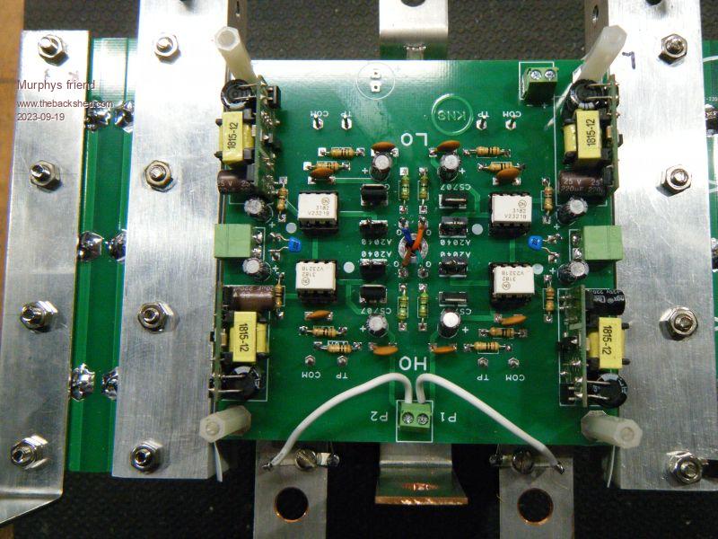

On top of that fits the driver board:

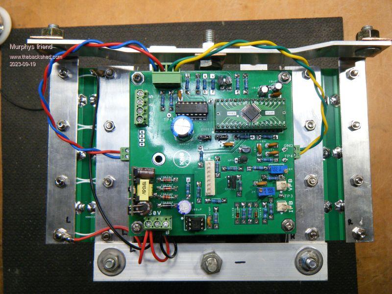

Followed by the control board:

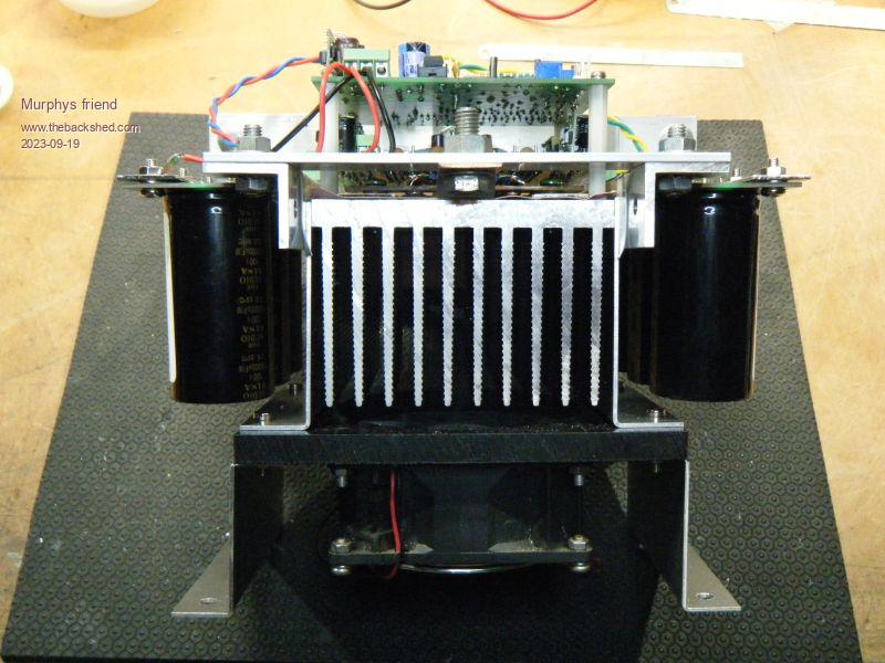

A side view of the power block:
All boards are 100 x 100mm BTW.
Ready for testing:

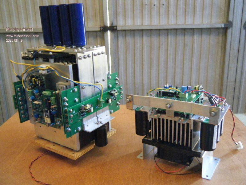

Comparing old and new size difference:
Lots of space in my inverter now:

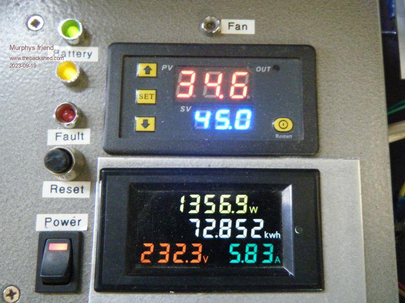

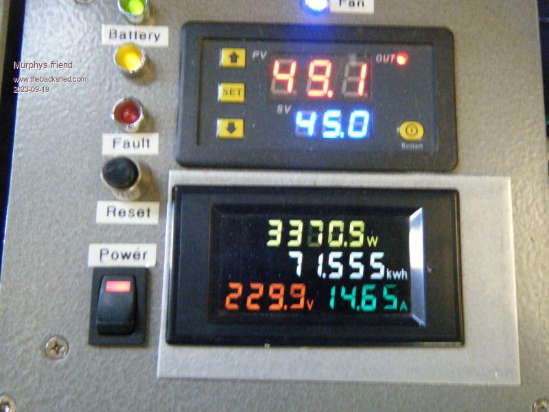

Now for some testing. I first tried powering it flat out, keeping in mind the inverter has a 3KW toroid transformer.
It handles that power easily:
Ambient temperature was 21 degrees C, the 90mm fan came on after about 10 min (at 50 deg. heat sink) and easily cooled the heatsink down to 45 degree from where it cycled then.
After 2 cycles I reduced power to:
A which the heatsink kept cooling, the temp. shown above is after one hour running. By this time the sun got too low to continue testing without draining my battery bank.
So, for my normal power use this small heat sink would be adequate, it appears. Summertime testing will confirm this.

Small question, I can't find the source wires, how did you connect those? If you run twisted wires from the driverboard straight to the mosfets you might improve the robustness even more.

Thanks, the source wires are the two white ones going to terminals labeled P1 & P2.

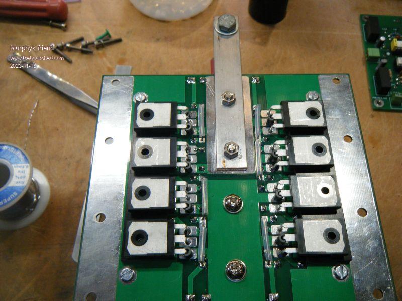

OK, time for an update of this project.

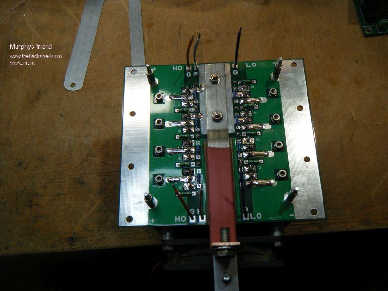

I borrowed a page out of Wiseguy's book and replaced those tiny SMD mosfets with (physically much more manageable) HY5608's.
8 of them were used for the full bridge. This is still for my new 24V caravan inverter.
It uses a re-cycled 1KW Latronics toroidal transformer, I left the original secondary in place.

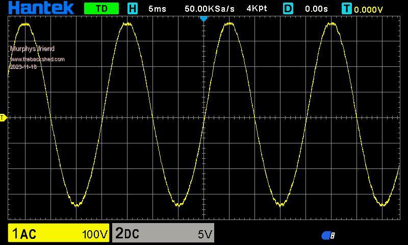

The inverter runs the EG8010 chip with its standard rectified AC (230 > 12V) reduced to 3 V for the VFB sampling input.

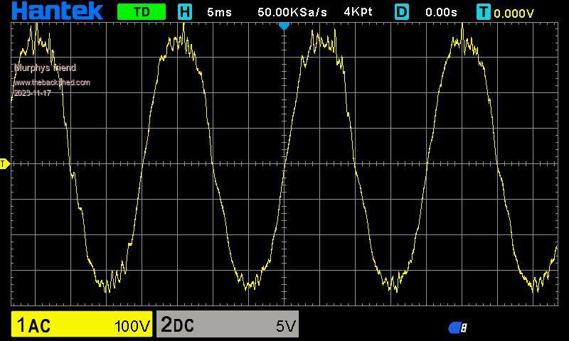

The AC waveforms are good, this is what 150W load looks like:
And this trace at 1100W load:

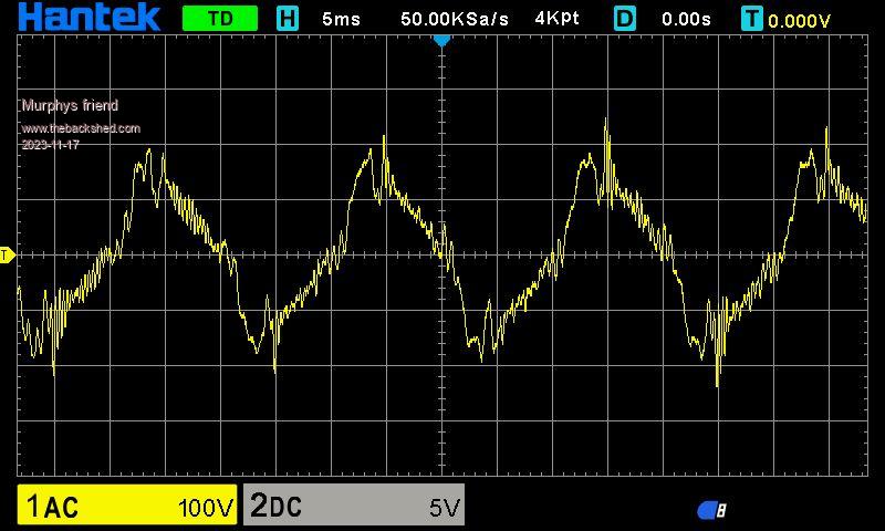

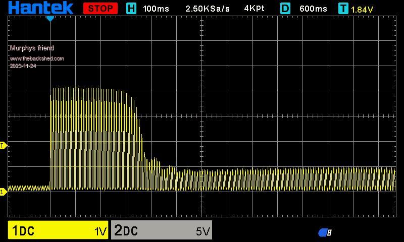

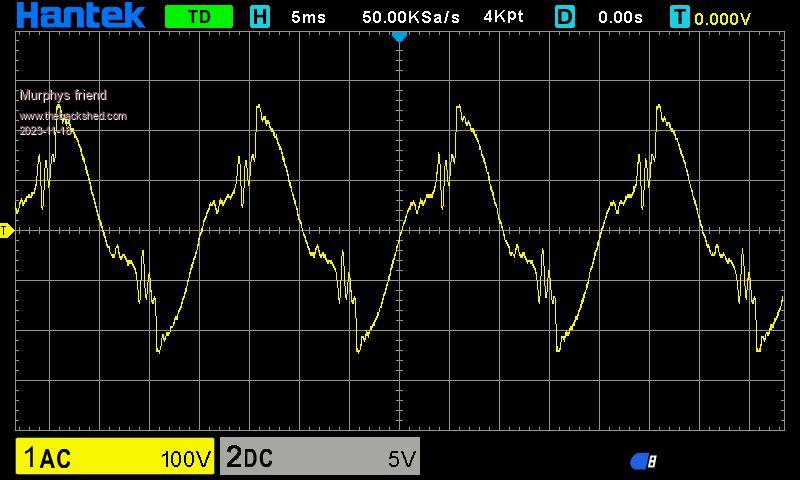

I then subjected this inverter to my chop saw test, this is rather severe for such a small transformer but everything survived the test multiple times.

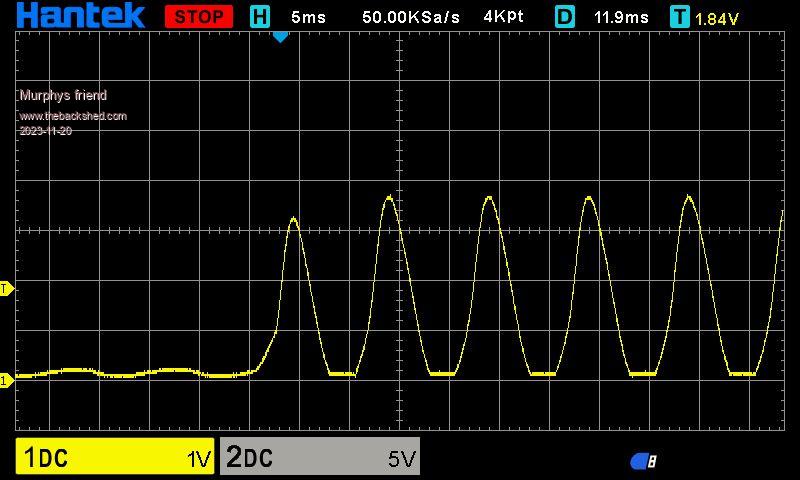

The start up wave form looks horrible but it *did* start up every time :

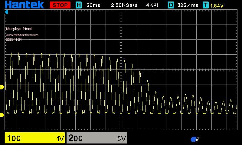

Once it was up to speed (but not cutting anything) I got this wave form:
I'm looking forward to your comments and will continue later to post some pictures of my new (downsized) caravan inverter.

Posted: 08:19am 17 Nov 2023
It looks like the last picture upload did malfunction, here is that picture:

Can you check the 12V out of the little transformer, to see if there is any deviation in voltage? might be hard to see, or its something else.
Cheers Aaron

Here is what my caravan aircon does to the inverter output.
First the startup wave form:
And when its running:
Murphy's friend

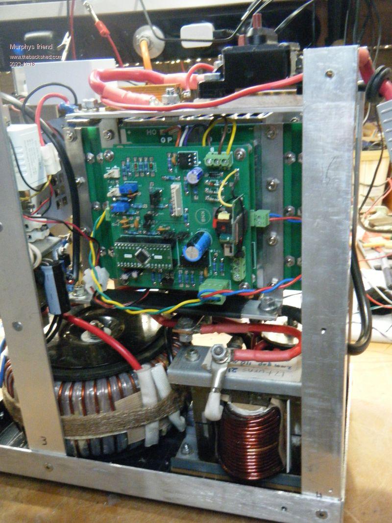

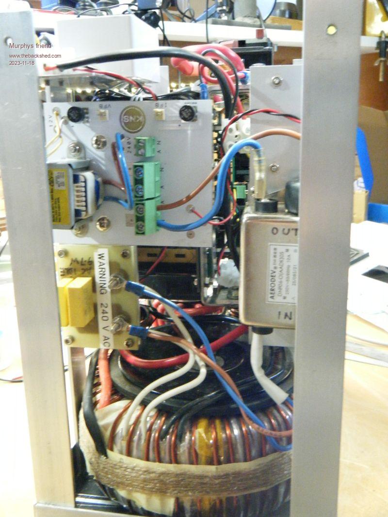

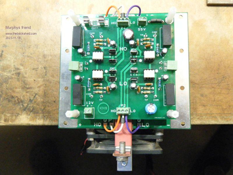

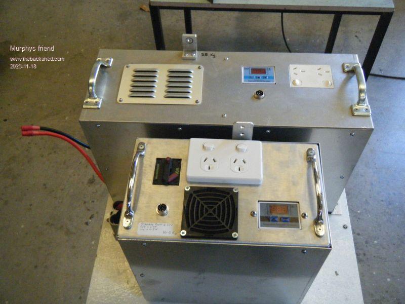

Now a few pictures, I have completely re built what is shown at the beginning of this thread. The idea was to have a smaller, lighter LF inverter for my van. The one I built some time ago works fine but due to its size and weight it was very difficult to insert/ extract from its tunnel boot home.
This is the power board underside, showing the 8 mosfets with ferrite beads on each leg that connects to the primary:
The top side of the power board:
And the driver board piggy back on top:
Then the control board piggy back on the lot:
Now a few pics of the build:
And the size difference of the old inverter behind the new inverter. The weight difference is 25kg reduced to 16.5kg:
