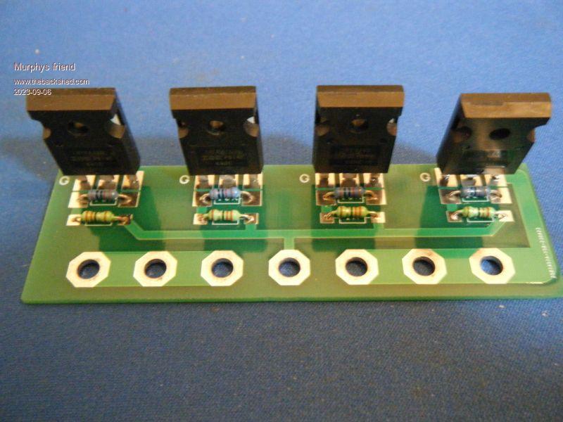

Here is how they look, there are four identical boards:
This board is fitted with IRFP4468PbF mosfets. All 4 boards test faultless when driven by a 20KHz, 50% duty cycle square wave. As load I used LED car brakelights with suitable dropping resistors so testing could be done at 55V DC.
