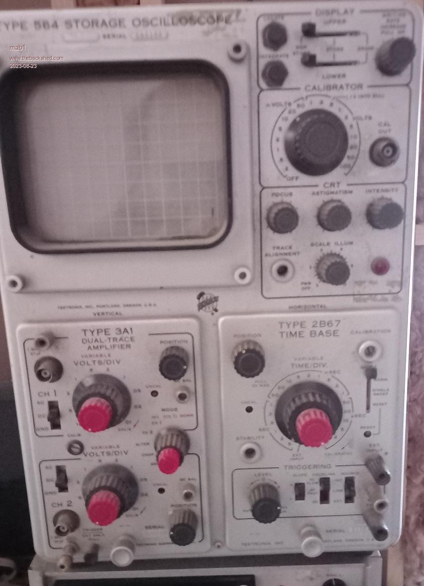

I have an old tektronix 564 storage oscilloscope, and the timebase plugin has stopped oscillating. This is the description of the fault -sorry if it's a bit long winded:-

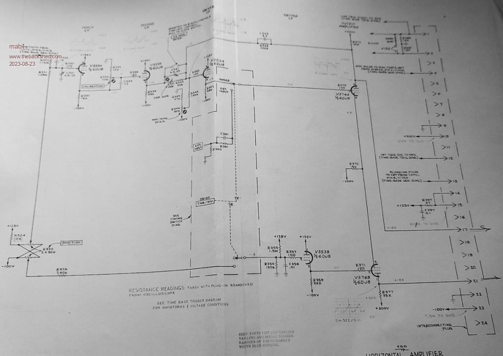

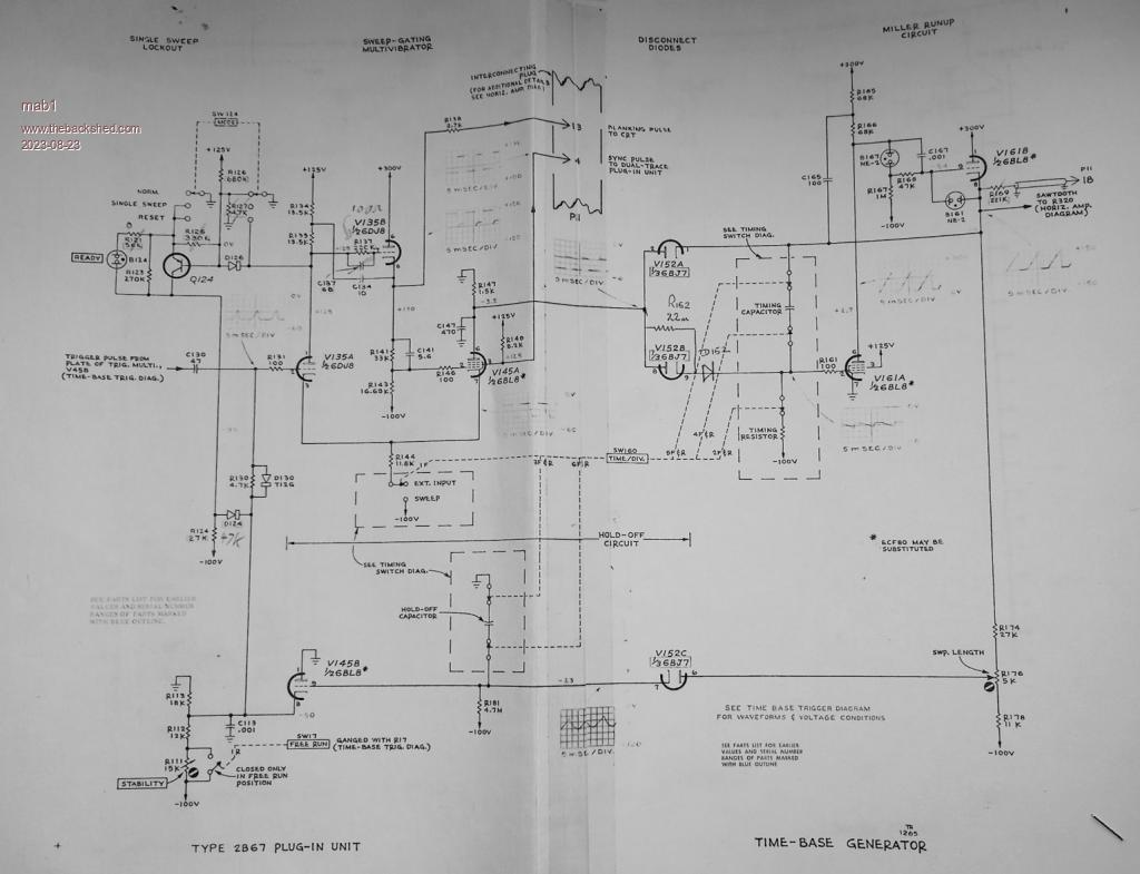

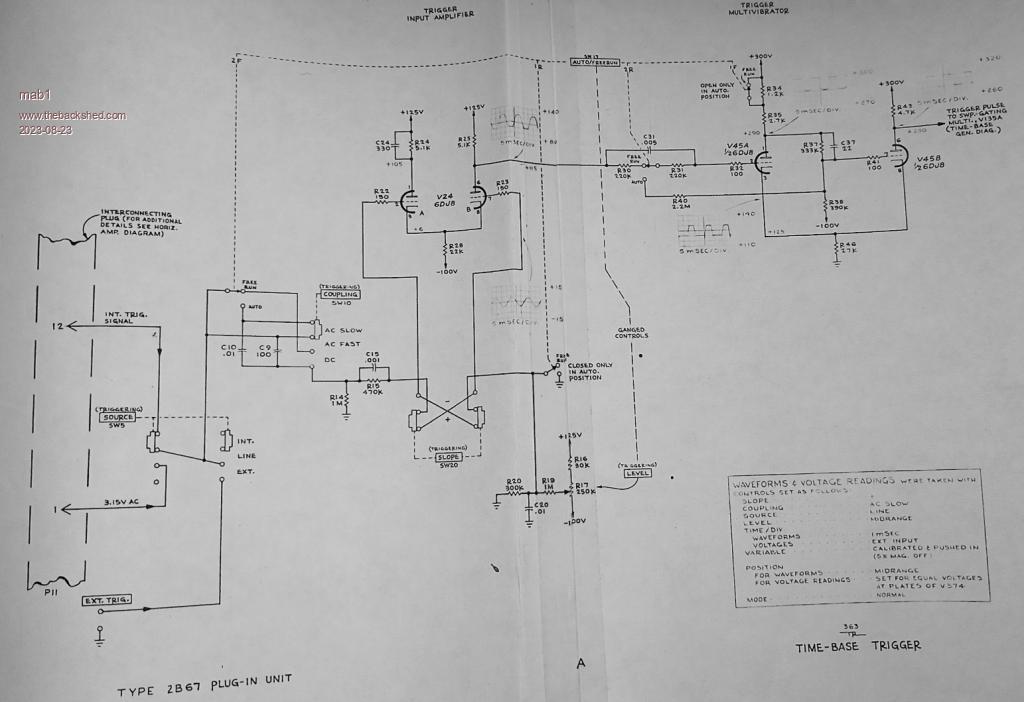

Here are 3 schematics
Output amp - I'm thinking this oart is working normally:
Trigger:
Timebase:
Hopefully i haven't made them unreadable  by downsizing.
I'm thinking that the trigger circuit should oscillate to drive the timebase?
But I'm not sure, hence i would appreciate any guidance on identifying the problem. Otherwise the only thing i can think of is to randomly swap valves around on the assumption one of them is faulty.

The schematic is almost difficult to read, but check first that voltage levels go to first two tubes, like -10 to +10V.
Measure the cathode of the second tube.
How it changes?
Then is the most interesting  two tubes.
They are used as an oscillator (which is not working).
Look that the DC level goes to first of the second tubes.
Then measure the anode voltage from the second tube.
How much is it?
And then use external capacitor, the same size than it should be and touch the old capacitor to the both ends.
It should start to oscillate.
If not, measure the backup capacitor and the parallel resistor.
This is my first advice .

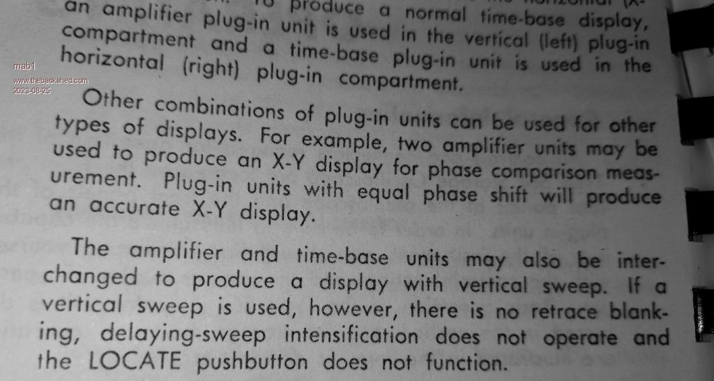

Just to be clear:- by the first two valves do you mean V24 A and B (trigger amp)? And 2nd two V45 A and B (trigger multivibrator)?
Do you know if it is acceptable to put the timebase plugin in to the left side (Y amp) side of the chassis?
That's the only way i can see to access the valve bases and associated components to measure voltages.

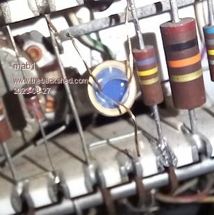

following Pekkas post i did try substitution of the 22pF C37 in the trigger multivibrator (my capacitance meter doesn't seem to work reliably at such low values, so i can't verify either the original or the replacement), but that hasn't worked.
I have tried reseating the valves, and i did replace a few resistors that were 'a bit high' at the start, so caps / or non-obvious valve issue are my prime focus now.

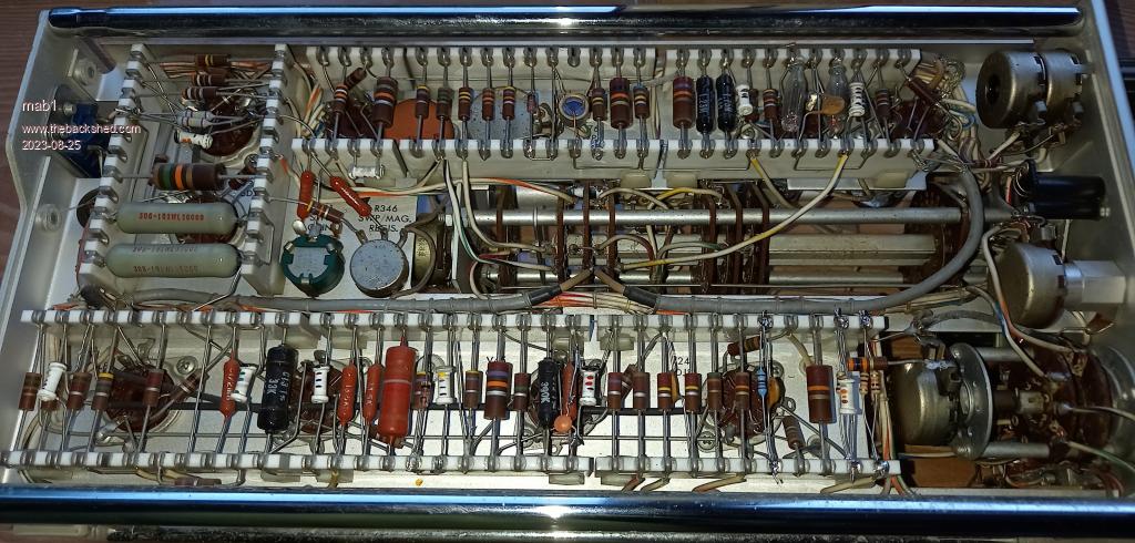

If it was a valve issue, I would expect the problem to ease as everything warmed up. However you say the longer the scope is on, the more you have to adjust the trigger control until you run out of adjustment. The symptom is typical of resistor drift due to heat. I would start with any of the older brown, rounded end resistors. These are a sponge with moisture. A picture of the component side of the module would be handy. Also, any of the old yellow wax capacitors (if fitted) would be the first things to replace. But a picture of the component side would help.

C37 22pF: my substitute is the small brown ceramic disk, approx centre on the lower tagstrip. The original is the cylindrical one alongside - it looks like it's still connected but thats just the pic.
Some good news: i found this in the manual for the mainframe:
So it looks like i can plug the timebase in on the left and probe the voltages on the components

There's nothing in the picture that screams "Change Me". Someones been in there before looking at the newer style resistors. The tubular ceramic cap's are normally very reliable. At least now you have access for voltage checking. A quick run around the tube pins should lead you in the right direction. Good luck   .
Pete'.

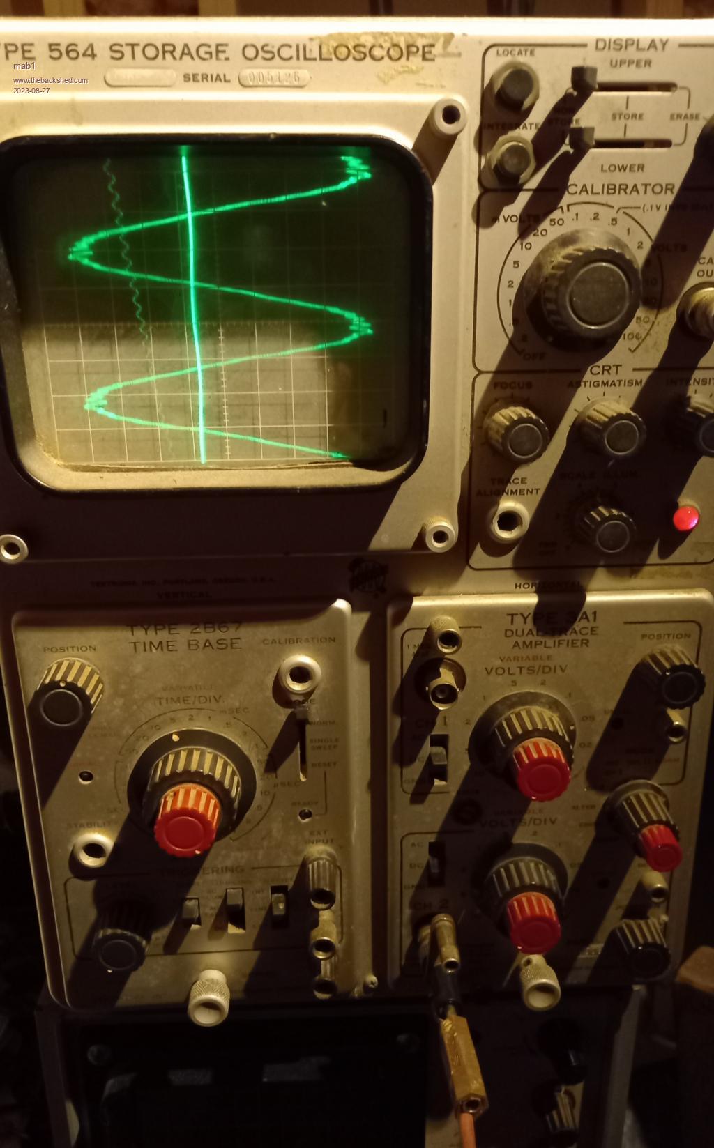

Posted: 10:27pm 26 Aug 2023
It's a GOAL!
Started testing static voltages, but the voltages i was seeing seemed reasonable and i didn't seem to be getting anywhere. So in the end i fired up the other valve scope and followed a trigger input signal until it stopped.
I do have a cheap Chinese pocket scope but it's only rated for 50vpp input.
The culprit: Q124 2N2043, the only transistor in the timebase, in the single sweep circuit. It seemed to check out with a diode test in circuit, but maybe i got b,c and e mixed up - i thought it was ok, but removing it from the circuit has got the timebase working.
Thanks for the contributions everyone,  got there in the end. Although i still don't understand valve circuits really

Thanks   , i've ordered a new transistor, the fact that its pnp (and germanium) probably helped confuse me when i was testing. As was the fact that this part of the timebase differs slightly from the schematic: the schematics are for a later serial no. than mine, and whilst the table of components does list the values for earlier units, when a resistor is ommited altogether it doesn't say wether its a link, or open cct - turns out it can be either.
