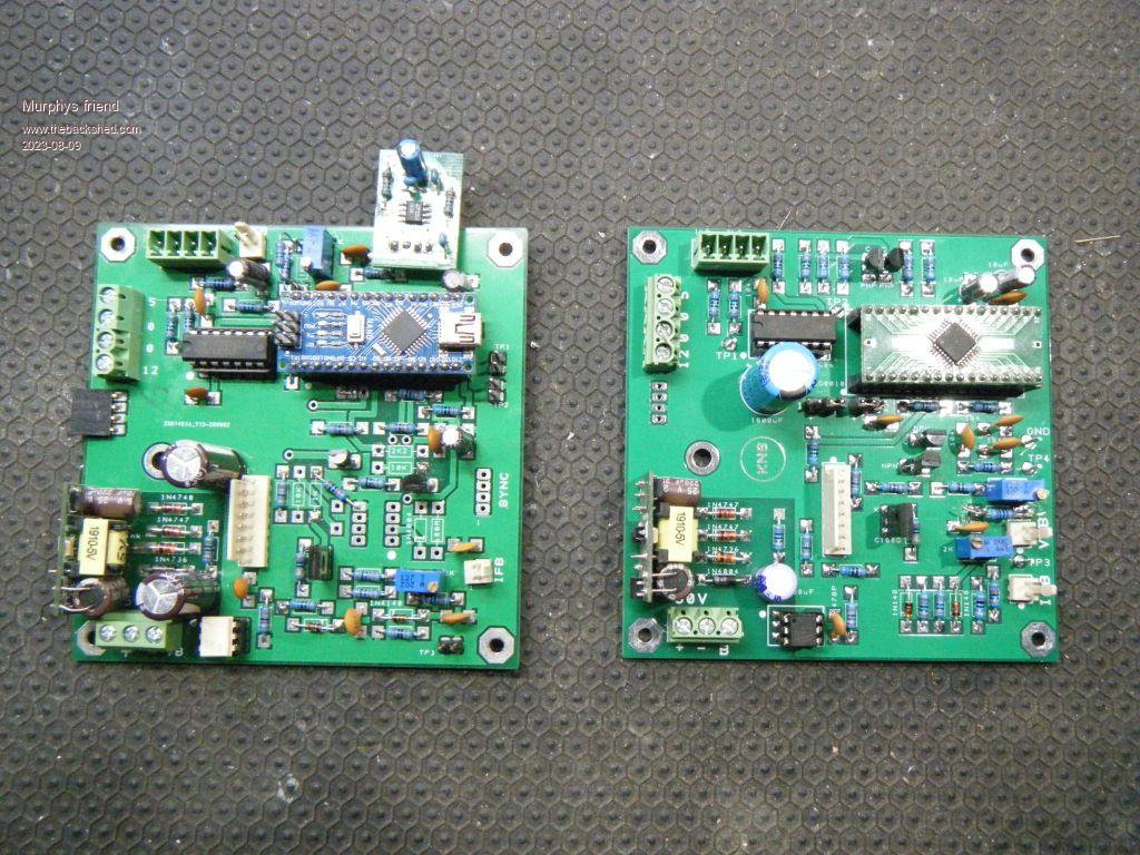

What else can I change? The original control board ran a EG8010 chip, the latest has a NANO with Poida's latest program.
What If I swap just the control boards, leaving the rest of the inverter and the voltage settings identical for this test?
So, Nano board, AC=230V, DC = 54.6V, power = 103W
EG8010 board, AC=230V, DC = 54.6V, power =120W
Well done Poida, your program beats the EG8010 by 17W in my inverter.

Thanks Mike, The EG8010 control board was made to wiseguy's schematic, minus the fancy shut off components. It runs well, nice AC sine wave but 120W idle.
The other control board uses the NANO with Poida's program, 103w idle. Also runs well with a nice sine wave AC.
Easy to swap boards.

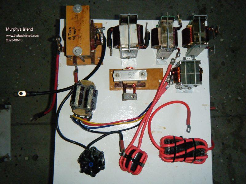

Have you checked your series inductor is ok? No shorted turns? Could explain the heatsinks running 'hot' if it's not doing its job.
Murphy's friend
Joined: 04/10/2019
Posts: 678
Posted: 03:33pm 09 Aug 2023
  mab1 said  Have you checked your series inductor is ok? No shorted turns? Could explain the heatsinks running 'hot' if it's not doing its job.
Yes I have, thanks.
There is quite a selection of chokes here, none improved standby power by much but does affect the sine trace.

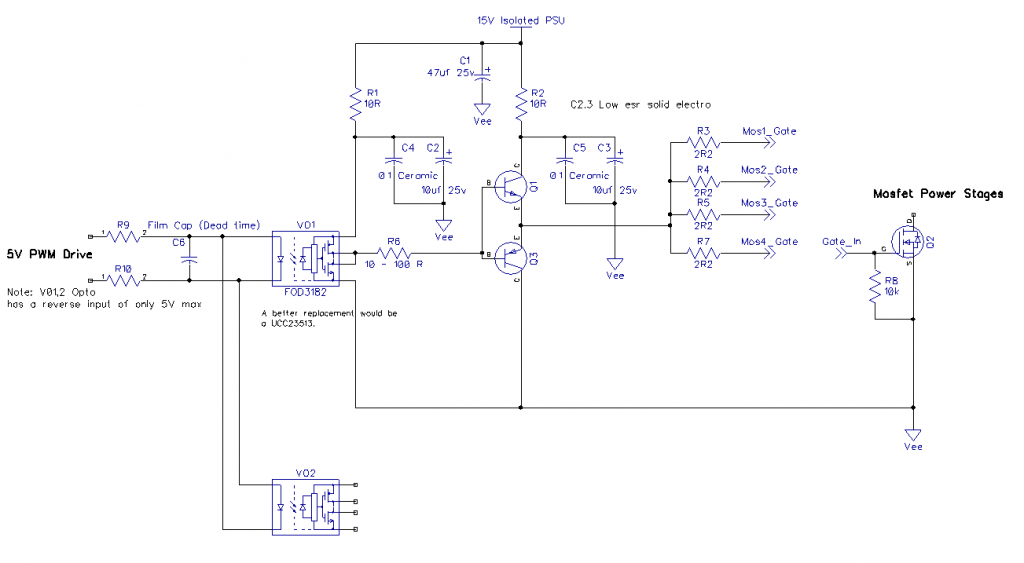

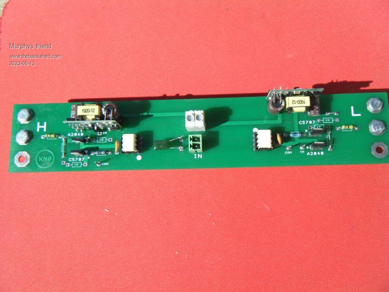

I'll answer wiseguy's last question first: 3.3uF

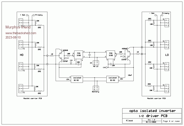

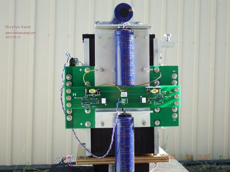

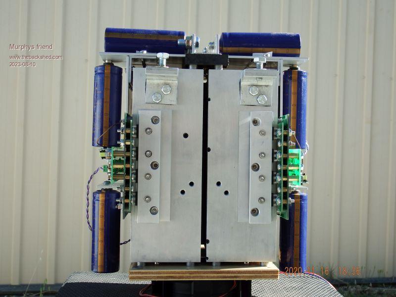

For the other questions pictures & schematics may be better than words, some of you may know that I build my inverters different to common all on one PCB layouts.
The above boards are situated around the heatsink corner from each other. The power board shows the mosfets (under the clamping bars) for 1/2 drive, the other 1/2 is opposite on the heat sink.
The driver/ power schematic:

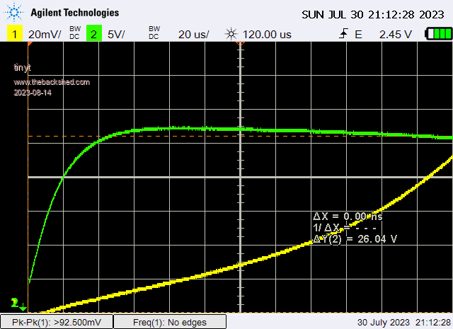

tinyt
Joined: 12/11/2017
Posts: 564
Posted: 02:23pm 10 Aug 2023
  Murphy's friend said  Yes Mark, I learned long ago to make it VERY easy to get to all parts in my inverters .
The annoying (or fortunate?) thing is the inverter runs perfectly well, no smoke and the heatsinks/ mosfets all measure around 35 degrees on this 18 degree winter day after being on for 4 hours, no load.
I think that 17 degrees heatsink temperature rise is the 103 watts being dissipated.
With no load and low idle power, I would expect the heatsink/mosfets temperature after four hours to be just slightly higher than ambient.
Assuming all 2R2 and 10K gate resistors are good, try disconnecting the four 1R mosfet drive resistors. Re-measure idle power, if it is still high, my guess is either leaky mosfet(s) or leaky bulk capacitor(s). If idle power became lower, the problem could be in the drive circuits.

I would check every voltage/power rail/level with a scope.
Make sure you check those deadtime capacitors, they can go faulty.

I would suspect poor dead time in Gate drives.
While proving that there is the correct timing, I would also
verify correct Gate drive voltages.
If above is perfect, then you have shown it's not the choke, nor
the resonant frequency (testing all those chokes would have tested
all the different freqs too) and the toroid does not suddenly develop
10x losses.
Do you have a spare toroid, no matter what size, that you can compare with?
They DO retain some magnetism in their core, even if we are told they
should not or do not. This can effect output waveform shape quality
Next look at signal integrity 5V PWM verses opto output, verses Gate voltage
and pay attention to signal quality and delays.
This will also verify correct operation of the isolated supplies.
Maybe a transistor in the totem pole is not quite good and
this will show it.
Edited 2023-08-11 09:12 by poida
Murphy's friend
Joined: 04/10/2019
Posts: 678
Posted: 08:19am 11 Aug 2023
Thanks guys, I really appreciate all your suggestions.

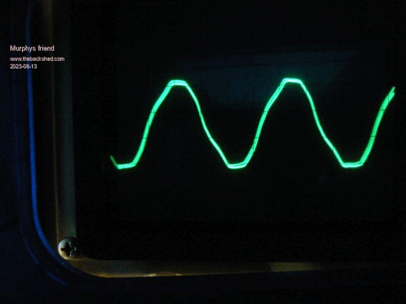

A little update from today; I powered it up without the primary connected and the standby power dropped to 85W.
I then tested all the resistors on the drive board & mosfet carrier, all correct value.

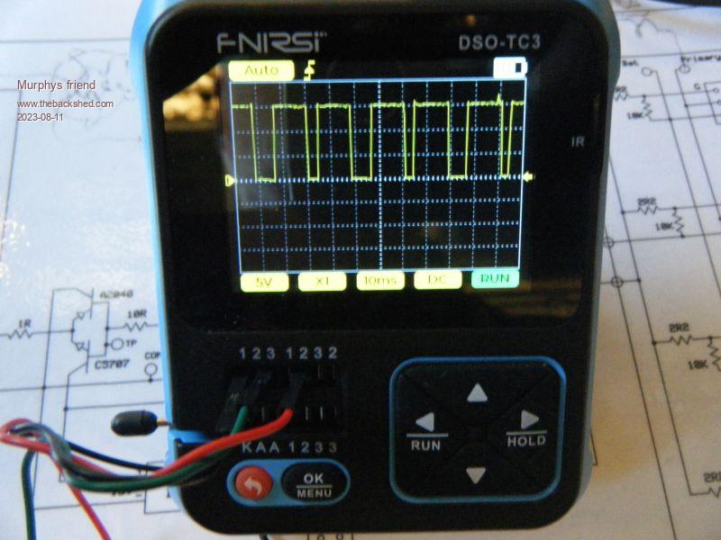

Then the totem pole transistors, had to unsolder them to test properly, all tested fine, each has plenty of gain.
Testing was with this neat gadget, the trace shown is from the common gates of the totem pole to ground at the LO side drivers.
The HI side trace is similar but below the base line.
Next job is to make 4 mosfet carrier boards (visible in a photo above) but only one HY4008 on each. That would eliminate a fault with the 16 now in use.
After that, don't know. I neither have the knowledge or the equipment to check dead times etc.

Those Fod3182 opto drivers can have a lot of variation in spec between chips, if they are in sockets and you have some spares, swap them out and test again without the primary connected, high currents with no primary connected looks like possibly too small a dead time with partial shoot through between HO\LO.
