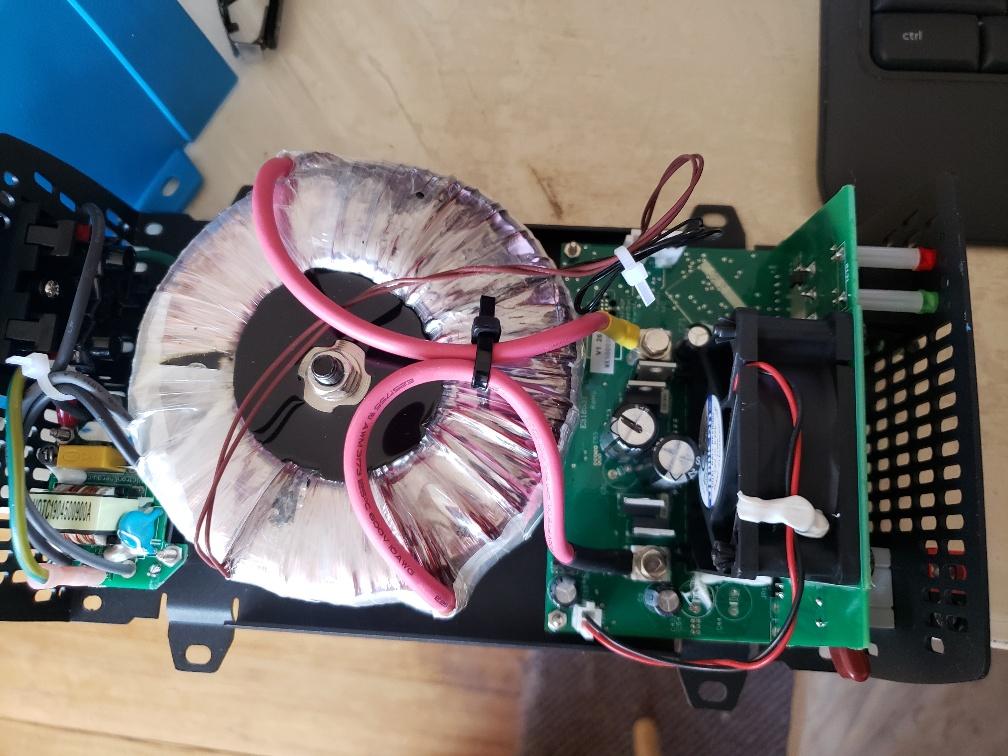

must have been desperate...
whats inside

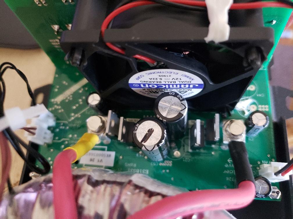

you can easily see the heatsinks.there are 4 of them.
So big and beefy, and Victron have the gall to flash warning lights
should there be "too much ripple" on the DC supply.
I fitted it with 8mm2 cable in an effort to help it keep running.
all I need is a 240V source to drive a laptop, do a couple of phones
and recharge the flashlights. And maybe top up the e-bike batteries.
I should just bail on this , get 2 x 12V lithium 100AH, make my own 24V inverter
and know it will be able to run an espresso machine + microwave at the same time.

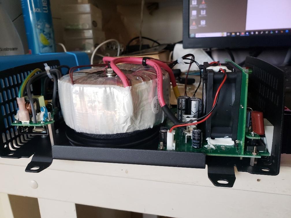

It looks a bit light on in the electronics department. Any idea whether it is a true sinewave output, and how easy it is to repair if required.
I guess if it dies you could easily add an Aliexpress board and re use the transformer.
After trying to fix two of their regulators and seeing the inside of a 3kw 24 volt inverter, I won't buy victron again.
The regulators are fully potted, plus they basically self destruct when you try and get them apart. Not very friendly stuff from a manufacturer.
I hope it runs for years and works well

I only see a decent toroid and output filtering/management there.
Agreed, get a simple Ali-verter and mate them for life.
