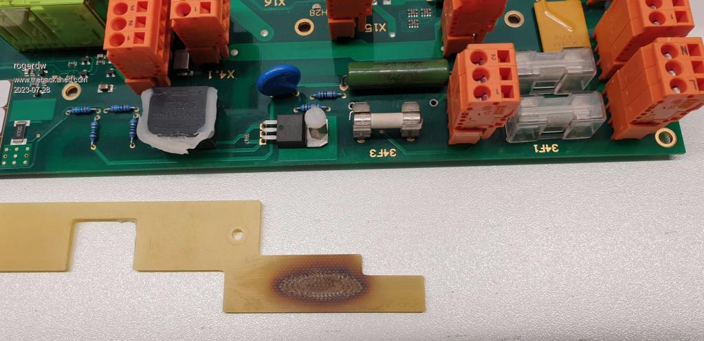

As some of you may know, I earn my living fixing circuit boards and regularly get asked to fix boards I've never seen before and with zero documentation.

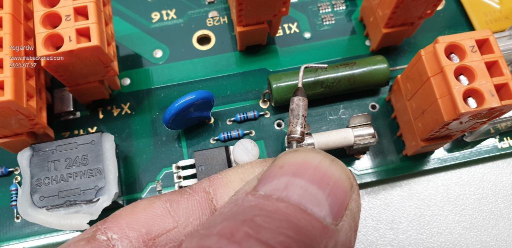

Anyway, the local meatworks brought in this board with an open circuit thermal fuse  ...  and they had a replacement for me to fit. Problem is the replacement is 184 degree and I'm pretty sure that's not a good idea.
See image, but it sits alongside a 22 ohm 7 watt resistor and inline with a normal fuse  ...  so I expect that it's meant to fail if the resistor gets too hot.
The board has 46 scratched onto it  ...  but the old fuse has been damaged and can only really read the 6 and degree marks. The only fuses I can find ending in '6' are 76 or 126 or 216  ...  and the lowest I can find is 70  degrees.
What temp would you choose? Thanks.

Those ceramic resistors can easily exceed 150 Celsius and will unsolder themselves if they get too hot; a 76C fuse would prevent that happening.

60/40 solder melts at about 184C and lead free solder's melting point is around 230C so you may be able to use the one they gave you.
If you want to be conservative the 126C one would be as low as I would go.

Its been running very hot
you can see the edge of the orange connector is black
and the board is starting to delaminate
i would think that it is probably a 176c fuse
The 184 is as close as you are likely to get
The only hit i got on 176 was Russian

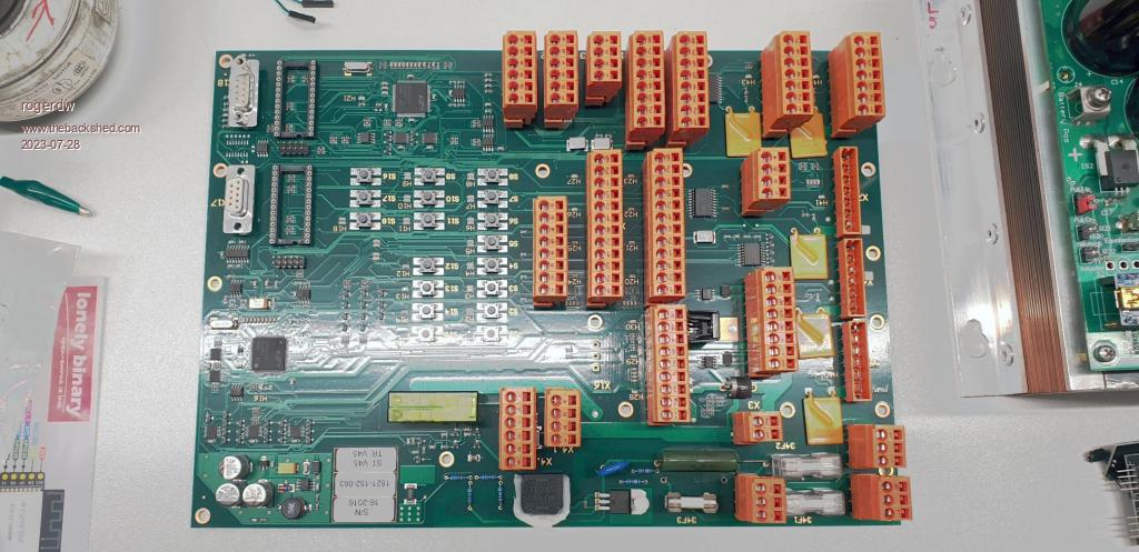

Roger, without the benefit of being able to see more of the PCB & application, is it a soft start circuit ?
The resistor passes a limited starting current but the triac? (if that is what it is) then handles the running current & in doing so diverts the current from the resistor ?
Maybe the triac / triggering device is misbehaving causing too much current through the resistor ?

Yes, it has been running hot  ... the cover that sits above it is quite heat damaged and I ground away a number of layers that were all blackened. Having said that, the resistor doesn't look too stressed  ...  it's not unusual to see those types all blackened and outer layers flaking off, yet still the correct resistance.
I hadn't even looked at what the other device was. Turns out you're right Mike, it is a triac  ...  BTB24-600. I will investigate that idea as well.
Normally I ask all sorts of questions when boards come in  ...  but this was supposed to be an easy part swap, so I didn't ask much at all. No idea what its function is  ...  mainly seems to be a junction board but with a heap of buttons and a couple of micros.
