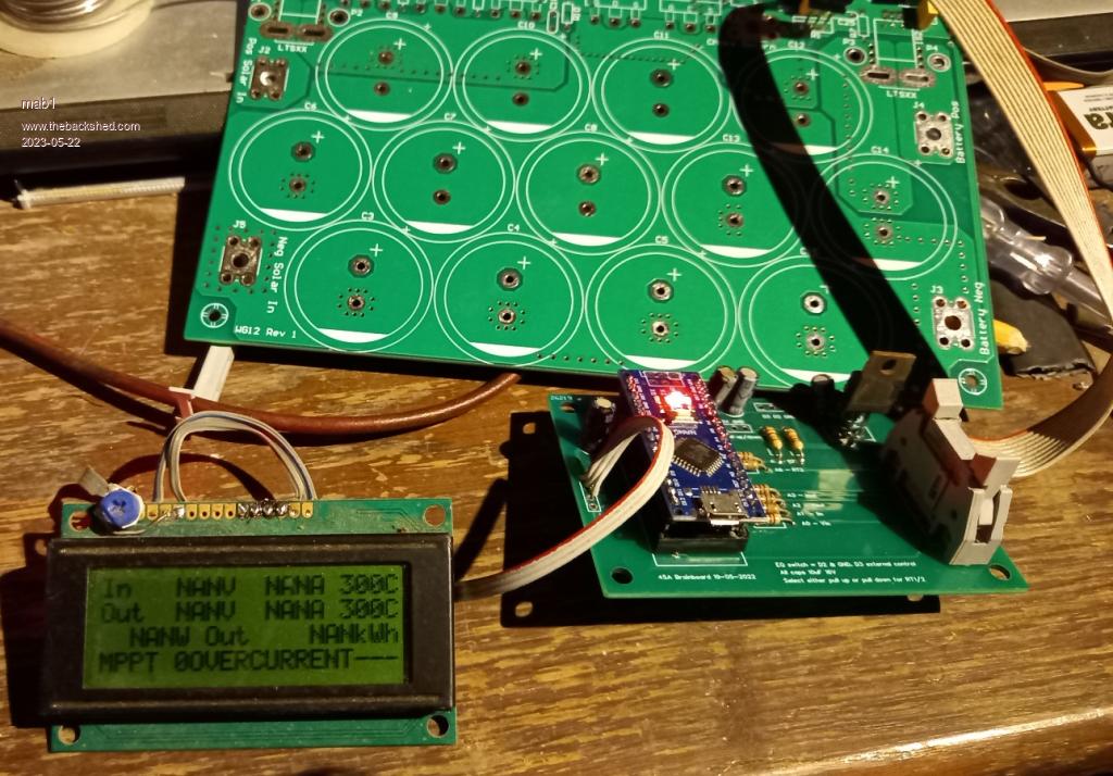

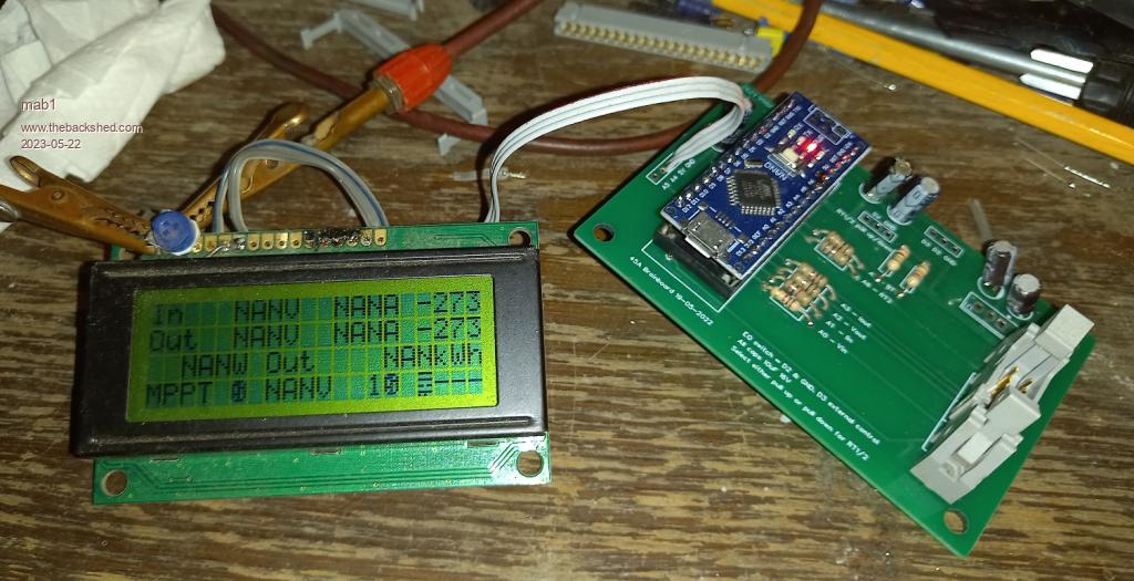

Thought I'd add mine as there seems to be a run of these builds developing - and i finally have a bit of progress to show.
As I've never done Arduino before i decided to start there:

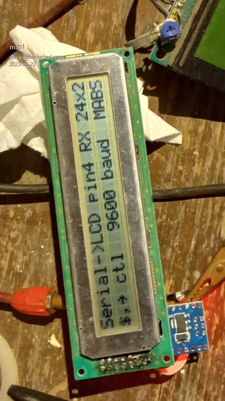

The pic of the 20x4 LCD didn't come out too well, but as i got a job lot of nanos i decided to convert this one too as it'll be a lot easier for a future project especially as it has a confusing 2x7 array of pins instead of the usual 14 or 16 pins in a row.
Here's the mppt 20x4 LCD actually receiving data from the mppt nano - although I'm not sure I've got the best version of the mppt code - as I'm moving to liion batteries i don't need absorb/equaliation/float voltages, but then i guess i can set them all the same in the code.
And here's the whole mppt as far as I've got it. I'm currently trying to salvage as may bits as possible from junk pcbs (managed to find two 7805s following my voltagr regulator question on the other thread). I expect to have to buy some bits but I've got an aerosharp inverter, and a santerno inverter both of which have lem current sensors and big caps. Surprisingly with all the junk here I can't find a single 1nF capacitor.

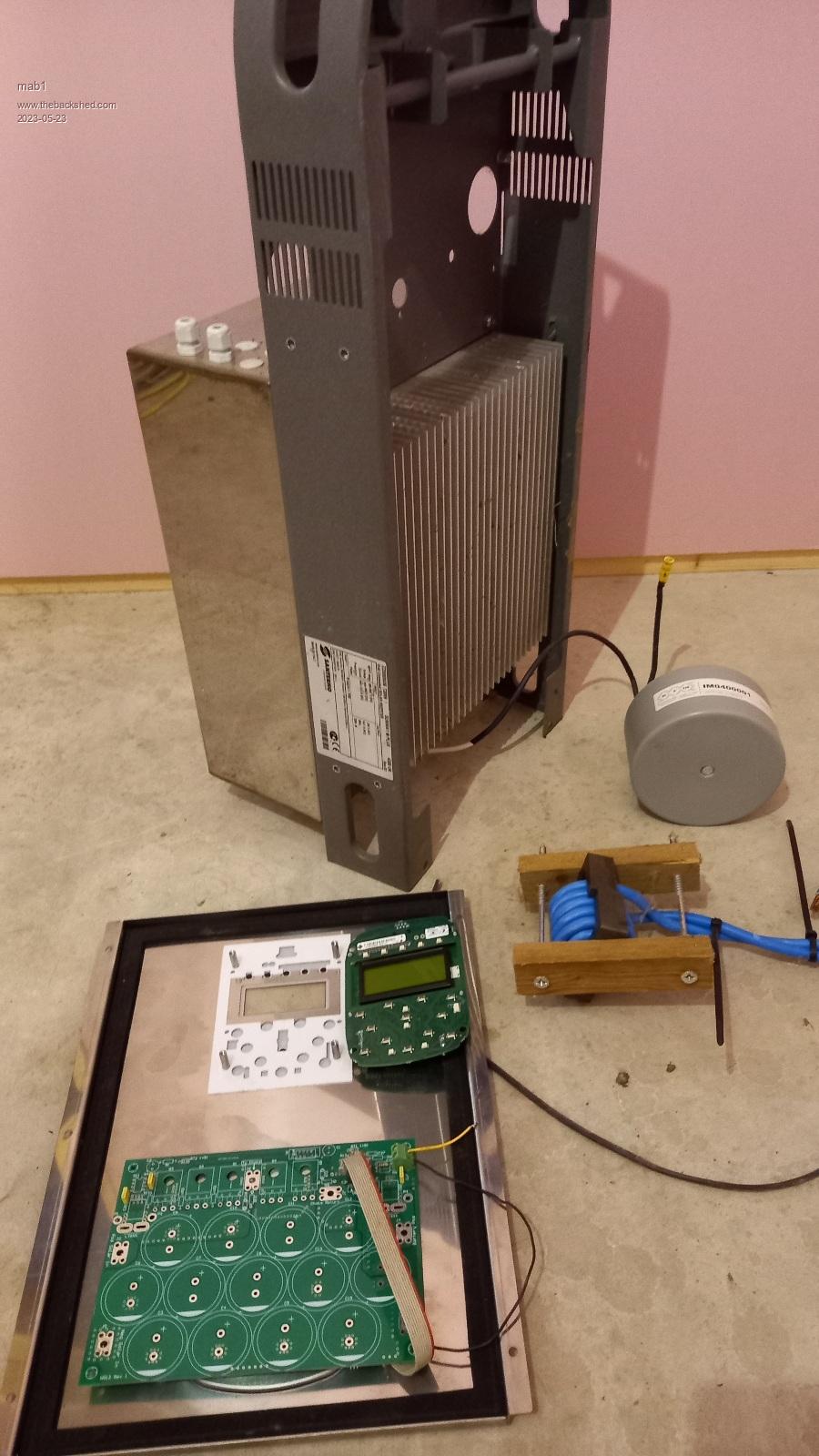

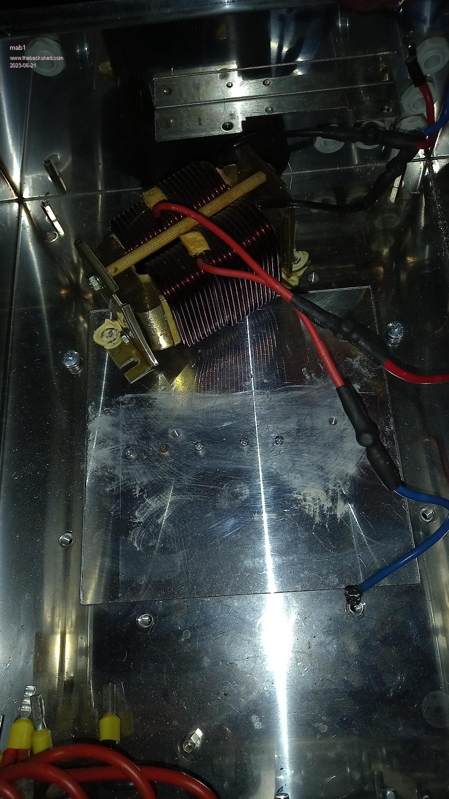

Talk of big heatsinks made me think of the case of the santerno inverter: i originally acquired two of them as donors for an inverter build (3.3kva toroidal transformers),  but as long as the powerjack keeps going that project's low priority. Looks like a good home for the mppt, although i might have to grind off the top bit where the toroidal tx and inductor were mounted.
It's a big stainless box with a massive heatsink, with a 20x4 lcd already mounted on the front face (why didn't i think of it before?!)
The round grey thing is a 5mH inductor that was in series with the 180v primary of the transformer, so must have been rated for 18A. Might be worth un-potting  and adapting it?
The ferrite Ecore inductor, wound with 11 turns 25mm2 blue wire is one i put together for the inverter build, but then read some more and realised it would saturate at ~40A or so IIRC (about 50uH as is), so it might be more suited to the mppt, but I'm not really ready to think about inductors yet - need to finish the mppt main board first. Only room in my head for one problem at a time

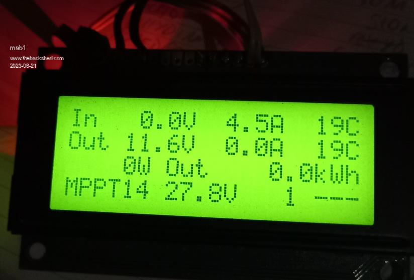

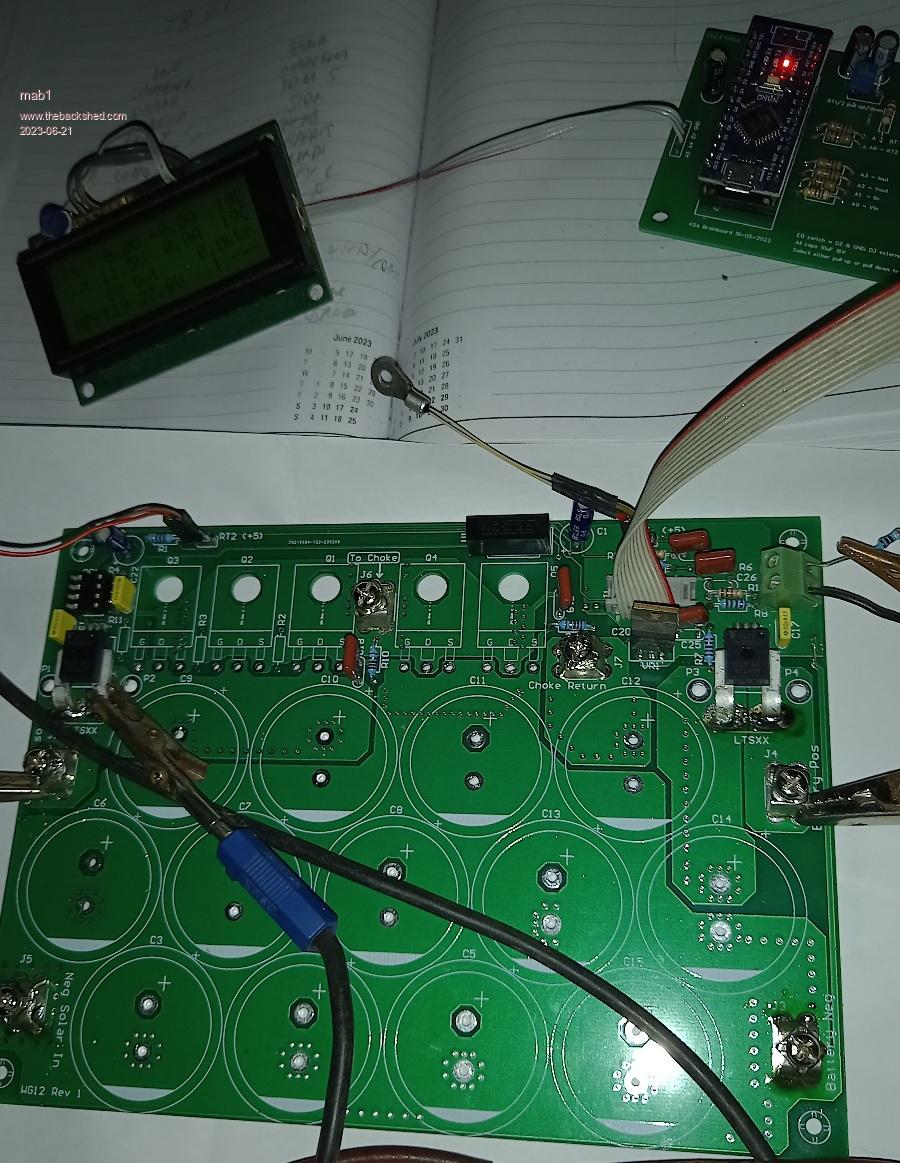

Creeping along on this project:
I now have working current sensors having bought some unidirectional 50A acs758s.
And have followed Poidas instructions on calibration - although i might redo the amps as i suspect the reference ammeter i used was underreading.
Also realised this lcd has a backlight    - but it draws 200mA! Makes the 7805 run hot.

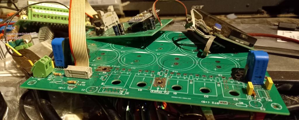

I have drilled & tapped 5 holes in the heatsink for fets & diodes and i do have some of the recommended 150v fets and 200v schottky diodes ( and Fod3182 optos), but am now wondering if i should get some 200v fets as i would quite like to use one of these mppts on a 4-series array with a vmpp of about 140v. Also just realised I'm a bit short on insulation washers for to247   there's so much to think of when making orders.
That's the heatsink with 5 M3 screws and the monster inductor from the aerosharp - still got the whole inductor modding &  testing thing to look forward to.

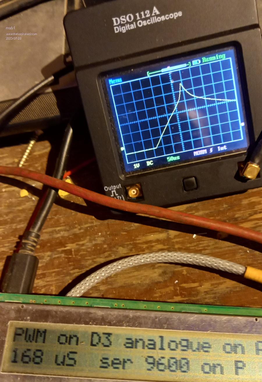

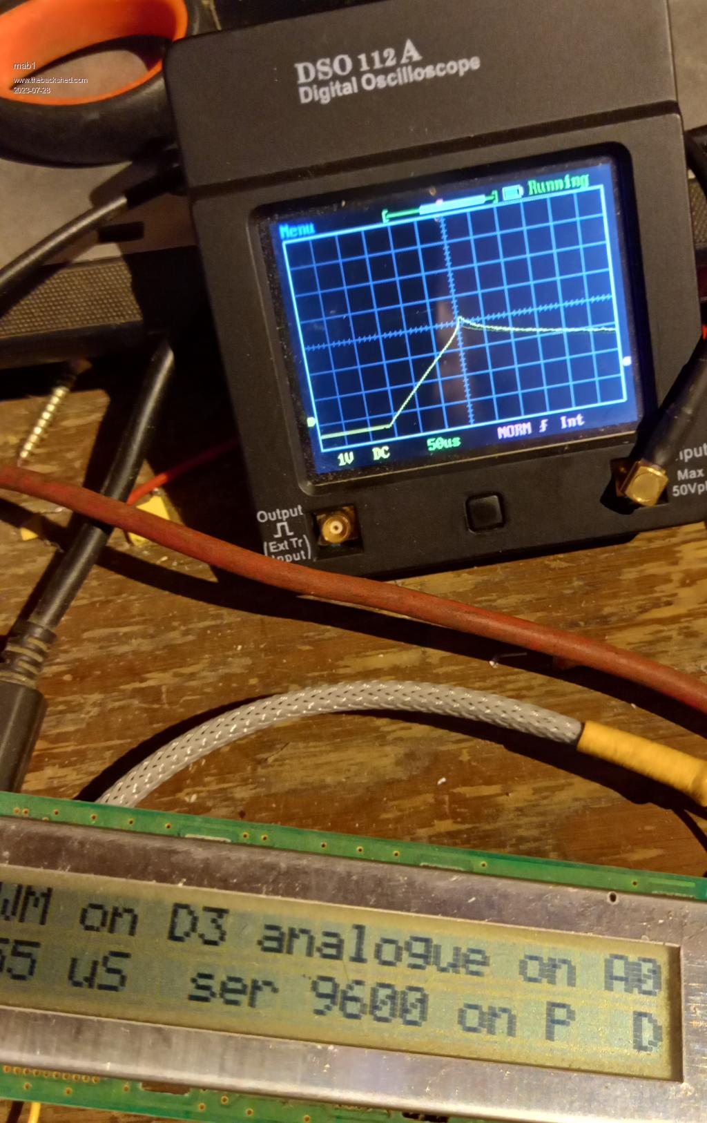

Posted: 06:58pm 27 Jul 2023

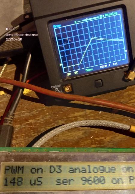

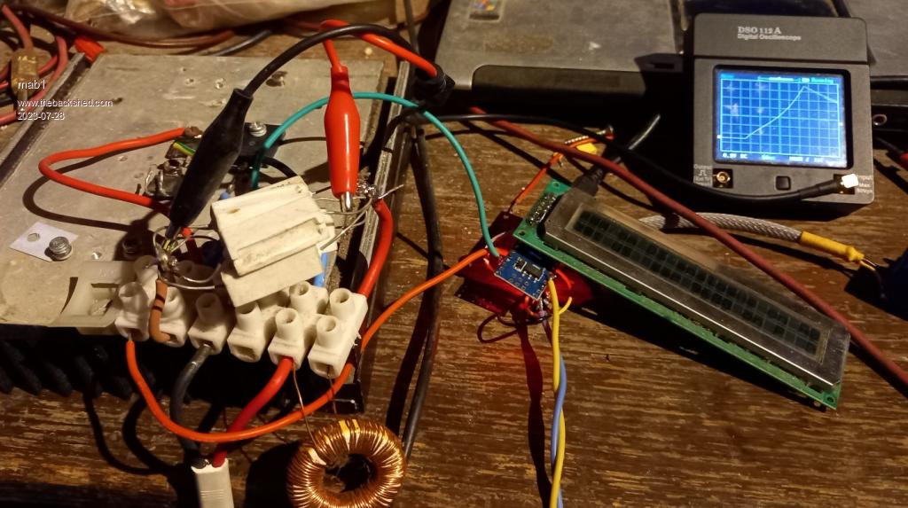

Ok, I've finally started looking at inductors: I've reprogrammed the nano with the 24x2 lcd to do pwm. It works from about 6uS up to 1023uS and runs at about 100Hz to allow the inductor current to fall.
Using an 06CN10L (60v 100A to220) mosfet along with one of the 200v schottkys that will be going into the MPPT unit.
Testing the inductor setup with a little torroidal inductor

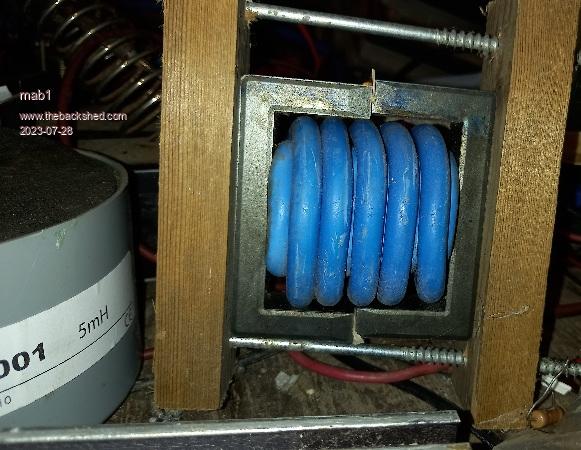

Tried my big ferrite that i wound a while ago with 11 turns of 25mm2 . I originally made this with an inverter build in mind, but that was before i learned that it would saturate at too low a current to be useful.
Depending on wether i have 0.5mm or 1mm of cardboard in the gap it's either 55uH and 30A saturation or 42uH and 50A from memory (didn't write it down), but 25mm2 is overkill so I thought if i can get more turns of something smaller in there,  and a bigger gap it might work for the MPPT.
I want to run 4 panels in series, vmmp 130v, into a 24v battery. Using this online calculator:
http://schmidt-walter-schaltnetzteile.de/smps_e/abw_smps_e.html
i reckon i need 100uH and that would give me a ripple of 10A at 20kHz.
So, with 24turns of test wire i get these results:
1.5mm gap (three card layers)
Thats about 30A, and i calculate 145uH (scope reading 'current' using 0.1ohm shunt resistor; 30.5v supply).
2mm gap, 4 cards
35A, 121uH
2.5mm gap, 5 cards
40A, 106uH
Saturation peak
Turned back to below saturation
5 cards in the gap
Edited 2023-07-28 05:03 by mab1

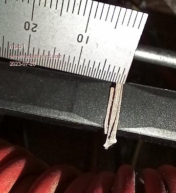

So, some advice please, on the subject of building inductors:-
I'd like to make this ferrite work in this mppt, if possible, but to stay above 100uH and increase saturation to maybe >60A, i would need more turns of wire and a bigger gap.
1. How big can i reasonably go with the gap?
2. I seem to recall advice against big solid wire due to skin effect - if you have 7 strand household wire (like the blue 25mm2 above) does that count as 7 in hand? or as they are touching and not insulated from each other, do they work as one solid wire?
I need to decide what sort of wire to use as that determines how many turns and what wire size i can use.
3. What do you use as gap spacers? Even with the clamp screws tight it gets quite noisy at 50A. Or can i use card, but with epoxy or similar to glue it in the final form?
I do have a 2nd pair of these ferrite cores, so i could just double them up, but then I'd like to save those for the 2nd mppt if possible

Hi Mab making good progress there, I use that schmidt walter site often.
There is another variable that I dont know if it has been played with much in the MPPT and that is the switching frequency to assist with the choke behaviour.
When I was playing with my inverter nominal Freq ~ 20kHz Poida created some test code for me that used frequencies of I think up to 50kHz.  In my inverter there was very little losses at 40kHz compared to 20kHz but of course the inductor requirements are much reduced.  So having a play at higher switching frequency might help.
Not sure if the code allows for simple frequency change but it probably does so the saturation point could then allow the use of the one choke with greater current before saturation and maybe less audible noise also ?
I suspect the non insulated copper 7 strand would behave more like one solid conductor with regard to skin effect.
Cheers Mike
Solar Mike
Joined: 08/02/2015
Posts: 1255
Posted: 01:07am 28 Jul 2023
Once you get over 1.5-2mm with ferrite cores I have found little difference as the gap gets larger. 20Khz is really too low for that type of core, would work better at approx 100 Khz or higher, see if the code allows a higher frequency near 40 Khz or more.
The multi-strand un-insulated wire acts as a single strand, you require multiple insulated strands; I use 0.56mm dia. multiple strands (each good 1 amp) for best efficiency, least heating.
Cut couple pieces scrap PCB material, 1.6mm standard thickness for your spacer, this wont compress as you clamp halves together.
Mike
