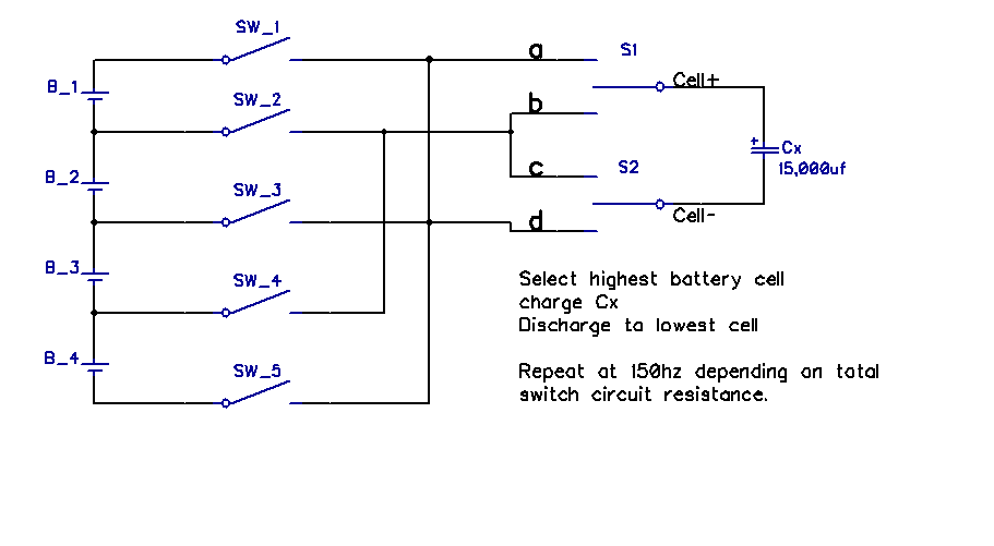

So a bit of DIY is called for, here is the basic dia for a simple concept of removing energy from the highest battery cell and adding to the lowest cell using a large value low esr capacitor bank.
Large low esr cap Cx is charged from the highest cell and discharged into the lowest, achieved by switching the switches in correct sequence order.
In practice the switches are back to back mosfets (dual device mosfets) each with an isolated gate drive, there is a time RC constant with Cx and the mosfet drain-source resistance, this determines the most efficient switch frequency. As cell voltages converge, balance current will naturally reduce to the point when balancing functionality is turned off.
With Lifepo4 banks balancing opportunity (high Side) will only really take place in the high voltage knee 3.4 - 3.6v; I limit my cell voltages to 3.5v max.

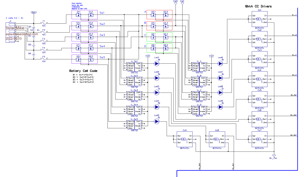

Have started drawing out a schematic, it looks complex, but all devices purchased from LCSC electronics are relatively inexpensive. I will use a 28pin Picaxe to drive the mosfets.

Edit: just noticed an error in the schematic, all the dual mosfet drivers gate drivers are wired wrong, replacing them with much less expensive TLP3906. Will update with another schematic when its done.

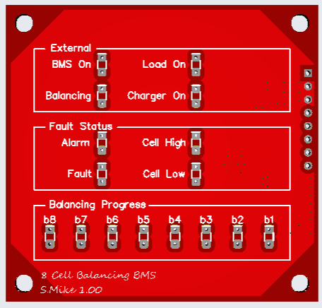

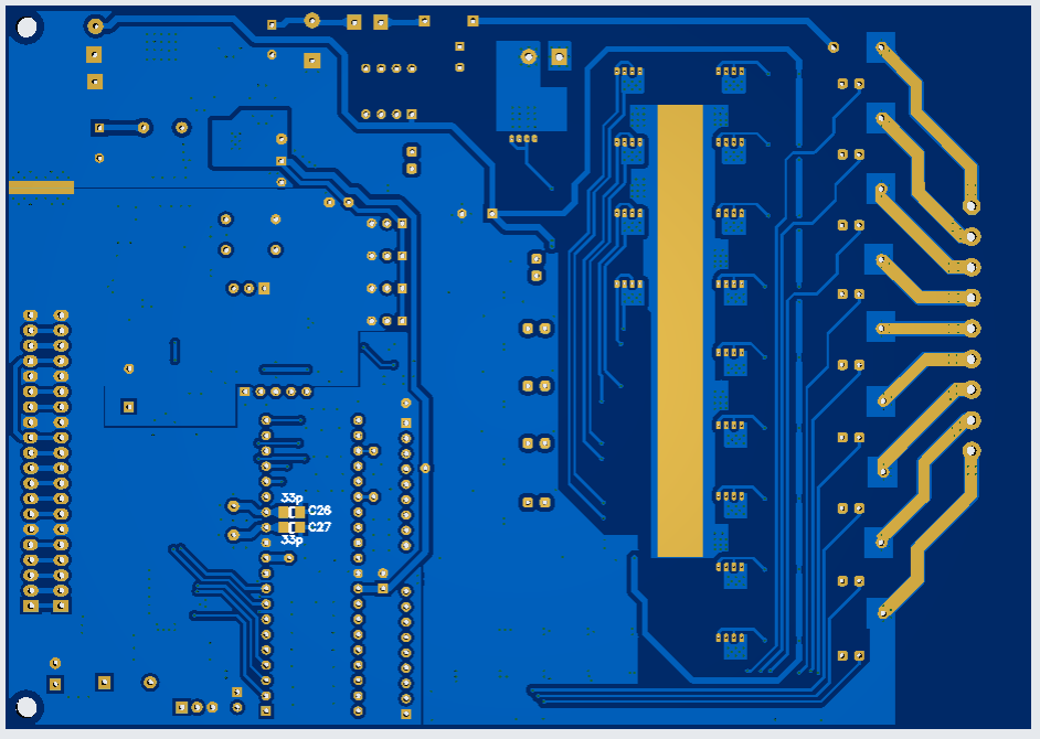

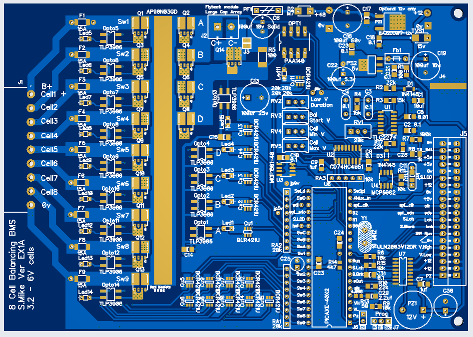

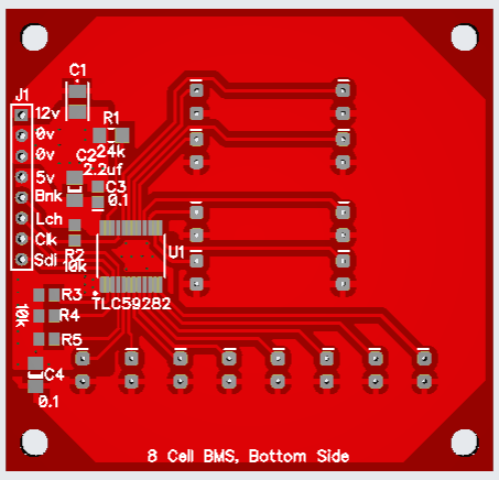

Finally found some time to draw out the schematic and do a pcb, I'm going to have a play with an 8 cell balancing BMS design; will be interesting to see what difference having either a capacitor array 20,000uf discharging from the highest voltage cell to the lowest; or using a small boost inverter discharging the highest cell into the whole battery bank.
I have allowed for both options with the pcb, the boost fly-back inverter and the cap array sit on separate pcb's. A small separate display pcb driven by serial data can show balancing status.
Main PCB 170 x 120mm:
Display 60 x 57mm:

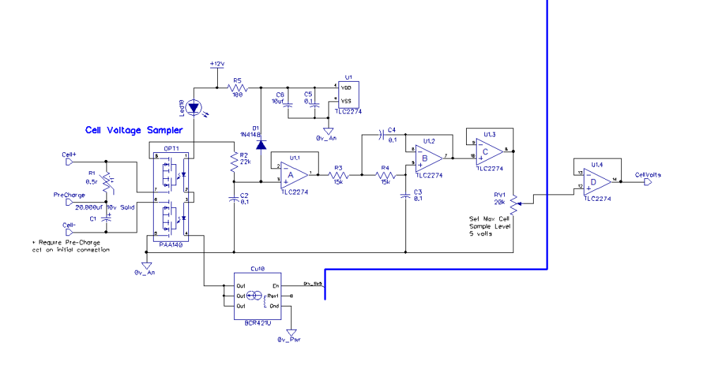

Schematic: I drew out 99% of the circuit then split it out into the main BMS and Led display boards, most cpu IO out lines have a 20k pulldown resistor (array) not shown on the schematic, also not shown are the common Picaxe programming bits or crystal.
BMS_Schematic.pdf
