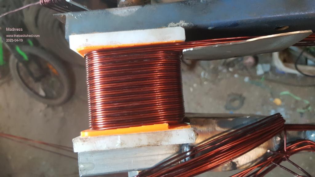

I have used the large choke cores from the Aerosharps to make these chokes. 12 Turns of 30 1.6mm wire which gives a total of 60mm2.

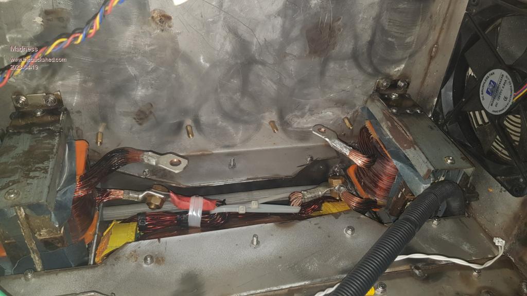

I have managed to shoehorn this into 2 Aerosharp cases with one choke on either end of the Toroid and power board output.

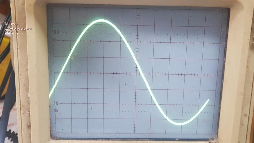

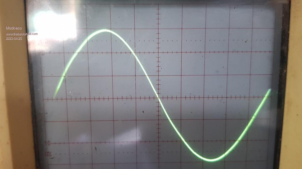

This runs perfectly as a standalone off-grid inverter it is almost completely silent and gives the best possible sinewave output.
There is no sign of any wobbles at zero crossing etc just at no load the peaks of the sine wave are slightly flattened.

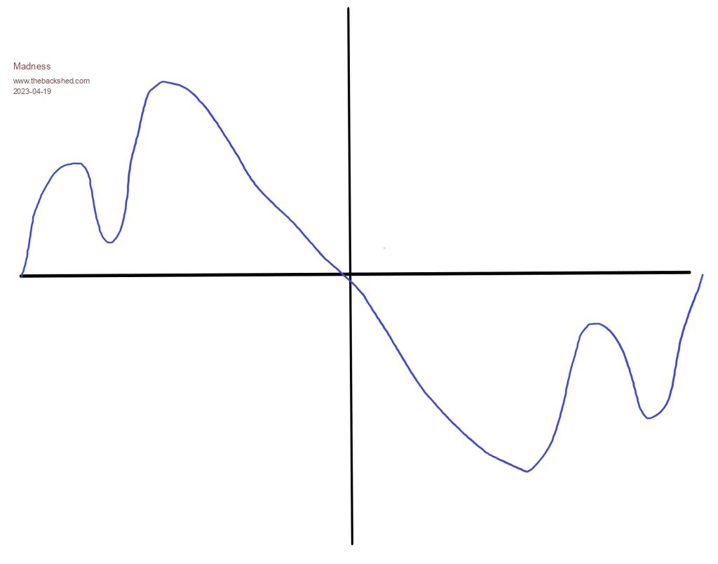

In spite of it running so well I am having issues with back-feeding from a GTI. I have only tried one with a few hundred watts of power available so far. If there is no load on the inverter the GTI tries to connect but the sine wave has like another small sine wave following the path of the main sinewave like this. Please excuse my lack of artistic ability, it does this for about 1/2 of second and the GTI quits and retries.
It will run fine if the is more load on the inverter than the GTI is able to output. But if running like this and I reduce the load the inverter makes some oscillating groaning sounds for a second and the GTI quits. I am using the Murphy code for Nano1 uploaded in the last month.

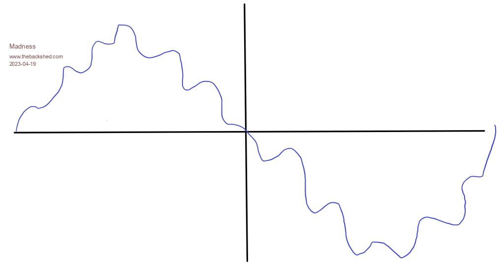

I had another look at the waveform when the GTI connects. This is a better drawing of it.
The image above is more like what happens after the GTI is connected with a load already on the inverter and then the load is turned off.
I have tried it with the V7 No Bessel version of the Nano1 code and it is the same.

So I think the distorted waveform seen above has origins from the electrical interaction of some parts of the system.
If the nanoverter was upsetting things, I would expect much slower changes,
not 4 or 5 dips in AC voltage per 50 Hz cycle.
How slow? Something like AC voltage varying up and down at 2 Hz or 3 Hz and maybe up to 5Hz.
The frequency response of the control loop, when using the op-amp low pass filter,
is not fast. I recall doing some transient response tests of the loop
and got some good DSO captures of the AC voltage before, during and after I apply a
sudden load.
I think this post shows what is happening. The light Blue trace is the scale factor
and you can see it stays constant for each 1/2 cycle.
https://www.thebackshed.com/forum/ViewTopic.php?PID=104481#104481#104481
Edited 2023-04-19 15:53 by poida

For a long time I have been using 3 5KW ABB Aurora GTI's with my EG8010 Inverter. It runs flawlessly with no waveform issues, I get away with running 3 of them as I divert power once a set battery charge current is exceeded. Also, I regulate the PV input if my HWS thermostat has switched off or if for any other reason, there is too much battery current. I am in the process of trying the EG8010 in Unipolar mode in this new inverter to see if there is any issue relating to chokes or the Toroid itself. It does run so well until the GTI connects, so I fully expect the Unipolar EG8010 will run fine as well. But I really want to get the Nanoverter working so I can work towards syncing with a generator and back-charging.
One thing I have not fitted is the filters to the inverter output, two reasons are 1, there is no room for them in the case and secondly, the output is so clean and perfect that I don't think it is needed. There is zero trace of the 20khz SPWM and absolutely no kinks and wobbles at zero crossing that plagued me previously.
The case is built, it was a bit of work but I got there, if I made it larger it would not have fitted on the wall in the space I had available anyway. That spot was previously occupied by 2 Trace 4.5KW inverters from last century that have reached their use buy date. I have polished up the Stainless steel and I don't need to worry about painting it or having it rust. The Stainless steel is easy enough to work with as I have a MIG welder that came with Argon gas and stainless wire. Getting the right cutting discs and drill bits also makes it not much different than working with normal steel.
Here is a little fun fact for you also, way back you said having the capacitors inside the heatsink was a bad idea due to heat. In the last 5 or 6 years my main inverters heatsink has never, not even once exceeded 40 degrees. So the air flowing through the heatsink had to be less than 40 degrees which means the capacitors were never at any risk of getting anywhere near a temperature that would cause an issue. As I have never had a cap fail also confirms that I don't need to worry about it and my inverter has to earn its keep. I know the temperature has never gone above 40 as my control card records the highest temperature for both the caps and the toroid which has had a maximum of 61 degrees.

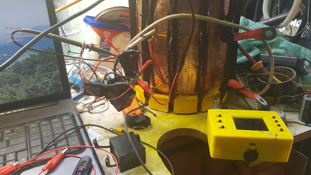

Mike I had wondered about that I am reading though everything I can find about the code to get a better understanding.
This morning I got a EG8010 test rig running using Unipolar with just 4 MOSFETs in total with smaller chokes on each output of the power board. This has worked with the GTI up to 200W so far and connects and operates without any issue. I have not had run any load before connecting the GTI. The sinewave is good, I just want to confirm this is all okay before fitting this control board to the big inverter.

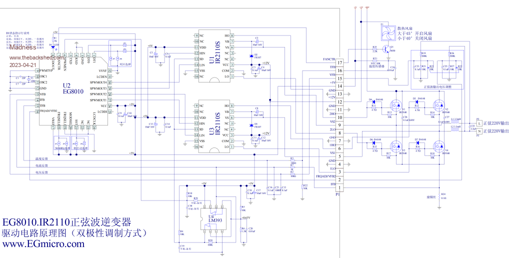

I said above I was going to try Unipolar on the EG8010, what I should have said is BIPOLAR, must be going mad.
The Bipolar modulation requires VFB from each side of the output but they only show it being used with a high voltage type inverter.
I have tried this but get a sine wave that looks like it has not had the SPWM filtered out but is much wider, I ran out of time on it today to get any further. I used the VFB circuit as per above on the toroid output. Previously I had just enabled Biploar with just the standard VFB we have been using forever on the EG8010, that gave a sinewave that had the top half looking normal but the bottom half was wobbly after zero crossing and the amplitude was reduced to about 2/3 of what is should be. I tried linking together both VFB and VFB 2 and got the same really wide sinewave as per above. Maybe something else is faulty causing that.
Poida is there possibly a different way in the code to produce the SPWM? I see here https://www.thebackshed.com/forum/ViewTopic.php?TID=9409&P=16#127475 you were working with different methods. If the Closed loop for the voltage control is basically the same as the EG8010 then am I right in thinking that the SPWM is the only possible factor assuming the hardware is functioning correctly? I have tried the standard EG8010 setup with the test set and the new inverter I have built and they run fine running normally and back feeding. They also run perfectly with the Nanoverter driving them and will work with a GTI but runs into problems when they try to backfeed.

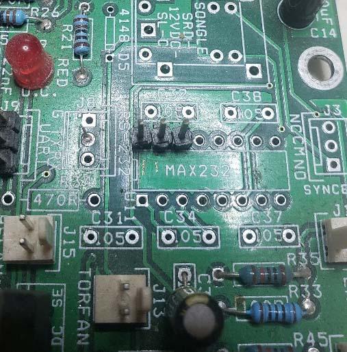

I can now help with this.
I wanted a "proper" AC current sensor to give AC current readings,
not the diode bridge + current transformer that was designed into the
nanoverter board. I spend a while trying to make it work and it
was poor, the Vf of the diodes made it very non-linear.
the hack:
first, remove R36 (2K2)
I fit a 3 pin 0.1" header to pins of the unused MAX232, pins 14,15,16
This gives me +5V, Gnd and unconnected for now.
I run a 2K resistor from the unused pin to R36 pin that goes to
the Nano analog input.
This now gives me a 3 pin header that I con connect various
current sensors to, using my standard 3 pin wiring (5V, Gnd and signal)
Leaving C39 in place we have a nice RC low pass filter on this input as well.
The nano2 code already has support for a linear AC current sensor
You tell it the DC offset and the linear gain via the menu and
you are good to go.

I ended up getting the EG8010 to run in Bipolar but it is very heavy on the DC current. So I am giving up on trying that idea to test if that type of modulation is compatible with GTI back feeding.
Next step I will try is hacking the early  2X Sine code to run as Nano 1.

Posted: 11:37pm 24 Apr 2023
Just another sine-wave photo? Yes, but this is a sine-wave generated by the 2XSINE code above on a Nanoverter with a GTI Connected! It is running as smooth as silk, no growling, just connected and ran with no change to the sinewave at all. This is with no load just the GTI and oscilloscope probe connected to the inverter output. ATM it is cloudy and the GTI is only making around 50W ATM. I will let run all day and see how it goes. There is no way it would work like this with the V7 Nano1 modulation, I know that version runs really nicely but it does not want to play with a GTI.
To get the code above to work I had to change
u = 20000.0 * sin(t);
to
u = 23000.0 * sin(t);
This was to get the AC up from 200V to 230V, I am not sure if this is the best way to do this I hope Poida can verify if correct or not. It may need to go higher as I don't think there is any headroom for a load on the inverter as it is now.
Edit. I have now seen over 300W back-feeding and all is well.
