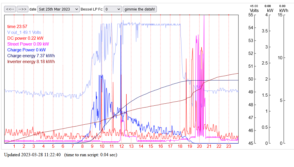

here is a typical sort of sunny day. cloudy in the morning.
8.1kW.hr was used by the inverter for that 24 hours  (Brown line)
7.4kW.hr was got from the panels and mppt controller (Dark Blue line)
We can see the battery spent from 12 until 6pm
in absorb mode, where there was more than enough solar
power to keep it there.
There is no need for more power (or higher current capability)
It's built big enough for my battery and use case.
I doubt you will be able to use 200 Amps charge current for long
and not often either.
So consider designing for 100 Amps charge current.
This will make it possible to run long lengths of maybe 25mm2 cable
the 100 Meters needed.
We do not need to follow design rules when choosing large current cables.
Some heat generation is OK, depending on the circumstances, that is
how long high currents are being transmitted, how high the over current
situation persists...all that.
Where I live we have a lot of cloudy days. That means peak panel power
will never occur.

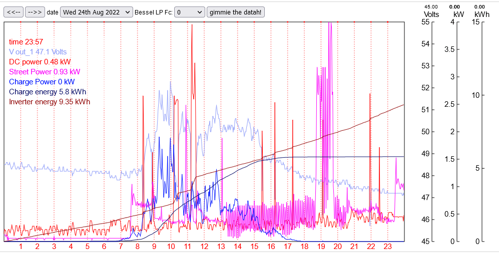

here is a cloudy day:
there was not enough sun to even get the battery to absorb voltage.
The inverter used 9.3 kW.hr
only 5.8kW.hr could be got from the sun
No point in having 200Amp capable wiring and controllers when the
power is not there.
But, it's very good to have as many panels you can get
helping with the charge since they are all running at
a small fraction of rated peak power.

Yes, I can't give the battery 200 amps with what I have now. But the plan is always more panels when I can get them. The battery will live with less, but some day I'd like to stir it up with something closer to C/10.
And yes, Nick, I'm just kinda itching to build stuff! I have plenty of unfinished projects, so this is just a preliminary feel-it-out stage. For the immediate future, I will just have to tough it out at a lower voltage and deal.
Warpspeed has been using an analog set power point controller with great success. I've studied the circuit and it makes good sense. It is immediately adaptable to a full bridge transformer drive. He uses the TL494 PWM chip that I already had in mind to use (as I have a few already). A pot sets the rated Vmpp and then the TL494 adjusts the PWM to control loading on the circuit. No need for software and very fast. Perhaps not quite as efficient in the long run, but very simple. So I have the IGBTs, I have the PWM controller, I just need to work out the transformer, something I've never really studied much of in HF power supplies.
