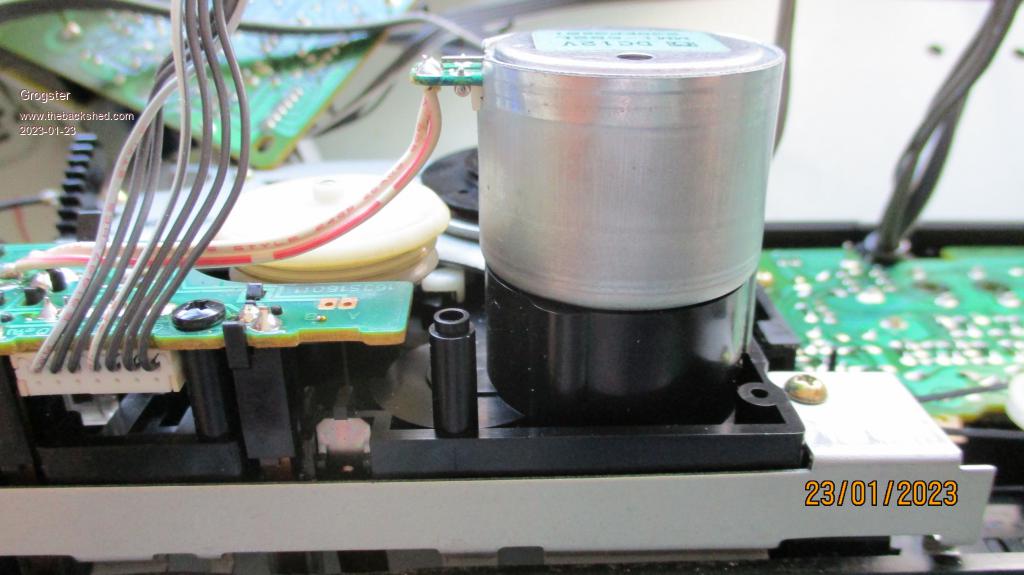

Sony TC-FX211 cassette deck with snapped main motor belt.
Replace belt, and everything is working find, but.....
Have a look at these photos:
First photo shows motor mounted on the deck, but with the pully wheel almost TOTALLY covered up.  Oh yay...

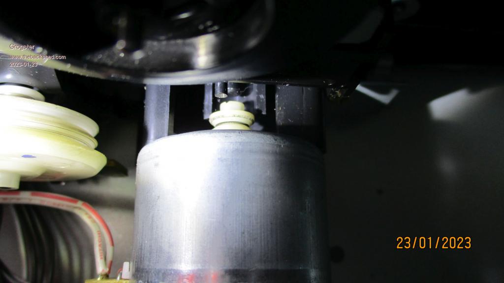

2nd photo shows pully, but note the black plastic behind and surrounding the pully, so you CAN'T simply push a new belt to the back and around the motor pully - the black plastic BLOCKS you from doing that.
Why, Sony, Why?
Well, in all honesty, I think that is done that way to prevent the belt from getting away from the motor pully during assembly, but that means that you HAVE to remove the entire deck, and remove the motor from the deck to get a new belt in there, then replace the motor to the deck, then put the deck back in the front panel, then loop the belt around the flywheel.
Sheesh.....
Would have been so much easier, if you did not need to remove the deck and the motor - you could just thread the new belt around the pully and......done.
Sigh.

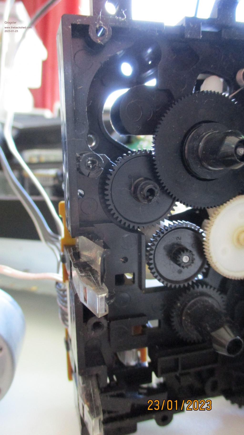

Photo 3 shows the deck out of the front panel, and the rear(with respect to cassette) cover removed, showing gears etc, and access to the motor screws.  Motor removed in this shot.

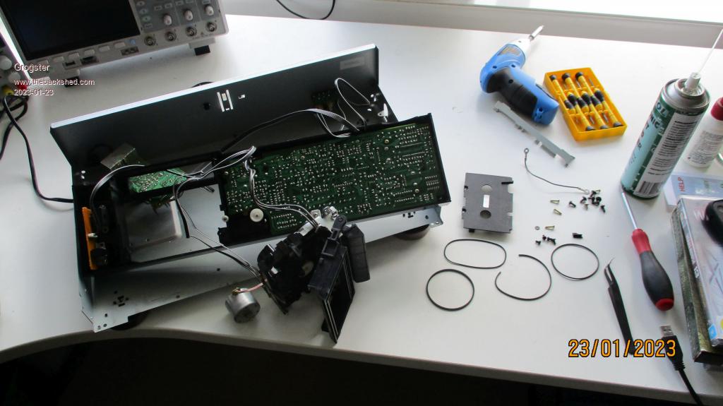

Photo 4 shows motor out of deck.

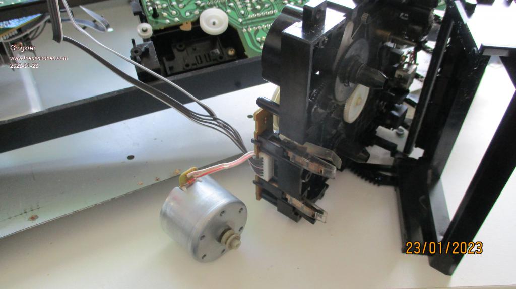

Photo 5 shows everything out on the bench.
I have since put everything back together, and the deck is working well again now, but.......why, Sony, why.....
