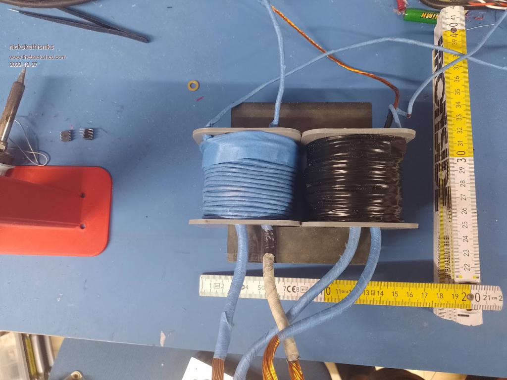

I did already wind a prototype transformer for 5kW at 20khz, with 2 U100 cores, H bridge topology.

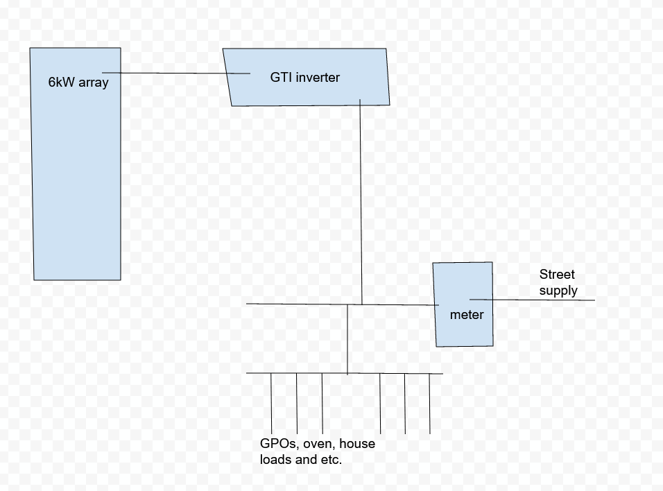

Wiseguy,
I made a simple as can be drawing on google docs.
here
where we might be able to edit.
I need to work out how to let anyone edit this...
this is what it is NOW.
In Red, I want to show what you want it to be.
can you 'splain to me what you propose?
I will then modify drawing to show this.

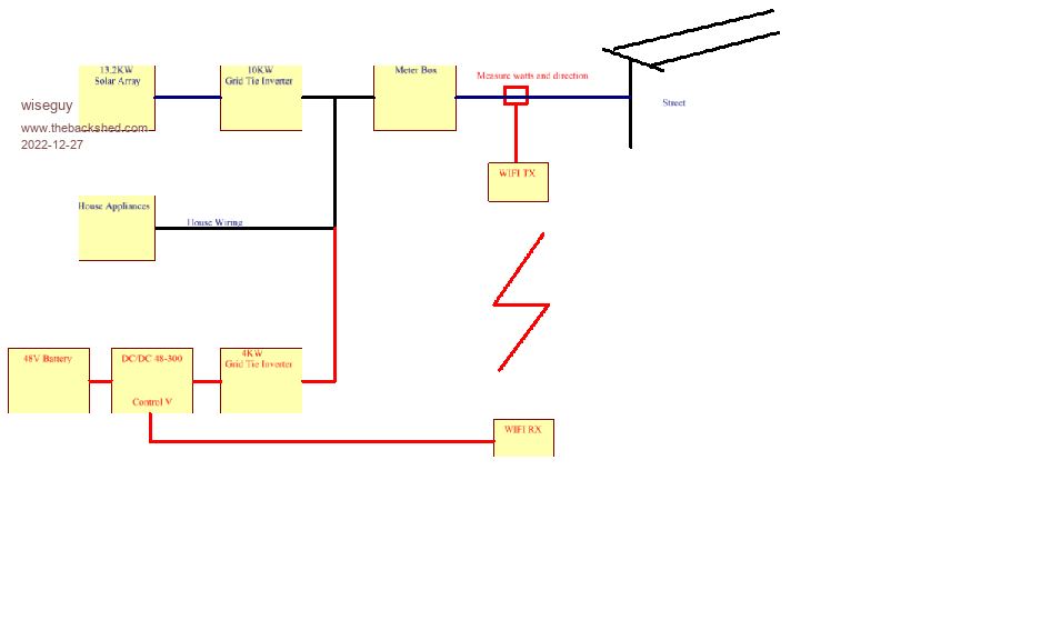

wiseguy
Joined: 21/06/2018
Posts: 1335
Posted: 10:51am 27 Dec 2022
Hi Peter,
Lets talk single phase for simplicity
An energy monitor added which reads street volts and compares it to current from a current clamp, installed on street supply wire between the street and the meter box.
This will measure energy and direction ie drawing or feeding back energy.
The energy monitor has a wifi link to a remote device.
There is a 48V battery storage block to add and another block which is a DC to DC converter (48 - 300).  Another block is the second grid feed inverter that is directly in parallel with the main inverter and its panel input is connected to the dc/dc converter.
The remote wifi receiver controls the DC/DC from 0 to Max via a dc control voltage pwm.
Ok having written that I am now getting a sense of a gentle hint that maybe I should have drawn an accompanying image lol wait a little while and I will try.

wiseguy
Joined: 21/06/2018
Posts: 1335
Posted: 11:32am 27 Dec 2022
Here is a picture that I hope is readable and represents the proposed system add on in red.
When power is attempted to be drawn from the street an equal amount of power is injected from the second grid tie.
So in effect it supplies the required power instead of the street ie street power does not feed the house, our own solar does during the day.
Our second grid feeds the energy when there is not enough solar
Apologies everyone a picture is worth lots more than a verbose description I can see the error of my ways.....
Peter I am happy if you want to add the changes to your above creation so others may edit further as required.
Edited 2022-12-27 21:46 by wiseguy
Cheers Mike

WG:
thanks for the drawing. Now I can see what the idea is.

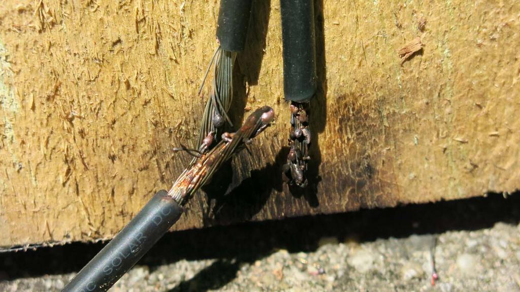

pd--
Joined: 11/12/2020
Posts: 122
Posted: 11:51pm 27 Dec 2022
Your description sounds pretty accurate to me
I put together sum photos for a solar panel fire course a while back
if you are going to play with this stuff then a rapid shutdown system and running the pos & neg in separate conduits that are far enough apart that the arc will blow out are a good idea

Godoh
Joined: 26/09/2020
Posts: 717
Posted: 12:42am 28 Dec 2022
Wow PD, that is one scary photo. That is why I included circuit breakers as well as isolators under my panels that are on a ground mount. They are on a cross beam under the timber panel frames. I have a 30 metre underground run to the shed so wanted to make sure that if a fault occurred then the underground run, that becomes a run through the shed was protected. I am only running around 70 volts as well. Those very high voltage DC runs on grid connects scare me. I have seen panels that have burnt where they shorted between the tracks on the panel itself. Great big burnt patches.

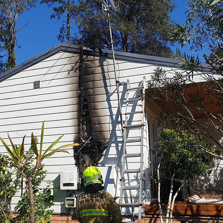

Posts: 3421
Posted: 04:53am 28 Dec 2022
Our local CFA brigade has attended one just like the photo. 10 x 300W panels.
You don't need hundreds of volts either, a loose connector on a large 50V DC emergency lighting system did the same thing.
With no half cycle zero crossings to interrupt the arc it just keeps going.
One reason why welders prefer DC.

and control its output.
The fronius can be programed in fail safe mode so if it looses comms with your bidirectional meter then it will reduce its output to 0
Thats assuming that you are planing on using a fronius for your 4kw grid ti inverter
Its just a bit of a twist on how things work hear with my AC coupled off grid system.
wiseguy
Joined: 21/06/2018
Posts: 1335
Posted: 01:03pm 28 Dec 2022
Hi Paul, I am quite unfamiliar with what Fronius information is available really. Is the protocol easily obtainable somewhere ?
I assumed it probably wouldn't be, the other reason for making the 300V a programmable current out was that the concept is then not tied to a particular brand of inverter.
However, in my case I will be using a Fronius so it still could be my option - I really like their good name and reliability despite being annoyed at how hot they run - gotta be some inefficiency somewhere in there despite their reliability !
Edited 2022-12-28 23:03 by wiseguy
Cheers Mike
nickskethisniks
Joined: 17/10/2017
Location: Belgium
Posts: 499
Posted: 08:09pm 28 Dec 2022
Ok, 800VDC is not something for home use for me ;)
At work we play with 3kV, but that's another domain.
You are totally right, I was totally amazed when I was playing with 2 panels in series one day, just making arcs, only about 75VDC and not even in full sun.
That's one main reason for me, to not go over a 48V nominal battery system!
I would also go for the extra gti.
For the cores, I bought them about 4y ago for my choke in the ozz inverter, 10€ each with 10 halves at digikey. Prices went up since then, a lot! Most of my components I buy here:
https://www.tme.eu/be/nl/details/u100_57_25-3c90/ferrietkernen/ferroxcube/
Bobbins are a problem, I made some out of ABS with a 3D printer, but you can't use them above a certain temperature, 70°C constantly should be possible. Making something out of FR4 material can be an option.
I bought a few I100 pieces too, to make monster transformers but those etd and EE cores are probably better with EMI and directly mountable on a pcb as well.
Edited 2022-12-29 06:15 by nickskethisniks
wiseguy
Joined: 21/06/2018
Posts: 1335
Posted: 09:50pm 28 Dec 2022
Nick, I was eyeing those exact U cores from Digikey yesterday and downloaded a Ferroxcube data sheet for them. They are an eyewatering $49.22 ea for 1-9 pieces which does not sound like a huge bargain compared to a working 4kW Fronius for $300 + freight I bought a couple of weeks ago = to 6 U cores....
The only bonus is that digikey pay for freight if orders >$50 so if I order 2 or more freight is free.  It has made the EE65's & EE70's I have to hand suddenly look a whole lot more attractive again.
Cheers Mike
