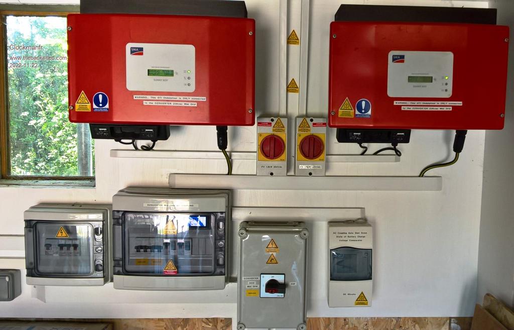

Photo below shows two old second hand GTI's powering into my 230vac Mini Grid.

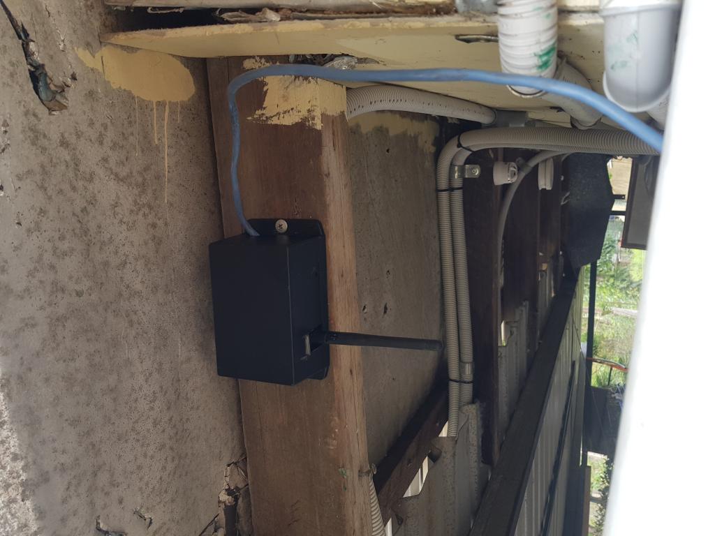

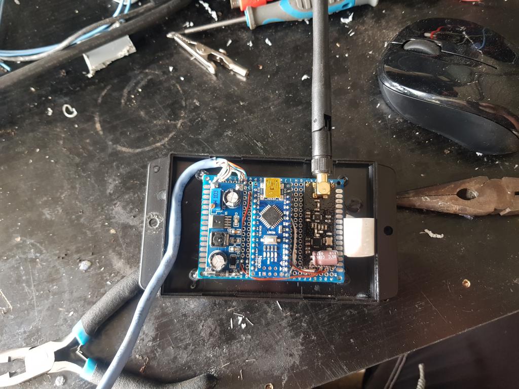

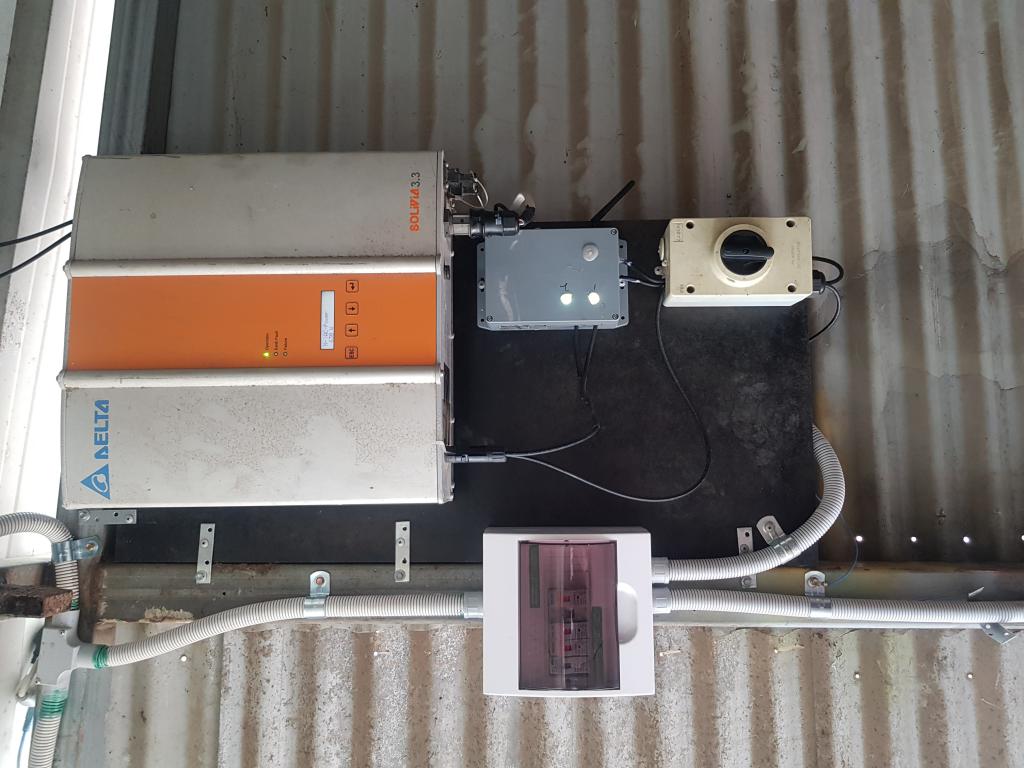

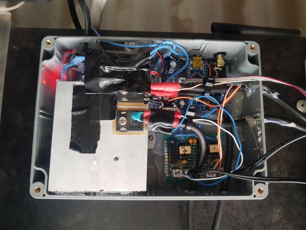

hey Clockman,  so Ive attached some pics of my setup, and it is working well, made a few more modifications to the code for more redundancy, slowed the Mosfet update down as again more suitable for my setup... but all configurable...
the big one is a RGB led ive set up as a heartbeat,  so as long as each second the nrf24l01 receives a signal, it pulses ...
volt transmit v1.2.zip
Transmitter in box...
transmitter spray sealed so reasonably waterproof
Reciever with white LEDs as mosfet notifiers, and green / red heartbeat led..
and whats in the box ...
