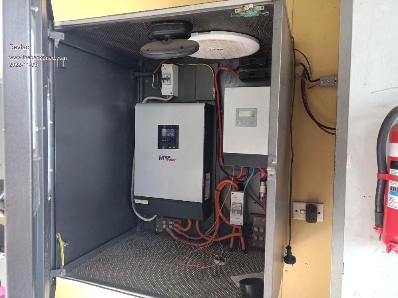

Revlac
Joined: 31/12/2016
Posts: 1310
Posted: 10:38am 09 Nov 2022
You could put the inverter in a large box with vents and a large fan, I did this a while back to see how it went, in the large box with perforated steel panels the inverter was much cleaner than one that was open to the natural ambient air and dust.
The small perforations collected the dust on the way in, however it will be a little hotter in the box, but the 240v extraction fan only needs to run over summer, the rest of the time its been ok.
Other than that any sparks and potential fire is contained in the enclosure.
Did a larger cabinet with extraction fan and it has a few vents with fly screen over them, they collect all the dust and the inverter has remained clean over the years.
I prefer fire proof cabinets for all this stuff now.
Batteries also contained in a metal box outside.
Cheers Aaron
