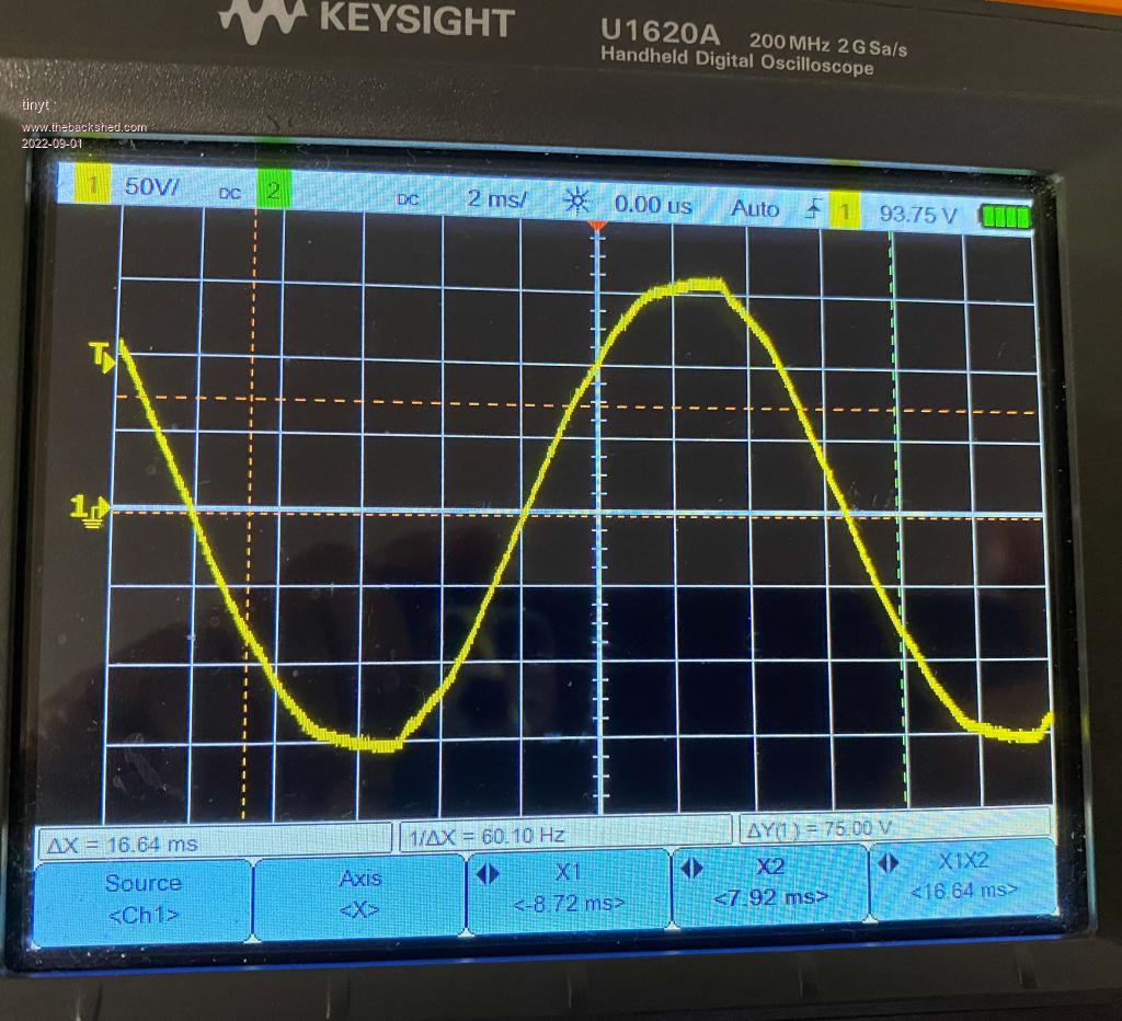

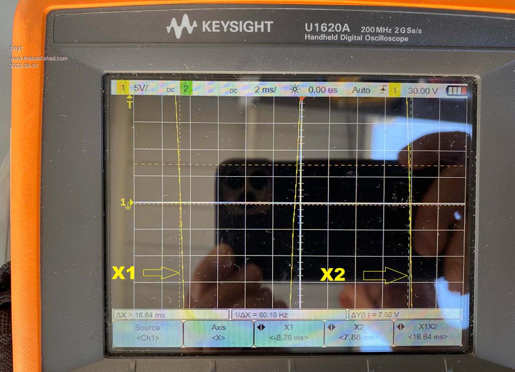

I have an EGS002 controlled Inverter set for 60 Hz, and I scope'd the AC output. I set the range low to overdrive the scope input so that the sine wave edges are almost vertical. Then I used the built in cursors and positioned X1 to a zero crossing falling edge and X2 to the next zero crossing falling edge. It showed a frequency of 60.10 Hz. Maybe, it is not accurate enough.
Here is the complete inverter waveform.

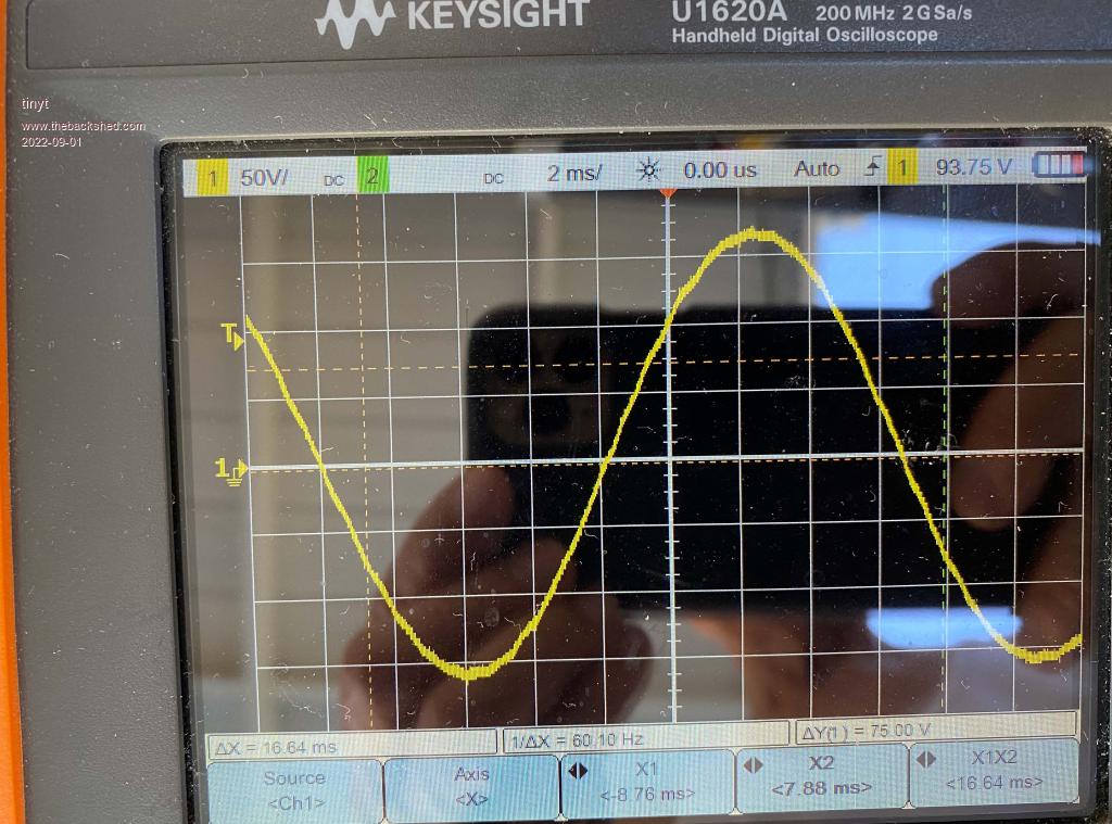

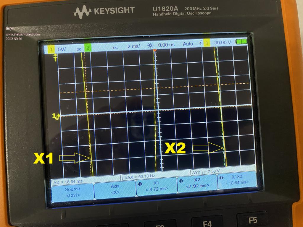

I did the same to the  utility power line and I got the same result of 60.10 Hz.
And here is the complete utility power line waveform.
As I said it might not be accurate enough due to manual cursor positioning and scope calculation resolution. A better way is to use a frequency counter.

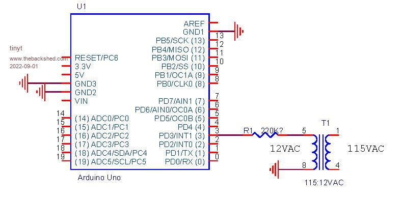

Maybe you can use an arduino just to compare the zero crossing timings of the inverter and the utility power. Something like this plus some sketch to start/stop one of the arduino timers:

My waveform looks the same as yours.  No observable discontinuities.  My Siglent scope expresses frequency out to three decimal places and seems to update every 1-2 seconds.  It jumps between 60.1xx and 60.2xx+, regardless where I put the trigger.
