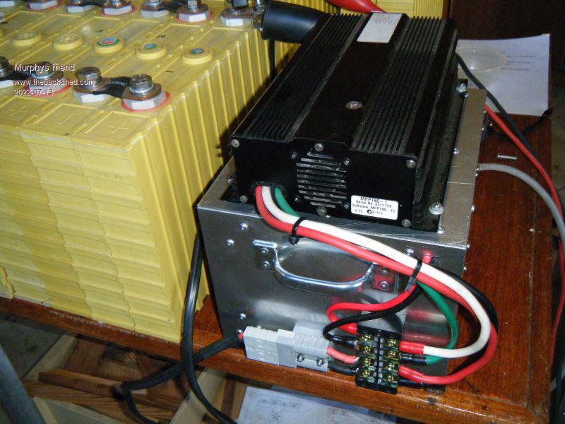

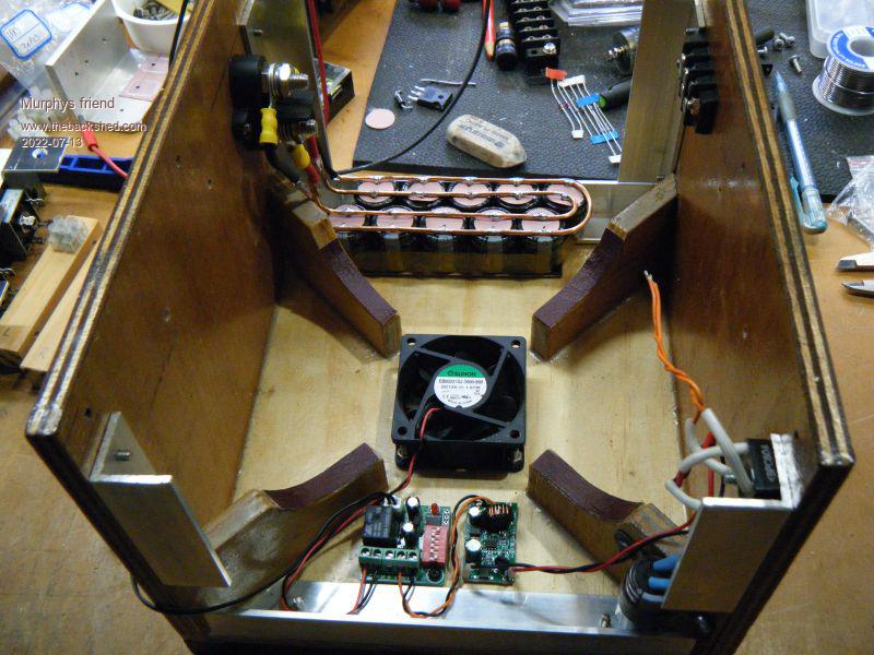

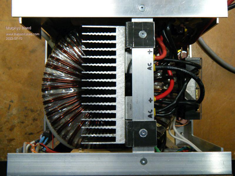

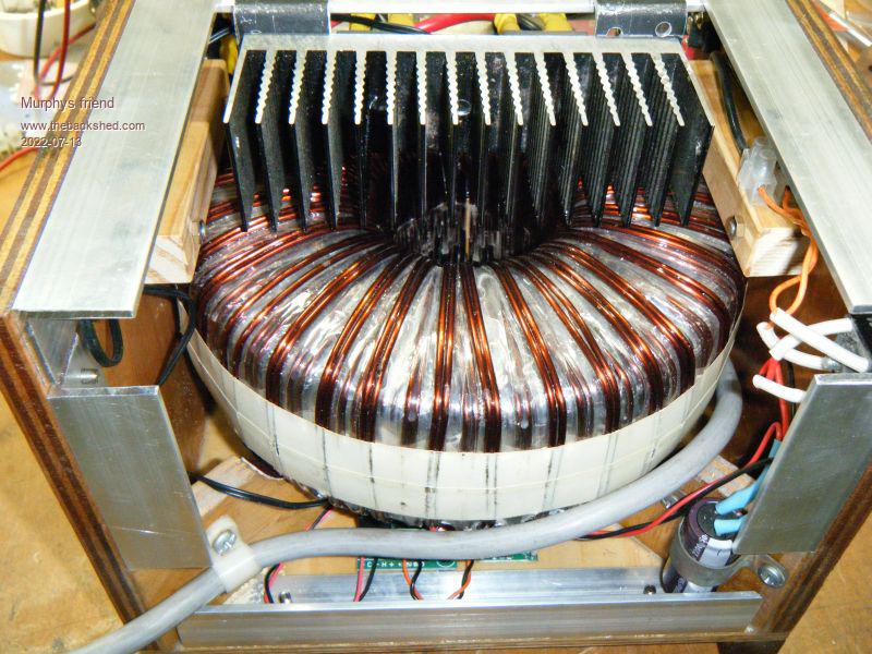

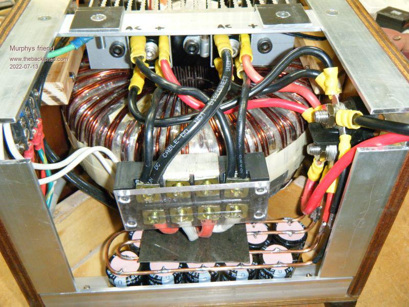

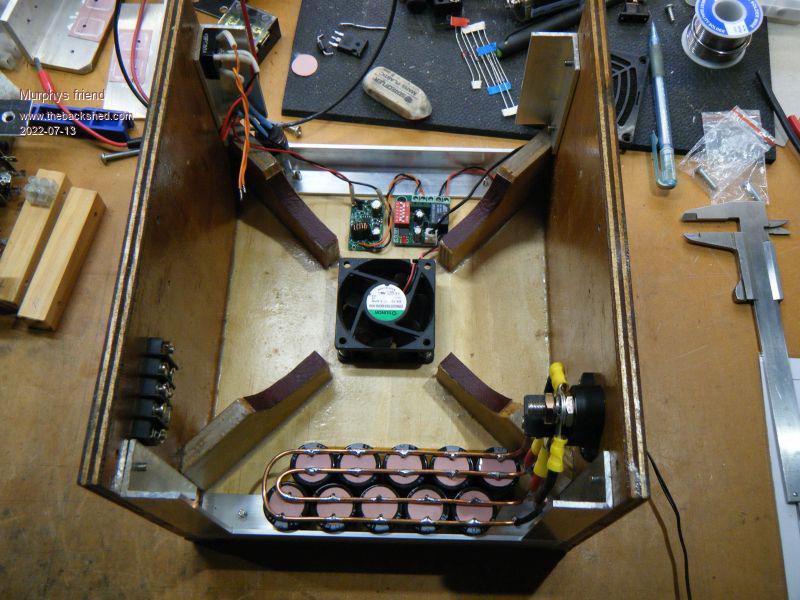

I decided to make my own, a plywood and aluminium composite as shown on the following pictures.
And this is the finished charger:
So, does it work? Much to my surprise, yes. I was worried the rather high ripple current I saw when I loaded the rectified secondary up might upset the MPPT input.
Apparently not so. I was running the generator to charge my spare 48V battery bank via this charger. With 1KW charging power I saw around 7V ripple at the input to the MPPT. I will test this again to the full generator output on the next rainy day, when I'll try to charge the house battery bank with a big load on it.
The nice thing with this MPPT is its auto battery voltage adjusting, so it can charge 12V, 24V & 48V batteries without having to switch anything.
Nice for my caravan battery too, it has a 24V lithium battery.
