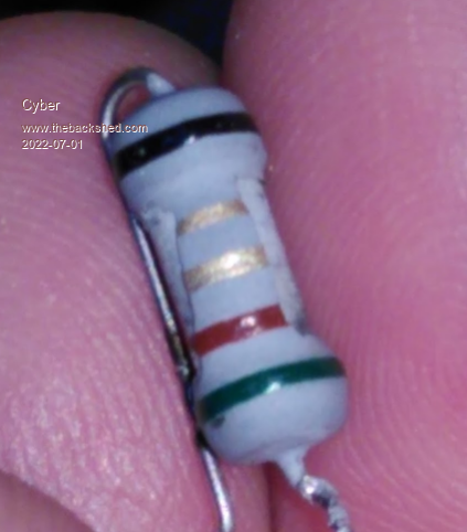

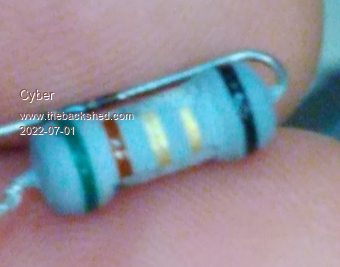

Here are this resistor photos.

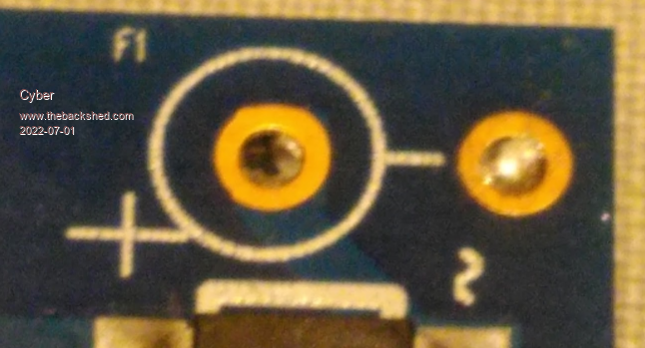

Also I notice that it is marked as F1 (fuse?) on PCB which is also odd.

Thank you for hint! Here is what I googled: "If an additional fifth band is black, the resistor is wirewound resistor. If an additional fifth band is white, the resistor is fusible resistor."
Looks like I have wirewound resistor.

So it looks like it is 5.1 Ohm wirewound resistor.

This may be an obvious comment but if that resistor is open circuit, it would usually fail for a reason, it passed too much current due to some issue or fault. If you haven't looked further to check other surrounding parts for issues a new resistor may end up with the same fate.
It is also possible a big mains spike caused it to look like that. Are you sure it is open circuit - and not just looking a bit sad - there doesn't seem to be enough blackness making me wonder if it still might read 5R1, this would not be the first time a part looking dead/abused still works - sorry if this is an insulting question to you.
"If an additional fifth band is white, the resistor is a fusible resistor."
I just learned something new too !! Have used/replaced many but never noticed a white band..... I am guilty of usually just confirming their value with a meter and ignoring the bands.
These days some resistors with 5 or 6 bands can make a sensible sounding value reading from either end so checking with a meter is a good thing.

I think its a fuse.
1 its labeled F1 on the PCB
2 it appears to connect to the ac side of a bridge rectifier
As for the value you will need to look at the components its protecting and the devises rated load.

If it's in the mains input side, it's almost certainly a metal oxide fusible resistor. Very common on low power boards. What is the unit it came from? Also, there should me a data plate (sticker) indicating input power.

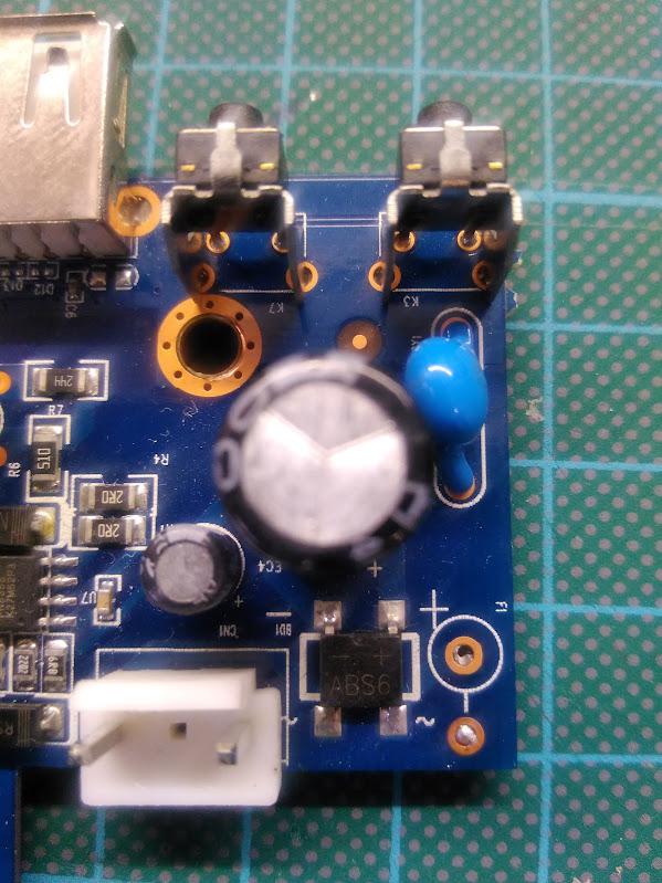

On of the legs of the failed "resistor" goes directly to AC power input. So it does look like it works as a fuse. This is the first time a see something that looks like a regular resistor to act like a fuse. )

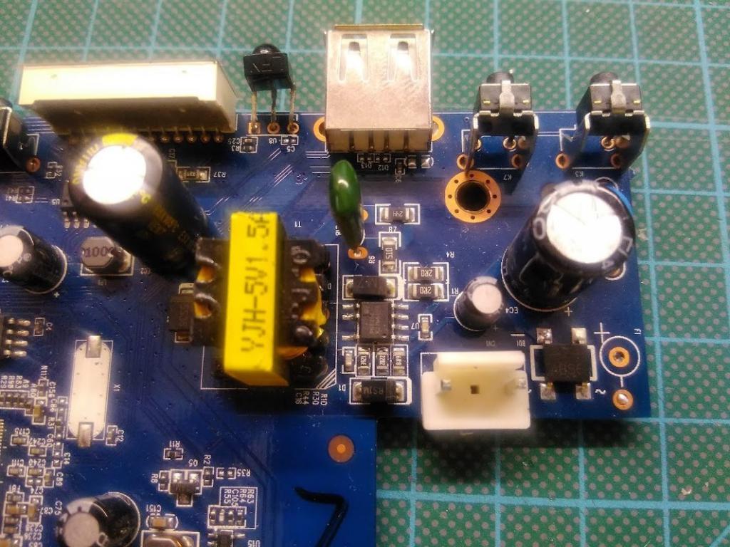

First component I would check is the diode to the left hand side of the transformer in the second picture, it may be shorted. The second item is to check the bridge diode next to the fusible resistor. The little 7 pin switchmode IC sees to have something on the top of the body just near pin 6 - is that a small crack (if it is that will be the answer too). Good luck with it!

Well I'll stick my neck out and tell you it's a fusible resistor.
Apart from checking the bridge rectifier, P/S IC and closeby diodes for shorts, I'd replace it (shield my eyes) and see what happens.
And if I was in a hurry and didn't have any fusible resistors, I'd stick a sensibly sized fuse or even a standard resistor temporarily, to see if that's all that's wrong.

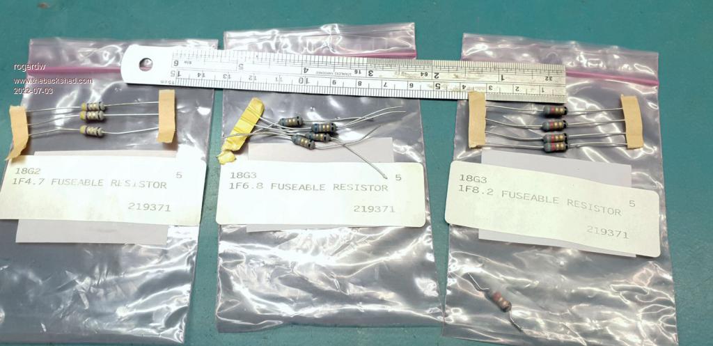

I have a drawer full of 1/2 watt, 1, 2 and 3 watt fusible resistors from an earlier work life.
The photo shows the colours and the related values and these too have two gold lines and then a final black. These are 1 watt resistors and the bodies are close to 10mm long
Cheers,  Roger

"The little 7 pin switch-mode IC seems to have something on the top of the body just near pin 6 - is that a small crack "
Zoomed in on that but the resolution isn't good enough to tell if it is a crack, soot mark or just part of the logo. Need a macro pic to be certain.

Any thunder storms around at the time of failure , you may find sum burn tracks around the RF end of the devise.
