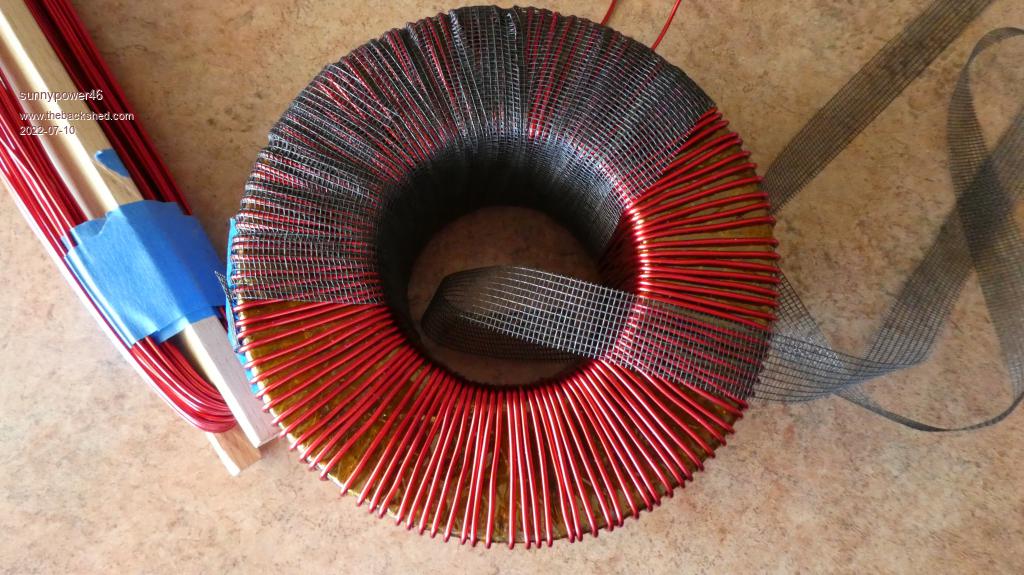

The PJ transformer is all rewrapped and ready for new wire, which was purchased earlier.  I'm too far into it to give up now.  I have two more PJ transformers, only one still working, though.  Might glue two together at some point.  Seems silly if the Lenco cores can be used, though.
I ordered a variac to try the suggested testing.  I'll be back with some data in a week or so.  Stay tuned!

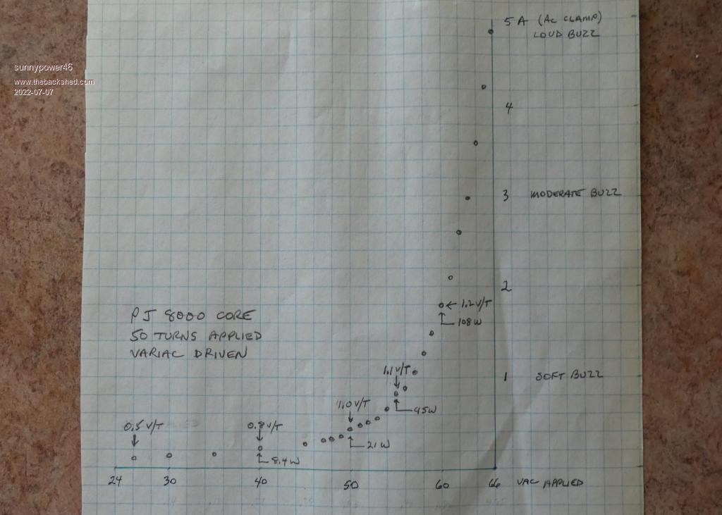

Meanwhile, I wrapped fifty turns of wire on the PJ toroid core and used my new variac. The resulting curve suggests 1V/turn would not be overly lossy.  So, 120+ turns either side of centertap is the number?  At 50v applied I noted .53A on the clamp meter, about 21 watts.  Getting into saturation further really hits the amps and sound hard.  This was a worthwhile learning experience for me.
If I can get this photo of the curve into the post, all can have a look.

You are very much on the right track.
The turns ratio calculation is easy.
The question is how much lower can you go than 1v per turn to really optimise the idle current. Each turn uses up space in the hole. You want as many turns as possible with the least amount of volts per turn. From your graph, you could try aiming for 0.8v per turn, so 20% more turns than a 1v per turn transformer.
Will it fit? Maybe. That's where the hole in a hole calculator will give you a rough idea. The other rule of thumb is that the cross section area of the conductor will give you the current rating of the winding. The rule is 4 amps per square millimetre.

The 5KVA transformer arrived.  It's a beast.  Good condition.  No time to play with it now.  If I have to, I'm not sure the center potting can safely be "knocked" out.  Probably will take some careful surgery first to reduce the side force tension.
I'm going to shoot for a 16:1 ratio for the PJ rewind.  240v secondary, 15v primary.  Using the 0.9 turn/V value, from earlier, I figure 267 secondary turns and 17 for the primary -- what I hope will be a reasonable balance of the various options suggested.
After winding the first layer, I've got at least a 68mm inner diameter remaining.  With only a 50mm diameter hole, I've determined I can get up to 21 turns of #4 awg welding cable in there.  The hole diameter will likely be around 60mm or better after the next secondary layer is wound.  So, maybe even #2 awg cable will fit.  Failing that, I have to go the many wires in hand route.  Yuk.
The first layer of #14 awg accepted 122 turns.  I need about 134, so some overlapping will be required. That would then produce the 120v half of the 240v center tapped total.  Repeat for the other half.  I know I'll get less turns wound on the second layer.  I'll deal with that on the third layer.
Some pictures to share.  First.  All 122 turns.  Wrapping with 3/4 inch fiberglass window screen strips I cut.  High heat resistant, easy to work with, somewhat stretchy, allows you to move the wires underneath, if desired, before epoxy.

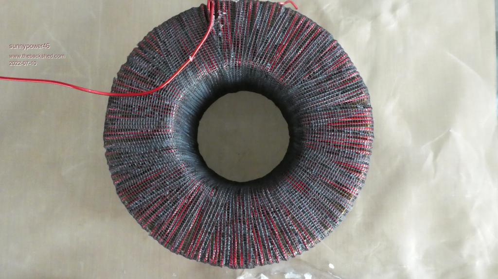

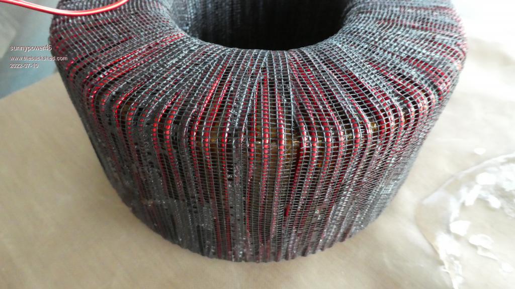

Second.  Readily accepts epoxy.  I'm using a high heat resistant (425F) "casting" epoxy.  It's a bit too thin.  Has a several hour working time.  Next time I'll wait till it thickens up some, like peanut butter. The screening was supposed to resist its running, but couldn't meet the challenge.  The epoxy curing time is slowing my work down.  Wouldn't a high heat, fast setting, thick coat spray on epoxy be nice!
Third.  Closeup.  The screening provides a physical barrier of sorts for the next layer.  Better than a direct contact second layer, at least.  I'll do better with the epoxy on the next layers.
