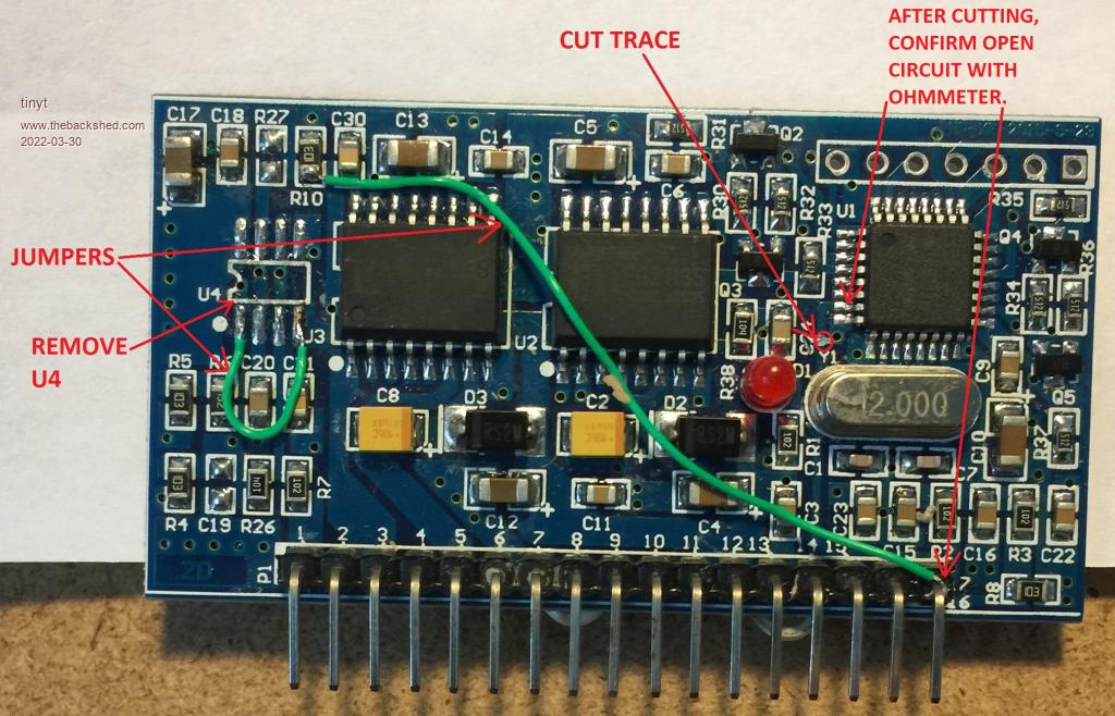

tinyt Guru Joined: 12/11/2017 Location: United StatesPosts: 564
Posted: 08:55pm 29 Mar 2022
Dug up picture of my EGS002 mod.
noneyabussiness Guru Joined: 31/07/2017 Location: AustraliaPosts: 527
Posted: 05:23am 30 Mar 2022
seems unnecessarily difficult.. seriously, jumping pins 1 to 4 and 7 to 8 on " U4 " will do the same thing... but in addition, the original " instant " current control of the eg8010 will continue to work if need be... why we had to remove the lm393 in the first place, it would " fight " the eg's current control and you would cause spurious drive signal to mosfets causing instantaneous combustion..I think it works !!
