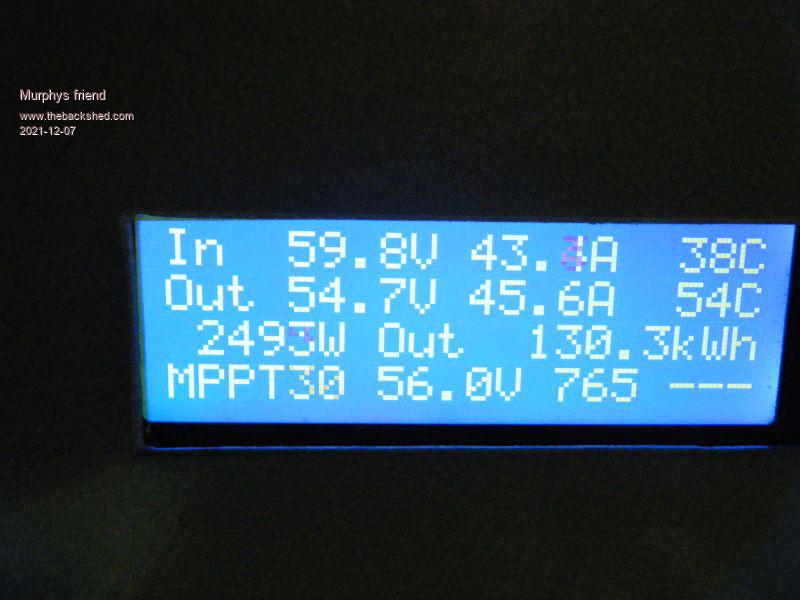

I think  its fixed now.
Very peculiar fault, never came across anything like it before.
The MPPT unit would run fine without its cover. Putting the cover on caused the LCD display to go blank after heavy current charging.
Aaron suggested to insulate the metal cover so it does not touch the metal frame of the LCD. Did that, made no difference.
But I noticed when I carefully replaced the cover the LCD was OK until the very final position of the cover.
So it turned out not to be an electrical connection to nor a mechanical disturbance of the LCD frame but the *proximity* of the cover to the LCD.
Simple solution, machined off 2mm from the nylon spacers that hold the LCD display module.
There is now a 2mm gap between the LCD and the MPPT metal cover. This is not enough to make reading the display difficult through the cover cutout.
But it made my blank screen problem go away .
My guess is that some kind of capacitive coupling upset the LCD display.
I put the unit under severe load to see if my cooling fan can keep up.
It can by the look of it, temperature in my shed was 30 degrees then.
Strangely, its the choke that gets hot, more than 10 degrees over the heat sink. Its not copper losses as the 15 sq mm enameled wire should easily pass the 45 odd amps.

  phil99 said  "Strangely, its the choke that gets hot"
Sounds like the core material does not like the high frequency, or it is going into saturation causing larger hysteresis power loss.
I'm not sure about the frequency but they are the same cores poida used.
I tested them for saturation and this occurs past 75Amps, well above the expected MPPT current, with the 20 turn coil I used.
An other observation, on saturation on my tester that choke squeals loudly. In the MPPt its completely silent.
