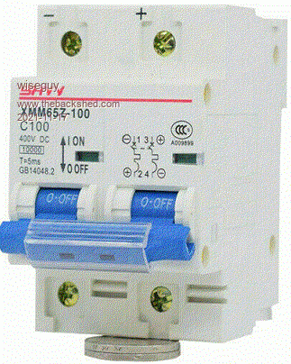

Very timely, I am also looking for 80/100/120A circuit breakers, when I saw these.
I am still trying to work out their polarity information (maybe they are too....)
Does this make sense to anyone else - maybe Solar inverter refers to the switch ?  Is it April 1st ?

Hi Wiseguy Mike, the 63 amp breakers I have look like that one.
They only have + and - marked on the top too.
That one looks like two single pole breakers with a piece of plastic tying them together. The metal piece on the bottom looks like a link.
Surely they are not suggesting to hook two breakers in series?
I have seen breakers with polarity markers before, some are pretty confusing too. I believe they are set up to work properly to extinguish the arc when they are connected in the correct way. Although I have seen some on Grid connected setups connected incorrectly.
I reckon the polarity markers on that one are just showing current flow.
They usually don't come with any paperwork so one can only guess and connect them in the way they are marked.

Polarity can be tricky, here is an article on the correct way to wire them Link ,electricians it seems cannot follow these simple instructions thus the reason for the regulation changes to allow only NON-polarity types in solar or DC installations.

When wiring in a single breaker with polarity marked on at least one terminal regardless whether placing it in series with the positive or negative lead it is easy to  consider what is regarded as the source and connect it appropriately. But to see a dual breaker with  the positive & negative looking inverted at the other end just doesn't look or feel right.  If you consider each breaker in isolation it does make sense but the markings look like a mistake has been made.
I can imagine many issues being made by the uninitiated, if you intuitively connect the Load red wire to the terminal marked positive the results are bound to be not real good.
If they put the word "source" or "if source" at each end and encompassing the polarity markings I think it would help those unfamiliar to understand the markings.
Thanks for the replies and for the link Mike - its no wonder they intend to legislate to go non polarised breakers.  I probably don't need to say I am not licensed to install solar !

Hi Wise Mike, if they had just put arrows showing current direction it may have been clearer.
If the supply positive is connected to the + terminal on the top right, then the load  positive is connected to the bottom right terminal. Then the load return (-ve) is connected to the bottom left and the top right connected to the Supply -ve then the current flow should be right.
Yep non polarised would be clearer. But then there would not be so many stuff ups and the inspectors would not have so much fun, getting folks to return and rectify their mistakes.
