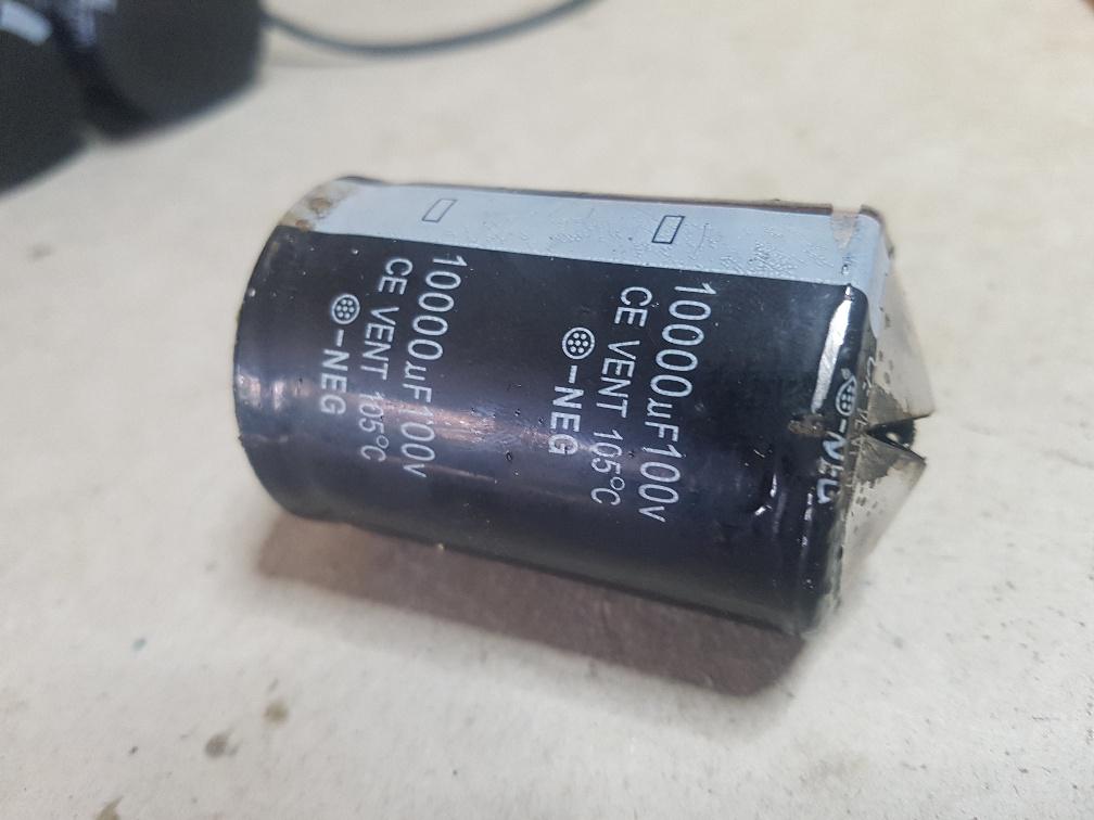

So far I have used these 100V 10,000uF caps in my inverter builds.
Why not use one for the DC-DC converter/power supply?
Input DC peak volts from the bridge rectifier is 95V.
No problems. Right?
So I built the power supply and it works fine, with short circuit protection,
current limit, etc. It charged the bike battery fine at 54V and 7 Amps.
Once the battery was charged I left it to finish off.

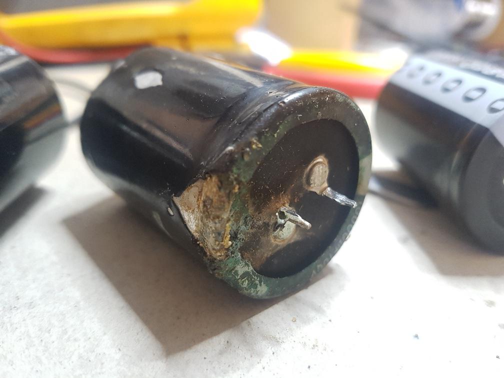

Later I discovered a blank LCD screen..
not good.
The cap had found it too hard to live with 95V and the current ripple from both the bridge rec. and the 20kHz PWM switching.
It looked like this after it spooged all it's guts over everything inside the
enclosure.
And that crap is very corrosive too.
So a cheap cap can cause a lot of extra work rebuilding your device.
And potentially damage a $600 ebike battery as an afterthought.
