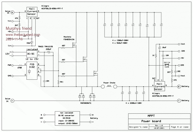

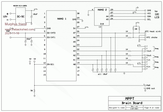

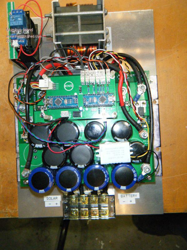

This project is based on Poida's & Wiseguys inputs to this forum. I did my own PCB to fit an existing (ex Victron energy)heatsink.
With help from a local programmer (Gaspo) I got the two nano's programmed. Nothing blew up when I powered it up but I ran into calibration issues, most likely due being last in class with regard to inputting data.

My build, no display fitted:
And powered up:
As it is not doing any MPPTing yet your input would be very much appreciated.

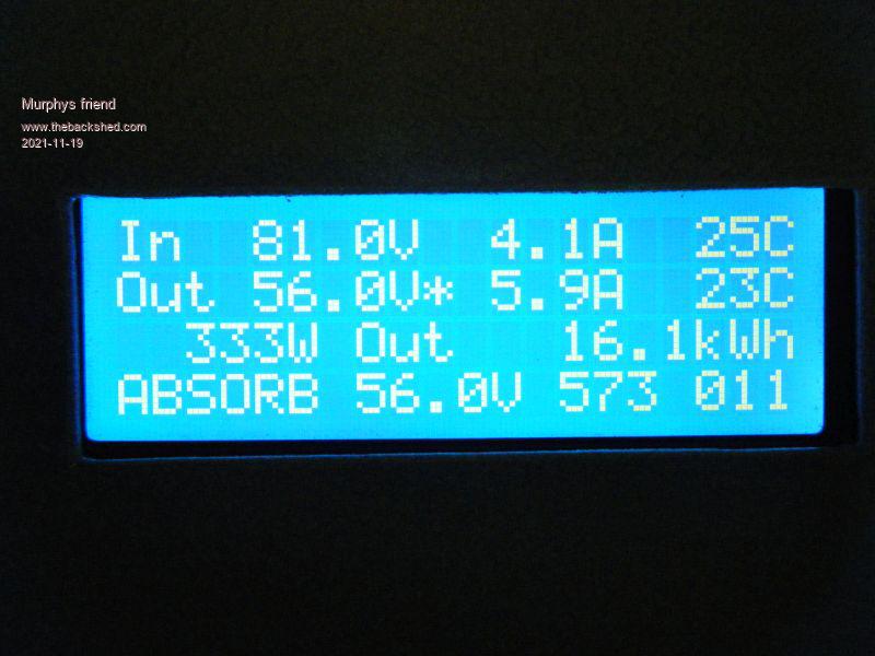

Posted: 07:50am 14 Nov 2021
Thanks Poida, that was quick .
The software version is mppt V5_BV_tempco.
I managed to calibrate the current sensors.

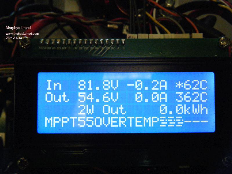

The display now reads this:
Could that overtemperature reading prevent it from mppting?
I do not have a battery temperature monitoring installed, these 200Ah lithium cells do not seem to get warm even with 100+ Amps charging them. All I need is the mppt to stop charging once the absorbing time has finished and the Voltage stays below 58V.
This home built MPPT is meant as a reserve unit to my other 2 charging methods (2KW back charging via inverter and a60A Outback MPPT charger)

Is the first thermistor you are using 10K NTC? It seems to read too high: 62C.
If you are not using second thermistor input connect 10K resistor in its place, should then read ~25C.
Edited 2021-11-14 19:42 by gaspo

the message "OVERTEMP" means the code sees an over temperature condition and
has stopped mppt-ing.
Maybe get back into the menu and disable overtemp shutdown by setting
heat sink max temp to something large, 1000
I like putting a 10K on the thermistor input pins.
This will make them 25C and this will be so for both choices
of wiring...
The calculated temperatures are only gong to be close to reality
when you use 10K NTC thermistors
AND
you have correctly set the option in the menu
"3 - NTC 5V or GND         (= 1 if 5V, = 0 if GND) "
If your thermistors have one pin connected to ground, then
you choose 0
If you have one pin connected to 5V supply (high side of voltage divider)
then choose 1
The firmware needs to do different calculations of the voltage divider
depending on the position of the NTC thermisors in the circuit.
Murphy's friend
Joined: 04/10/2019
Posts: 678
Posted: 05:27am 15 Nov 2021

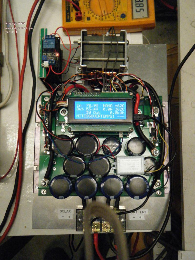

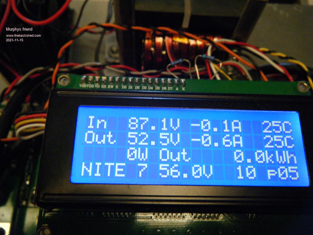

Thanks to your excellent suggestions I now have managed to trace and correct what I did wrong with the temperature sensors.
I now get this display (with 10K resistors fitted):
Unfortunately the nano has now decided to remain in the 'NITE' condition, any suggestion how to wake it up?
The voltages shown are what I measure at the terminals. No current since its asleep.
Thank you for your patience with my MPPT build.

have you set
M - Night power          (in Watts)
yet?
I have it as 5 Watts.
If it's not set yet, it might be NAN and so the mppt scan probably will
fail, and then no transition from NITE to MPPT/ABSORB
Murphy's friend
Joined: 04/10/2019
Posts: 678
Posted: 06:52am 15 Nov 2021
Have changed that from 10 to 5 watts now.
The display changed from 'MPPT' to 'ABSORB' after I applied a heavy load to my battery bank.
But I still cannot see any current on the display nor is any fed to the battery.
I changed the FOD3182 just in case - no difference.
I have a very small battery  operated digital scope that shows a steady stream of narrow pulses at 50us intervals. That changes to a 'wider pulse train' every 60 seconds and then reverts back.
Sorry, I do not have the fancy equipment nor the knowledge to use it to troubleshoot.
I'm hoping your suggestions keep coming until I got it going .

Joined: 02/02/2017
Posts: 1507
Posted: 07:17am 15 Nov 2021
the steady stream of narrow pulses is normal. It is the 1 clock wide PWM pulse.
I am wondering if both current sensors are showing correct values.
Should the input current sensor be wired backwards, increasing current will make
for negative power during the mppt scan.
The mppt scan looks for the largest power for the range of PWM duty cycle widths
from 5 clocks to near 100% duty width.
It expects power to increase from very small at 5 clocks and to increase
steadily to some maximum at some other PWM duty width.
The wider pulse train is normal and it is the result of the mppt scan

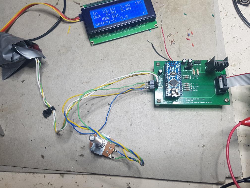

Maybe you could try running the buck converter firmware
on your power board.
This code will take the voltage present on A5 pin on the nano as the
drive for PWM width.
I have used this code very often (in particular, to characterise various inductors)
and it always works. It always drives the mppt board hardware well.
You will need some sort of load on the "battery+" and ground terminals.
I am wondering what exactly you have built and what signals are present.
the buck converter code is pretty simple.
It prints out on the nano serial console Vin, Vout, Iin, Iout
using manually set calibration factors in the code. Easy to adjust.
I have a potentiometer set up, with ground and 5V on both ends and
the wiper going to A5. The LCD is also active, showing this data.
The code will prove the hardware works.
The code takes the potentiometer setting as the required output voltage
and then adjusts PWM width to get it to be this value.
Current values are ignored. Just output voltage is to match the pot setting.
maybe try
buck_converter_nics_1_b1_nano_pwmserial_bb.ino.zip
The calibration values will not be correct for you, nor anyone else.
Everyone's builds are different.
 xVin = 0.1744;
 xVout = 0.0900;
 xIin = 0.235;
 xIout = 0.244;

Murphy's friend
Joined: 04/10/2019
Posts: 678
Posted: 07:36am 15 Nov 2021
  poida said  the steady stream of narrow pulses is normal. It is the 1 clock wide PWM pulse.
Hmmmm. I followed wiseguys PCB layout for the Allegro sensors. Mine are oriented at 180 degrees to his though. From the specs I see pin 4 is the input for unipolar devices so solar IN goes to pin 4 of the Iin sensor and choke out goes to pin 4 of the Iout sensor.
I'll do some measurements tomorrow and enter them on my schematic so I can show them here.

I just fired up my mppt board (Wiseguy's PCB) using 050U type Allegro current sensors.
I use this code
buck_converter_WG_b4_nano_sserial_bb.ino.zip
The code's calibration is
 xVin = 0.1564;
 xVout = 0.102;
 xIin = 0.0792;
 xIout = 0.0792;
 tIin = 0.00;
 tIout = 0.00;
 oIin = 127;
 oIout = 127;
 octrip = 0;
Note the oIin and oIout values. These are 127.
This means the offset for zero current is 127 ADC counts or about
127/1023 x 5V or about 0.62 V
xIin = the scale factor for the input current sensor
In this case it's 0.0792
To get Amps, convert the input to the usual 0 to 1023 counts from the ADC
Let's say it's 300
to get amps we go (300 - 127) x 0.0792
This ends up being 13.7 Amps
You get the idea?
Same for the output current sensor.
It uses it's own scale factor xIout
and it's own offset oIout
In the case of my build using Wiseguy's PCB and 2 Allegro 050U type
50 Amp sensors I have offsets for the sensors that are the same.
And scale factors for both sensors that are the same.
It is running, with the pot set to 8.8V on the output and the device has got
8.9V on the output.
the buck converter code (like the zip file above) does not care at all about
input current or output current.
It just works at one thing, to make the output voltage = the pot setting.
This will be good to see if your current sensors are working as you expect.
Edited 2021-11-15 20:34 by poida

Thank you for that, I'm now almost sure its the  current sensor calibration that's holding me up.
I  get 'G' =119 and 'H' = 118 when I do the zero sensor part of your setting up instructions.
Unfortunately doing your suggested buck converter bit requires messing with programming and I have all left fingers when it comes to that. So I prefer to have somebody who knows doing that and I will ask if there is no *very* easy way to change that 119 ADC count to 127. Instructions for dummies anyone? .
I have an oscilloscope hooked to the PWM output of the nano and was watching the narrow clock pulses you described earlier. They actually change in width, occasionally, for a whole 60 second cycle they are wider.
But no current flowing in or out of the MPPT board.

How to get you going with this..
No programming needed.
I have two concerns.
#1 is that the output current sensor is wired in a way that increasing current
gives a smaller output signal.
Should this be the case then the mmpt scan will decide it's not worth running
the converter and stay in night mode.
We can verify that the current sensor is correct using a power supply of some sort
and the DMM.
If no power supply with a current limited to about 5 or 10 Amps is available
we must make one. A 12V battery, one headlight globe of 60W or something.
Disconnect both solar array input and the battery bank.
We don't need or want this at all.
First, connect the DMM to the sensor output (solder a temporary wire if needed)
and ground. We will see about 0.5V when the board has 12V supply and with no current passing through the sensor.
Then connect battery positive to the current sensor terminal that goes to the inductor.
Connect the other side of the sensor (the Battery+ terminal) to the headlight globe,
then the other globe terminal to the 12V negative.
We have some current flowing through the sensor in the + direction.
We should see the DMM show an increase from the 0.5V to maybe 1V when the light is on.
If so, the sensor is hooked up correctly.
If it drops below the zero current voltage, then we have the cause of our problems
#2
Maybe the isolated 12V supply is not existing. Prove that it is on the two pins of
the opto coupler.
If not, then that is the problem.
#3
Maybe you are using the not-connected pin on the opto coupler.
Some of them do NOT join pins 6 and 7 together.
My recent power supply project caught me up with this.
I assumed the opto output was on pin 7.
It was not. Nothing was on pin 7
I had to bridge pin 6 and 7 to make it work.
Maybe you have done the same?
It's one thing to know PWM is present on the opto's inputs
and at sufficient current to light the diode within.
It's another thing entirely to have the opto's output connected
to the FET's Gates. Maybe prove that is good too?
Murphy's friend
Joined: 04/10/2019
Posts: 678
Posted: 06:46am 16 Nov 2021
OK, While I have been sitting here watching that CRO trace something in the nano woke up and the pulse tops are  up to 50us wide at times. Output power shown is around 55W and 1A Iout which tallies with the battery voltage.
I ran the batteries down a bit before that to entice charging but that is quite poor at present. How much charge current could I expect with nearly full width PWM pulses?
I'll add my schematics below:
Murphy's friend
Joined: 04/10/2019
Posts: 678
Posted: 07:00am 16 Nov 2021
Thank you for those very good suggestions.
I  did the 'E' and 'F' cal. amps set up with 8 Amps flowing through the allegro sensors in the right direction. I used the nano display to show that, did not think of measuring the sensor output voltage directly but will do that next.
Pin 6 @ 7 of the FOD3182 are linked by a PCB track.
I did look earlier at the mosfet gates and saw nothing, I just looked again and still nothing, what should I see there when its MPPT ing?
There is 15.9V at pins 5 to 8 of the FOD3182.
poida
Joined: 02/02/2017
Posts: 1507
Posted: 09:04am 16 Nov 2021
The Gate should show about 15V pulses compared to the FET's Source pins
which is the inductor connection.
You can not and must not use DC ground as a reference for the Gate pulse
measurement/probing.
If you do you will short the solar array input positive to ground
and bad things will happen.
Lucky you have a small hand held CRO so it can have it's ground lead
connected to the FET source pins (pin 3, right most pins)
and then see the voltage applied to the Gates.
These pulses should be nearly the same as the pulses coming out of the nano
only not 5V, but 15V
