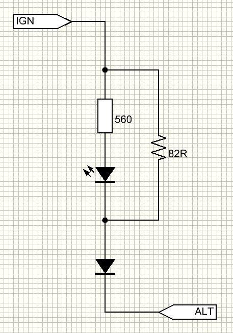

Posts: 9975
Posted: 04:37am 15 Nov 2021
This is what I have now, and it is working fine, so I will design this in so the dash is fully LED, and I should never need to change a blown bulb ever again for the life of the car.
If anyone sees anything fundamentally wrong with this arrangement, please let me know before I glue it all to the back of the dash!
Posts: 3293
Posted: 06:12am 15 Nov 2021
That would be perfect. On Bosch alternators your ALT goes to D+, for Lucas it's IND.
