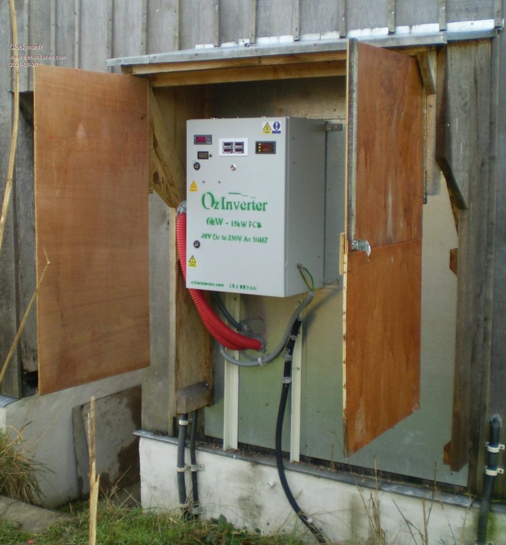

3      Your Inverter should have good access to air flow.  But keep the weather elements away from the actual machine.

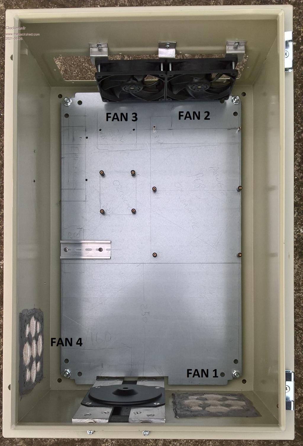

Excess heat in your inverter when under load, will lead to rapid wear down on the electronic components, notably the Capacitors and the toroid windings.
Ensure that the enclosure for the Inverter allows good air flow, for the PCB's and the toroid. And for the 6kW OzInverter I recommend the double Ozcooling circuit that's temp and delay adjustable, for sucking in with a 120mm diameter fan at the bottom blowing air direct onto the toroid and another sucking the air out at the top of the enclosure. And 2 more 120 mm diameter fans with the PCB boards that are fastened vertically.
Use stainless steel insect mesh to stop spiders etc from getting into the Inverter machine. As Oztules found out, "The local moths liked my LED's on the control board and snuggled up to it until the Control board shorted out."   Keep the insect mesh clear, its surprising that insects and debris soon clog the mesh.

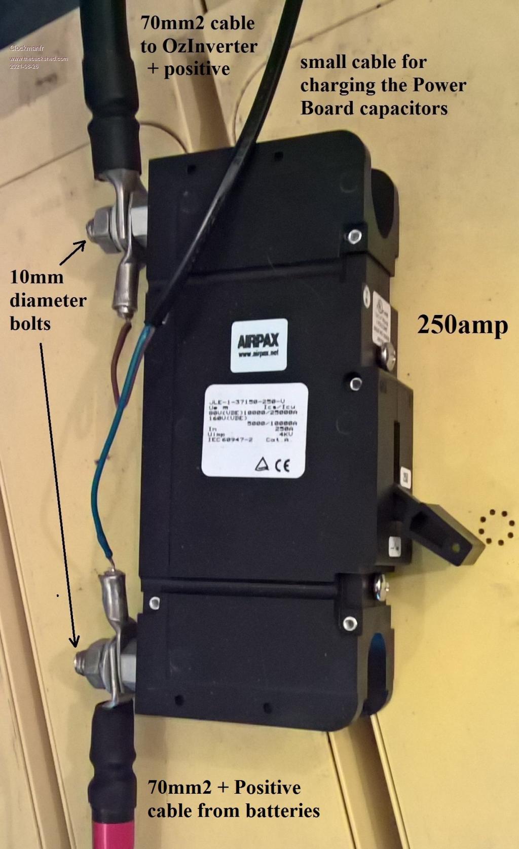

I have also seen that when a main 250amp breaker has been engaged in the battery room, for just a split second all the spider cobwebs glowed, so not a good idea to have electrical connections in the battery room.
For a permanent 24/7 inverter installation, a good solution is to have the Inverter the other side of the wall to the battery room, this keeps the 70mm/2 cable reasonably short, so voltage sag is minimal. And have the Inverter in a good weather/rain proof cabinet that keeps it dry and protected from beast and small animals, but importantly allows lots of air to flow around it.
Ensure your cables are encased in cable protection from the 'furry critters'.
Now some of you may say, "I will have the inverter inside my house", well firstly, the constant very gentle Hum from the hand made toroid and the Choke assembly are always there, and with commercial manufactured inverters under heavy load can sound like a bag of spanners.

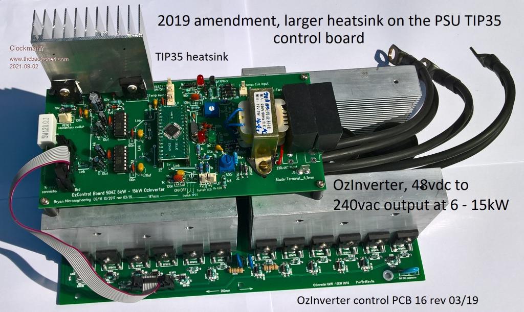

We have 24 FETs.
These are my standard boards, and also use these for the 8kW to 20kW OzInverter.
But to be honest, even with my large system, the 6kW-15kW OzInverter handles everything without issues. Where the 8kW-20kW requires a fair bit of extra work, and the toroid becomes about 50kg, that's 110lbs in your money, and becomes a hassle mounting it safely.  So i no longer recommend the 8kW-20kW.

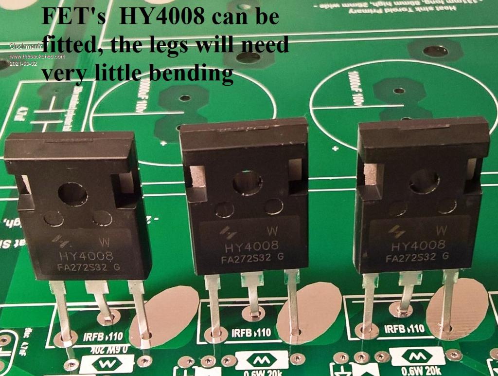

But I haven't used the power jack little mosfet boards for a long time
I use the ben and amber little mosfet boards that kent made for me
They use the 247 big size mosfets
Like the hy4008 or better yet the hy5608
They fit and work better than the pj ones he done a incredible job designing them
They are much cheaper also I have gave a bunch of them away and people love them
Ben and amber boards with the 360 amp hy5608 are the ones I melted the solder off the legs of
