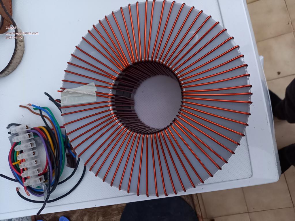

I had not finished removing old windings when I took this photo

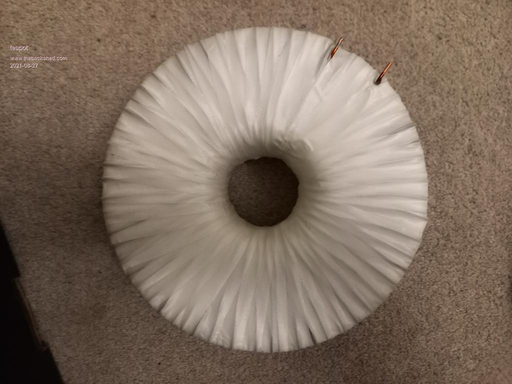

Doh! Unfortunately I had already wound the secondary yesterday before I saw the above message!
I wound it for 210 turns of 2.0mm dia enamelled wire, spread over three layers (continuous i.e. series, not multiple layers of 210x thin wire in parallel as described in your example), with each layer being separated by glass-fibre tape to minimise the risk of shorted windings between layers should the enamel coating be damaged by rubbing or other mechanical stress. I hope this will work else I have made an almighty c0ckup!
I'm wont to run the unit at maximum load (3.6kW) for more than a few minutes at a time (and have a 16A RCBO on the output anyway), so 2.0mm (3.1mm2) secondary should be fine. Any load lasting more than 5 minutes will be under 2.5kW.
I wasn't concerned about adjacent turns on the same layer rubbing and shorting as at ~0.6 turns per volt, one shorted turn is insignificant in the real scheme of things, so I wound them as close together as I could to minimise the number of layers.
I haven't yet measured the new inner hole diameter, but I will do when I start winding the primary after work this evening. It looks to be somewhere around 50mm though due to the thickness of the tape which is heavily overlapped in the centre area.
Assuming an absolute maximum of 16A at 240V AC, and efficiency of 85%, I expect a maximum average current of about 180A in the primary at 24V. Therefore I'm going to wind the primary with 12 turns of either 1x 35mm2 semi-flexible cable or 2x 16mm2 depending on what fits and lays best through the centre.
I will then tweak the primary turns and/or CSA after testing until I am happy with the performance under various loads.
I will of course power up the PJ with both the old transformer still connected, and the new transformer AC side disconnected, plus LV side current-limited by a large metal-clad resistor and use my scope to make sure that the voltage is in the right ballpark and I get the AC phase the correct way around before I disconnect the old PJ toroid and connect up the new transformer. This should minimise the chance of accidentally letting the magic smoke out of the PJ boards!
Edited 2021-08-26 23:19 by teapot

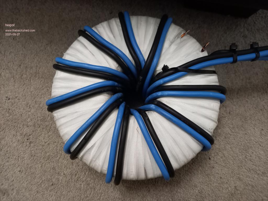

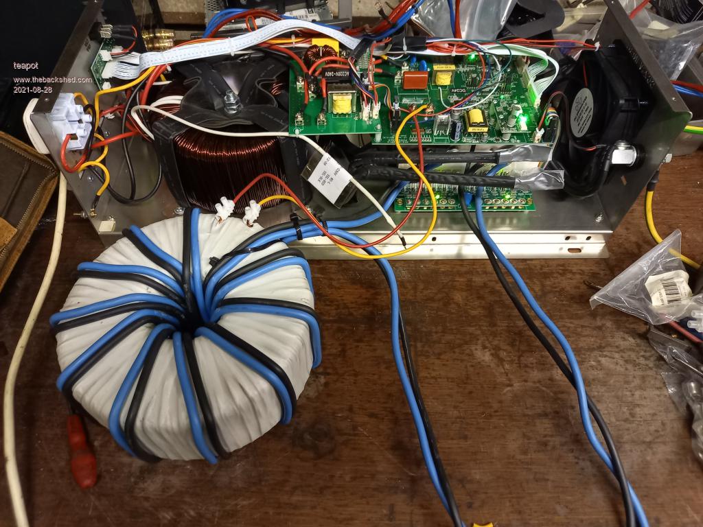

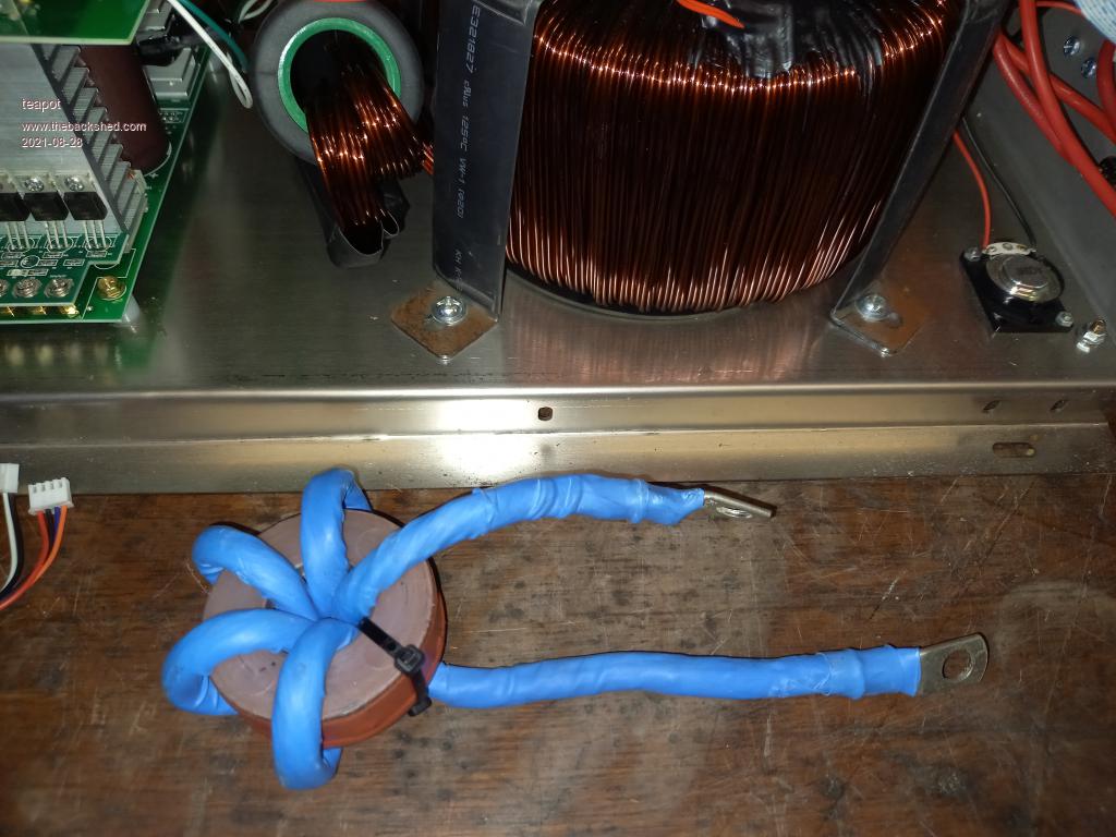

With a secondary consisting of 210 turns of 2mm diameter enamelled copper wire over 3 layers, each separated with a layer of glass fibre tape:
I only managed to wind 11 turns of 2x 16mm2 semi-flexible cable for the primary. Was aiming for 12 turns. Will test tomorrow evening and see what happens:
Posted: 10:14pm 26 Aug 2021
One single winding of 2mm wire will be 3.14mm sq as you say.
At 4 amps per mm sq that will be about a 12.5 amp secondary rating. Say 3Kw.
Primary wires size of 2x16mm sq will give a primary rating of 128 amps.
128 amps x 24v = 3 Kw.
This will run fine all day at 3Kw, and will easily do multiples of 3Kw for short bursts.
Eleven turns will be good as well. It just means the peak current through the mosfets and primary will be a few percent higher, but in the great scheme of things that does not matter. It may even be better, as it will allow for a lower final minimum battery voltage, especially as you are interested in achieving fairly high final ac output voltage.
This is going to work wonderfully well for you.
Well done !
Try connecting the secondary to the 240v grid, and measure the current, that will tell you the transformer no load idling power. This is a bit of a lucky dip, and depends mostly on the quality of the steel alloy used in the core, and its subsequent heat treatment. But it will be an interesting number to know all the same.

A cautionary note.
Even a single shorted turn will dramatically increase losses and eventually cook the transformer. It is a short circuited secondary and the current circulating in it will be very high.
That said the wire enamel is quite tough so damage during winding is rare. If you are concerned about vibration during operation wearing through the enamel give each layer a coat of varnish to lock the turns in place. Keeping the wire taut during winding usually prevents later movement without varnish.
For thin insulation between layers I have used oven bags cut into strips a few cm wide. It can survive 150 C.

Well good news :) Tonight's test was successful!
I couldn't work out which way to connect up the secondary wires to the PJ control board L/N terminals, so I took a chance, and powered it up using a bench PSU limited to 30A, to minimise the size of the fume event if I got it wrong! Thankfully it powered up and behaved as expected.
I don't know if it actually matters which way the two secondary outputs are connected to the control board, but thankfully if it does, I got it the right way around!

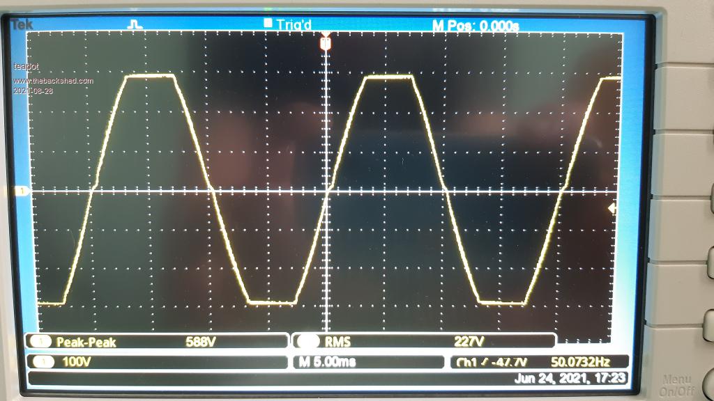

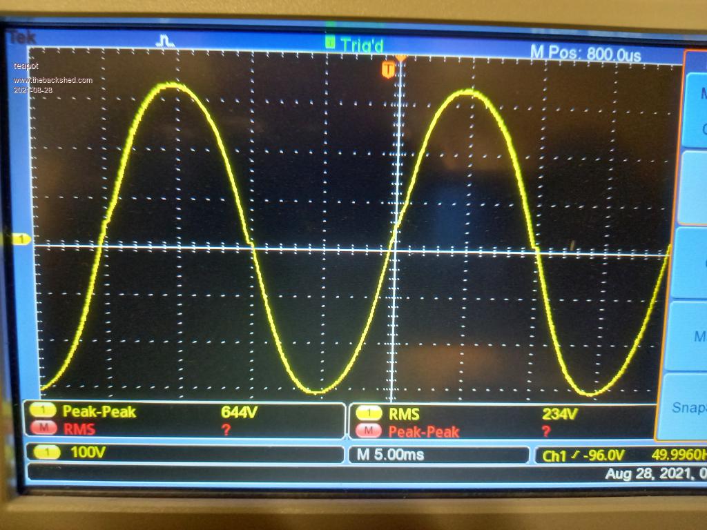

I did an extreme test - 3kW load with long undersized leads from my battery bank, which resulted in only 22.8V at the input to the inverter. Despite this, the output waveform was still near perfect as seen below. I have not done the resistor ladder mod yet, so it is still only about 230V.
It is a huge improvement over the severely clipped waveform seen here with a 2.5 kW load on PJ's own transformer:
I ran this for about 15 mins. The primary windings became very warm due to the high primary current. So some cooling will be required. But the core itself remained cool.
Here is a photo of the bodge-up on my workbench:

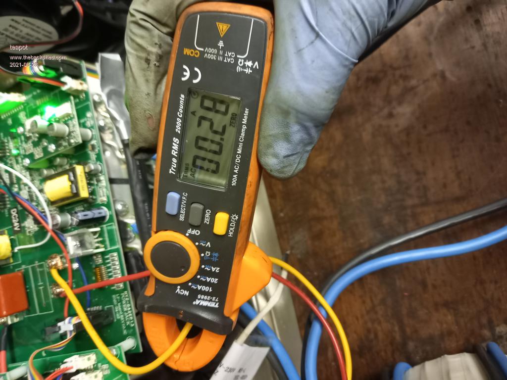

However the downside is that my DC idle current is now up from 0.6A with the PJ transformer to now 2.5A. Which is as bad as my old 2013 PJ 8k.
I also noted that there seems to be a 0.3A AC current on the secondary outputs even when no load. This is the same with my transformer or the PJ. I'm not sure why this is, as I would expect the DC input current to reflect this in the same way. It seems a bit mystic to me.
I don't know what PJ have done to get the idle current so low, as the only inductor on the primary is this tiddly little toroid with one turn. I made my own toroid inductor with more turns to try to reduce the idle current on the old 2013 PJ as can be seen in the foreground of this photo. Although it did halve the idle current, the core got very hot and made some severe deformations to the sine wave output, so I have not used it since and tolerated the high idle current on my old 2013 PJ.
I wish I could find a way to get the idle current back down to < 1A even with my new transformer, then I would have the perfect inverter for my needs.
Edited 2021-08-28 05:51 by teapot
wiseguy
Joined: 21/06/2018
Posts: 1335
Posted: 10:18pm 27 Aug 2021
There is a load on the secondary, usually a filter capacitor & because they use a small iron core transformer for the voltage sense circuitry. One has Xc reactance the other Xl and unfortunately unlikely to cancel each other..... There can be quite a phase shift between the voltage and the current so yes there may  appear to be 300mA of circulating current but the peak current is a fair way from the peak voltage so the true true power is much smaller. You need to monitor the current against voltage in real time to determine the true power or use a true power meter if you have access to a sensitive one.
I can't see a primary choke in your picture when you connected it to the inverter, it is important to have one, but don't use a high grade ferrite unless it has a good sized gap. A Powdered iron toroid or an iron cored inductor which you will find reference to elsewhere here is a must to reduce idling power. Using too many turns may ensure saturation occurs (depending on the core material - iron or iron powder is better) which can heat the core rapidly (and distort the AC output). Best to make up a saturation tester to assist in the choke design.
If you used the clamp meter on its AC setting to measure the primary current to calculate transformer input power this is also very misleading, to measure the true power into the inverter use the meter in DC current mode on the cable connecting the inverter to the battery.  An inverter can have high circulating currents in the primary yet be drawing a much smaller overall DC current.
Lastly, when measuring the toroidal secondary current whilst connected to mains to determine idling power of the toroid, the current by itself is quite misleading. My Toroid was using ~10.5 watts of power going by separate true rms I & V readings but the true power was only around ~6W using an accurate watt meter - around 60% difference !
Edited 2021-08-28 08:20 by wiseguy
