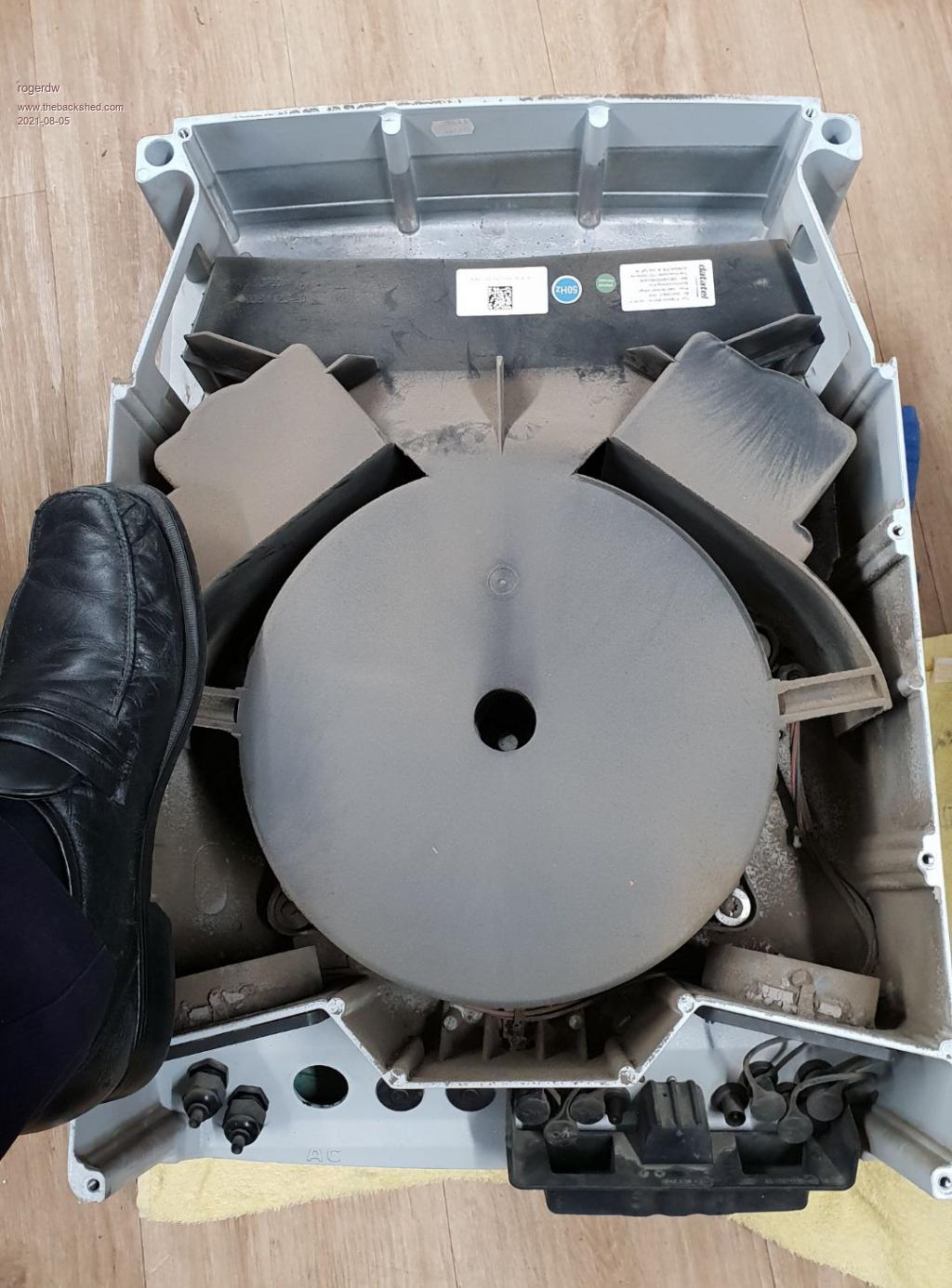

I went to order some sheet metal and have some bending done for my solar heater project and the guy was quite interested and asked lots of questions. Seems he lives off grid out in the scrub and has an interest in alternative technology.
Anyway, when I said what I did for a living (repair circuit boards), he pulled out his phone to show me a photo  ...  and said he'd been looking for someone to fix the board in his inverter, but because he couldn't find anyone, he had to buy a new inverter.
He just couldn't get his head around throwing the old one away  ...  and then asked if I wanted it. Anyway, of course I took it home  ...  and after having a look, discovered that it was a 12 y/o SMA built SMC6000A Sunny Mini Central  ...  even though it was dressed up in a nice green BP Solar case. Good for 6000 watts.

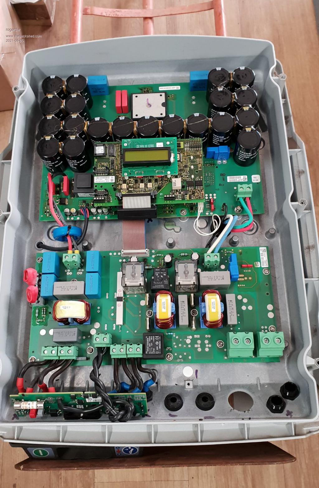

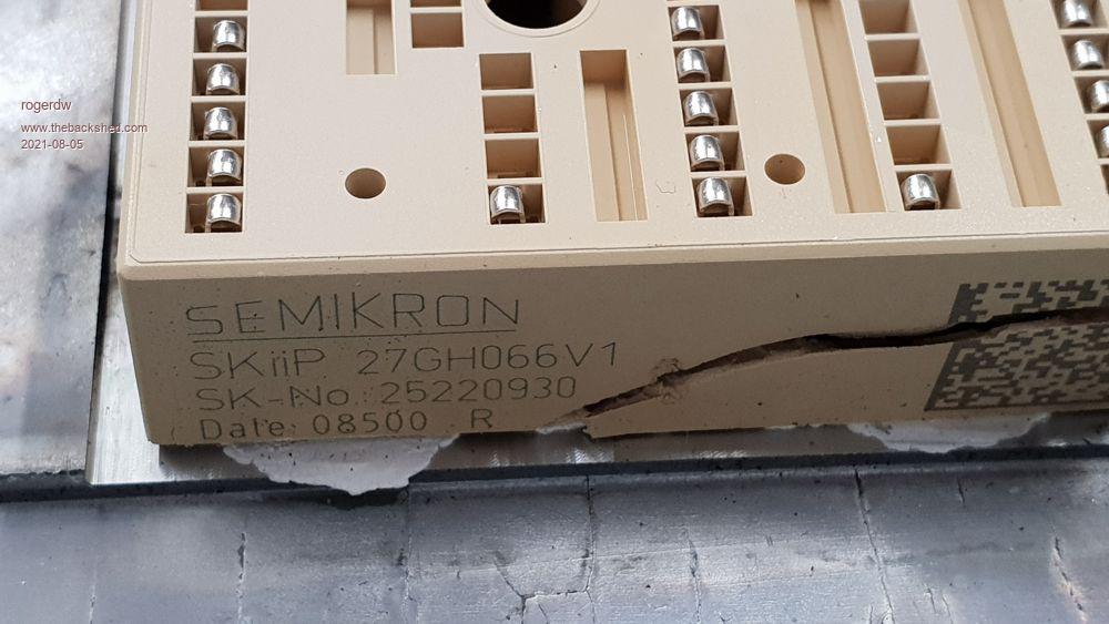

The photo he showed was of a couple smd components burnt on the main board  ...  but being alongside the main IGBT suggested that it was blown.
Half a dozen screws and the board was out and IGBT exposed and sure enough it had burst at the seams.

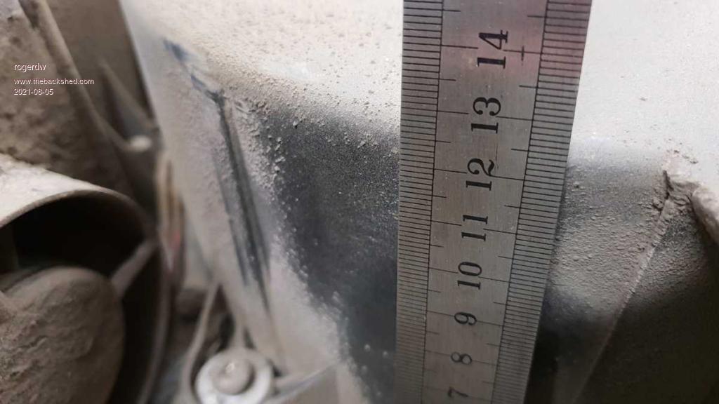

Then I realised that the front section of the unit was pretty shallow and started to wonder what was in the rear  ...  especially seeing it was so heavy  ...  63 kg.
Rolled it over and took off the nice flat aluminium cover  ...  and exposed what looked like a black plastic shroud covering the works.
Took out the half dozen screws and went to lift the cover off  ....  and realised the  cover had a toroid embedded in it from the other side  ...  and of course, unless I tipped it over again and disconnected the wires running to it, there was no way it was coming out.
There isn't really any finned heatsink at all  ...  just the huge mass of aluminium case  ...  and two fans that can blow air up either side of the toroid, past the IGBT mount position  ...  and out the sides near the top.

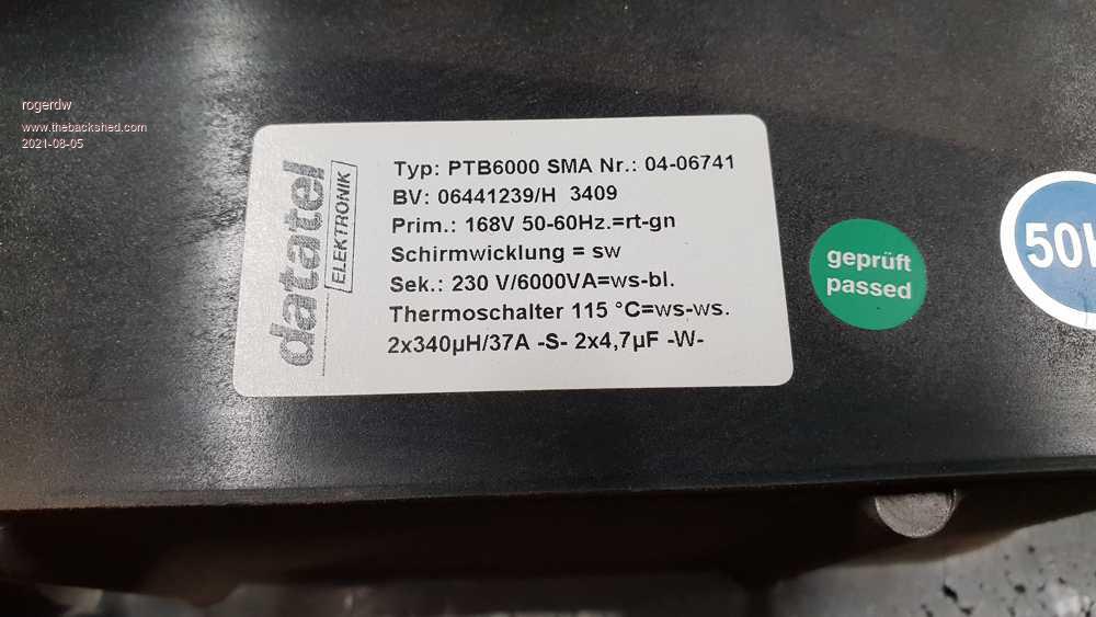

The cover also has a label showing that the tx has a 168v primary and 230v secondary at 6000va.

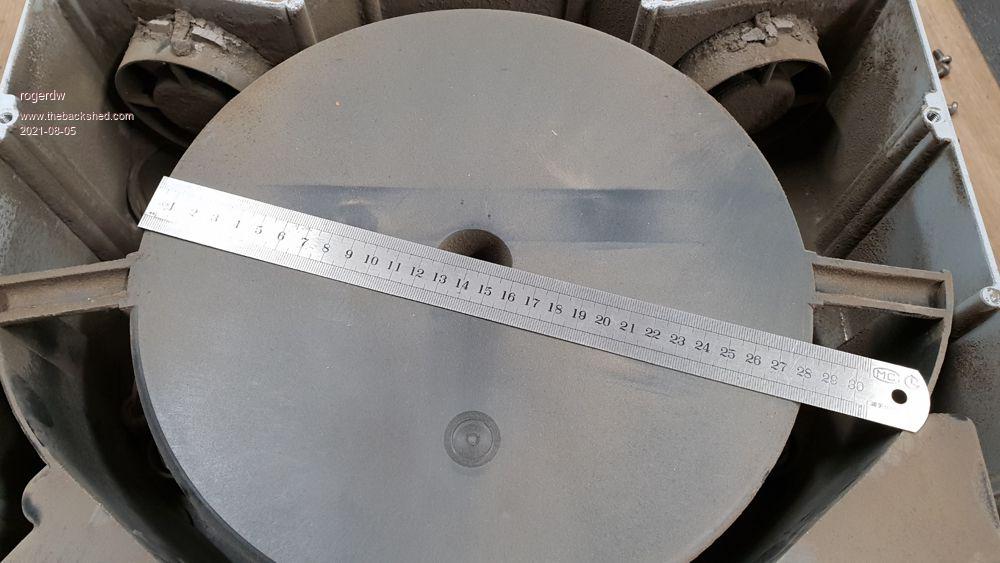

Of course, the other thing that struck me was the size. It must have a massive toroid glued in there.
Check out the pictures  ...  and imagine stripping a pair of these to sandwich together to rewind.
They're all 1000uF at 300v capacitors  ...  20,000uF 300v
That's my size 10.5 hoof showing here

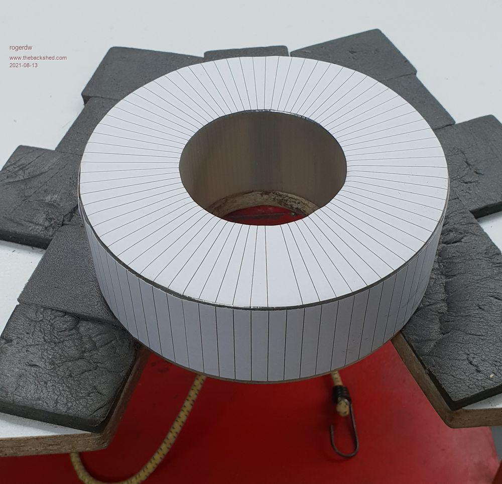

  Quote  Like Nicks unit no mylar on the outer just resin straight over and throughout the winding
So there's no way to save the top winding which is the primary I assume  ...  so I wonder about feeding it through a bandsaw.
Take off slices down through the outer layers so you can get to the windings and chisel it from there  ...  like taking the peel off an orange.
Now I've had some experience winding toroids, maybe it's just as well to hack it all off down to the bare core and start afresh with new wire.
  Quote  I hated every minute of every hour I slaved to finally get to the inner layer which is intact (minus the wire I broke off so a small repair to do sometime when I can bear to look at it again).
So you're saying you need a bit of time to think about if you're prepared to strip mine for me  ...  or was that a definite no?
  Quote  I tried every solvent in my arsenal to no avail the heat gun just made it stink and hot to handle - maybe you can make it work. the only think that softened it up a bit was brake fluid but I only used a small amount. maybe a couple of litres and let it soak overnight (or a few more) might pay better dividends.
Thanks for that, it's always helpful to hear what's been tried and what definitely doesn't work  ...  and what might be worth a second look.
