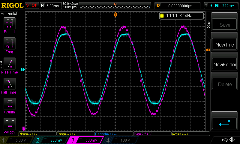

Time to see the output voltage and current of it.
First we see the Eltek running on street power.
Light Blue is voltage
Pink is current.
Arbitrary vertical scales.
Nice.
Very good power factor, almost the same as a bar heater.

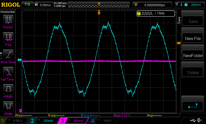

Now the genny, with zero load.
Gentech proudly promote the fact it's "less than 5% THD"
and it looks alright.

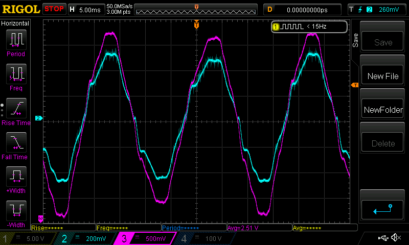

Now under load, approx 2kW from the Eltek PS.
Not bad at all.
The power factor is really high so that's good for the entire system
(genny, Eltek and battery charge current)
I am very happy with the unit and would recommend it to anybody.

Poida, the generator waveform looks pretty good but those spikes on the top and bottom of the sinewave look odd. If one were very finicky they could take it apart and reshape the pole pieces on the stator to put a bit more taper on the leading and trailing edge. But then as you say it is pretty good as it is.
I have never put a scope on a genset only rewound them when they blew up. Which happened a bit. I learnt early on that using one to weld all morning then just stopping it at lunch time was not good. The windings cooked themselves while I was having lunch. I guess my apprentiship wasn't totally wasted.
