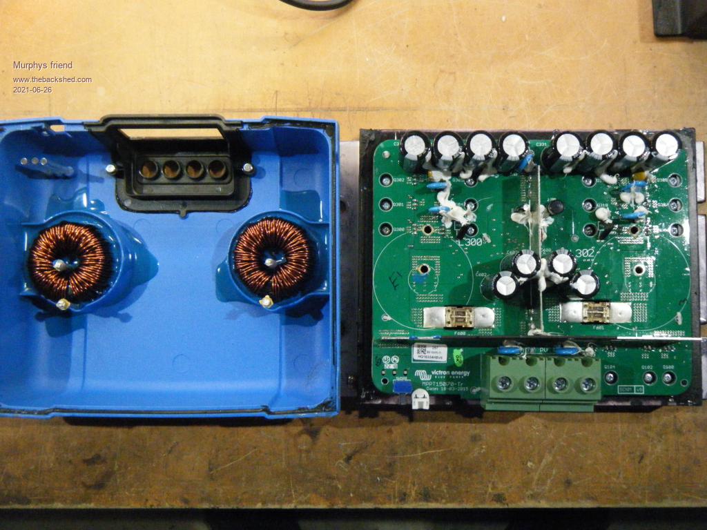

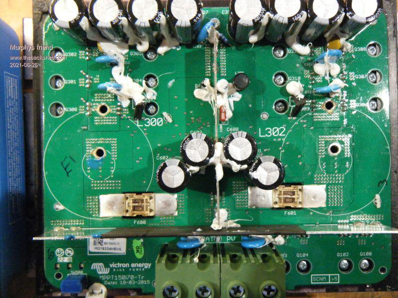

This worked very well until today when I checked the batteries (2 x 12v lithium in series), they were down to 12V - not good .
Disconnecting everything I found the MPPT was putting  out only 12V instead of ~27V.

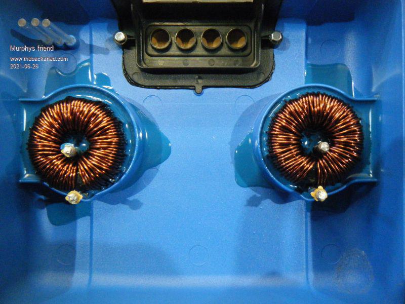

Assuming some link inside had come adrift i tried to open it - bad mistake . These things are designed to self destroy if one tries to open the case.
From the pictures one can see the choke wires in the lid have ripped out of the PCB.
The only way they could have assembled this unit was to pour liquid resin into the cups in the blue lid and screw the thing together. Once the resin has set it cannot come apart without destroying it.
I certainly would not recommend this brand to anybody. Having spent a working life repairing electrical/ electronic equipment and coming across something, which was rather expensive, made unrepairable really bugs me.

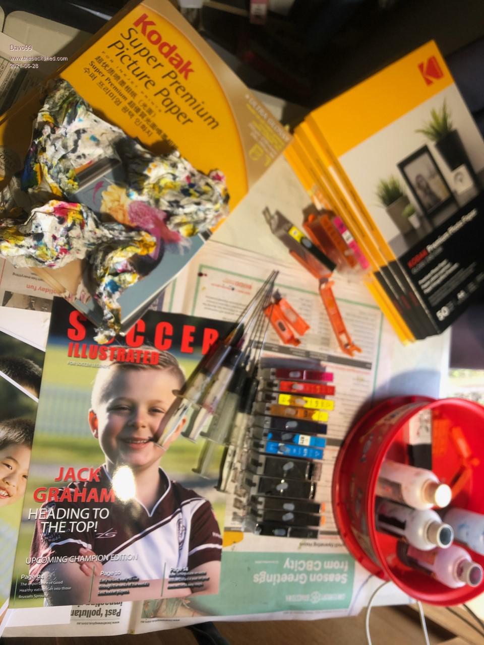

I did a similar thing many years ago in my game. Some popular equipment required a Cable that was ridiculous over priced because of  Proprietary  plug that was anything but special, just designed to force people into buying their over priced Junk. and Junk it was. One thing to pay for quality that last for years and is dependable, but when you are paying for sub standard junk that even other Chines cheap equivalents left for dead, that' different.  These leads were literally 40X what you could buy equivalents for.
In a rare inspiration and frustration, one day I tore into one of these things and as suspected, they were nothing special at all. I got another connector, a washer and converted the equipment to take the standard leads that could virtually be bought on any corner store For $2, Literally.
Took some pics, posted it on some relevant photo forums and within months people were doing it everywhere and reposting the into. It was the simplest, quickest conversion that any incompetent could do with ease and from what I saw, hundreds of people did.  I have no doubt what so ever the info became so wide spread amongst users of that equipment which was the go to in the day, it must have killed sales of those overpriced leads dead.

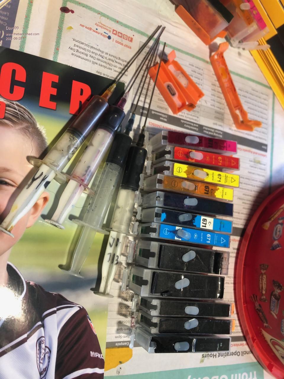

The other one I have no problem with is refilling printer ink cartridges. What  Take that is! They work heard to create this misinformation and fear mongering that not using their over priced cartridges is not only going to stop your printer working, they create the impression it's going to detonate and take your home and loved ones with it.
SO simple to refill these things and use them over and over. the ones I use are $25+ best price I have seen them. To refill costs literally under 3 Cents. I buy the ink in Liter bottles and get well over 100 Refils. At a $25 saving a Pop, easy to see what this is worth to me. I also do it or a few family and friends whom I put onto the right machines. Shed my dentist how to do it and gave him some ink after he complained how much it was costing him with his kids doing school assignments and got a lifetime supply of Syringes with blunt needles I use and gratitude that hasn't waned or failed to be mentioned in 3 years.
The printer I am using now just passed 1000 A4 full colour pages. I expect it will Mysteriously shut down soon even though it's now working perfectly.  They have a counter built in that keeps record of " Cleaning Cycles" and once the number is somewhere over 1000 Pages on the print counter in my experience is Reached, they stop in their tracks through a code the " Ink absorber pad needs changing."  That requires total disassembly of the machine and a Jig to re assemble it which to the best of my knowledge and enquiry's, not even the approved service agents have even if it was remotely worth the labour cost of doing it.
Something else to look after the environment with and reduce waste by throwing out perfectly good machines with who knows how much life left? Exactly what manufacturers don't want now days. Products that last.
Sounds to me Roger like you are helping a lot of people and doing a public service and a very creditable one. The intention of the manufacturer was basically to sucker people and and feather their own nest at someone else's expense. They know dam well what they are doing and do it anyway so to me, all bets are off and if I can screw them over the same way they are trying to screw others, I'll not only do it, I will derive great satisfaction and enjoyment from it and share with as many others as I can how to so the same thing.
Keep up the EXCELLENT work you are doing mate and feel duly proud of beating these greedy mongerals at their own game.

I don't know how many of those MPPT units shown above are likely to be around  ...  but it could be very handy for future reference if Murph could take some measurements.
First thing I'd do is drill through the coil holes and out the back of the case  ...  then others could know the exact location to drill from outside in the future.
How I would tackle one in future would be drill in through the case from behind the pcb  ...  at the four solder points for the inductors. Maybe a 8-10mm hole depending on the distance from case to pcb  ...
...  then unsolder the four legs  ...  and fight the lid off.
I can see some transistors or mosfets in close proximity behind there as well  ...  but once you know where things are and have taken good notes and measurements  ...  it's amazing how accurate you can get.

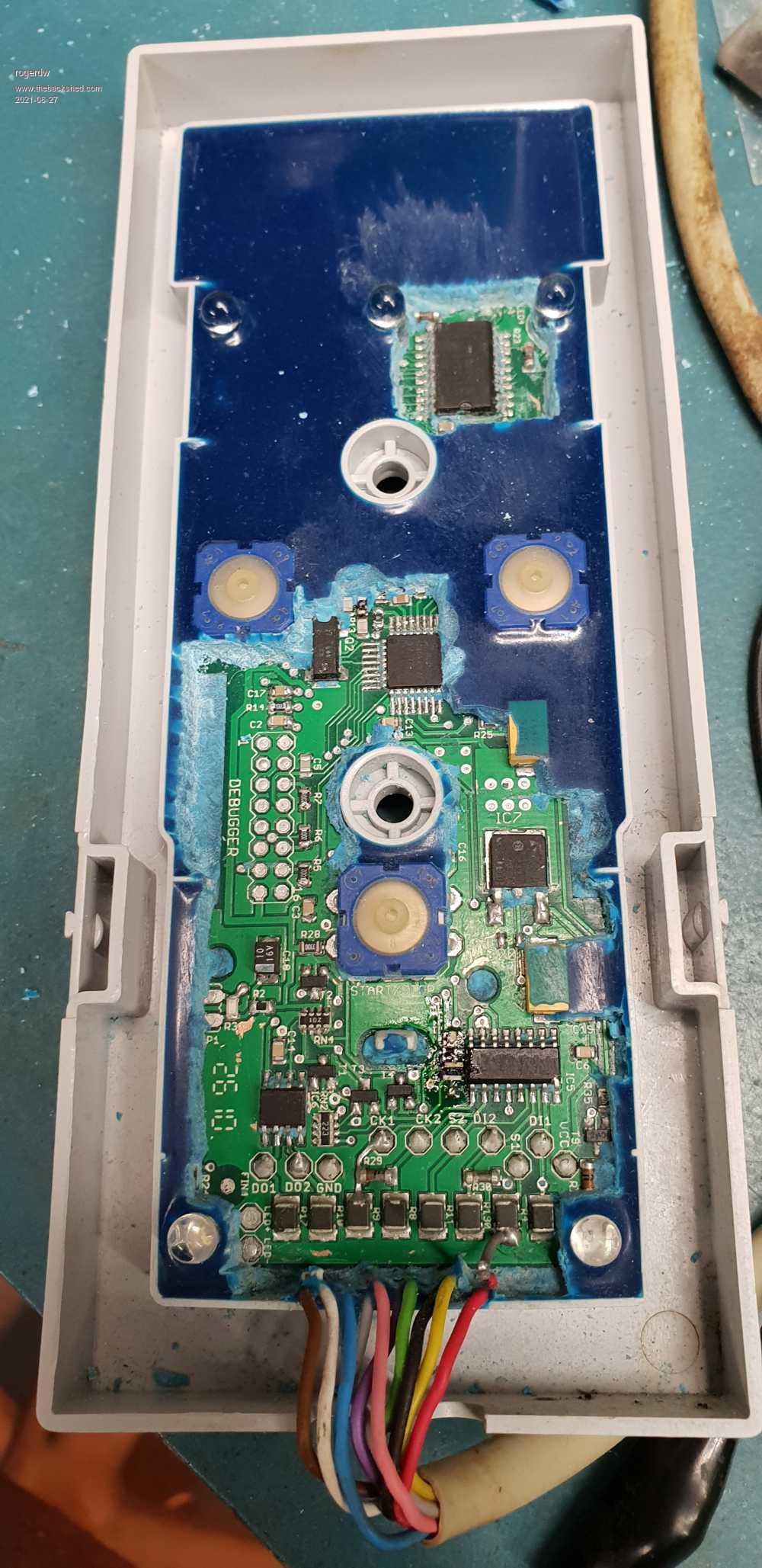

I first did some fully encapsulated boards about 40 years ago  ...  and after cutting a couple apart, discovered I could simply drill an 8mm hole, pick out the epoxy resin down to the board  ...  and resolder the dry joints on a particular electro.
I did heaps back then and saved a lot of people a lot of money.
There aren't that many different encapsulated boards that come in  ...  but there is one particular board that I have fixed hundreds of  ...  and they really don't take much longer than normal boards believe it or not.
The first one I saw kinda got sacrificed and over time I fully denuded it  ...  and any time I have a tricky fault on one  ...  I get that one out to guide me as to where to dig and concentrate my efforts.
Something I find amusing is that of the handful of techs I know around the world who fix this brand of equipment  ...  none of them will attempt this particular model. I keep egging them on and could get them a huge head start from where I started  ...  but somehow in their head, they believe they will be too hard to fix.
Only last week I had a board arrive that I'd never seen before. I haven't fixed it yet, but Ive made good progress. Of course, as a one off it wouldn't make sense  ...  but there are thousands of these boards around and sooner or later there's likely to be a steady stream if I can make them work.
The mess at the end of IC5 is the remains of a network resistor that I chipped  ...  so I temporarily stuck in some 0805 resistors on edge.
I very rarely find any chips that have had their numbers removed, don't remember the last time  ...  it's really only micros that are programmed that are a worry  ...  but in the vast majority of cases they are still ok  ...  except for the ones I have already mentioned.
This got me interested Davo. I just replaced my Canon printer because it started to make horrible clanking noises and refused to print. Cost of brand new printer and two included cartridges was $59.00. Now, a set of replacement cartridges costs easily that much so I wonder why they bother to have them replaceable in the first place?

  rogerdw said  I don't know how many of those MPPT units shown above are likely to be around  ...  but it could be very handy for future reference if Murph could take some measurements.
Good idea Roger but perhaps not easy with this MPPT. The inductors have 3 twisted wires (~1mm dia each) to connect to the PCB. The PCB is only 8mm above the heat sink so one would have to drill through the heat sink to get to the solder joints .
I could tell you exactly where the centers of the two torodial chokes are so one could drill a pilot hole through the blue cover and then use a hole saw that cuts bigger than the choke diameter to free them from the lid. Sounds messy .
When looking at the PCB underside, where all the SMD components are fitted, I saw nothing obviously busted. I assume it was a program failure that suddenly failed to recognise I had a 24V battery connected and decided to charge it with 12V instead - which is what I measured at the battery terminals. Solar input was 80V BTW.
This did no good to my expensive lithium battery but, fortunately, it charged up OK today with perhaps one of its nine lives lost.
