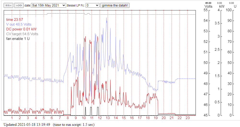

Last Saturday is typical. The Red line is inverter DC input power.
The light Blue line is battery voltage. Upper Grey line is constant voltage charge target. Black line is fan command, non-zero means it is running.
So from the above it would be sensible to make an inverter that is running
at it's most efficient when producing about 500W.
It spends so little time at the high levels I can afford to have it at a lower efficiency during those peaks.
My estimation of efficiency is something like 93% at 500W and maybe 91% at 2.5kW
(there are times when the inverter power is zero. This is when the battery voltage drops to below low voltage cut-off and so the inverter is switched off)
So, what is your load profile?

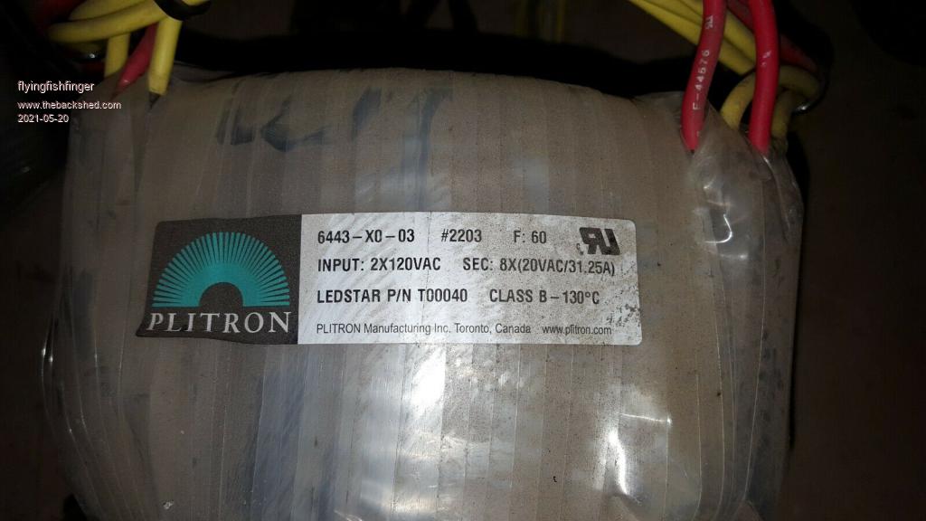

Oh, found something interesting: 5KVA transformer. It's local enough that I could make the drive to pick it up, so it really only would cost $60.
If we look at the last two pictures, they are of a beefy toroid. Could this work?
The ratings on the non-toroidal one are much better, though. I can't quite tell if I would get the toroid or the "square" one, but I have inquired...
R
Edited 2021-05-19 02:47 by flyingfishfinger

The toroidal in your link looks like a good start. It's all about the core dimensions and material quality. You won't really know what you have till you take it home and do some tests. If I was you, I'd buy 2 of the toroidals, take them home and run some tests. Unwind/rewind if necessary. Warpspeed is our resident transformer expert and may have more to add.

flyingfishfinger
Joined: 12/09/2020
Posts: 120
Posted: 10:32pm 18 May 2021
  Warpspeed said  What I suggest you do, is wind your toroid with TWO primary windings, and run them in parallel for now for 24 volts dc.
Fair enough! What do you think of the one in the 2nd link I provided above with dimensions?
R
wiseguy
Joined: 21/06/2018
Posts: 1335
Posted: 11:10pm 18 May 2021
I think the second one is too small for your needs (my guess is only 300 - 400VA).
For the price the 5kVA unit is a real bargain, despite the fact you need at least 28VDC to get your 120V AC rated output. Working backwards from a 24V supply you can only generate ~ 17VAC so at full power you will only have ~ 102VAC. But at times when fully charged you will have ~ 27.5V that will transform to ~ 117V AC.
I assume most power tools would still work fine with 100VAC and the kettle aint going to boil real quick either.  But the rating is for 5KVA, so running at say 1-3 KVA losses will be minimal (certainly less than at 5KVA) and you might get an extra few volts out you weren't expecting. I reckon set the output volts to say 105 and be prepared for it to droop a couple more volts as the batteries draw down.
Its worth the $60 from a learning/fun perspective and if you go to pick it up you can have a closer look at all those toroids he has lying around whilst your there, maybe you will strike gold !
Cheers Mike
wiseguy
Joined: 21/06/2018
Posts: 1335
Posted: 11:17pm 18 May 2021
Just had another thought maybe you can wire the secondary in series with the driven primary and get back another ~ 17VAC added to the output. Its unconventional but I reckon it would work fine.  The output voltage is then not isolated from the batteries any more so safety & attention to accidental grounding etc must all be considered. This is not intended as a long term solution just as a means to an end to get going out in the back blocks.  Now you can have at least 115/117VAC and know it will be that for 90+% of the time.
I should also add and clarify that our inverters have mostly (all?) used toroids. In that respect you will be a bit of a pioneer. The toroidals are a bit more efficient perhaps Tony could indicate what comparative losses you could expect, I reckon he has more hands on experience than I do in this area.
Edited 2021-05-19 13:42 by wiseguy
Cheers Mike
flyingfishfinger
Joined: 12/09/2020
Posts: 120
Posted: 04:43pm 19 May 2021
Apparently they're all the same.
Too bad, would have been nice to be a "pioneer" :) I think you mistook the first set of pictures. He's out of "rectangular" transformers, only has toroids left:
I was able to find a datasheet to go with it as well, attached. How much of this could I use as-is?
644303-1_toroid.pdf
