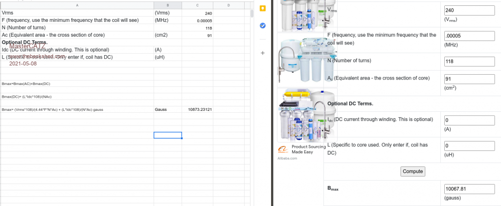

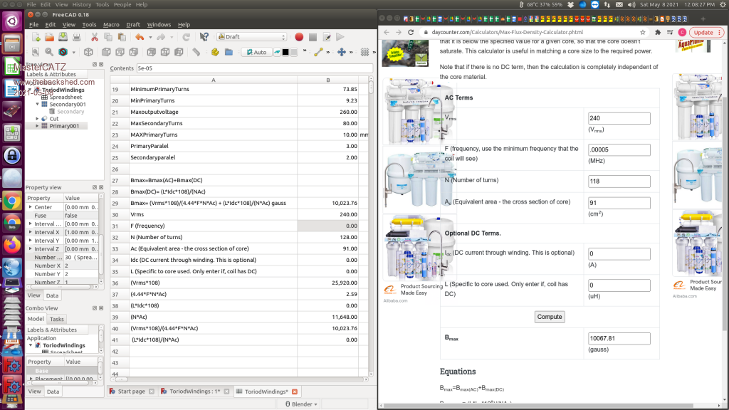

Bmax(DC)= (L*Idc*108)/(NAc)
what is L ?
not having much luck getting matching answers
using that webpage with your numbers
240Vrms 0.0005 mhz 240turns 4.8cm2 9384.38 gauss ?
and my CAD spreadsheets doing 10,135.14 gauss
if it was 9.1cm2 would you do 128 turns ? or 118 ?
just trying to work out where the variance is coming from my guess CAD is rounding up somewhere
yep cad rounding damn their goes that idea
(4.44*F*N*Ac) = 2.585856 not 2.59
Edited 2021-05-08 11:47 by MasterCATZ
Howdy MasterCATZ, sounds like a pretty gutsy machine needed. Good luck with it.
Not sure if you had a typo in your reply or you missed the detail  ...  but it is .00005 Mhz (four zeroes).
Cheers,  Roger

well their was that as well but did not affect the formula I just had to change to 91cm2
so the above question would be if you had 91cm2 how many turns would you do ?
I am leaning towards 128 as most seem to work it out from 260v ironically that is the number my rounded up cad gave me working with 240v
but working it out with 10,000 guass the turns seem higher ?
OzInverter with the 91cm2 did 80 Turns saying each turn was 3.25V?
back to being unsure who's maths to use?
Solder Seal Wire Connector Marine Grade Heat Shrink Wire would these be usable for joining wire in a transformer ?
if anyone knows how to stop freecad rounding I am all ears
google spreadsheet seemed to be closer still not a match
Edited 2021-05-08 12:48 by MasterCATZ

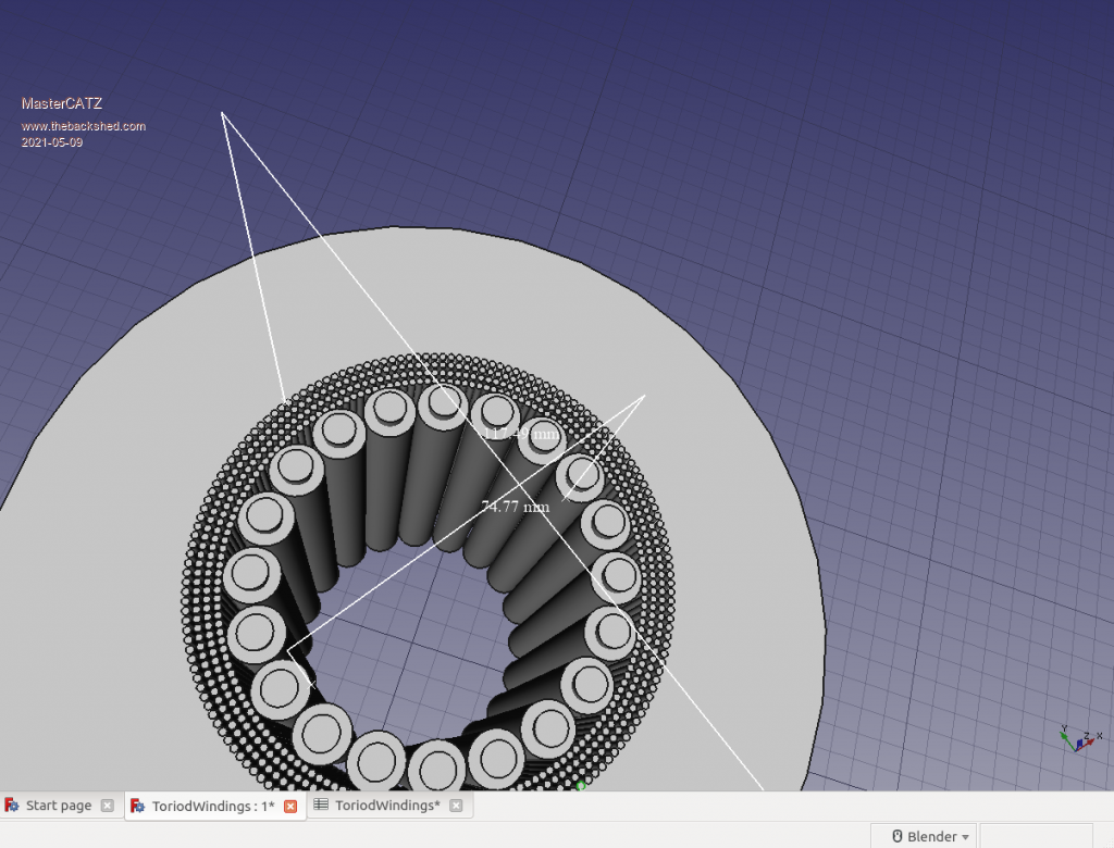

ie) 91.8mm diameter (external of secondary wire ) - 90mm diameter
(internal of hole )= 6 618.74 - 6 361.73 = 257.01mm2
and now I am wondering why that is smaller mm2 then 1180mm2  when I was working of each wires mm2
*edit* oh I see they would have to overlap only ~150 wires fit arround the core
97.2mm diameter (external of 4th secondary wire ) - 90mm diameter
(internal of hole )= 7 420.32 - 6 361.73 = 1058.59 hmm still a bit off
99.78 diameter (external of Primary wire )  - 91.8mm diameter (external of secondary wire ) = 7 819.46  - 6 618.74 = 1200.72 mm2 ?

if the Warpinverter is what I think it was , it required custom PCB work ?
I will only have 2x matching cores not 4x tho if I bought the remaining 2x working inverters they had instock for $700 I would have 4x matching cores
I do not mind having 2x separate units for redundancy and the PCB is only ~$100 to replace vs a HF transformerless inverter
well which method will be best ? I only want to build once :P
I have tried finding fish safe DC heaters and could not really find them 240v 500w stainless steel heaters are only $10 ea as well and because just about everything is plastic I did not want super hot inductors near them plus the battery bank is 100m away ... and the fish tanks span 20m
sticking with AC seemed the easiest option
and I worked out the
"Primary and secondary should each use up equal cross sectional areas of the hole"
1:8 ratio   Primary 1 / 8 Secondary
345 Amp 50mm2 = 6.25 mm2 wire , so I either buy 6-7mm2 wire to do the turns or reuse the 1.8mm wire = 3 - 4 winds , I noticed everyone is insulating between every secondary layer ?  I thought that being parallel it would not matter ?
Mylar Tape ? kapton ? or epoxy or ???
I was going to use this but its only 5kw and low temp
Name: PET  Insulation Adhesive Mylar Tape
Length: 66 meters
Substrate: polyester film
Thickness 0.055mm
Length: 66m
Temperature resistance: 130
Elongation: 100%
Peel strength: 250N/M
Breakdown voltage: 5.5KV
Electro-erosion coefficient: 1.0
Flame retardant rating: 94V-0
Excellent solvent resistance
currently also deciding between 50mm2 and 70mm2 not much price difference
any reason to not use flexible welding wire ? would this have too much vibration ?
doing 70mm2 I could do 5x layers of 1.8mm
mind you the more I look at this I feel I will be altering the core size ...
I do also do have a few rolls of 100m 6mm2 wire here , whats best multiple smaller strands and trying to line layers up or just using 1 wire ?
I am also wanting to run this on only fully charged batteries to use up all the excess solar power so maybe I should do the primary for a higher voltage ?
I do not plan on running it below 52V I normally keep batteries always above 50v the only inverters allowed to use power under 50V are the airpumps
would 1:7 Ratio be better for me ?
oh and another thing I run super caps with my battery bank
I read the  Gauss range is 10000 ~ 20000  lower the number the more winds = more efficienty ?
thanks heaps
Edited 2021-05-08 22:07 by MasterCATZ

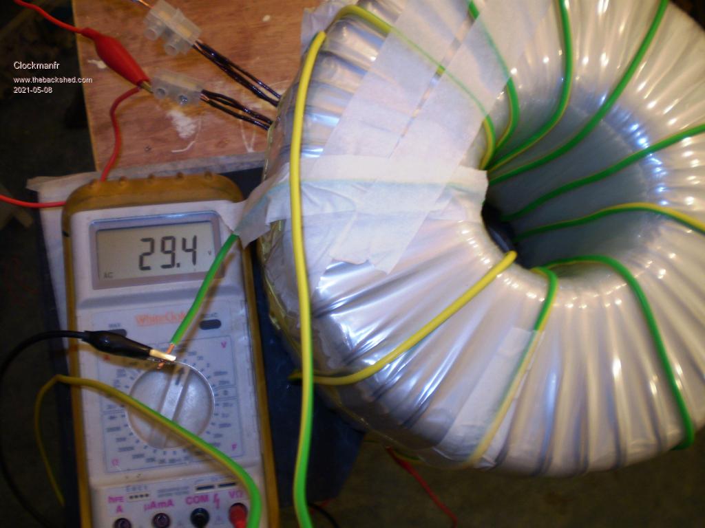

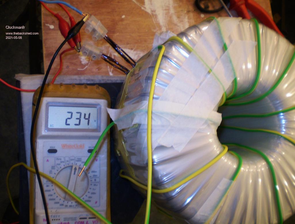

OzInverterNo2BookToroidC.pdf
Hi MasterCATZ,
Please find attached PDF on the tech stuff pages regards the torroid with the OzInverter. There are another 9 pages to the making the toroid Chapter.
Please note OzInverter book edition 1, was based around the toroid for the 6-15kW Powerjack boards and they required 30 to 32v for the processors.
For the 2nd Edition OzInverter book we have our own PCB's with the 8010 PWM SMD chip and this requires a voltage of 28 to 30v for a nominal 48v system.
For the biggest OzInverter i have done, i call it rated at 8kW the toroid bare core works out at about 38kg, 230mm OD, 100mm center hole and the core 140mm thick/high, then 80 turns secondary at 6off, 1.8mm diameter and just 10 turns of 1off 75mm/2 for the primary.
NOTE, at this weight of toroid the windings are being crushed, so good even winding and good mounting is very important.
TESTING ...... Big OzInverter toroid test, just using a 2.5mm2 test primary wire. ....... 234vac going in the secondary's
80 turns, after the step up light bulb process .... and 29.4vac reading on the Primary. So our initial winding calculations are correct. Remember if in doubt a few more secondary windings will not hurt. See test procedure later in Chapter.
The two photographs below, show the 8kW BigOzInverter toroid under testing, but here it has a temporary primary
cable/wire. The 8kW BigOzInverter has a secondary of 80 turns and a primary of 10 turns.
Remember we want the primary to read between 28vac and 30vac, and the below photo shows 29.4vac, that's good.  1st pic shows 234vac going in.
I trust this helps explain, but all the details are fully explained in the 2nd Edition.
Edited 2021-05-08 21:39 by Clockmanfr

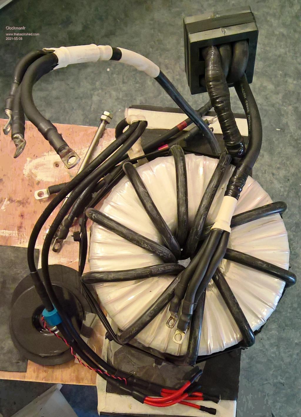

Clockmanfr
Joined: 23/10/2015
Posts: 437
Posted: 11:49am 08 May 2021
Here is the 8kW OzInverter toroid assembled.
Thats a 52kg lump.

MasterCATZ
Joined: 25/03/2011
Posts: 52
Posted: 11:35pm 08 May 2021
with the 1:7 mostly to make sure it will only run on full batteries as I am using the inverter to dump the excess power being generated
how ever I was told we have to manually start these so that may not work how I wanted anyhow, as I was just wanting something that would automatically output when ever their was excess power as this will only be connected to heaters
my thinking of using smaller primary cable was to allow the cables to fill in the voids around the hole better how ever yesterday I forgotten to add the sheath into the CAD so it looked like their was more space then their actually was
with the flexable welding cable being used as primary any other concerns other than the sound ? these strands would not degrade over time from vibration?
its running in the pump / compressor shed noise is of no concern
I was also planning on removing the external sheath
I was also thinking about 3D printing a winding template for spacing so each layer was directly ontop of the previous layer any issues with this ? I was planing on winding wire over it and leaving it their for each layer
or is it best for only the wire going down the hole to be aligned and have the external turns spreading out filling in the gaps ?
it looks like with the 70cm2 cross section of using 1 core if I was wanting to use 70mm2 primary cable I would need the core to be 220mm external 120mm internal 4 secondary layers 2.5mm2 of 166 turns 20 Primary Turns ?
does that seem about right to you , any benefit in doing this as a single core project? I figured having more turns might help the core ?
Edited 2021-05-09 11:45 by MasterCATZ
Haxby
Joined: 07/07/2008
Posts: 427
Posted: 02:31am 09 May 2021
Can you post a pic of the transformer nameplates?
Since you are burning off excess solar, transformer idle power won't be an issue for you.
If you are lucky, You might be able to modify the transformers you have without much work.
