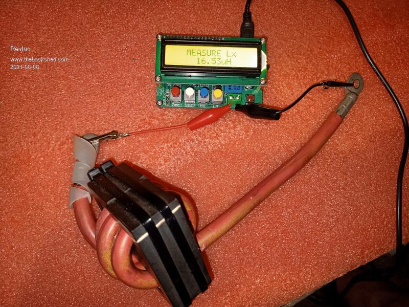

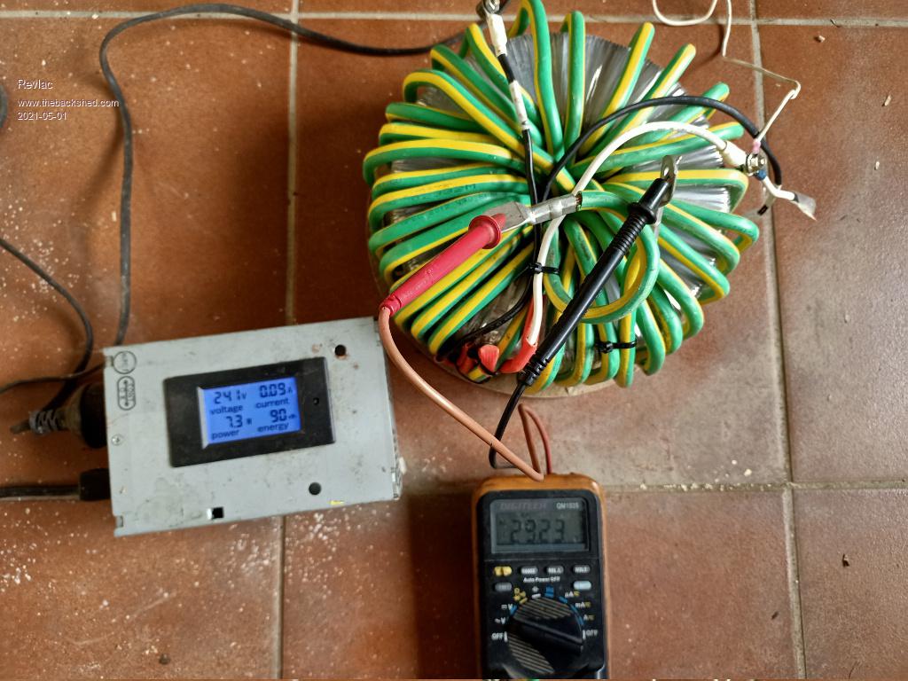

Tested the Toroidal transformer the other day using the light bulb as a soft start, then bypassed it with a switch.
Results are good, 240Vac in and 29Vac out at about 7watts, so now I have some working numbers to go with, should use the same meters later as there is some variation in readings between meters.
I think Most of the builds here were 28v on the primary, if we need to we could take a turn off the primary and go with it.
Next job will be to test the transformer resonance, found the test circuit on the bench, but the wiring diagram is somewhere amongst the paperwork on the bench, clean the bench up and probably loose other things in the process, it happens.

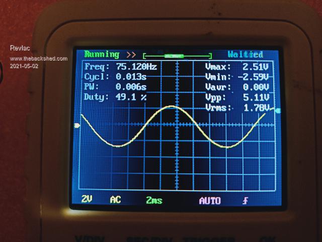

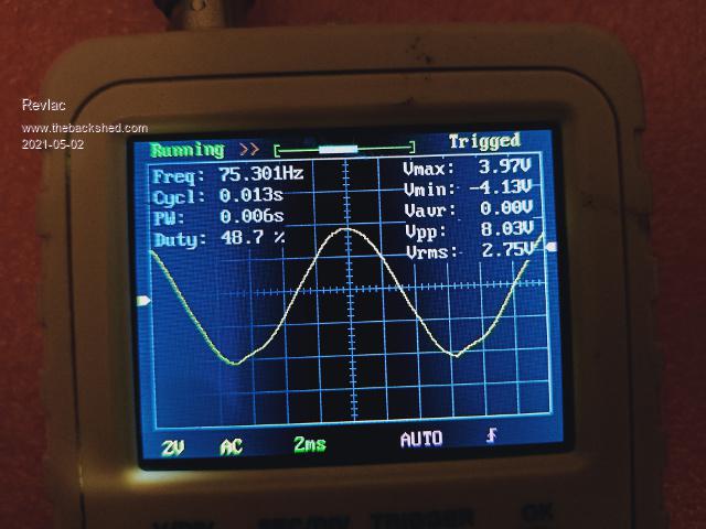

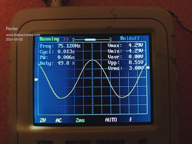

Been a busy day today, Did the resonance test at 75hz, to check the capacitance needed on the transformer primary.
The first picture is the wave on the primary without any capacitor connected.
The next is with a 1uf capacitor, there is an increase in peak voltage compared to the previous test.
This one is with a 3.5uf capacitor connected, quite a large drop in peak voltage.
Seems to be a lot less capacitance than expected so its always good to check this as all builds are different, I had a guess of about 3uf, that looks to be way off, I will try this again later to see it I did anything wrong, the frequency generator is getting a bit flaky, so might be time to make a new one.

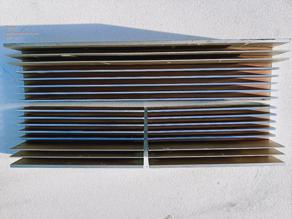

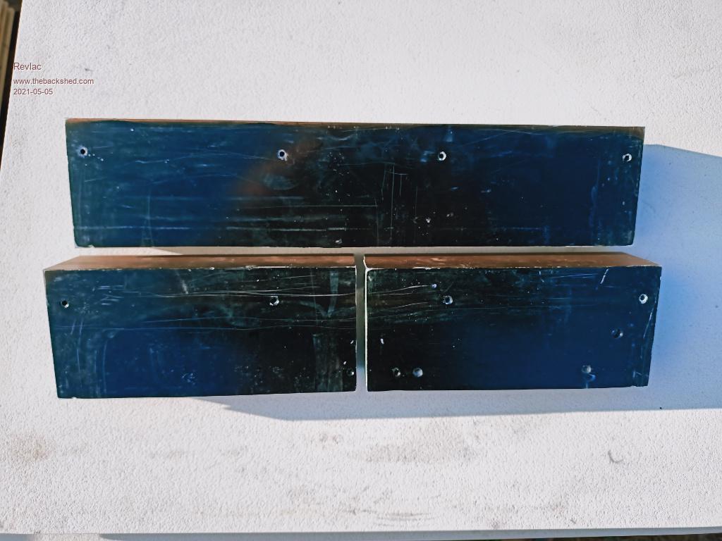

Working on the heat sink, not difficult to cut the large heat sink into 3 parts and trim down a few fins.
I used to build Aluminium boats, most aluminium cutting was done with multicutter, tungsten tip saw blade that has different teeth and grade of tungsten than your average wood saw blade, we also had a large metal cutting blade in the drop saw, very expensive and always use some sort of lubrication to keep the blade from grabbing, also prevent any buildup between the teeth that can break the teeth off..
The most we cut in one day was about a ton, That was a lot of aluminium shavings to sweep up at the end of the day.
You can also use those thin .9 or 1mm cutoff wheels, with plenty of lubrication (often) they will also do an exceptional job on small one off projects.
There is some existing holes in the heat sink, if they end up under where the mosfet mounts on, I think it would be good practice to clean the hole out and plug it up with some alloy rod or plug and level it off flush with the heat sink.
Next is the 20 or so holes to drill and tap.

I have a tungsten tooth blade in my dropsaw for copper and aluminium,,,I,ve been using a small squirt of WD 40 for the lib.  I used to use Trefolex , can,t spell that one,. Anyhow, what do you guys use?.

Did get some good rain over night and today, was outside the shed and started cutting these heat sinks, perfect opportunity for it to rain Heavy about half way through, and it did...
For cutting lubrication at work, we used some sort of wax on the Bandsaw and Dropsaw also used WD40 on the Dropsaw if we Didn't want too much mess, had to clean everything that was cut to achieve a good weld on aluminium.
For this heat sink, used some lanotec lanolin spray, it held on to the cutting wheel a little longer, also good on the flapdisc variable speed angle grinder sander, gives a much better finnish...

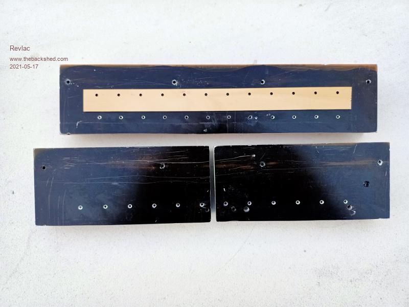

Made up a drill template and laser cut it into some thin plywood, not absolutely perfect but it worked ok and was helpful, Easier than measuring and marking each hole.
All drilled now but have only taped a few so far, might not need anymore than 4 fets per leg, should be enough power.
I think what I should have done was drill and tap some bigger holes and bolt a plate across the front of the mosfets to hold them down, same as have done before, still could do that if we need to.

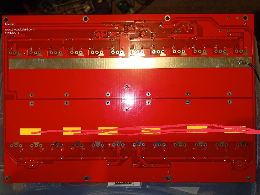

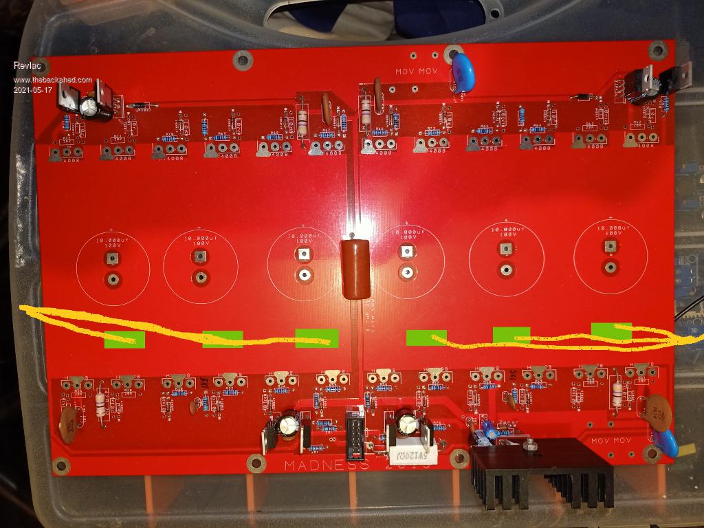

The 2 previous inverter builds have live heat sinks and the cables from the transformer and choke connect to the heat sinks, and have been running ok, weather that will give any trouble down the track I don't know.
Using the back of the mosfets as a connection is probably not the most ideal way to run parallel mosfets, this time round we might try to run multiple wires attached to the power board instead of just using the heat sinks, or connect both, perhaps a stud bolted through the heat sink to make it easy to connect.
Just a thought while tapping the small threads, Hope I don't brake the damn tap before the job is done.
I have drawn in a few wires and solder pads in the approximate area were the wires might go, looks a bit crude but hopefully it makes sense.
The negative is already done this way.
Cheers Aaron

Looks fine to me .  I'm a bit new to solder "pads" , I'll try my hand at a sample piece of PCB first ?.  I think I'll have to experiment with a couple different solder iron nibs ,have an assortment ,that I've never used. Plus ,I'll be asking you for solder and flux advice.
The tapping , I mostly do mine by hand ,and Yes, I do have that "Lanotek" Lanolene anti-siege lubricant for tapping.
Ribbon cable would be tidy for that fet pad connection ??.

Hi Aaron, thanks for posting the pictures. If you go for the multi wires approach, it should achieve what you want - try to keep the wire groups the same lengths. In your picture you only show the positive and 2 x choke connections what were you planning with the negative supply connection?
After having a bit closer look at the MAD board it was a pretty good effort, (despite my aversion to using ribbon cables).  The 2 x Gate drives for the upper sides should have been sent up through the centre divide instead of the longer treck around outside of the pcb (the bootstrap power trace could have gone around the outside - length of that trace is relatively unimportant) and the 2 buffer stages located more centrally similarly to the low side buffers PCB rather than the outsides, it all helps to reduce the length of the switching traces, I've not examined the board close up so there may be other constructive criticisms but nothing jumps out at first glance.
It appears you are only going to load the central 4 FETs first (a lot of gate resistors missing......) for a trial ?
When tapping into aluminium, if M3, depending on TAP type I do about a half turn and back it off to feel the swarf break - if its still not "totally free" back off a bit further before adding the next half turn etc & I am very liberal with the WD40. Nothing worse than tapping 16 holes and the tap breaks off - in the 16th hole and is next to impossible to remove and the last 2+ hours are then wasted.....
Cheers Mike

Thanks for the input Mike,
I did wonder about the wire length when doing it this way, The multi wire approach, it makes sense to have them the same length, will try to do that, if I can make it neat enough and not block any airflow between the heatsinks etc.
Depending on the size of wire I can find and amount of wires needed I Would like to end up with a total of at least 16mm2
The negative would be done the same way, I had a photo (lost it) of the other inverter with I think 4 (heavy gauge) wires soldered onto the plaited strip, each was a different length and all ended in a single crimped terminal hanging out from the end of the board about 200mm or so, Its working well.
This time I would prefer no wires hanging off the board, connections (except negative) to either go to the heat sinks, or might be better to have all them terminate on some base or mounting under the entire power board....something to think about.
Its a good working board and I thank Gary and others for making it possible for the rest of us to get something started and use, very pleased with the way it works, I'm always interested in other ideas and ways things can be done.
Will do the usual test with 1 fet per leg first then just do 4 per leg and leave the rest as an option, I noticed last time the power consumption (unless its my imagination) change a little with the amount of fets driven, will see if that's happens this time round.
I agree with the assessment. It's not optimal but it works pretty well, at least good enough for the girls I go out with around here (AvE reference)
From the experience of using these boards for years, I am happy to continue using these boards, now slightly modified by me for a few more years.
Board blowups now are a thing of the past for me, thankfully.
When they blow usually a bit of a PCB trace is taken off to The Maker as well.
I found having the FETs soldered into the board with 15mm pin lengths to be very good.
It lets you mount the heatsink further up from the caps. It gives some separation
from PCB and FET when they blow. It lets you get the side cutters into them to cut them out when it blows. It makes it easier to desolder the longer pin leads compared
with short leads. The HY4008 pins are rated at 70 Amps continuous so they usually
do not fail. The failures usually are within the TO-247 package and or the PCB track.
I kind of want a weak spot that is the long pins rather than having the weak spot being the PCB. But all this is my opinion.
Now I have gerber files for the power board and can get them for $25 it no longer seems such a big deal when they blow. Just rip out the big caps and make a new one
with all new passives, diodes, transistors etc and using the salvaged caps.

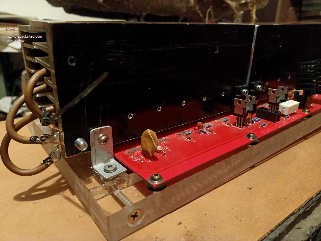

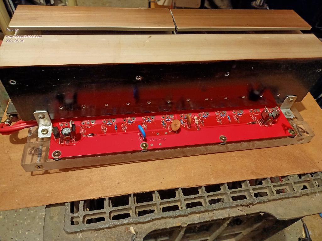

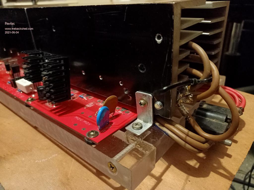

A little more progress when time permits.

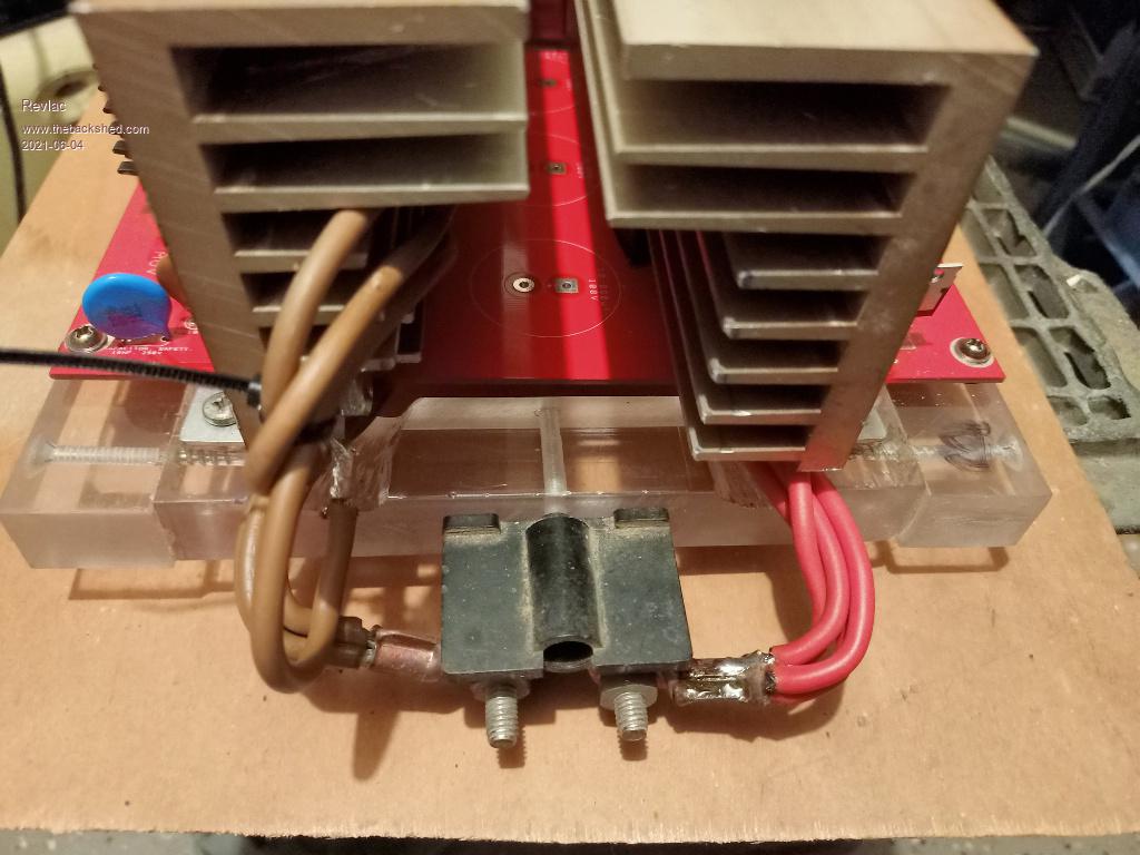

The wires are now connected to the PCB and are the same length, they are attached to the heat sink with a bolt, and can be bolted on the front of the heat sink as another option, the transformer and choke leads can go onto those bolts.
Heat sinks have a small brackets at each end to help steady and strengthen it all up.
All mounted on some strong perspex frame that can be mounted easily.
The mosfets are not in yet, there is some length for the mosfet legs, I could add a little more but will see how it looks later, still some holes to plug up on the heat sink, I also plan on going over the face of the heat sink with the orbital sander when ready to place the mosfets in.
Still more to go.

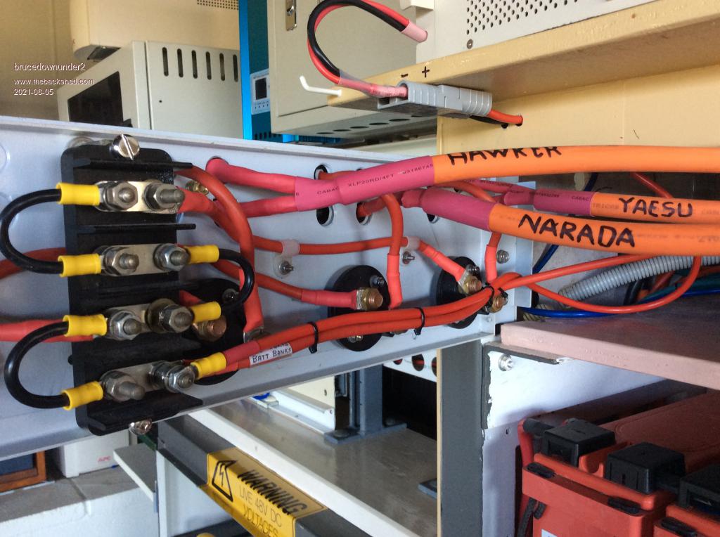

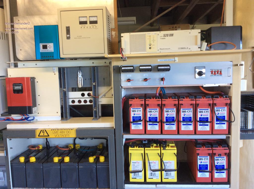

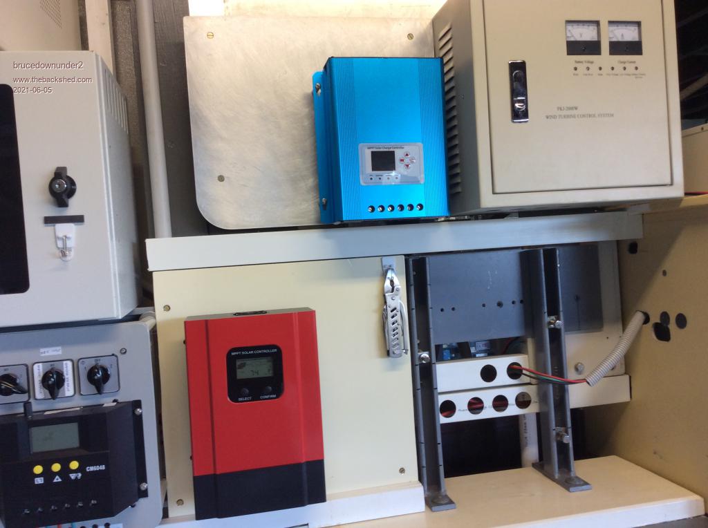

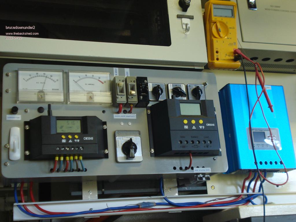

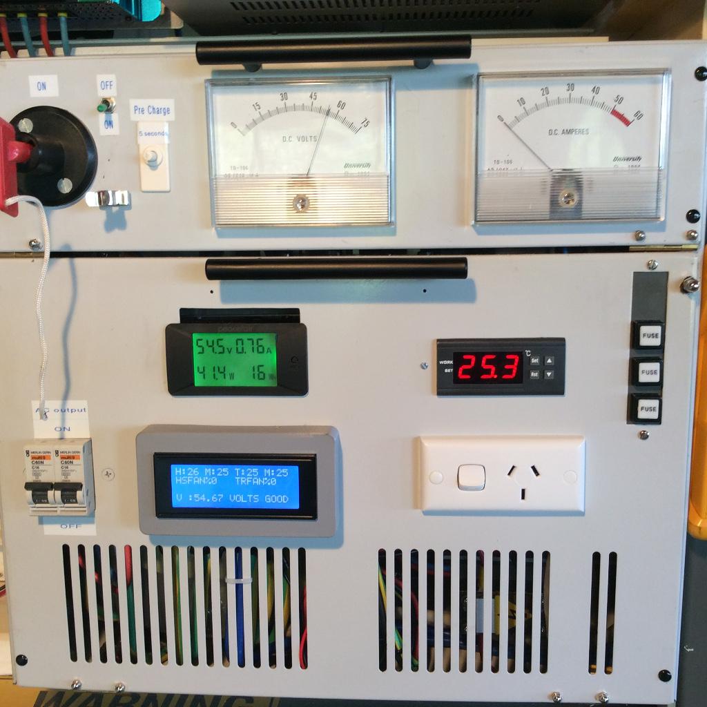

I've been working on my end ,sorting out some refinements to switching between batteries and controllers, more or less for redundancy if parts fail and the ease of charging more or less in a battery bank.
I'm interested in installing a fork-lift type battery bank in the future, with the idea of being able to stand-alone off home batteries.
Here's a shot of the control panel I've finished, apart from the rotary switch which will be operational soon.
Have a nice day ,
Bruce

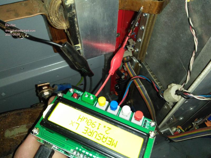

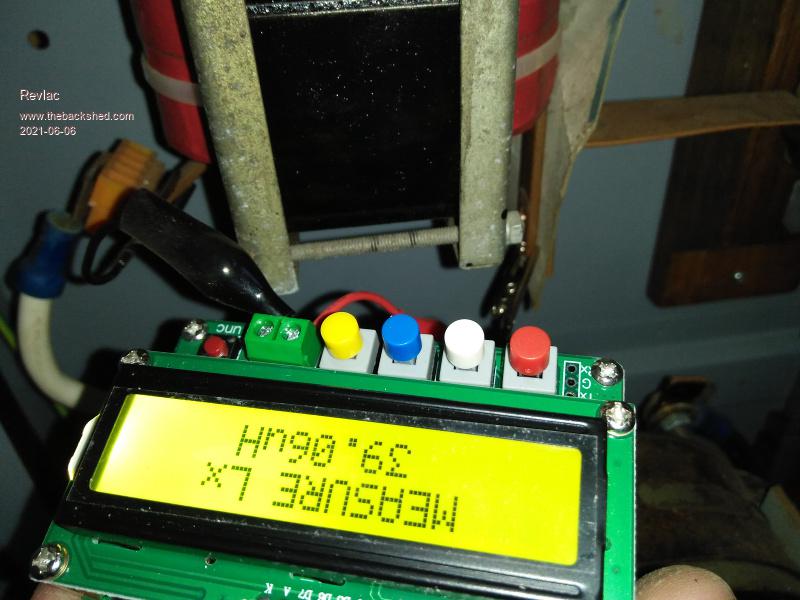

Measured the choke that Bruce has wound up for this inverter, and the Lc meter reads 16.5uH, this looks a bit low compared to others, unless I'm mistaken.
Also I think it will need a small spacer inserted where the ferrite  butt's together, for this EE choke, without any gap its likely going to squeal or something.
I made up a double EE choke up for my other inverter (Details elsewhere), have since tested that with the Lc Meter and that come to 2.2uH, so will remove that as its not doing much.
The other large choke I made up for my other inverter (again Details elsewhere) tested 39uH and that inverter is running well with it, Roughly 90% efficient at 2000w.
Its the same dimensions as a pair of aerosharp chokes but made of thin silicon steel strip same as the toroids, I think we may have to make one of those, from some scrounged parts.
Edited 2021-06-06 18:36 by Revlac
Cheers Aaron
