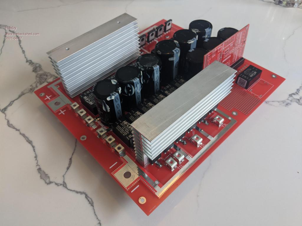

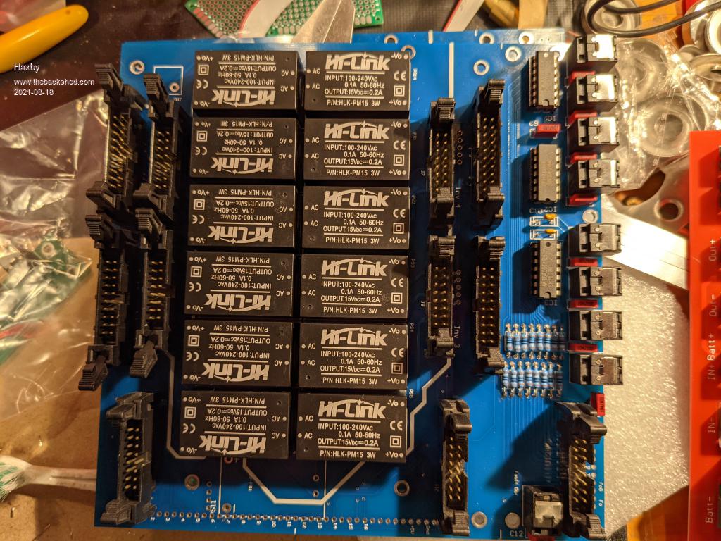

I'm building 3 of my single phase power boards, one for each phase. This time I'm using GW80V60DF IGBT's. They are rated at 120A at 25 degrees C, so they should withstand a short across the output for the duration that a C-Curve breaker can trip. This is a really important factor, and makes designing for over-current situations pretty simple. The heatsinks will need to dissipate 40W each at full load, so a fan will be required for each one. The 4 IGBT's on the far center only need to dissipate 1W at 50% duty cycle at most, so I won't put them on a heatsink for now and see how hot they get.

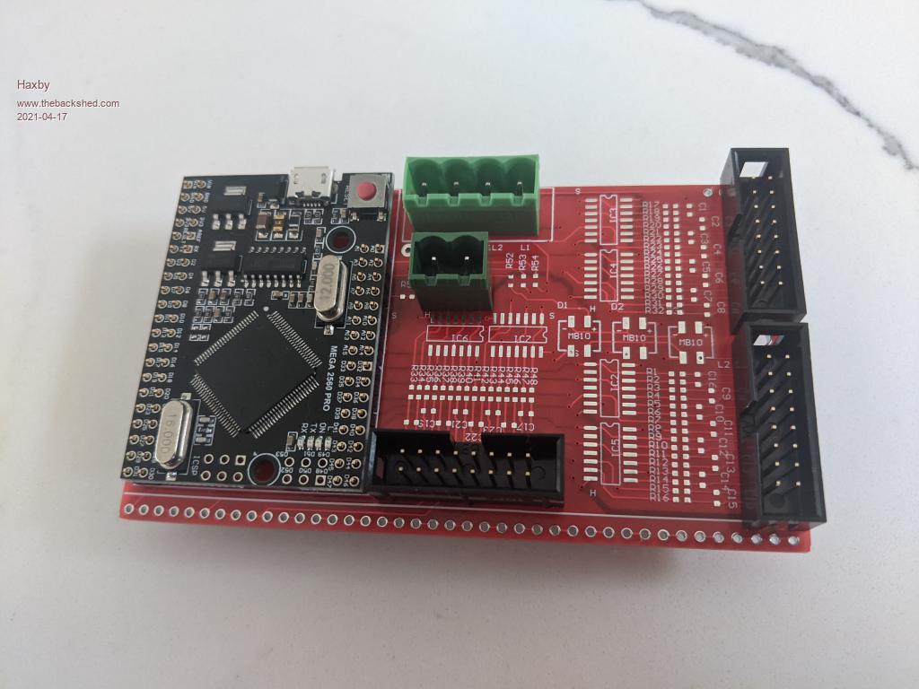

And here is the control board running Poida's code. I like through hole components as much as the next guy, but this has to run a total of 48 IGBT drivers, so the component count is very high. If I didn't use SMD components, it would have to have been a large 4 layer logic board. Not very desirable. So I went with a Mega 2560 MINI, and squeezed everything on one riser board that could live on the middle power board. It's no higher than the heatsinks, so the whole single board can still fit in a 2U rack mount box. You can see the 16 pin IDC connectors that go to each power board. The 2 pin connector is the on/off control, and the 4 pin connector is voltage feedback from 3x off-board transformers. I'll coat it heavily with some conformal coating spray once all the bugs are ironed out.
I haven't tested the board yet, just waiting on components, I only scoped the mega mini to see the familiar step traces. Hopefully I haven't stuffed it up!

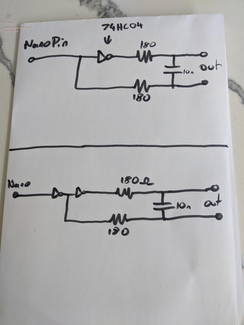

Warp you've got me thinking whether I should have buffered the nano output with another hex inverter gate before breaking out the signal to the big bad world:
Top pic shows what I did. Bottom pic shows what might work better.
Thoughts appreciated! (As always)

Gents, I'm considering scrapping the logic board and re-designing a new board for better EMI protection.
As it is now, there are 24 wires coming out of the processor that are going straight to each power board (via 180 ohm resistor). The distance is about 30cm.
I'm thinking of optocoupling each one before it exits the board.
I'm concerned about common mode noise being picked up.
Am I paranoid?
poida
Joined: 02/02/2017
Posts: 1507
Posted: 06:12am 24 Apr 2021
I think you could use optos for the output of the board, and have optos
also on each inverter board. It seems like a lot of bother but I see it as
differential pairs for all signals.
This adds up to 48 wires, 24 pairs.
24 optos on the controller, and 24 on the inverters, 8 per phase.
This will isolate a lot of rubbish from the logic source.
I expect there are quad optos on SOT format, maybe even 8 optos per package.
I have not bothered to have a quick look in digikey.
(looks at first thing on digikey...)
TLP292-4 is only $0.67 AU with 4 channels. So you need 6.
All 24 opto outputs could be driven by a single DC source, isolated from all
the rest of the logic. Ahh, but then the 24 outputs will not be isolated from each
other. Maybe no problem then, since we need about 5-10mA to drive an opto diode
and EMI is usually of the order of a few uA.
Haxby
Joined: 07/07/2008
Posts: 427
Posted: 08:22am 24 Apr 2021
My (possibly unfounded) paranoia is that EMI could get back to the mega processor and lock it up.
So I'm contemplating either running each mega output through a hex inverter 74hc04 for "some" protection or completely isolating each output with an optocoupler.
I don't have any experience with EMI so I don't know how valid my concerns are. But a locked up processor would be game over to 48 IGBTs!
To be clear, the signal wires are already "balanced" in that each pair already connects to the LED of the igbt driver chip. Nothing else. No ground loops.
But even though there are no ground loops, I think that having 24 pins of the mega, coming out 30cm from the board, completely un-buffered, may be a bad idea. How bad an idea is hard to judge for me. Could just having a ferrite clip-on bead be enough? Not sure.
Posted: 11:20pm 24 Apr 2021
I believe you definitely need opto isolators located right at the mosfet gates to prevent anything upsetting the gate drives directly.
Its right at the individual switching bridges that all the electrical violence is at its worst.
I believe we are already all in full agreement that the lower mosfet gate driver circuits in the bridge require full galvanic isolation, and the same treatment as the upper mosfet gate drivers. The driver should bond as closely as possible directly to the mosfet source to work independent of the very noisy main system ground.
At the other end, the control board is just driving into a fully floating LED through a rather long twisted pair. Almost nothing external can get into that to upset the gate drive signal.
Any induced common mode voltage will be shunted by the low impedance of the buffers and the 180 ohm series drive resistors. I cannot see that ever being a serious problem, especially if the heatsinks are all grounded.
"Live" heatsinks connected directly to the lower mosfet drains may capacitively couple into the gate driver leads, but if you are aware of this possibility, its not difficult to physically separate the drive wires from any live heatsinks.
Unless the drive wires actually lay directly over a live heatsink for quite a distance, I doubt you will have any issues.
The real evil is in the overall system grounding.
Nowhere will there be a nice solid noise free ground that all your analog and digital systems can be referenced to.  This becomes especially bad as there are four inverters not one. Phil will have twelve inverters running, and as long as the whole thing is thought right through, there should not be any more noise or EMI problems than with just a single inverter.
Posted: 12:01am 25 Apr 2021
One further thought...
If capacitive coupling into the long gate driver leads does prove to be a problem, you could always use twin screened (microphone) cable.
Do not connect the screen to the microprocessor ground, but connect just one end only of the screen to the main dc power system ground at one end or the other.
I cannot see this being necessary, but its always good to have one extra trick up your sleeve.

A bit of paranoia is actually healthy in applications like this. In my opinion & experience, in noisy environments I place a minimum ~100 ohms in series and close to each output from the micro. Looking back towards the uC any outside noise has a low pass filter of 100Ohms and a few pF which greatly attenuates the fast edges that are likely to be the cause of any trouble.
Using an opto for each output I think is overkill. I like your proposed scheme of 2 x HC04's and  the 2 x 180 Ohm resistors, but I would still include a series resistor  between the uC and the first HC04 buffer if there is room, nothing wrong with belts and braces. As Tony suggests, keep the Opto drivers as close to the FETs/IGBTs as you can manage is also optimal.
Probably obvious, but good PCB layout then to keep external (noisy) traces at the edge of the board & well away from any of the uC pins & traces. If there needs to be a physical connection/s between the uC PCB ground and the power stage ground (ie for measuring Vin etc) a ferrite bead/s can also help.
"having 24 pins of the mega, coming out 30cm from the board, completely un-buffered, may be a bad idea in my experience" Totally Agree.

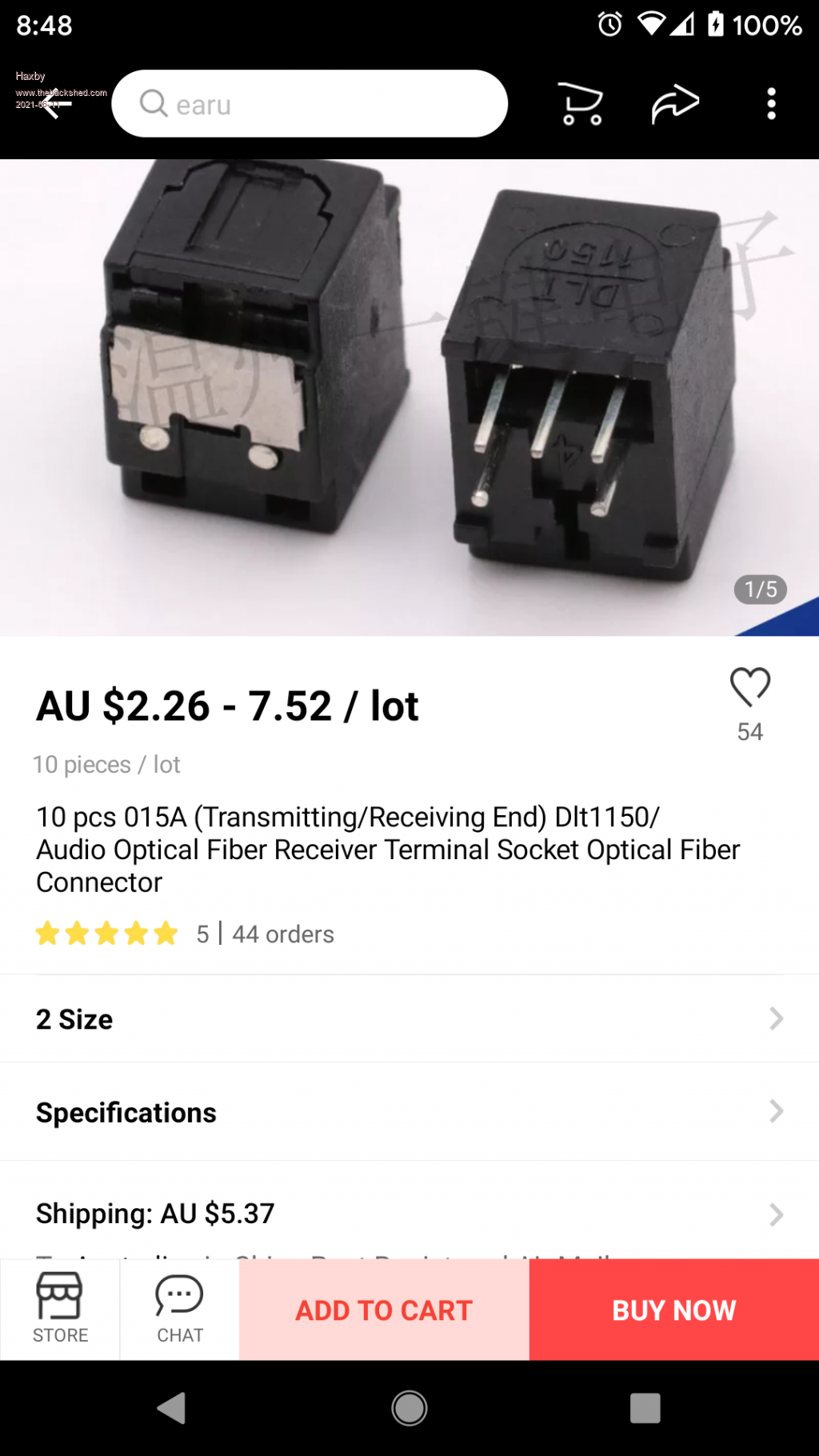

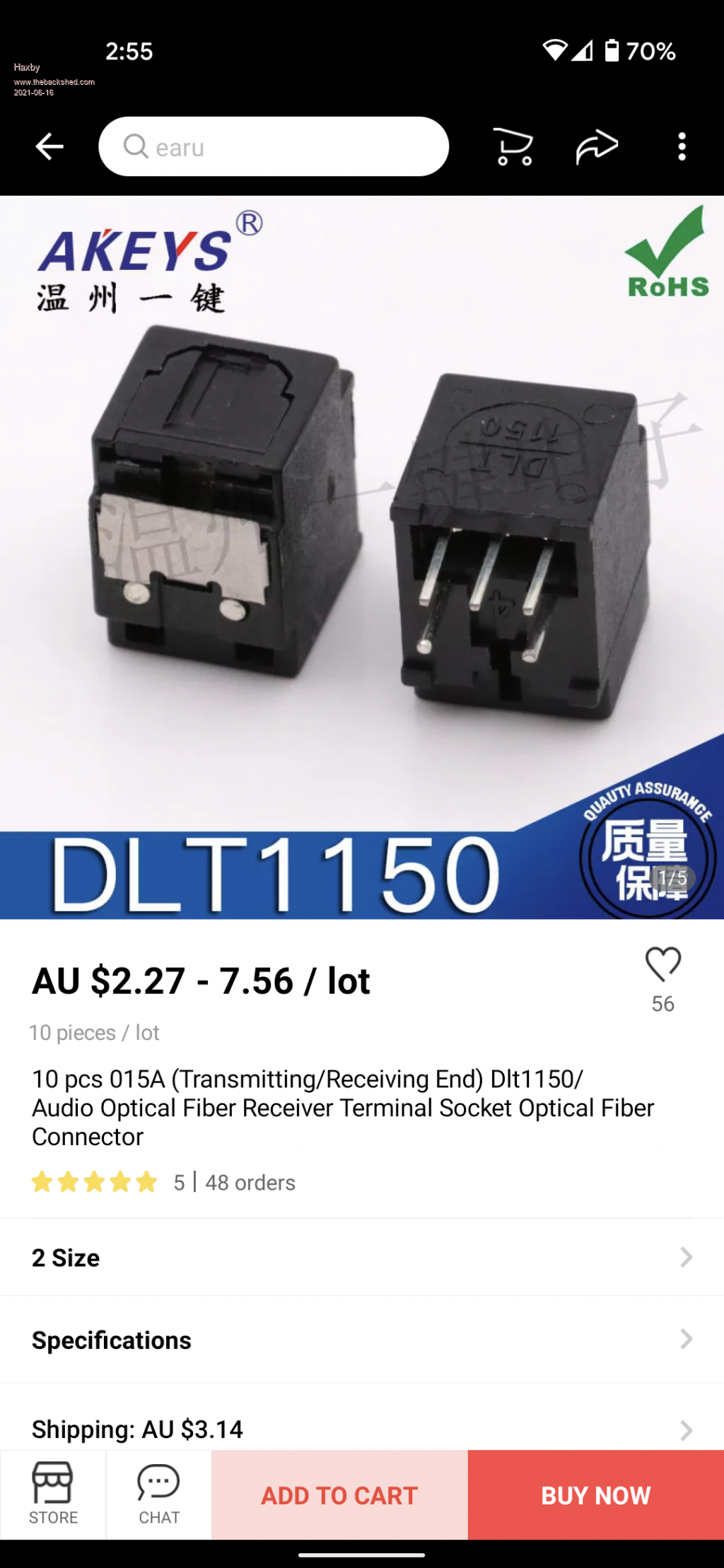

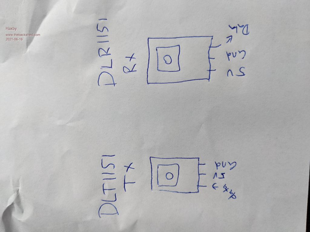

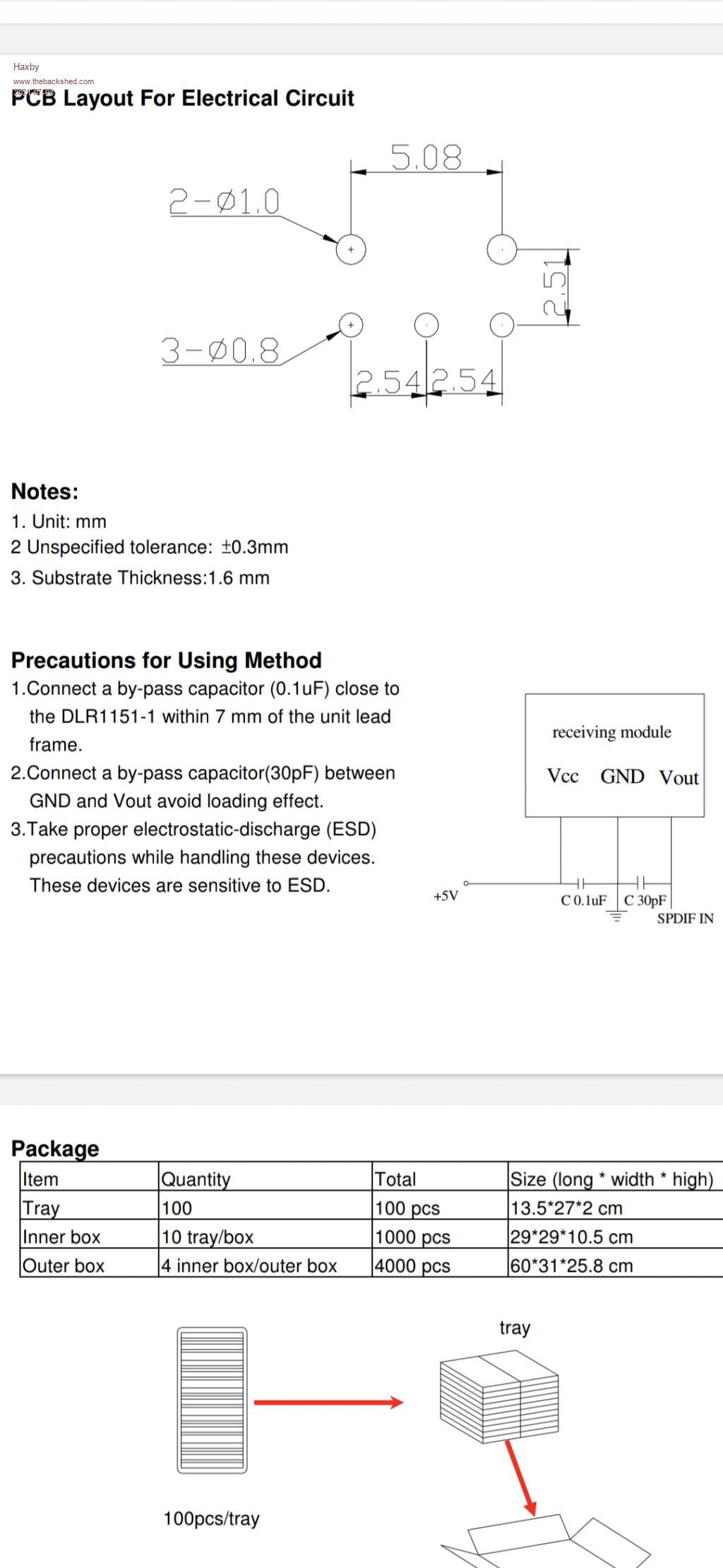

To completely isolate the mega mini processor from the power electronics, I'm considering signalling each IGBT through fiber optic cable.
I'm thinking of using common Hi-Fi audio industry fiber optic cables known as Toslink cables. They appear to be just an LED for the transmitter and a transistor for the receiver... So just a very long optocoupler:
This would put my mind at ease once and for all with regard to capacitive and EMI issues.
Any thoughts on this?
Not sure if I should have one optical cable per igbt or one optical cable per 2 igbts (half bridge).
One per igbt would require 16 optical cables per phase, so 48 optic cables total coming from the processor!!!
If I used 1 optic cable per half bridge, I'd "only" need 24 total but then would have to add a dead time circuit at the igbt end, which would add complexity....
Decisions decisions.... Anyone here used audio based optic cables for something like this before?
The other more professional and expensive types are the HFBR-0500 by Avago, but I'd imagine the cheap Ali express ones would be fine.
Posted: 11:01pm 11 Jun 2021
I think personally its probably overkill, but no harm in doing it.
If the whole EMI concept is thought right through, and there is a definite plan regarding layout and grounding, most of the potential problems will never arise in the first place.
There is a lot more to all this than just getting a schematic from somewhere and connecting up all the parts to each other.
