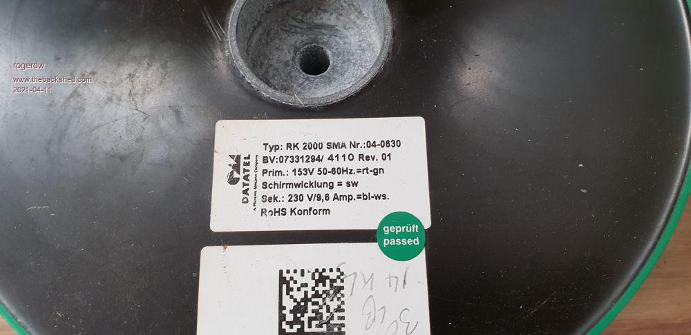

I've had the same question as to why SMA is never mentioned for toroids  ...  and the only reason I can come up with is that (at least some of) the SMA toroids are encapsulated  ...
...  which means you can't unwind them and reuse the wire like you can the Aerosharps  ...  and if you do want to use the bare toroid, you need to destroy the rest to get it apart.

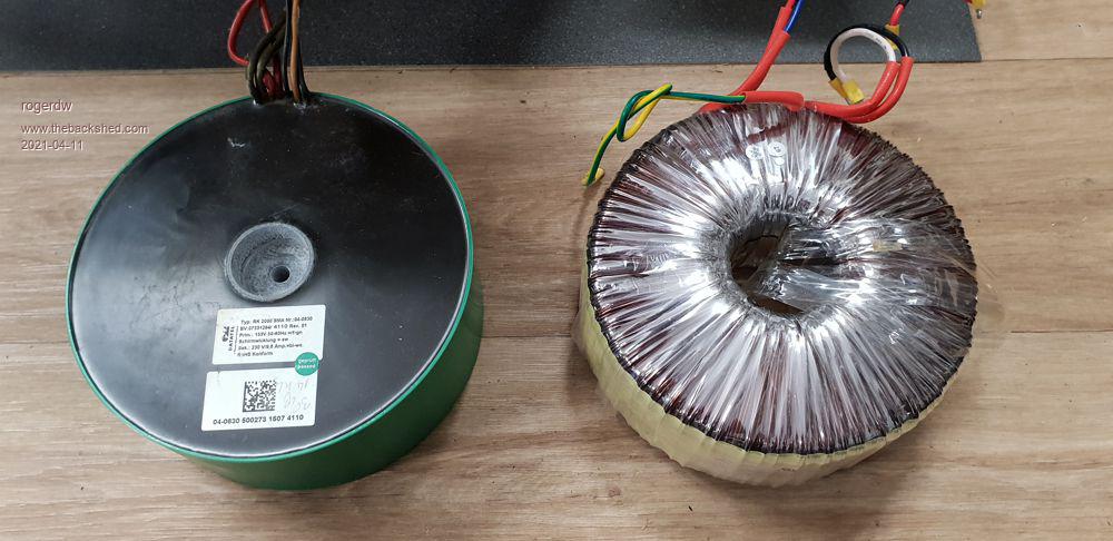

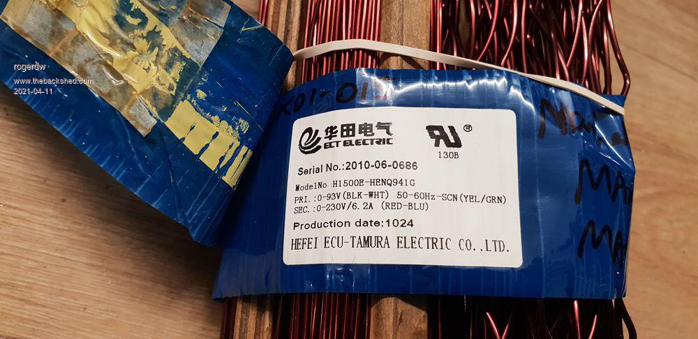

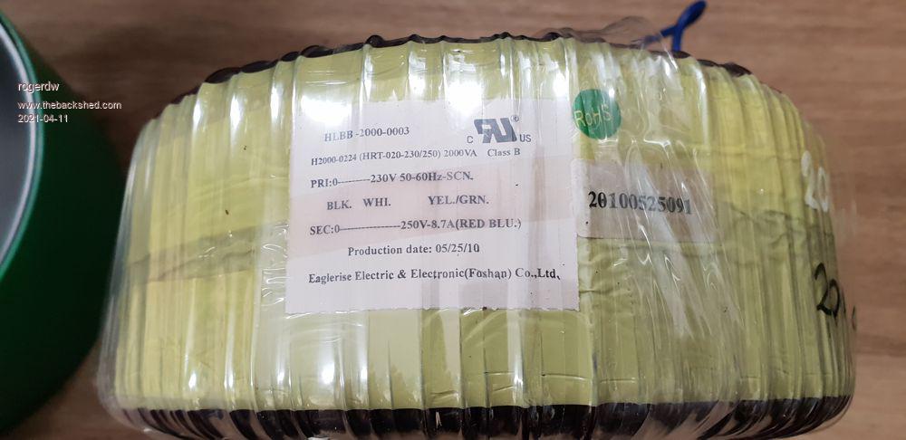

Here's a pix of a 2kW SMA and a 2kW Aerosharp toroid
A closeup of the SMA 2kW ratings  ...  153V Prim 230V Sec
Aerosharp 2kW Tx ratings  ...  230V Prim 250V Sec
And last  ...  specs of a 1.5kW Aerosharp toroid  ...  93V Prim 230V Sec

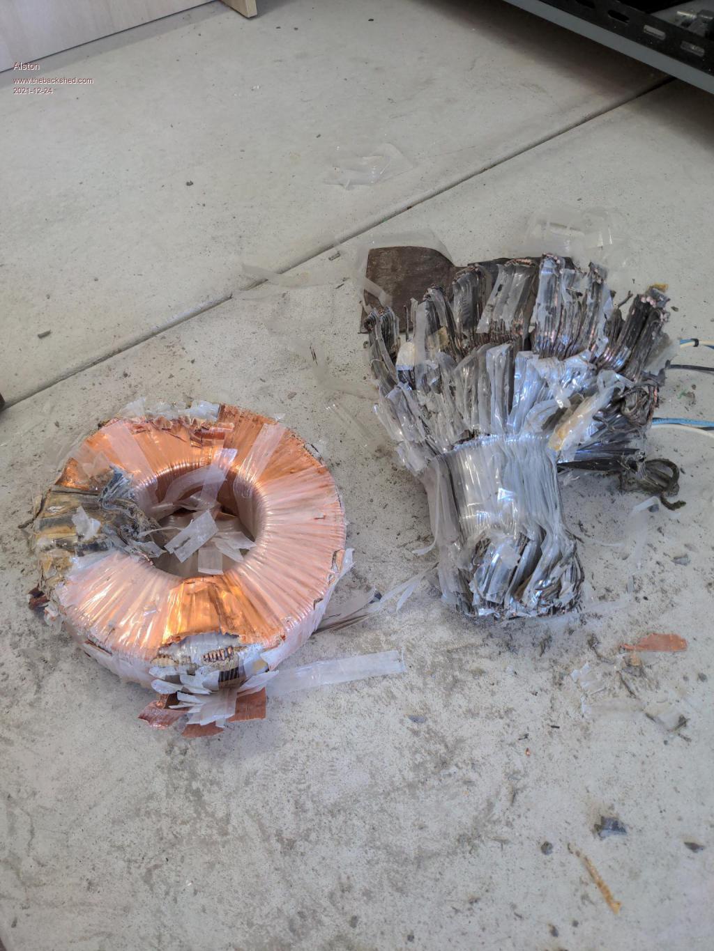

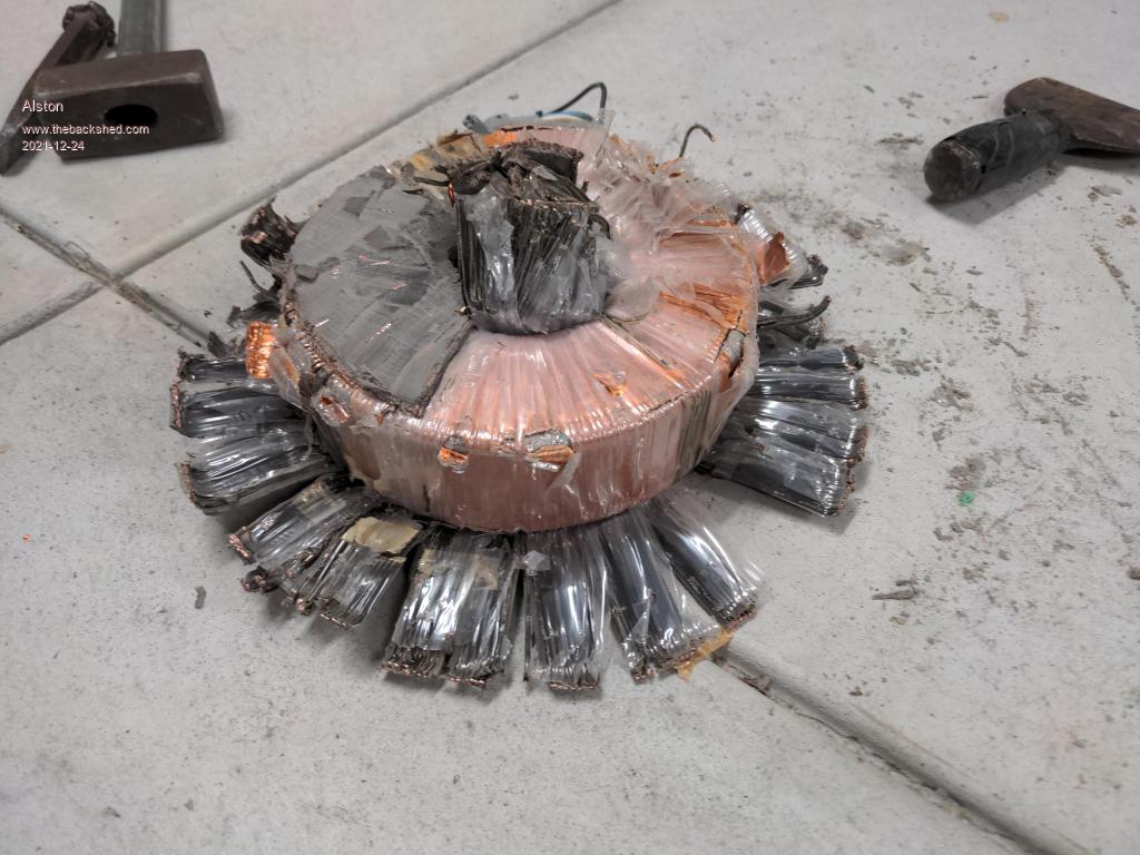

It has taken me a while but I have slowly been gathering parts for a Warpspeed inverter built. I managed to get an Aerosharp for the first transformer and then a smaller SMA inverter for the second. I knew I would need to destroy the the outer winding if I wanted to use the SMA toroid but the potting compound is proving very difficult to remove. I have cut away most of the green housing and have tried acetone but it doesn't do anything to the potting compound. Murphy's Friend is it possible that you might have tried to boil it hot water as I have seen people use that technique for potting compound? Anyone have any tips?
wiseguy
Joined: 21/06/2018
Posts: 1335
Posted: 02:33pm 12 Dec 2021
The only thing I found that softened it was brake fluid but I didnt have enough to give it a decent bath to soak in. Being impatient I then decided to do it by hand. The first step was to remove the toroids central aluminium mounting mandrel.
Simple, get my large club hammer and a ~ 20mm dia steel bar length and bash it as hard as you can & I mean real hard, then repeat over and over then give up !  It didnt move 1mm
Then use a drill to drill multiple 6mm dia holes all around the mandrel on both sides & elongate the holes to all meld together and then eventually remove the mandrel after ~ 1.5 hours. Then use a chisel pliers and a shipload of effort to lop off all the square edges - dont worry about marking the wire - you will never be able to re use it unless someone finds something magical that dissolves the potting crap.
My hands were raw at the end of many many hours of toil and I had hundreds of 2 or 3 turn segments still with the encapsulation stuck all over them lying in a big pile on the floor. I have another 3kW one asking for the same treatment but I haven't worked up the energy/enthusiasm to attack it yet.  I'm thinking an angle grinder is worth a shot but that will also be messy and great care needed not to damage the 240V inner winding underneath.
Nicks reckons its about an hours work but either he got a different type of potted unit to mine or I'm really beginning to show my age ! If you find an easy or easier method please post it !  Good luck.

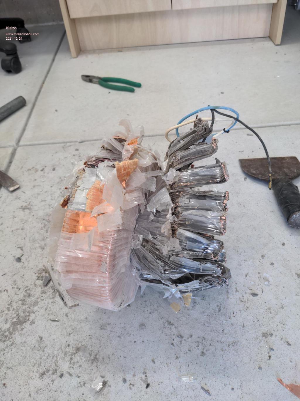

Thanks Wiseguy, I used your technique to get the centre out. Your are right that was a huge amount of work to get that out. I have stopped for the night and will need to tackle the removal of the rest of the compound and top layer of winding. Wondering if this is worth the effort!

Hmmm, the toroid I 'freed' from encapsulation must have had different stuff in it. It was some years ago but I did not remember it being as hard as wiseguy describes.
How about sandblasting it off? Powder coating places should have a big enough blasting cabinet. Once its cleaned to the outer winding surface it should be possible to start unwinding that.

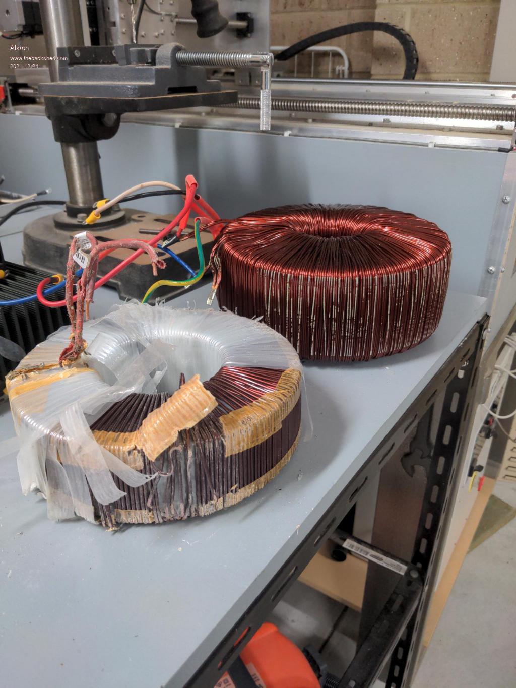

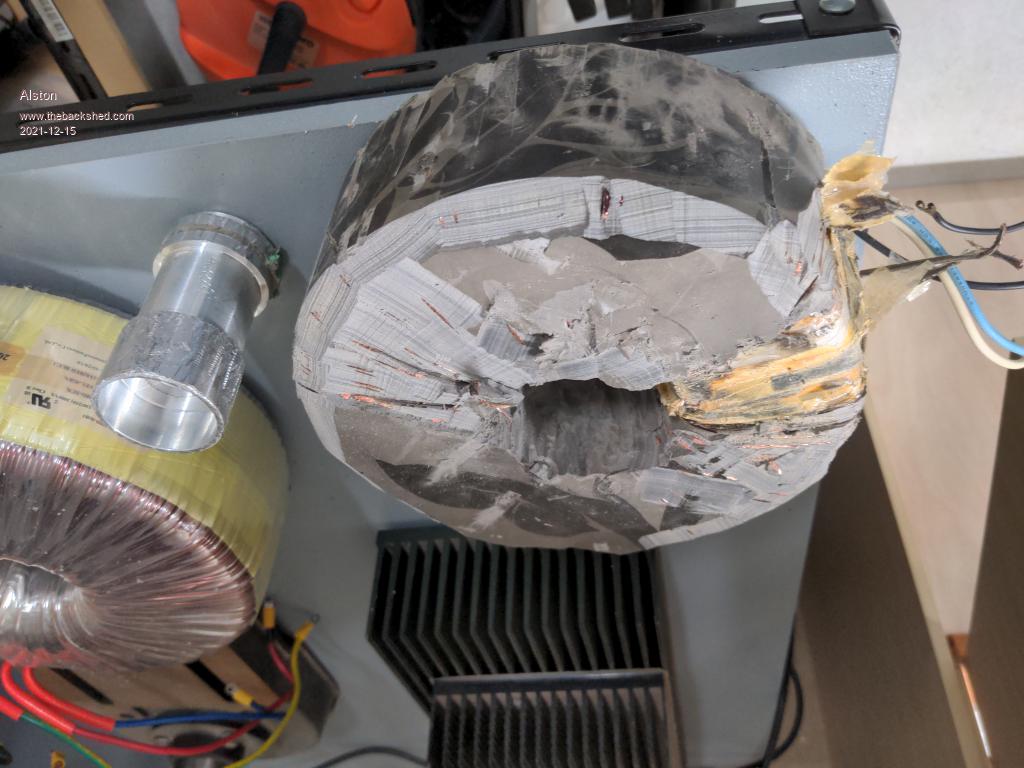

Alston
Joined: 04/04/2021
Posts: 63
Posted: 01:16pm 15 Dec 2021
Edited 2021-12-15 23:18 by Alston
wiseguy
Joined: 21/06/2018
Posts: 1335
Posted: 02:11pm 15 Dec 2021
That looks very familiar - there is still a lot to do though. I reckon an angle grinder with one of those wood carving/shaving discs would remove a lot of that potting crap (along with a bit of varnish.....) in good time. That would also help simplify the energy needed during unwinding. You just need to be careful around near the inner 240V winding wires and where they exit.
I have a mandrel that looks just like that too     I'm curious how long did it take you to remove - I'm hoping you don't say 5 minutes..... mind you I was learning as I progressed.

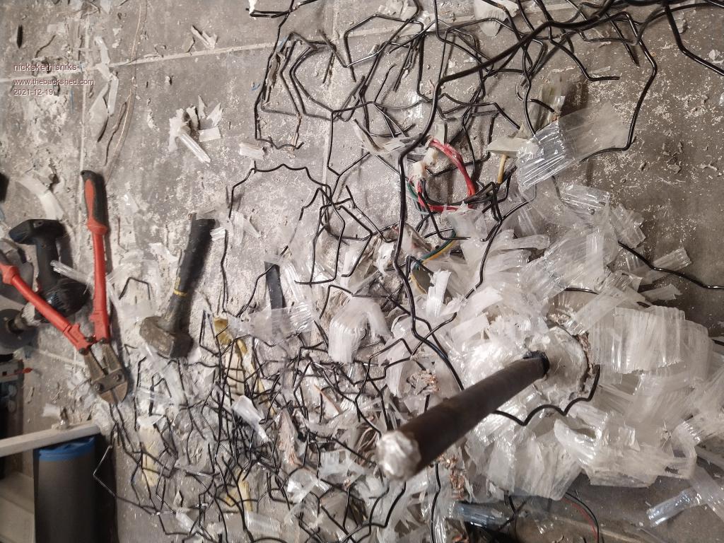

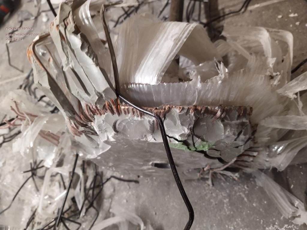

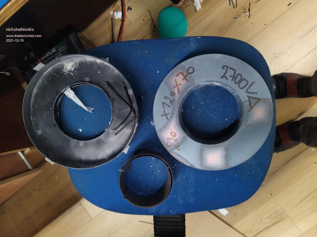

Let me nuance my 1h statement, this was done with a 1400VA transformer. Apparently there is a remarkable difference between a 1400VA transformer and the 2700VA transformer I did today, both potted with grey stuff. The difference between the 2 is that the bigger transformer has a much thicker layer of potting on it then the smaller one, it also has bigger gaps between the wires. This makes it a lot more difficult to go thru that stuff. I think I spent about 1h30 this time, but went for the core only. I tried some different things this time, like using a cordless drill hammer but I had the feeling doing it manually my strokes had more impact.
I lost time chipping of stuff on both side, you really only need to do 1 side first if you are not saving the windings. Then smashing as hard as you can on the middle part, it should come loose. Both windings were damaged this time, this because of the electrical hammer, and so I didn't try to safe the 230V winding this time. The wires of mine were very thick, 3.4mm for the low voltage winding and 2.75mm for 230V. The 230V winding was on the outside of the core so I couldn't save it.
You could ask yourself if it is worth the effort, better to source a non-potted transformer for sure. But over here I can't buy those cores, and should import from UK.
I forgot to take pictures, but this was the battlefield:
Reward : 220*120*70
