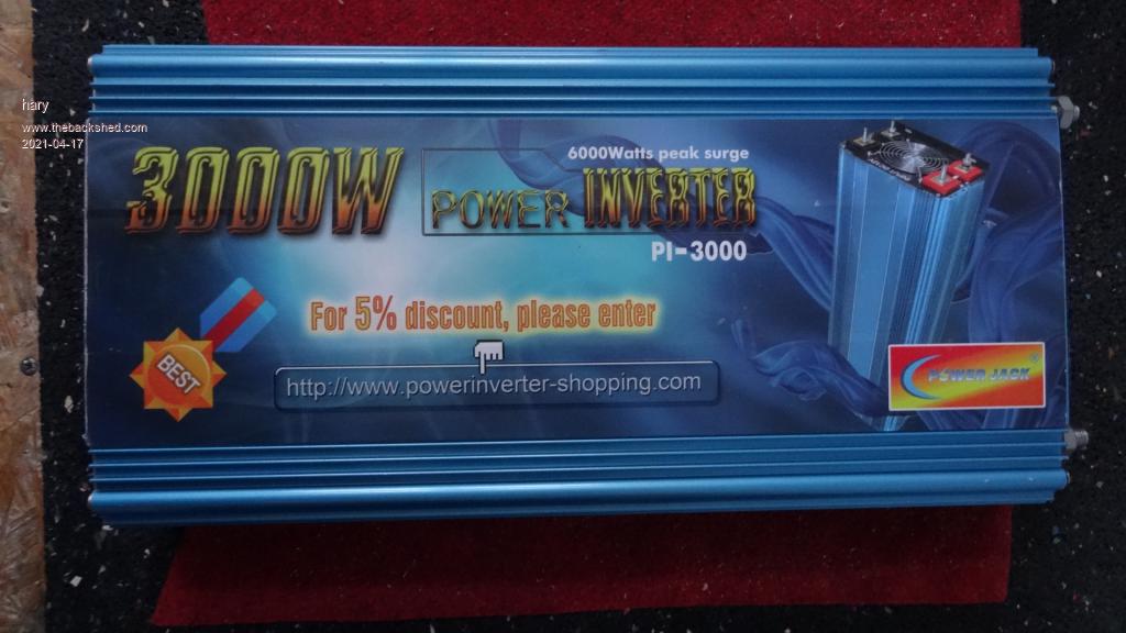

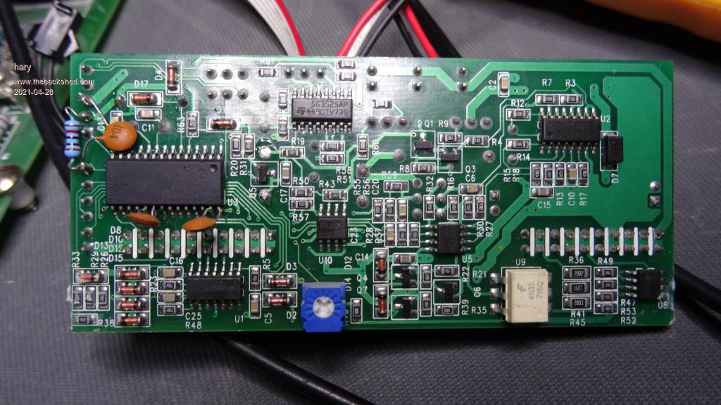

I first had a look to this one, below :
It was beeping, so I took it out of the case and checked for different things about burned fuses or MOSFETs, voltage on the first and second stage, etc.
It was like turning on and off rapidly.There was nothing burned, no fuses, no MOSFETs.
There were 6 small transformers fed by 2 fuses for each, then the output of that 6 transformer were in series.
So I took the fuses off and what I noticed is that with only 1 or 2 of the primary stage transformers, it would not beep and turn itself in security state as the output voltage on the first stage  was lower (less than 180VDC).
With the 6 transformer on, the output voltage was around 250VDC, but was difficult to measure as the inverter was rapidly turning on/off.
I could light up an incandescent 60W light bulb from that 160-180VDC.
So I thought there was something wrong about the first stage feedback loop, so the inverter first was to high in voltage and it would put itself in some kind of security state (on/off behavior).
I started to check around that direction on a control board and first think I've noticed was some lack of tin on some welding.
I wanted to trace that feedback track before doing anything, but fortunately (or not), putting back the control board in place for some deeper expertise, the inverter seemed to start well without beeping.
As I have been touching lot of connection, I was pretty sure there was a bad solder joint somewhere.
I spent some time redoing most of the solder I could, then put everything back, and the inverter seem to give 230VAC at its output.
But for sure I was a little stupid.
As I was so excited, i didn't take much time to check different voltages at different stages in the inverter, or even check the MOSFETs' driver signal with my brand new oscilloscope before closing the box.

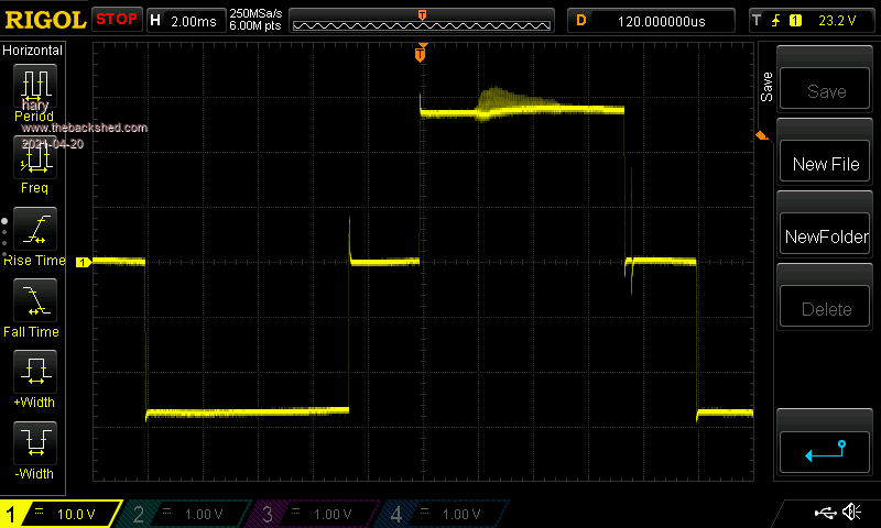

An horrible thing happened to me !
This :
I was thinking I had fixed a true sine wave inverter ! I'm very disappointed.

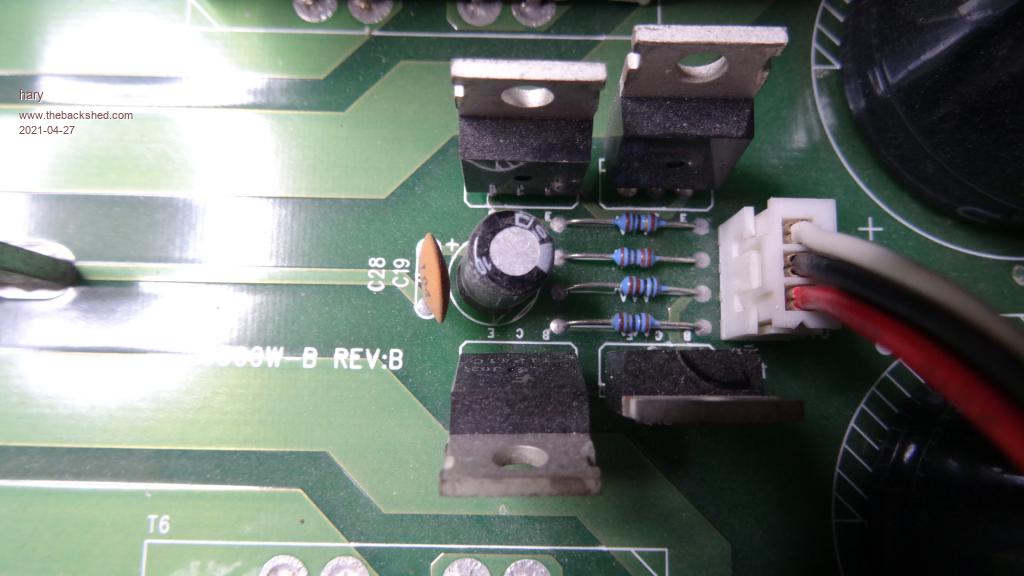

I noticed most of the Mosfets were dead plus the 10R resistors from the driver to Gate. Everything else on the board seems to be ok.
I've taken all the dead components off to check that all the rest was ok.

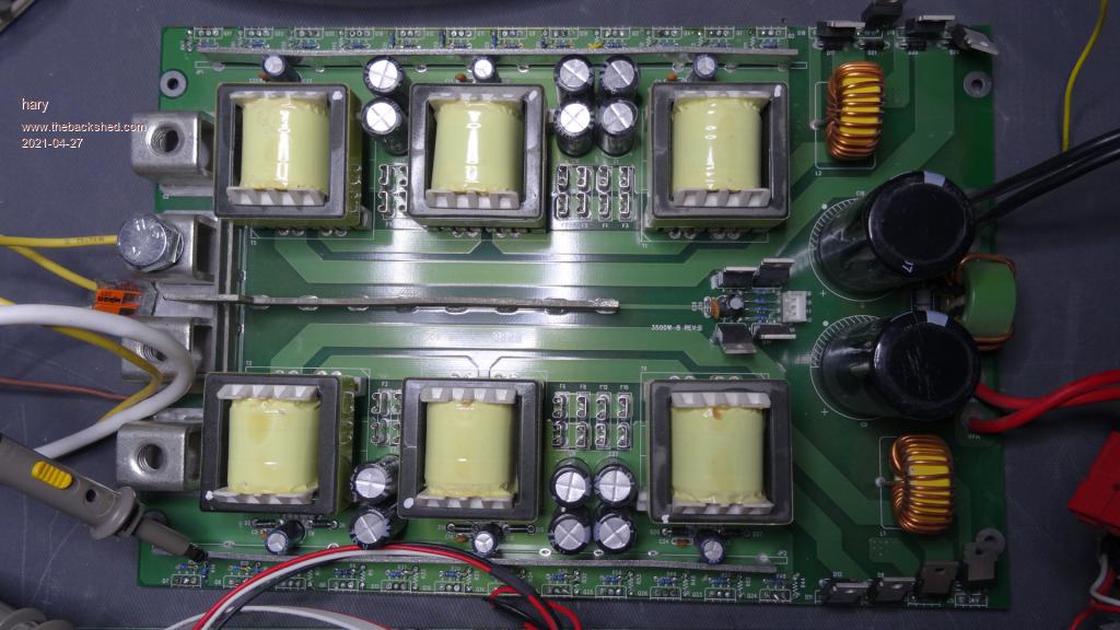

The inverter is made of 2 boards :

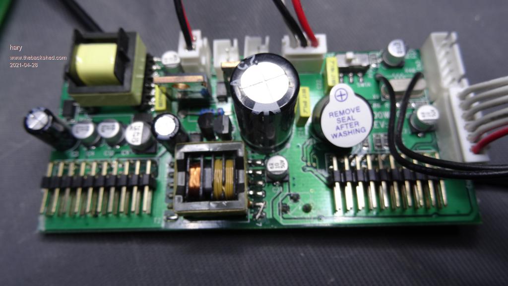

The 1st one hold all the control of the second stage of that HF inverter plus the charger/UPS functions and the second stage of the inverter.
The 2nd board only hold the DC12V/DC200+ boost converter and the 2 Push-Pull Mosfets drivers made of 2 pairs of TIP41C and TP42C.

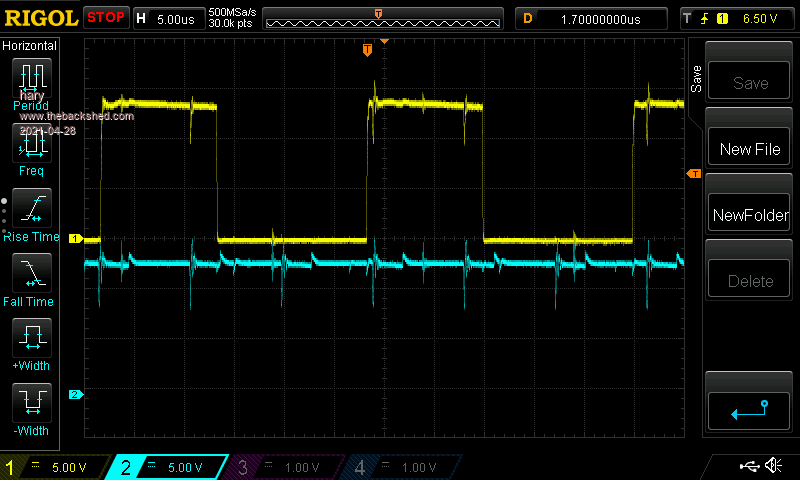

Here is a closer look at the driver :
Here is the sigal I get from the control board or after the Push-Pull driver.

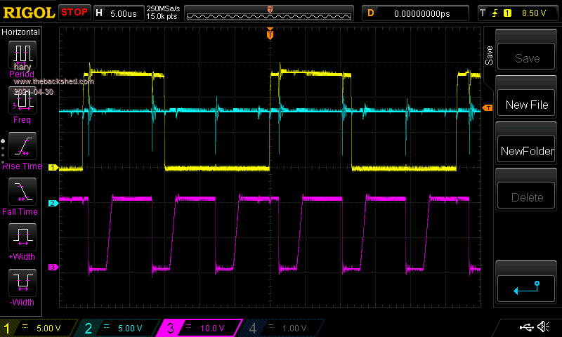

As you can see the signal doesn't seem to be perfect as it shows some down spike close to 7.5V.
I wonder whether I can trust that driver's signal or not:
I would like your advices before putting a all bunch (24) of new IRF3205.
nickskethisniks
Joined: 17/10/2017
Location: Belgium
Posts: 499
Posted: 05:52pm 26 Apr 2021
It looks like there is a problem with the voltage supplied to your gate driver circuit. There is about the same period between the spikes, so I would look in to that, are these without MOSFETs connected?

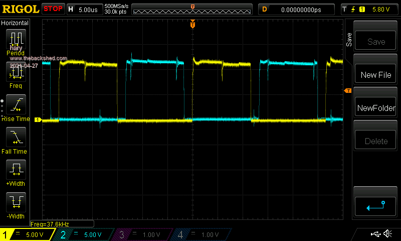

Posted: 07:55pm 27 Apr 2021
@Pete Locke. I'm not sure to understand 100%, but I don't think I need such a trick as I can still run the driver without the rest of the circuit.

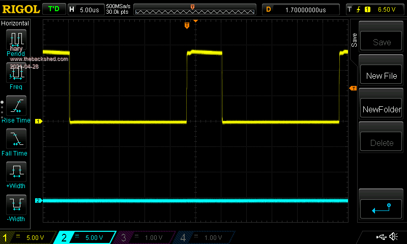

Here again, without any load on its output, in yellow the signal from pin14/outputB of the SG3525 where the Push-pull is triggered from, and in blue the VCC. As you can see, the spikes are also present on the power line and seem to be synchronised
Here, the signal of a spare SG3525 I powered up on the bench. The signal just looks perfect. So I really don't think I can just replace the lot of IRF3205 and power it up.I first need to get a nice commande from the SG3525.
I would appreciate some specialist feedback
nickskethisniks
Joined: 17/10/2017
Location: Belgium
Posts: 499
Posted: 08:05pm 27 Apr 2021
Have you probed that 12V gatedriver power supply? You can use some kind of marker pen to trace down that 12V to the place were it is created. Or probe some random low voltage (probably 16-25V)capacitors around some high HF transformers to find the circuit. It's possible they first create a stable/constant voltage from that battery input voltage.
Edit: ok, you posted some other pics while I was writing...
As I said, look in that stage where that 12V is created. Makes me wonder, probably not the cause but are the output igbt's connected, is this stage also active? Make sure there is no short between input DC and output AC.
Edited 2021-04-28 06:11 by nickskethisniks

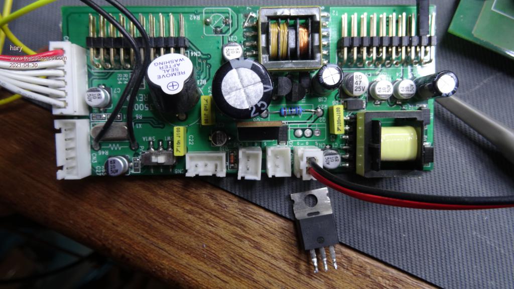

hary
Joined: 15/04/2019
Posts: 89
Posted: 08:41pm 27 Apr 2021

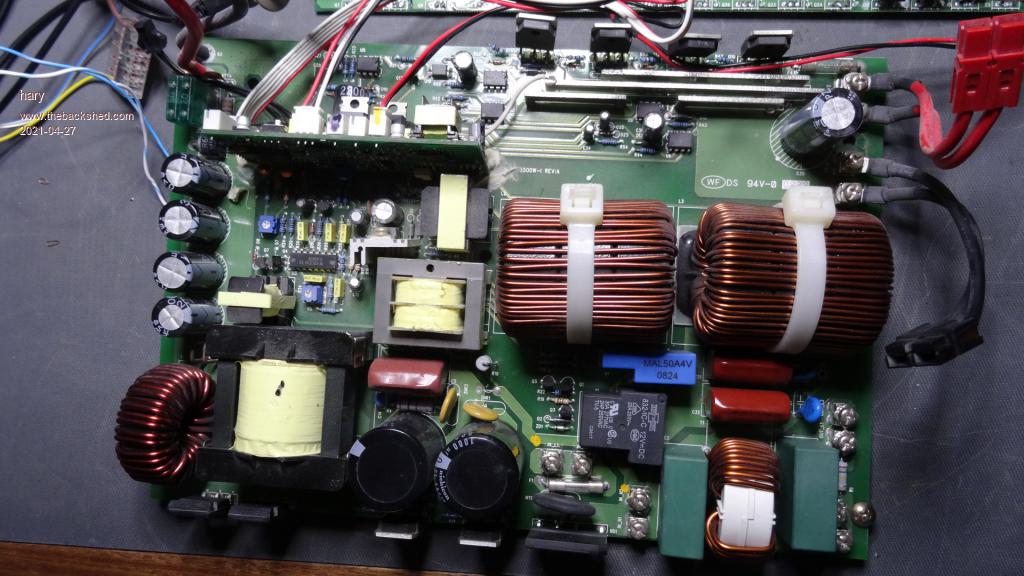

That inverter is a DC12V/AC230V, so the control board seems to be supplied directly from the battery, no kind of buck converter in between.
Here is the control board :
Even on that big 2200uF cap, I can see the spikes !
I've disconnected the second stage's IGBT to be sure not too make trouble, but I don't think the second stage driver would start before the control board get a 200+VDC from the 1st stage.
nickskethisniks
Joined: 17/10/2017
Location: Belgium
Posts: 499
Posted: 08:26pm 28 Apr 2021
Ok, you are sure? Are you using a battery or power supply to power the inverter? Small chance it's caused by your supply because you spikes look to be synchronised to your gatedriver signal. I'm going to sleep on it.

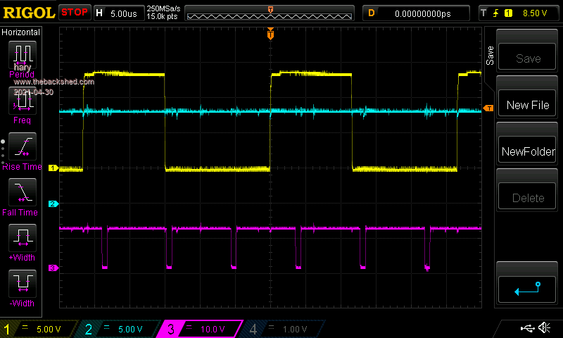

hary
Joined: 15/04/2019
Posts: 89
Posted: 05:43am 29 Apr 2021
Hi nickskethisniks.
It's powered with a bench SPSU (ruiden RD6018).
But on that post https://www.thebackshed.com/forum/ViewTopic.php?PID=168015#168015#167935
the 2nd picture shows the output signal of a spare SG3525 alone that I powered from the exact same bench PSU and it looks perfect !
I might try to power the control board with a shorter/bigger line to ensure no lack of power. I'll give you the feedback soon
