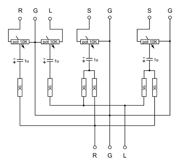

I want to make a very simple mono/stereo audio mixer to mix 3 inputs:
- computer stereo sound card
- motherboard mono speaker (pc speaker/buzzer)
- external music player
I plan to connect mixer output to stereo speakers with active aplifier.
Use case is retro gaming. Some old games play music from soundcard, but sound effects still come from PC speaker (for example Ultima). Other games don't have music at all, so I turn on some external music.
And it would be nice to hear all sounds from same speakers, and adjust volume level for each input.
I found such circuit of passive mixer:
http://www.therandomlab.com/2015/05/simple-passive-monostereo-to-stereo.html
I would need to change one mono input to stereo input, so I would have 2 stere inputs and 1 mono input.
Would it be ok for my use case?
I'm open for any suggestions.
Thank you!

Yes, that should work fine.
Any number of mono or stereo inputs could be added, its just more of the same.

Yes....but no. The issue with the circuit is that you will have left and right mixing through the 1K resistors on the two mono channels. It will work, but the stereo separation will suffer. You need to have an active mono splitter to keep the stereo effect as good as it can be.

What you say is quite true Pete, but he just wants something very simple for gaming.

Posted: 10:16pm 18 Mar 2021
Stereo is supposed to be two entirely different and separate channels.
So in theory you should be able to have a full symphony orchestra going full blast on one channel, and have complete total dead silence on the other channel.
Feeding a mono signal into both channels using just resistors will work fine, both channels will then produce the same mono signal.
What Pete is saying is that one stereo channel can bleed slightly back into the other through the same mixing resistors, so instead of having dead silence on one channel, a loud signal on one channel can feed a little bit of signal back into the other channel. So it slightly degrades the full stereo effect.
If you are interested in top end very high quality stereo reproduction, that is a disadvantage.  For sound effects for gaming, I doubt that you would even notice the slight difference.
I suggest build the circuit as you originally intended, and see how it goes.
If you strike any problems we can help you solve them.

Please explain me one thing: for what reason pots are connected to ground?
To my understanding pots here are used to adjust input level on each channel, so I would put a pot on every channel wire (like resistor and capacitor). But would I want to ground the third pot pin?

I thought I'll better illustrate what I mean.
In my circuits when I needed to adjust volume I did it like this. Used two pot's pins, and left third one unused.
Or like this. Same as previous, but shortened unused pin to middle pin, since it's not used.
And both these approches worked fine for me. So I'm confused to see the third pin connected to ground.
Posted: 08:10am 21 Mar 2021
That should work, but it has the disadvantage that you can only turn down the volume so far. If its still too loud on one input, there is not much you can do.
By returning the potentiometers to ground, you can turn down the volume all the way down to zero.
A much wider adjustment range.

Posted: 08:47am 21 Mar 2021
As Tony said, it will work but not as well as it would with an earth (ground) in the circuit. The original circuit you posted should work OK, with the understanding that the left and right channels (what you get in your left and right ear, especially with headphones on) will sound closer together. What I mean is that if your game has a car going from left to right on the screen, the sound will appear to be closer to it coming straight at you rather than from one side to the other.
But build the original as has been suggested, and see how you like it. If it's not what you are after then we can help with suggestions/links to something a bit better.
The other thing to bear in mind, is as it's a passive mixer, when you alter one of the volume controls, it will have an effect on the other two channels. It may or maynot be noticeable depending on the adjustment. But build it and see how you like it.

Can you also please explain me what task capacitors do in this circuit?
Edited 2021-03-21 23:59 by Cyber
Posted: 10:07pm 21 Mar 2021
The capacitors remove any slight residual dc voltage on the audio signal. Probably not necessary, but its good design practice to have them there.

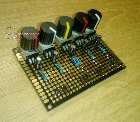

Posted: 06:54pm 06 Apr 2021
I built it and tested it on some mobile phones and it sounds fine to me!
