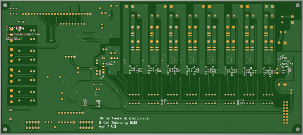

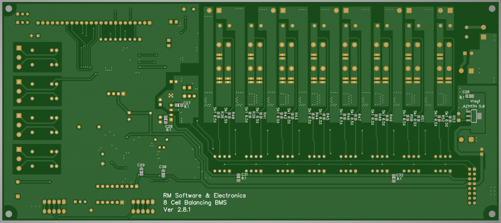

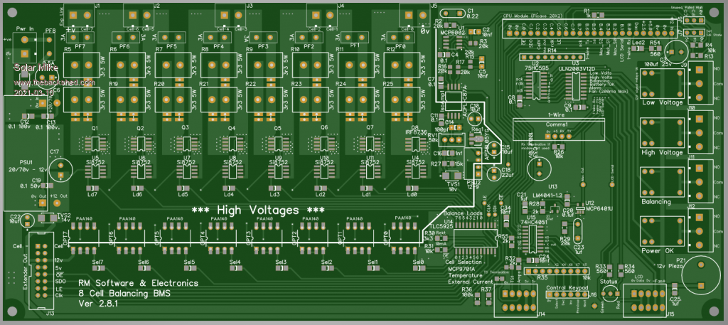

Currently splitting up an old lifepo4 battery bank into several 24v packs, the old 40AH cells are pretty much on the way out, 4 have started to swell markedly if left after charging; the rest 30 odd are probably at < 50% capacity.
Cannot really use them without a BMS as their capacities vary all over the place, the current BMS I published a while ago is a bit complex and requires several pcbs; so have designed this version which is a bit easier to make.
Spec: 8 cells, can vary between 2.5 - 12 volts each, balancing current 0.5 - several amps, using a switched floating isolated measuring circuit. Extender output allows expansion to more groups of 8 cells.
Just as I completed this, latest silicon chip has a nifty design using switching transformers for lossless balancing of 4 cells, not sure how much that it can be extended, wait for part 2 next month.
And those 4 bad cells, cannot find anywhere in Wellington to take for disposal or recycling, not sure what to do with them, may drill a 10mm hole in each and drop in a bucket of water for a week to make inert.
PCB top: 260 x 115mm
I dont have a schematic as yet as its very similar to previous designs.

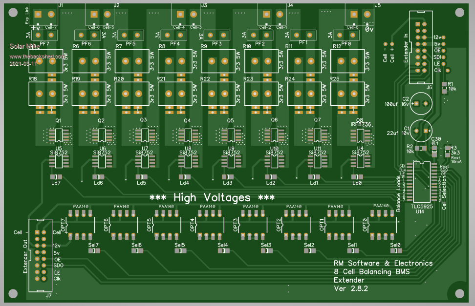

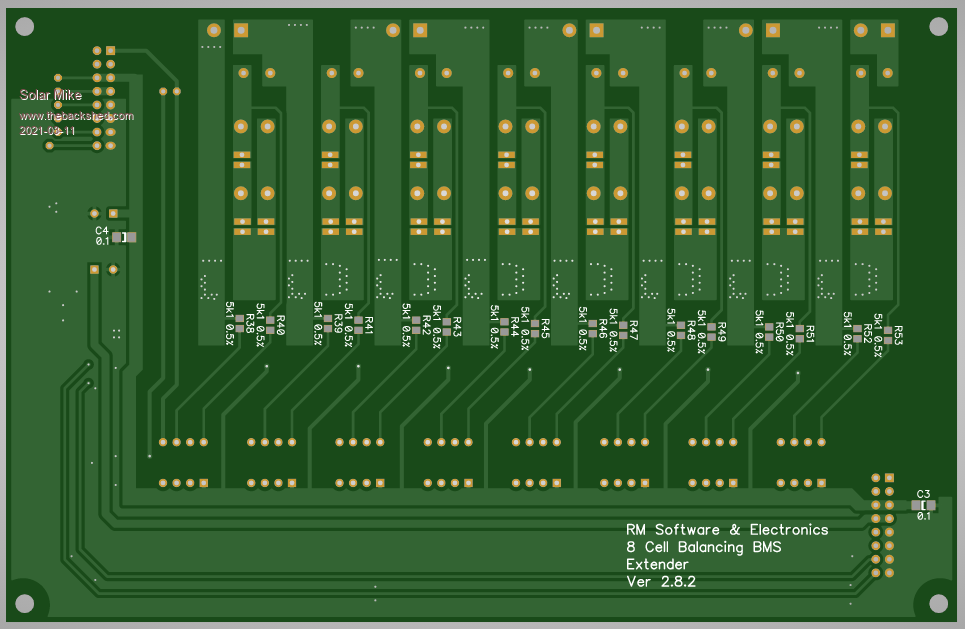

Update: Have cut and paste to clone an extender pcb, this allows multiples of 8 cells to be measured. Made some minor alterations to original at same time, still don't have a schematic for this, not even a pencil drawing, but have sent both sets of gerbers off today regardless; cannot see any errors... famous last words.
Extender 115 x 178:
Once I get it going will publish gerbers and software.
